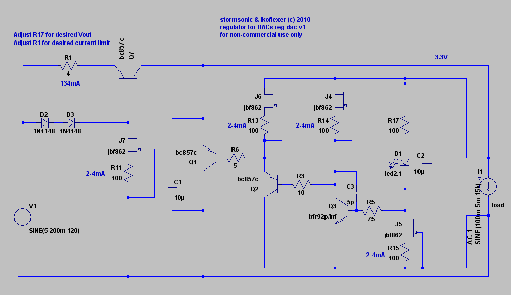

I wanted you to be in agreement as well. This is the one I have here, you might have changed something when you built it? Probably didn't even use C3?
D2 & D3 can be replaced with single LED. C2 can be increased to 47uF or 100uF.
R17 need some tweaking. Exact value depending of D1 voltage forward and Id of J5.
Tested without C3 capacitor, it is stable. Current should not go over 100mA.

I am spending 90% of my SPARE time on my "bread and butter" work now and only 10% on DIY. But will cut the boards today and build 3 x +/-15V regulators for my active XO in the following weeks. I think if ppap64 wants 6 regulators for 6 opamps it may be a bit overkill. I can tell you my result in about a couple of weeks time.

Here is one suggestion: we have gone through those before but I think it is very convinent if you inidcate the ideal Idss (or Idss range) of the jFETs directly on the schematic so that we don't need to go back to the previous over 1000 posts trying to dig out the information, which is something I have to do now. I remember for J2 and J4 they would be 7mA to 8mA, or not? 😕
Bill
Will do Bill, good suggestion!
