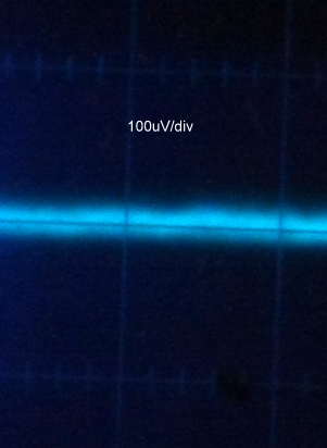

I would like to address this now. In the past I have posted pictures taken of my oscilloscope screen while the regulator was connected. The oscilloscope was set on the most sensitive setting, i.e. 100uV/div. What this means is that if there was ripple with peaks spanning from one horizontal line to the next horizontal line shown on the oscilloscope screen, it is equivalent to measuring 100uV peak-to-peak.
Attached is an image showing a close up of the trace, while the positive regulator is powered on. In the past I have assessed the trace width to between 30 and 40 microvolts, because I wanted to err on the plus side. It is definitely below 50 microvolts, which would be 1/2 of division.
Now, let's see what syn08 has measured. He reported a noise density of 510nV/rtHz. We need to convert this to a peak-to-peak value, such as what I have shown in the picture. It is typical to take a frequency range of 21kHz for the conversion, since we want to know the peak-to-peak value especially in the audio range.
The proper way to convert is to integrate below the curve that syn08 has shown. However, a good approximation can be give by the following formula:
Peak-to-peak noise = ND * sqrt(frequency) * 1.57 / 0.707
We assume a 1 pole filter to discard the rest of the frequency above 21kHz, hence the multiplication by 1.57, and we divide by 0.707 to convert from RMS to peak-to-peak. So,
syn08_p2p_noise = 510 * sqrt(21000) * 1.57 / 0.707
syn08_p2p_noise = 164119.45347 nV = 164uV
A little tutorial on converting spectral density to RMS can be found at this link from AD:
Analog
164uV would have shown as a very thick trace on my oscilloscope, spanning across almost two horizontal lines on the screen.

does divide by 0.707 give Vrms to Vpk or gives Vrms to Vpp?
Your noise on the scope looks like 20 to 30uVpp as best as I can interpret. But it appears to be wideband, not filtered @ an audio frequency.
If you increase the noise bandwidth then the predicted 164uV will be even higher for the actual scope picture.
Ther is obviously something very different between the actual noise measurement and the noise prediction.
Oops, you're right, it's voltage peak. This should teach me to not write things when half asleep. 🙂
Multiply by 2 and you get Vpp. And this makes things even worse for syn08's result, of course, because what's shown on my scope is Vpp. Thanks for the correction Andrew!
Yes, you're right. I just wanted to approximate in such way that it would be a bit of advantage for his argument, and even so, it still shows much smaller noise for my measurement.
Andrew, he didn't say it was a prediction, he said he measured it. The fact that there is a big difference is my point, and he must have made a mistake either measuring or building the regulator. The schematic he shows does not work and has one big error: The LEDs that bias the CCS mosfet are reversed, and so is the capacitor. I wonder if his simulations and circuit have the same error.

However, I confess I didn't do it to capture the trace I showed earlier. Even so, the observed noise was quite small and seeing that I simply didn't obsess any more over it.

Interesting, I didn't even think about the noise distribution. If we assume it Gaussian and apply your formula, we get even worse a difference between syn08's result and mine.
Let's see.
syn08_p2p_gaussian_noise = 510 * sqrt(21000) * 1.57 * 6 * 2
syn08_p2p_gaussian_noise = 1.39mV
We'd get a larger number using a wider bandwidth, but there's no point in continuing this. I think it's pretty clear that my implementation and syn08's implementation of the same circuit are completely different. I don't blame him for being so outraged, his result is indeed a disaster.
