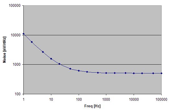

Noise measurements
I've found the noise measurements, see attached.
510nV/rtHz plateau noise, up to 11,000nV/rtHz at very low frequencies (1Hz). Corner frequency is around 100Hz, not bad.
This is in my book "noisy as hell". Imagine you would try to feed a MC stage with this regulator. To keep the power supply negligible, the MC stage would need a HF PSRR of not less than 60dB. There's not many low noise opamps with such a PSRR, for a full discrete low noise design that's almost impossible to get.

Things don't add up syn08. I've already told you that your loop gain analysis was wrong. You probably didn't check it again because you cannot see my replies.

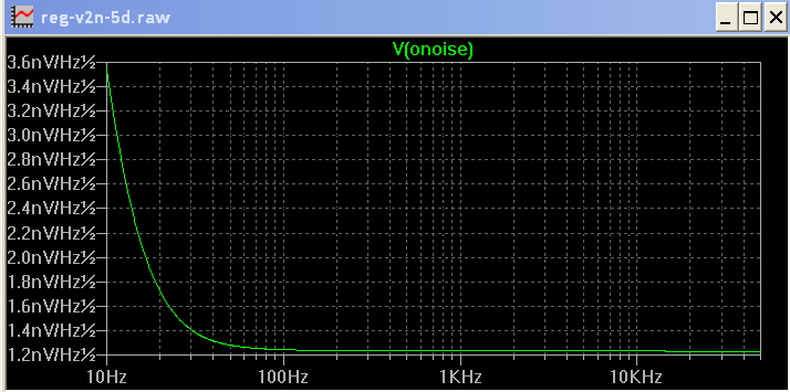

Regarding the noise. This circuit has as its basis Salas' v1 circuit, with very few parts added. The most important modification was one transistor to make the first gain stage of the error amp cascode, and the buffer right after it, another bjt. A lot of people, probably hundreds, have built the Salas circuit and all have reported "black background" and described it as the lowest noise regulator they used. Does it make sense that a couple of extra transistors would make the noise so huge that it's a disaster? Not to me.
I also attached a simple noise simulation of the circuit. I know very well it's just a simulation. But this noise simulation shows better results (i.e. lower noise) than most regulator designs out there. How can reality be 300 times worse than the simulation? Again, it doesn't make sense to me.
Now, the output impedance. 100mOhm? I have measured it up to about 50kHz with my totally non professional devices and a layout that I wasn't even careful about, on purpose, and it was way below 10mOhm. I don't remember exactly the number but now I want to do it again and write it down.
I've described it before, but this is how I measured the output impedance manually. I used a mosfet as load, biased with two resistors so that there was a DC load of about 100mA. Then I injected a sine wave (also tested with square wave, but the measurement was easier with sine wave) into the gate such that the AC component of the load was about 20mA. I have tried other values as well, like 200mA DC + 50 to 100mA AC, etc. Measured the ripple on the regulator output and divided by the current, at a few frequency points, such as 100Hz, 500Hz, 1kHz, 3kHz, 5kHz, 10kHz, 15kHz, 20kHz, 30kHz, 40kHz, and 50kHz.
I had to do it this way because I just don't have the instruments to sweep over the frequency and just get a plot. That would be nice.
In any case, in my opinion you must have made a mistake somewhere syn08.
