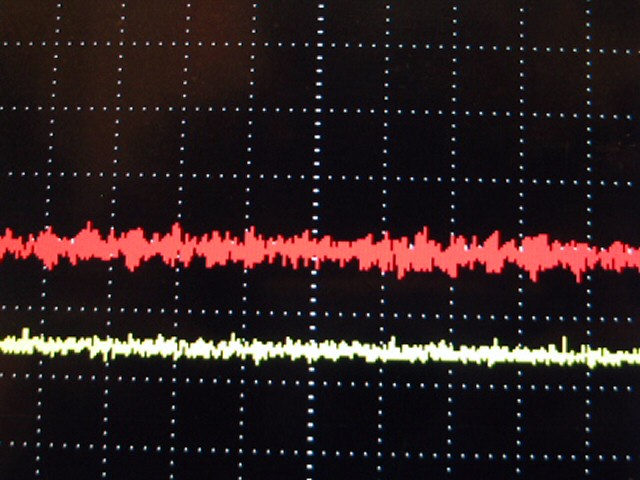

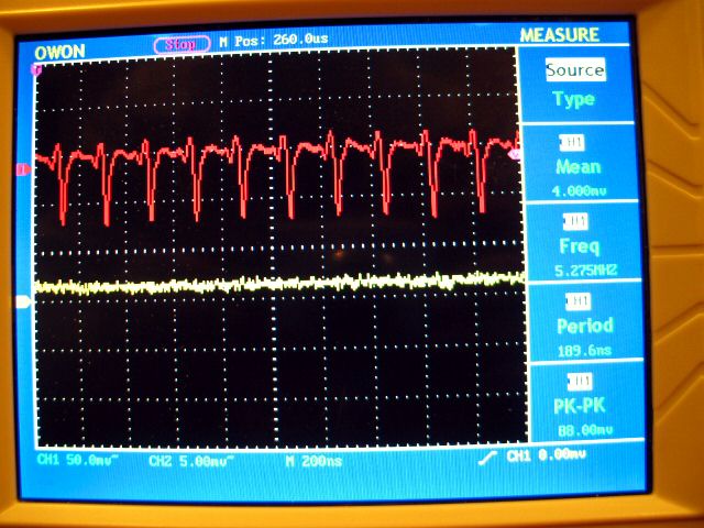

received logic level MOSFETs and assembled new board.
Picture without output cap, oscillations with 88 mV peak-to-peak
Output cap 3.3uF MKP Vishay
Zoomed trace, final version.
Output cap 47uF Panasonic FC + bypass 4.7uF MKT EPCOS
http://www.diyaudio.com/forums/attachment.php?attachmentid=150751&stc=1&d=1261181853
Bottom trace (white-yellow) is noise floor.
Output wires & sense wires cut to 3 cm.
I can confirm that placing output cap at load introduced some oscillations, better to keep output cap close to MOSFET.
Tried different caps, good results with Panasonic FC and FM, Elna Silmic, Oscon. I think this cap should be low ESR type.
Another bypass with 100nF or 220nF and oscillations returns 😛

Good info. What load? Roughly what was the ripple on the input? 5V output?
The last image shows ripple close to the noise floor. What would you estimate it to be peak-to-peak?

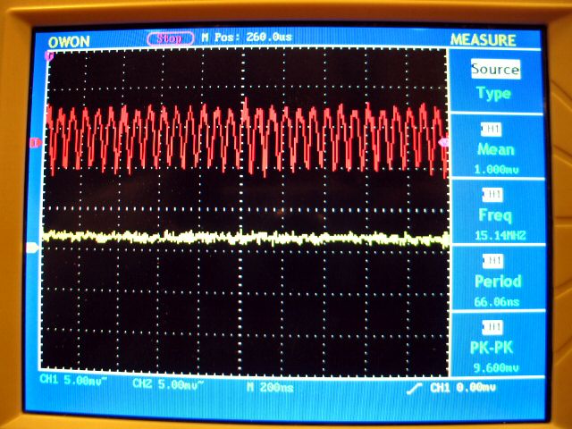

Yes, received email today 😛 (sent Dec. 15th)
I think problem was in different MOSFETs (IRFBC40 & CEB703AL).
Input 12V, shunt current set to 500 mA. Output 5V, load 100 mA (resistor).
Look at 2nd picture, lower left corner. Grid is 5 mV, output ripple 3.6 mV peak-to-peak.
Thanks stormsonic. Now let's get to business. 3.6mV peak-to-peak is too much 😀
The images I showed earlier were sub 30-40 uV peak-to-peak. This has happened with about 15cm or output wire (both output and sense). Both latest pcb prototypes same performance. And I don't cheat.
There might be something off with your implementation?
Can't be. The Simpler Simplistic HV which is ultra basic was shown with 1mV on an analogous TFT screen scope, long outs, no remote sensing, next to heater wires and valves, with rudimentary CRC input. V2 LV should show just thin line in a digital source environment. Is the Vref filtered with 220uF in your implementation Stormsonic? Or it may be the GND.
or the measuring bridge is tapped into the wrong locations or maybe the bridge is broken into separate sections.

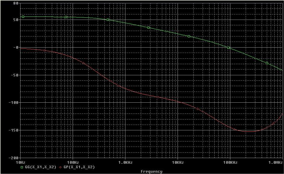

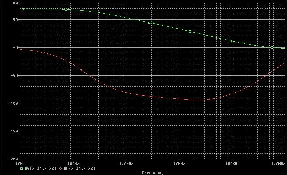

No; in this design, it's most likely the result of a max 30 degs phase margin. Under such circumstances, the output cap parasitics (L, R) and wiring are deciding the stability.
To avoid any idiosyncrasies, I'm not going to compare this design to other solutions but the Salas regulator.
See below; the Salas regulator has significantly larger open loop gain, much unity gain loop frequency and a very large phase margin; it is unconditionally stable and has a good (although not perfect) frequency (because of the decent bandwidth) and transient (because the relatively small phase dip) response.
It is certainly funny to compare these results with the subjective opinions
Yeah, the virtually unstable design "sounds better"
Oopsy daisy! I just noticed this. the Salas regulator does indeed have larger phase margin, but it does not have a higher open loop gain. Your analysis is flawed.
