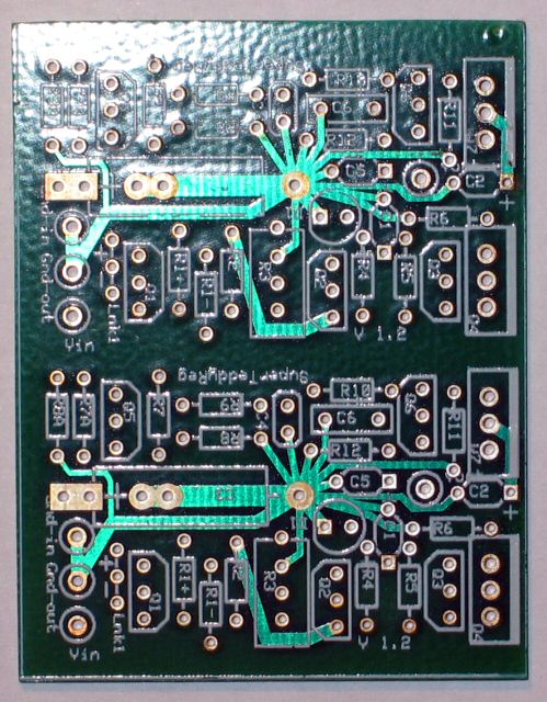

Hi telstar. First, the schematic has a bad mistake. The point in between the two CCS mosfets is connected directly to ground.
Ops, will fix it!

Iko, my proposal, if possible:
- each PCB board should hold two independent regulator circuit. Each circuit can be set as positive or as negative version.
With that arrangement, you can have two positive versions, two negative versions or one positive and one negative version.
If anyone need only one regulator, PCB can be cut in half.
Production costs will be reduced.
Very clever solution for SupperTeddyReg PCB, pic bellow
It's a good suggestion stormsonic, but there is a technical problem. The negative STR board is done so that it uses the same layout but complementary parts (pnp instead of npn, p-channel instead of n-channel). Now you can see the obvious advantage: you can use the same board for positive and negative. There is a disadvantage though. The negative version will have quite different specs (line and load regulation for instance). Now this does not happen when the negative regulator is designed the way I did it. So you can expect the negative and the positive rails to have specs that are close to each other. The other advantage is that you can use the same type devices on both rails. However, the positive layout cannot be the same as the negative layout.
