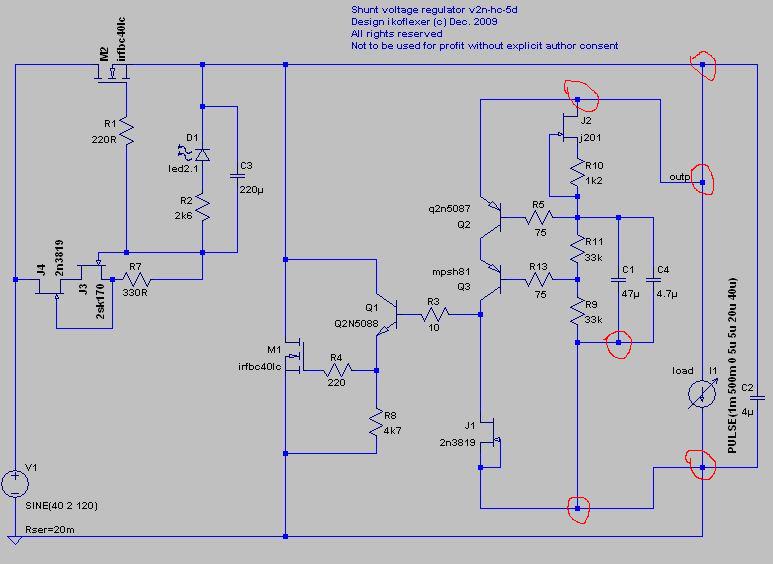

I don't know if the LM317/337 pre-regulator will improve the sound or not but am thinking about giving it a try. The benefits I can think of are:
1. Add some 70dB line regulation before the CCS-shunt. It is not that the line regulation of the CCS-shunt is bad. But maths show us line regulation can further improve, despite being small.
2. Add 1.5A current limit that the LM317/337 provides so that the rectifier diodes won't fail and reduces the inrush currents of some large capacitors used in the raw supply. It may also provide protection to the MOSFETs.
3. Pre-regulating may reduce the heat dissipation of the MOSFETs by a small amount.
4. Possible saving on the capacitance in the raw supply.
5. Other benefits. For example, the transformer may give 27V. The LM317/337 regulates it to 23V, so that my 25V rated capacitors can be used.
Any disadvantages? I can't find any. The LM317/337 may produce its own noise, but I hope the 1R + 470uH choke behind it will get rid of the noise. Increased phase error? Increased impedance? I can't see they are any issues.

The output impedance of anything before the regulator does not matter. Basically that whole stuff that feeds the regulator has one role only: filter. The regulator will present to the load the low output impedance that it can benefit from, better than anything else.
That is good to hear and is what I thought. It is for this reason I thought of using the LM317/337.
It's too easy to find out. You just try it and you'll know the answer. I agree in general with what you listed as potential advantages. The other side of the coin would be more bulk and power consumption, possible oscillation. Nothing major really. I've always said, if I wanted efficiency I wouldn't use a shunt regulator or a 4.6l eight cylinder engine. 🙂
Wouldn't worry about phase error, because it doesn't make much sense to me, really, if you manage to get the noise very low via pre-filtering. Any phase issues would be an intrinsic major problem related to the shunt reg, but that was part of what the design tries to avoid.
Thanks. I see that is a green light for me to go ahead. I will build the thing in the next a few days, first get the fast-soft recovery diodes Salas recommended.
Oscillation with the LM317/337 should not be an issue, unless someone is too keen to put some high Q film cap at the output. I have now the oscillioscope but will first model the circuit in LTSpice. With these tools, it will be fine. I will report back when I get it done.

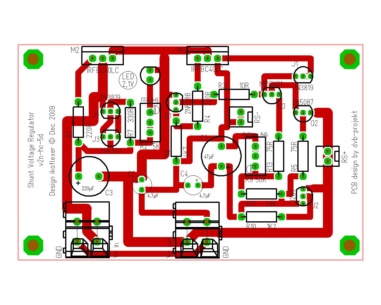

Hi ikoflexer,

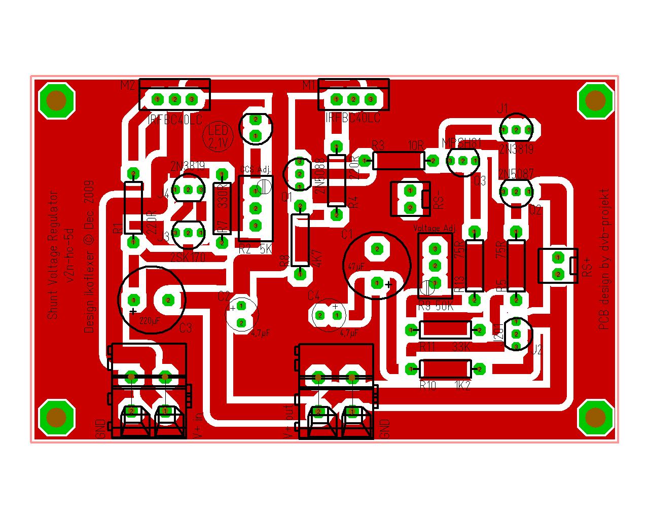

do you think the ground-plane version of my layout has HF advantages to the normal version? 🙄
HiFiNutNut replies, that C2 should be placed close to the MOSFET. On my board it is about 30mm away from M1 & M2. I hope this is close enough.

@dvb-projekt
If I see correct, RS+ (remote sense +) is connected to + output trace and RS-(remote sense -) is connected to GND trace?
@dvb-projekt
Yes, RS+ close to J2 and RS- close to C1.
I see nothing wrong.
I have read much feedback saying that the location of C2 and it's intrinsic ESR is quite critical to how stable the reg is.
Go back and read the feedback.
