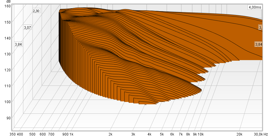

right there is a 3db efficiency increase when drivers are within 1/4 wavelength. I don't recall why this is true but I do recall it. Its built into HornResp for arraying
your first figure shows the (dreaded) lobing due to excessive driver separation. Interesting at 1/2 wavelength, there is no lobing but a narrower beam than at 1/4 wavelength separation. I think existence of a lobe would argue (very strongly 🙂) against the possibility of formation of a point source but I don't think absence of a lobe is a sufficient condition for one to form.
I agree that 1/4 wavelength separation is better than 1/2 wavelength separation but I don't see that as addressing whether or not <= 1/4 wavelength separation is necessary for a point source to form. I still find my argument involving the reflection null frequency compelling.

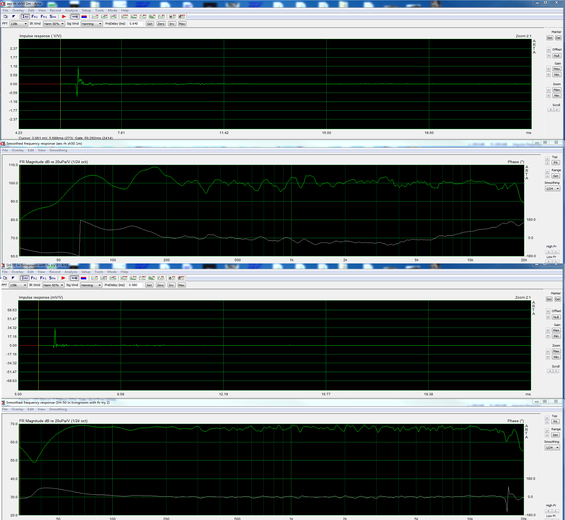

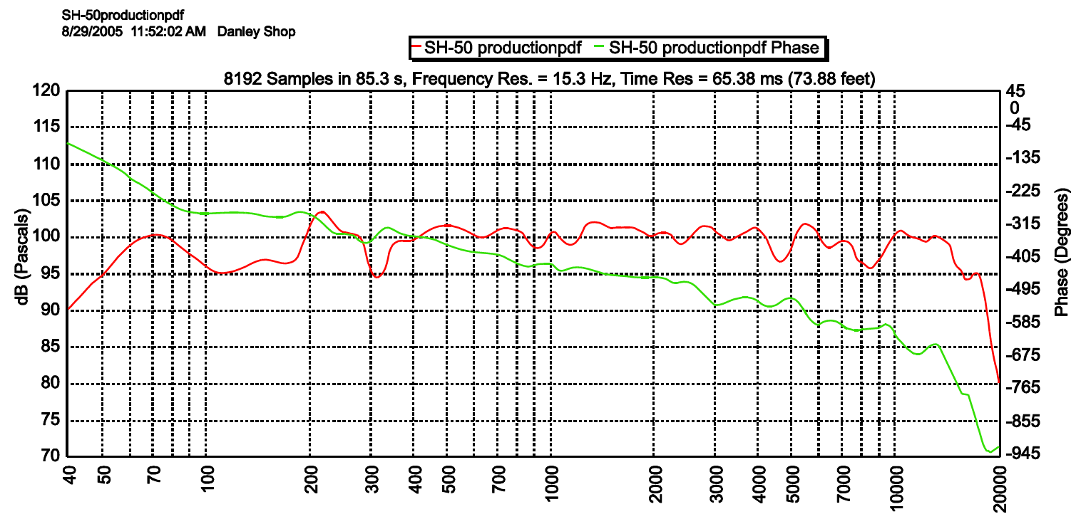

Yes lets forget those brickwall filters it was only thoughts and have to be tested if works well beside in being FIR DSP will cost some overall system delay.
About you got just about linear phase with IIR filters think that actual implementation had some errors and not only me that thought so, it was also pointed out by wesayso and Raimonds. Heart of that problem was probably trying to force (time step) standard textbook LR4 slopes to sum flat group delay doesn't work very good probably because actual group delay per bandpass change numbers inside its passband and Tom Danley also shared many times he doesn't use standard texbook XO filters. Over my head how Tom Danley XO but have seen in sims other slopes where change numbers in group delay happens outside passband and think something ala that scheme could be much better forced to sum with a suddenly time step. Suggest don't subjective use the previous wrong flat phase configured setup to judge how a correct linear phase XO will sound in long run.
Seen many mention SH-50 as linear phase but think its rather kind of relative flat nice strait line, in datasheet note phase scale is covering 900º, second attachment is Tom Danley share a Rephase exercise linearization for SH-50 at this link http://www.diyaudio.com/forums/multi-way/244508-monster-massive-23.html.

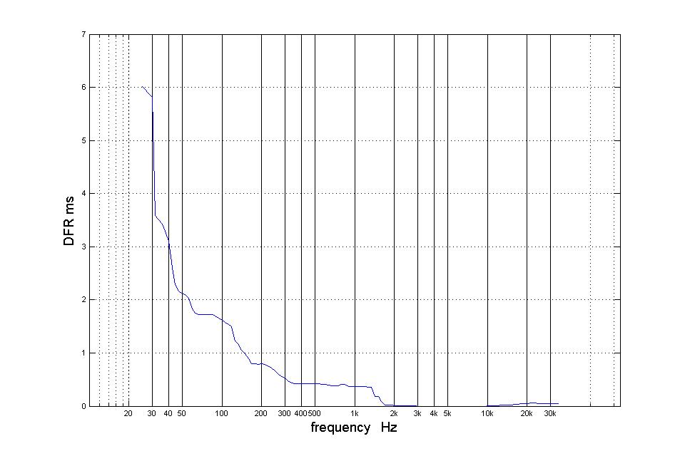

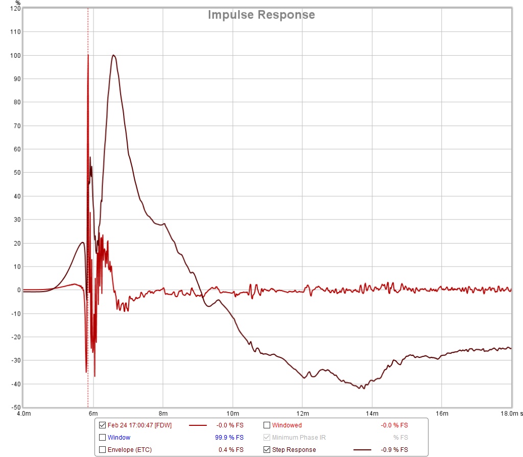

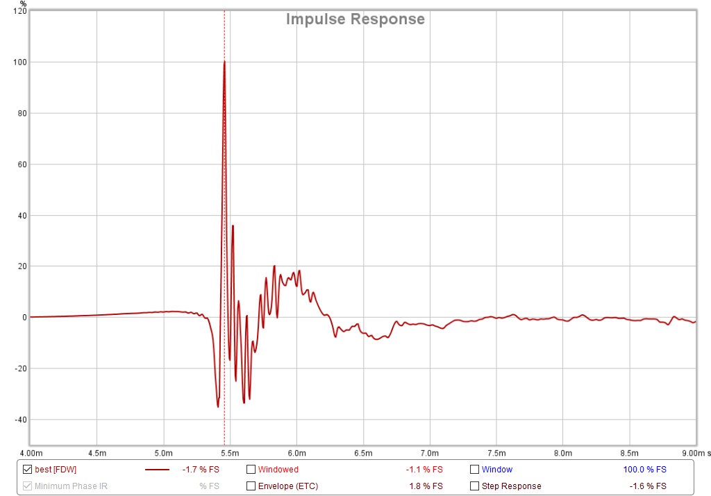

Here is a DFR that shows the time step. This pre-EQ DFR from a TDA_EQ measurement. TDA shows similar thing but couldn't find one easily.

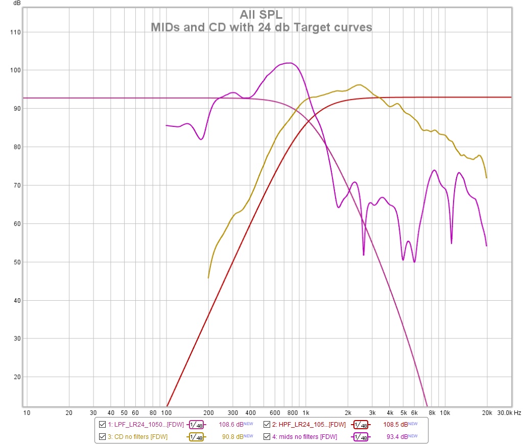

Let's take look at my latest measurements plotted against 24 db slope target curves. You see that I'm flattening the horn gain and bandpass peak of the mids so that they extend down to 200 Hz or so and that the unfiltered mid curve is above the XO target curve through the XO region. I've offset the curves so that the unfiltered mids and CD response cross at 1050 Hz, my new target XO.

.....What is this sudden time step you mentioned? If drivers are time aligned via DSP delay, there shouldn't be a time step when crossing from one to the other. If I have the CD and mids out of phase with each other than I would have a ~.5 ms time step. Curiously, that is what I see in TDA's DFR but not in the min phase subtracted GDR, which Raimonds says is the XO GDR.....

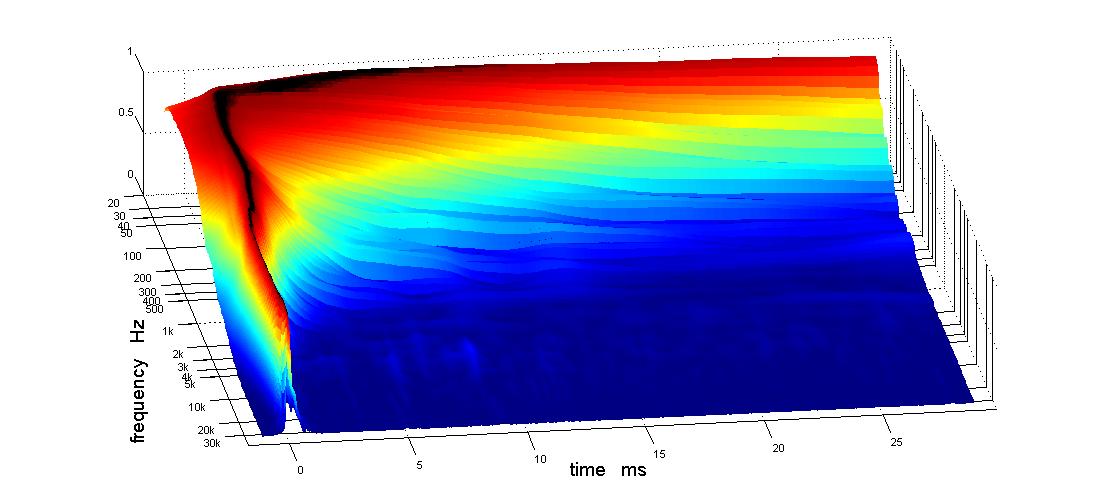

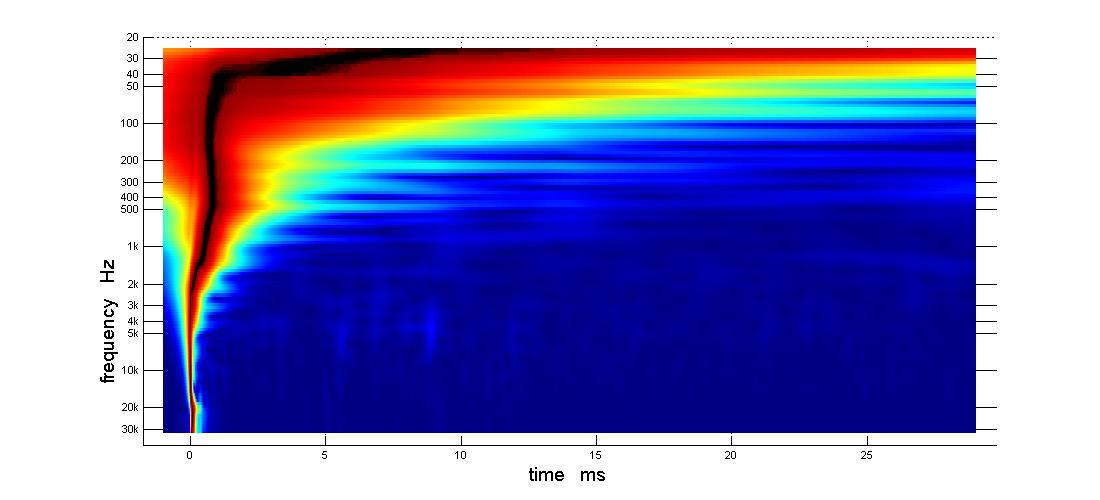

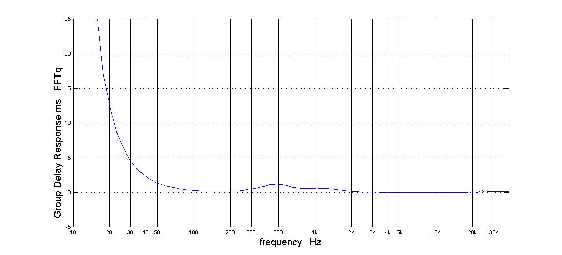

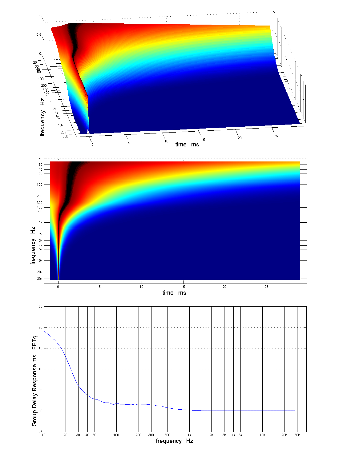

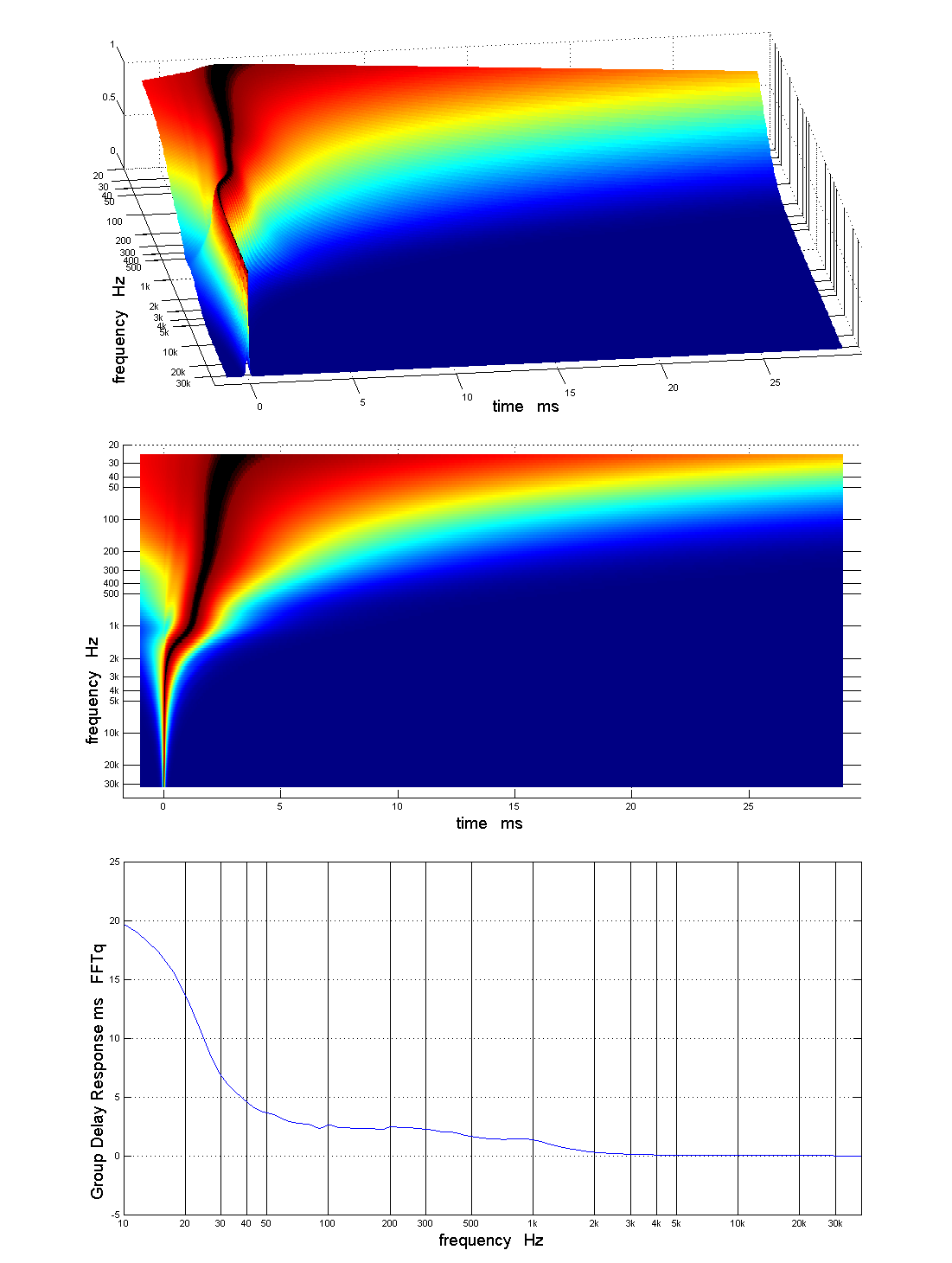

The suddenly time step is when taking the relative flat part from woofer and mid and force those two the about 2mS forward in time relative to tweeter when looking at how group delay the three band-passes are supposed to perform for LR 4th order slopes.
As example this plot show group delay the three band-passes each by each now take the one belonging to woofer and mid and time step forward relative to tweeter as the black handmade trace model, this gives nice flat phase and flat group delay althoug a tiny bumb in transition area. Doing this step in electric domain will cause error in amplitude sum for that specific LR slopes but in acoustic doamain probably more forgiving because of wide dispersion plus live room environment and other measurement design axis than strait in center.
I don't quite follow but I do recognize that so-called hand made trace. It looks like what TDA shows me as the 950 Hz 24 db acoustic XO GDR.
In this measurement, I was delaying the mids by 2.06 ms and the CD by 2.35 ms to align them with the woofer, which has about 2ms of horn path delay itself at its XO to the mids. In addition, I believe the CD is .17 ms behind the mids because of mid entry position on the horn.
Basicly with a known target scheme especially when measured in trusted nearfield acoustics should show same curve as syntetics or electric domain target curves would perform and say you at that time had the precise slopes at place then acoustic offset between drivers were off and stepped in time because else it had looked close to the syntetic texbook one, but in general think because that XO scheme was dropped after Raimonds gave advice and belong to past think no reason to walk over it again, lets look forward the new XO scheme and what it brings 🙂.

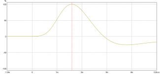

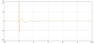

new XO
This XO has 48 db acoustic slopes on the mid/CD at 1050 Hz. I think the steeper slopes and higher XO frequency have helped the sound. I think I can do better on the woofer XO. It was a real struggle to stay close to the 24 db target slope and the ripple in the transition region shows it. The woofer really wanted to fall off faster. I should have let it do so.

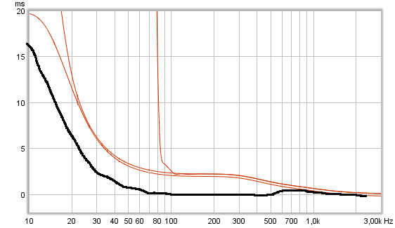

The group delay isn't much different than what we've seen before. The direct response line in TDA still bends but more gently than before:

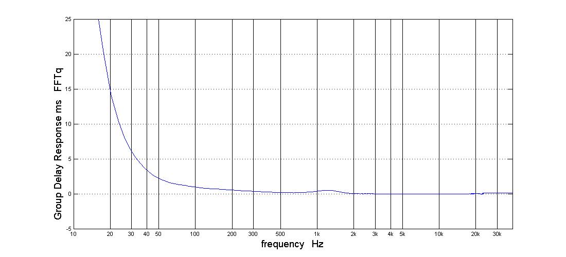

this is the group delay with min phase subtracted and thus the XO group delay:

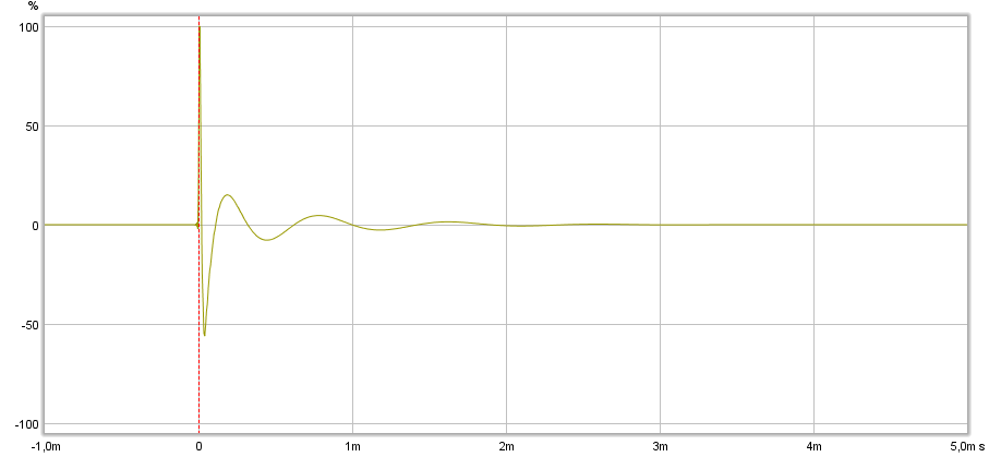

I swept the dsp delays through ranges around their final settings to be sure I had at least a local optimum. Here is the FR and phase that resulted.

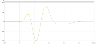

and the IR
I'm out of EQ resources for improving the above in the miniDSP 4x10 but have both APL1 and OpenDRC FIR engines for a next step.

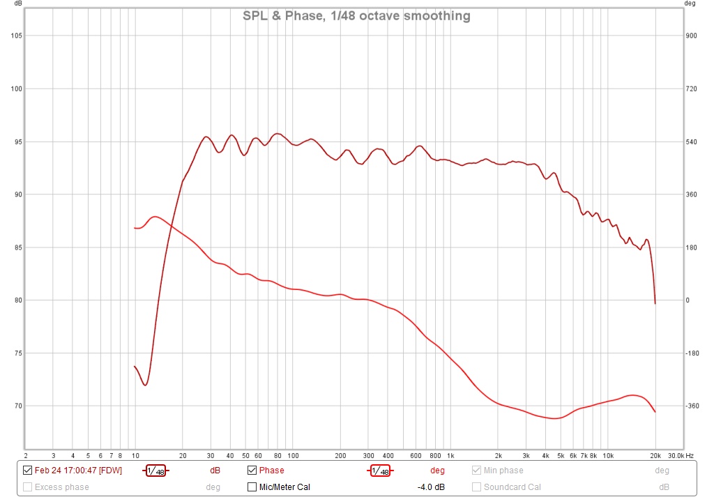

and the IR

Think APL1 can help with even more pro IIR correction and OpenDRC can linearize XO points, but before that next step take a look at phase which is supposed to turn 1080º by XO points alone plus 180º at each end of system stop-bands. So miss about 540º phase turn in your REW curve which indicate somewhere time step between pass-bands and/or also mismatched polarity can play a 180º wrong step role. Looking attack side of IR woofer fire too early indicated by step starts going more than numbers of 30 in negative direction, where negative direction should only happen at decay side of IR.
Think goal must be in miniDSP to get those acoustic centers perfect alligned and also rechecked for any polarity mismacth, then FIR correct the known XO point in OpenDRC and finally use APL1 to finetune anything left including a good tonal response.

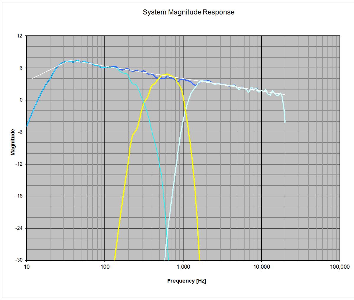

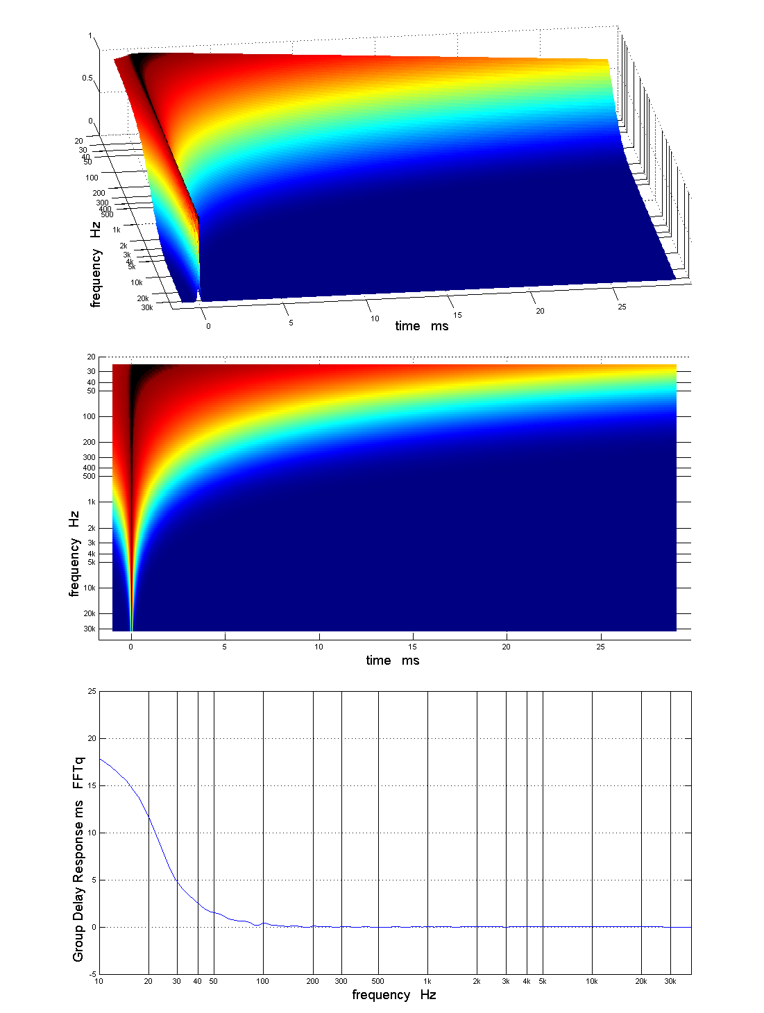

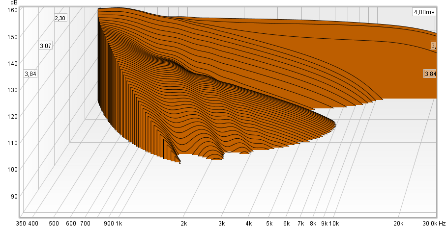

Models below use 15Hz and 20kHz as system stopbands and 350Hz LR4 plus 1050Hz LR8 as XO points with a B&K tonal curve. First is ordinary IIR XO points which give some delay that add some long tails high up in frq when viewed into waterfall plots, second is when 1050Hz point is FIR linearized and third have also 350Hz point linearized.
Points in previous post is don't add FIR before IIR system is alligned perfect and predict as such a IIR domain is supposed to perform, then adding the known IIR XO points some FIR correction will do the wonders and clean up waterfalls so that mids will perform beatifull decay, below is waterfall for the three models.

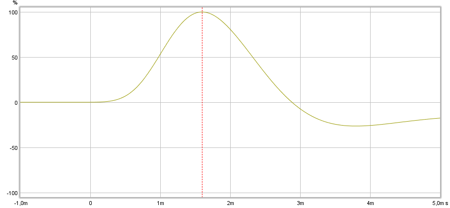

I was suspicious of the timing also. I hoped you would chime in.

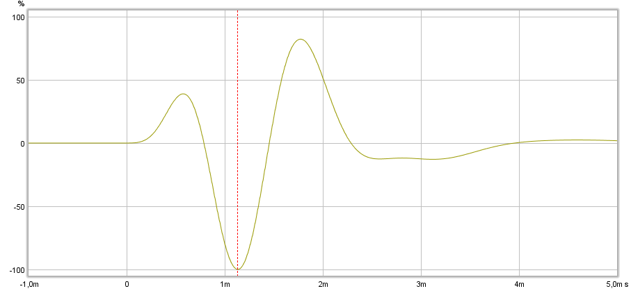

Looking through my measurements, I see REW was marking time at the midpoints of the first rise of the IR instead of the peak. Shame on me for not checking sooner. Mid and CD off by <.2 ms but woofer off by .89 ms. That might explain the woofer firing early but not the missing 540 degrees but it is a start.
Come to think about regarding having correct same polarity the three pass-bands is maybe bit difficult to check because no diagraph is visible and if actual filter in miniDSP end up as 2nd order it will electric reverse cone direction. So before any calibration for offset timing to ensure polarity is absolut correct suggest run system with speaker cable only connected for one band at a time using below IR figures as reference and then adjust if they happen be out of sync.
