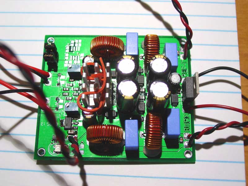

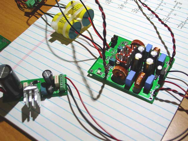

Here's a closer shot of the amp. Note the single 14V regulator whose output splits into three traces. An 820uF Panasonic FM cap is connected to a ferrite chip inductor that's connected to another 820uF Panasonic FM cap that's connected to the chip's supply pins for each channel; as well as a ferrite chip inductor connected to a 68uF Panasonic FM cap for the 14V driver input section.
The 5V supply uses an onboard low noise Micrel 5209 5V regulator with a 2.2uF ceramic cap on its input and a 120uF Panasonic FC cap on its output.
The inductors are the same as the ones used on the 41Hz amp3 and amp6 and the output filter caps are polypropylene film types. I used Auricaps as my off-board input coupling caps.
The input side of the board remains the same, although the PCB is slightly smaller and everything is quite snug. The sound is on par if not better than v1.0 even though the power supply and board layout are quite different.

theAnonymous1 said:Beautiful!!! Where do I submit my order? 😀
Thanks! I actually have two other boards almost complete that will be sent out to a couple people to demo before I do any sort of small production run. If their opinion of the amp is positive then I'll take the next step and see about pricing if I have about 50-100 made.
If you REALLY want one I can build one up for you because I have three boards left. BUT it will take me some time to get one built because I'd need to order more parts and find time to build them. Email me if you're seriously interested in one of these boards - an approximate price for one of my three remaining boards would be $120.

Well, so as not to keep everyone in suspense for too long, I will say that Im quite impressed with Brians design. Ive not done near enough listening to give any concrete discriptions yet, but I will say that my initial observations are that this is really an excellent sounding amp, with the best LF response Ive heard from a Tripath yet. The separate 5V supply completely eliminates the thump on problems and so far, it may have the best 3-D soundstage Ive heard. Very low noise it appears. Most notable is the detail in very complex compositions. The separation of instruments and the decay of strings is wonderfull!!
But I dont want to commit to too much until Ive really put in some time with this amp and have a better handle on its exact performance qualities. Being giddy with new toys can sometimes steal away ones objectivity.

BTW Brian, the SMD LED on the board is a nice touch. Nice to know theres DC on the board once the PS is turned on.

Got the amp today, am listening to it now - Steely Dan.
Well.... This ain't your grandmother's Sonic Impact!
Very strong, good bass, lots of low mid. Plus all the detail of the Tripath chip. It sounds as good on Latin music too.
Good work BWRX!
What 1st impressed me about the amp board was how well it is made. Beautiful work. From now on we will just refer to BWRX as "the Robot". No human should be able to solder SMD that well. It just isn't possible. And those inductors! 😀
I'll be listening to it more over a couple of weeks- unless Brian wants to sell it. Will give my impression vs. other t-amps. So far, I agree with AMT above. Sounds as strong as an AMP6 with maybe more channel seperation.
