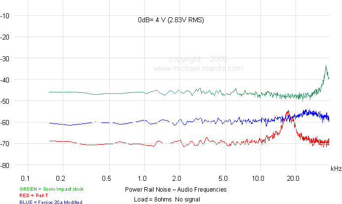

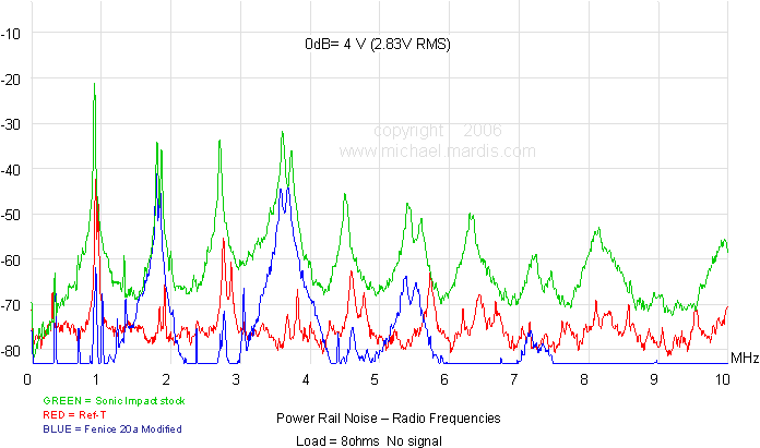

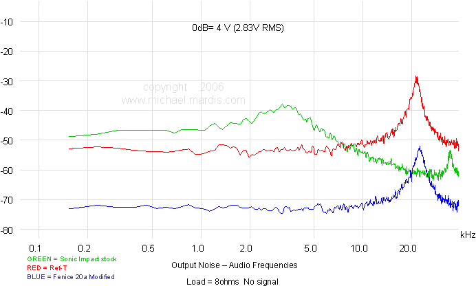

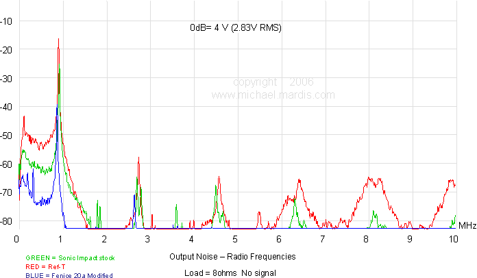

I did some measuring and spectrum analysis of the Ref-T and 2 other T-Amps this afternoon. I will post graphs as soon as I can get them into a usable format.
Not surprising is that the power supply rail of the Ref-T is the cleanest of the 3 tested. What was a surprise is that the Ref-T had the highest output noise of the 3. Highest in both audio and radio frequencies.
That is with the amp at idle, no input signal. Things will change a bit when the amp is under load. I'll do that testing tomorrow.
Amps tested were: the Ref-T, a modified Fenice 20a and a stock Sonic Impact 5066.

panomaniac said:Not surprising is that the power supply rail of the Ref-T is the cleanest of the 3 tested. What was a surprise is that the Ref-T had the highest output noise of the 3. Highest in both audio and radio frequencies.
The power supply rail better be clean! The two Panasonic FM caps with a ferrite bead between them are meant to keep a lot of RF junk from getting back to the regulator as well as provide a stiff voltage rail that can handle large transient current demands.
I can think of a couple reasons why the Ref-T would have more noise. First would be the output filter. It uses 10uH inductors and 0.27uF caps which are smaller than the nominal 0.47uF that most T-amps use. This raises the cutoff frequency of the filter and changes the Q as well. The other reason could be the ground plane. Switching currents could be flowing where I didn't want them to... That means there's still room for improvement! What's interesting is that I don't hear any noise when the amp is hooked up to my speakers and idling unless I put my ear withing half a foot of the drivers. That's just as good as any of the stock SI's or amp3's I've used.

I agree with Brian, the output filter may be the trouble on the output noise. But there is noise down in the Audio spectrum, too, where the filter should not have an effect.
That said; the amp is VERY quiet. Just want to show some measurements for comparison sake, and for Brian's amusement.
Let’s start with the output at audio frequencies. Click below. From this we can see that the Fenice and Ref-T have a similar noise signature, but the Fenice is 20dB lower. The Sonic looks different.
This graph shows left channel only. On the right channel the Ref-T had its noise bump lower, at about 13 kHz.

All the measurements above were taken with a PicoScope digital scope.
You will see that 0dB is referenced to 2.83V RMS. Why?
2.83V RMS into 8 ohms is 1 watt. I used that reference because it is the standard used for speakers. This will give you some idea of how loud the noise might be on your system, whatever the sensitivity is.
This is NOT a S/N ratio. To get a good idea of that, you would need to drop at least 6dB, possibly 9dB. It would depend on how much signal each amp can put out before clipping..
