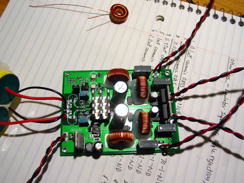

Tonight I hooked up the amp using my beefy (for amps of this power level anyway) linear supply consisting of a 120VA Plitron toroid with 15VAC secondaries, an IR 25A bridge for each secondary, and a 22000uF Panasonic cap in parallel with a bleeder resistor and a 0.1uF Panasonic polypropylene film cap for each secondary. It puts out a rock soild 23.5V to my twin LT1085 regulators (set to 14V) for each output channel; the regulator for the one channel also powers the 14V analog driving section. A 12VDC 1.5A unregulated wall wart transfomer supplied DC voltage to my LMS1585 regulator (set to 5V) for the 5V analog section.
All I can say is that it works and sounds fabulous. There's a bit more detail and the soundstage sound a tad wider than before. I can't tell if it has more clean power because I don't want to play it too loud right now.
The power supply setup I'm using is most definitely overkill but that was all part of the experiment. Despite what Tripath said about using separate supplies, the Ref-T v1.0 board seems to work quite well but more testing is needed to see how it fares under differing conditions.

Finally, here's a photo of the Ref-T with output caps next to my "beater" AMP3 for comparison.

Cool,
I especially like the heat sink attachment method. 😉
Weren't you going to put regulation onboard? Or is it there and I don't see it?

Looks great, Brian! Good to hear it sounds promising (as it should). Looks like a winner.
I second the praise for the heat sink attachment. Special audiophile elastomeric properties, I assume? 😀
All of the regulation will be onboard as soon as I receive my Digi-Key shipment 😉panomaniac said:Weren't you going to put regulation onboard? Or is it there and I don't see it?
Thanks! Yes, the audiophile elastomeric band was the heatsink attachment method of choice since I ran of thin double sided tapeserengetiplains said:Looks great, Brian! Good to hear it sounds promising (as it should). Looks like a winner.

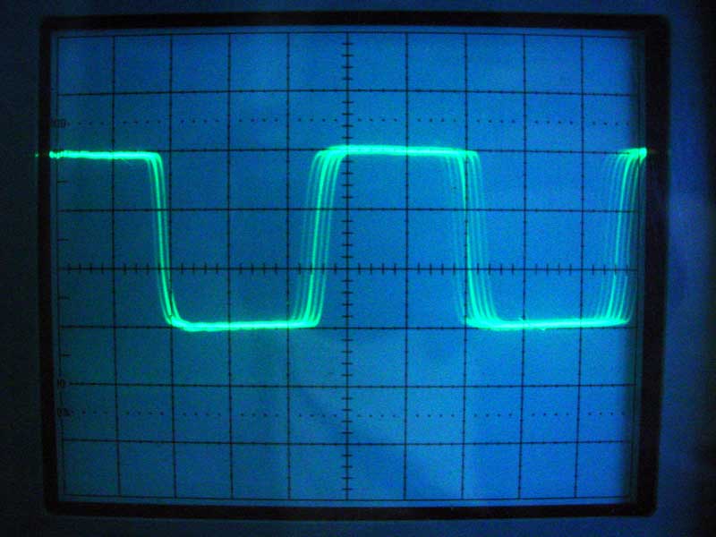

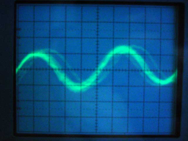

I've been probing the amp with my oscilloscope and found some interesting things. The waveforms look nice and clean and almost look overdamped. That may be because I'm using my actual speakers as the load instead of an 8ohm resistor. There is a 200mV (100mV from each output that are 180 degrees out of phase) 1MHz (exactly) residual signal that rides the output waveform regardless of the signal being amplified or the level of amplification. For this measurement I have two probes hooked up with the grounds at power ground and the probes at the output of one channel and the scope set to differential mode.
Michael or anyone else - have you seen this when probing around your amps?
I'll try to take some pics of the scope so you all can see what's going on.
Here's the switching waveform while the amp is idling. 5V/div vertical, 0.2us/div horizontal.

That residual just looks like the switching sqaure wave after filtration to me. Isn't it?
Your full blast square wave above looks mighty clean, no ringing. Never seen that before. But I always scoped on resistors, not drivers. Will try the with drivers and report back.
You have both the L and C in the filters now, right?
Hmm, I posted the horizontal scale wrong for that first photo. I thought I measured it at 0.5us/div. But yes, I thought it was just the switching frequency after the filter but was confused about the different frequency. I took my measurements at the output diodes before the inductors.
Brian, I think you need your morning coffee.
The 1st waveform is the square wave before filter, 5V/div. is right.
2nd is the waveform after the low pass filter. Both are the same frequency, as far as I can see.

Ah geez! I had mislabeled the horizontal scale in the first photo because when I took the measurement it was at 0.5us per division. But I looked in another photo I took and saw that the little red 1X-10X knob was tweaked off center... yep, that'll do it. Gotta love these old analog scopes! In conclusion, you are correct 🙂 and I will get that coffee soon!
Yes, the amp has the 41hz toroids (I measured them to be 13uH at 100kHz), 0.22uF film caps to ground, the Tripath recommended zobel/snubber, and 0.01uF differential cap right where the output wires leave the board.

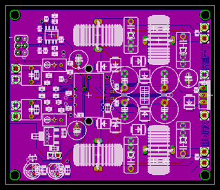

This latest version (v1.2) is different from the first version (v1.0) in a few different ways (v1.1 was an iteration of v1.0 that was scrapped when I started v1.2). The key differences are in the power supply components and layout. There are only two on board regulators now. One for the 14V sections and one for the 5V sections. There is room on board for 4 supply caps with space for ferrite beads or inductors between the caps. This should provide good filtering for the each output channel and will help to keep them more separate from one another. The 14V driving section also has a ferrite bead and an electrolytic cap for filtering. An electrolytic cap was also added to the 5V supply section. The overload status LED circuit was removed from the board and the fault and power LEDs are now driven from the TA2021B internal 5V regulator instead of the 14V driving supply. Room for small film input coupling caps was made on the input side. The board layout changed dramatically on the output side but remained largely the same on the input side.
I'll let ya'll know how it sounds when I get one built in a couple of weeks.
Oh, the attached image should be the actual size of the amp.
