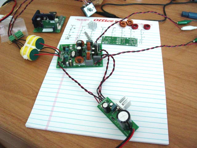

She's alive and playing music! The replacement opration was tricky because the large caps are so close to the chips pins but I did it without melting the caps' sleeve too bad.
This time I have the 3 regulators of the Ref-T hooked up to a single regulator that's powered from my large linear supply. The overload light came on when I first powered it up and I said oh sh!t, but when I unmuted the amp the light went off and I was relieved.
I had to readjust the DC offsets - they're now 0.07mV and -0.03mV 🙂 - because I adjusted them before I replaced the chip, but that was it. She's sounding good again. Can't wait to see how the new boards compare to this one. Expect to see some info on the new boards in about a week.
That's a UCD180 module in the top left corner of the photo. I still need to fix that too...
