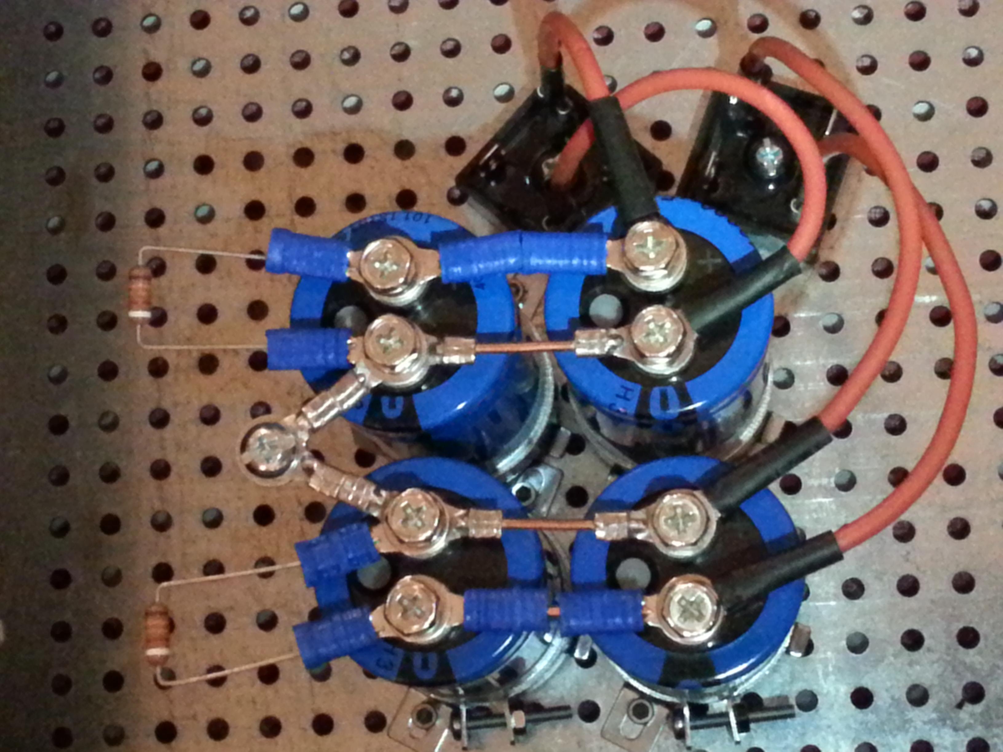

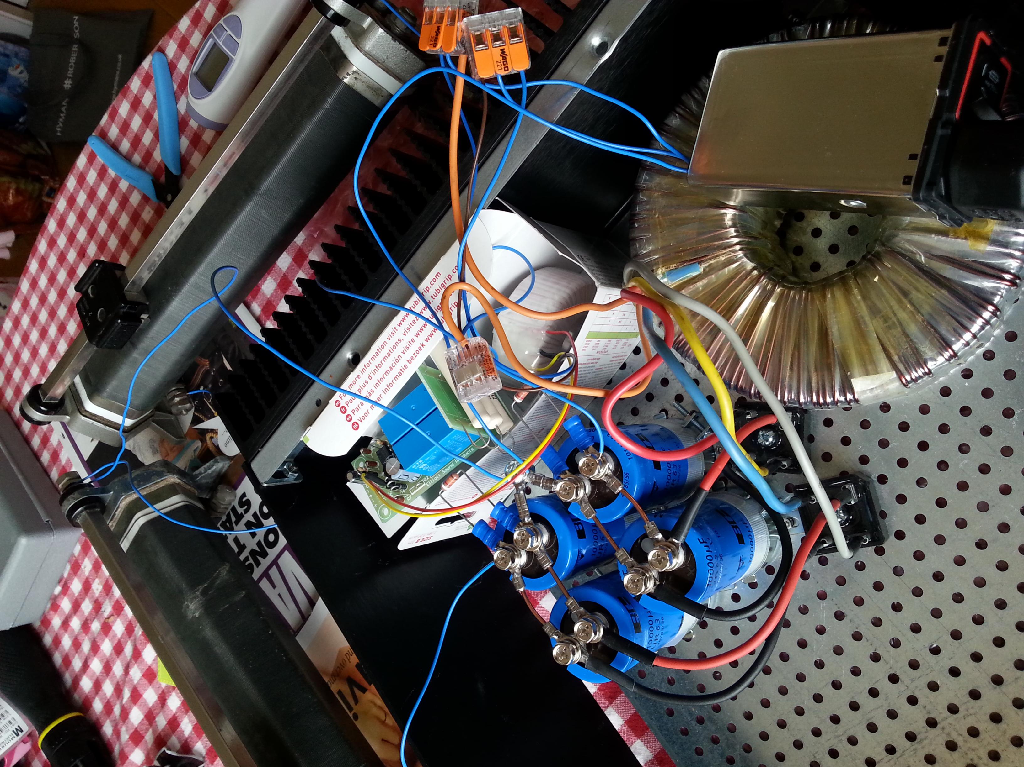

I'm using GBPC3504W, one for each power rail. Measured loss (AC-DC) = 2.74V.
Hi Calpe. I know the specs but I can't really explain why my DC is 2.7V less than AC x 1.414.
It must be 2x diode drops of approx 1V, and another 0.7V lost... somewhere... between the bridge rectifier and first capacitor.

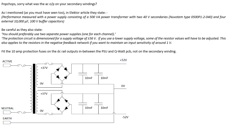

Taken from the article:-
Power Supply (for one amplifier)
Power transformer: sec. 2x40V, 500VA (e.g. Nuvotem 0500P1-2-040 for 230 VAC mains)
Bridge rectifier: 200V, 35A (e.g. GBPC3502) (Fairchild)
Four 10,000μF, 100V electrolytic capacitors (2 in parallel on each supply rail)

Yep thanks ICG. I did some more testing and more reading. Seems like my rectification losses are closer to 3.1V per rail... so thats say 2x 0.9V diode drops plus another 1.2V dropped somewhere.
If I was using a single bridge spanning both rails then I guess each rail only pays 1x 0.9 diode drop. Might be worth remembering if I need to tweak up the voltage later.
But where / how am I losing the other 1.2V at idle?

1st: Change to the one bridge design that calpe shows.
2nd: Get rid of these fuses at the secondaries. Remember your big filter capacitor(s). The larger the value, the shorter the charging pulses, the bigger the charging currents per pulse. These fuses, together with their holders, ad substantial ohmic losses!
Best regards!
Best regards!
Calpe's circuit would result in lower diode voltage drop, but I think the dual-rectifier circuit will be quieter. I need to choose a transformer that will allow me to try both configurations - thats why I'm checking the losses. Should be only 1 diode drop difference per rail.1st: Change to the one bridge design that calpe shows.

Your transformer is already prepared. Just connect both secondaries in series and user this connection as C.T.I need to choose a transformer that will allow me to try both configurations - thats why I'm checking the losses. Should be only 1 diode drop difference per rail.
Is it true too that each bridge handles less power? Reduced workload?
No. Because each bridge in a dual arrangement handles the same current as in a single one, and diode Drops are the same, too, losses per bridge remain constant, i.e. double loss by two bridges.

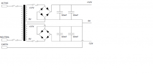

Hi Calpe,
I'm currently using a 625VA ILP toroid with 2x 35V secondaries, 5% regulation. At the moment it's connected directly into the bridges, as shown in my circuit diagram hence each bridge handles 35V AC. If I connect as in your diagram, then only one bridge is needed and output is 0.9V higher but the bridge is connected to 70V AC.
I need a slightly higher DC output than can be obtained with this old 35V tranny and I want two independent transformers (as per the otherwise dubious Elektor advice - their 230V/40V transformer suggestion gives >60V in the UK). So the plan is to use 2x 240V/38.5V transformers, each with dual secondaries, each secondary driving its own rectifier. Maximal independence. Aiming for 55V nominal DC output.
I will install my 10A fuses between caps I think... providing the resistance is <20 mR.

Hi Calpe - the new transformers will have a higher voltage AC secondary winding. Planning 38.5V instead of my current 35V. So then I would get approx 55V instead of approx 49V (at low load).Therefore, to get a higher d.c. you would need a higher AC supply.
DC = AC x 1.414 - 3.1V (using dual rectifiers)
DC = AC x 1.414 - 2.2V (using single bridge rectifier)
(Remember that transformer AC output at idle is typically 5-7% higher than at max load).
