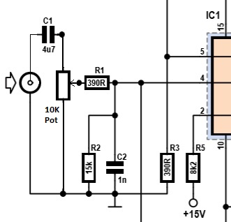

Level input pot
Correct diagram for level input pot

Many devices use a very high output signal today. The "standard" seems to have evolved to 2 volts for 0 dB. As you have seen in the specs, the Q-Watt amplifier input sensitivity is 0,88 volts for 137 watts (0.1% THD+N).
This means that you would need to use an attenuator in the chain in order to keep the amp in its safe area. That's why I have built in a potmeter to adjust the level (volume if you like).
If we do some more math, we'll see why Elektor chose this given voltage gain: For 220W @ 4 Ohms input sensitivity calculates to 0.771mV, which is very close to the standard 0dBV sensitivity (1mW = 0.775mV/600 ohms). For home use, I'll try to increase the value of both R1 and R3 to 510 ohms to achieve a sensitivity of 1V @ 220 watts. This requires some care, 'cause stability may be affected. Thus it demands some measuring tools (function generator, oscilloscope...).
Best regards!
The 775 mv used to be a standard many ages ago. Today the standard is more like 2 volts;... all modern devices such as DAC's, CD players, etc output 2 volts @ 0 dB.
I prefer not to temper with those resister values because as you rightfully state that stability might be afected. It is a lot easier (and safer) to use attenuators. This way stability is not influenced.
As said before, I do not recommend tweaking the closed loop gain to everyone, especially not to those who don't own a precise square wave generator and an oscilloscope.
I'll ty it anyway. Maybe an attenuator will be demanded additionally.
