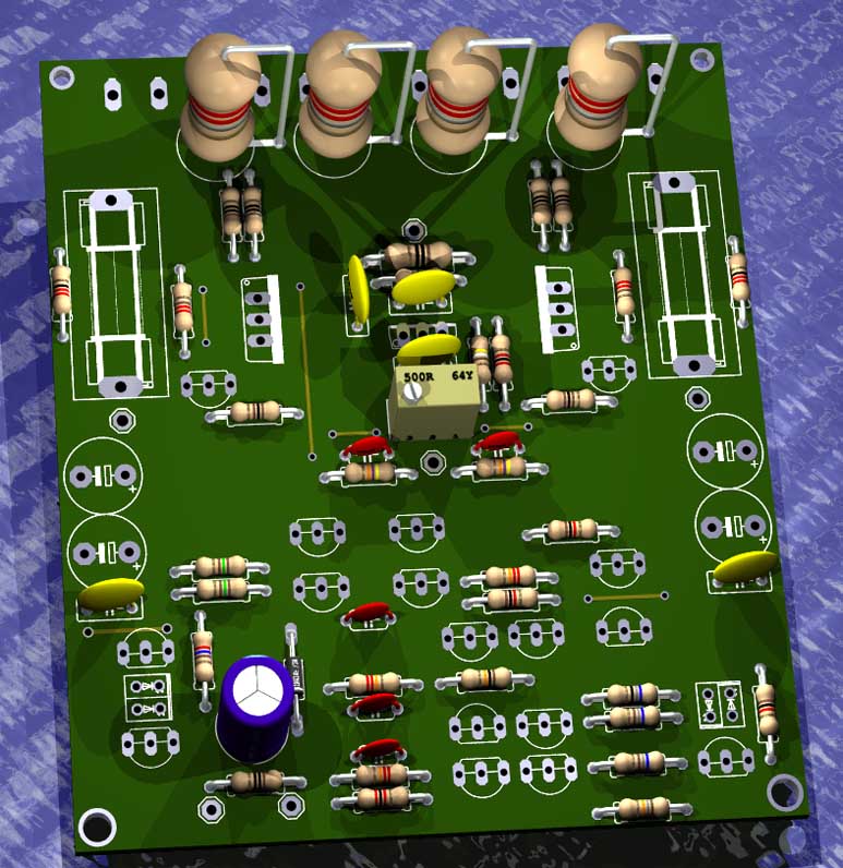

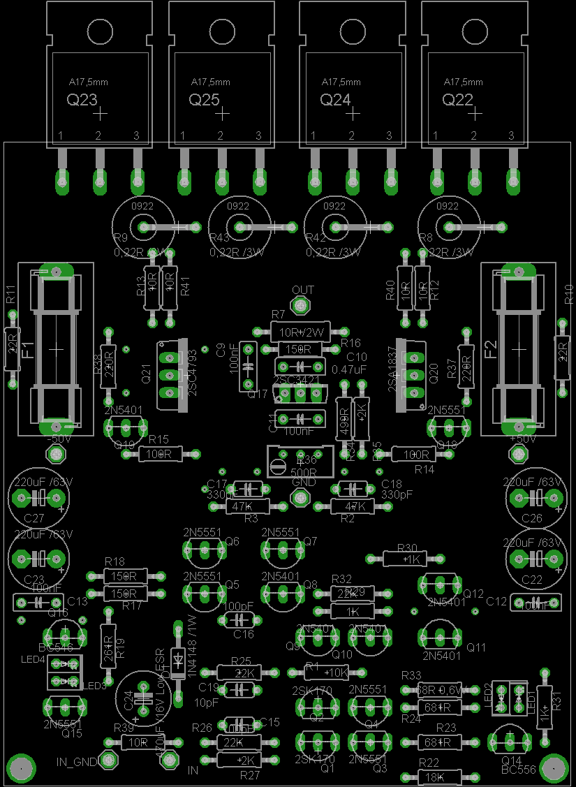

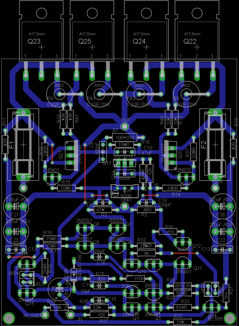

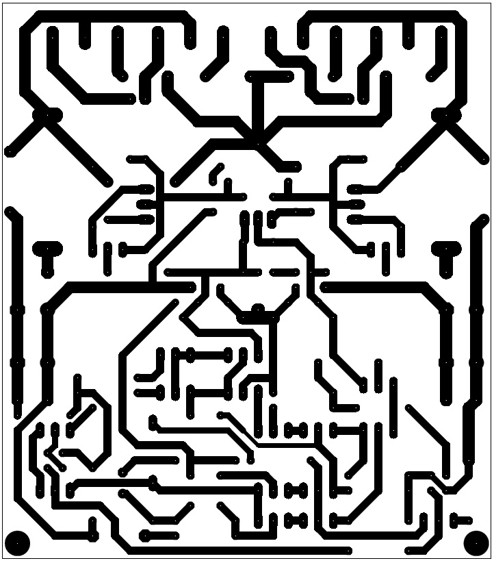

Hi, this is my first post in this forum. I am DIY entosiast, and i dont understand from schematics. I had build about ten amplifiers. All of them are from the internet and forums. I read the theme's of Roender for RMI-FC100 and i wanna make this amplifier, but it is expensive for me. Hard to find that expensive output transistors and match them. I like very much scheme's on AAK, and i have almost all the parts to do that. I made my own design of the board. The board is single side (easy to make by photo method). The dimension on the board is 80x90mm. It doesnt include the PSU. I place the psu on my designs close to amplifiers PCB, and with good ground wiring i dont have problem with hum or noise. I draw the schematic and design PCB for one day, thats why i need to check all for errors. If all is right i will continue with making the PCB.
I use Eagle 5.9. I will post pdf with shematic, and pictures on the PCB. If i make the amplifier and i am sure that the PCB is correct, and AAK allow me, i will load the PCB for making, who wont it. I apologise for my bad english.
Cheers, Christo!

No. Simply connect IN_GND to the lower end of C15 (SG).the input ground point is at the wrong end of the 10 ohm resistor
GND is correctly shown at the bottom of R39. In this schematic GND is actually PCB Power Ground (PG).
However, check the GND connection of the base of Q8 & R2+R3 & C17+C18 & R32.
It may be that performance could be improved if this GND were not on the PG.
Could it be moved to SG?
