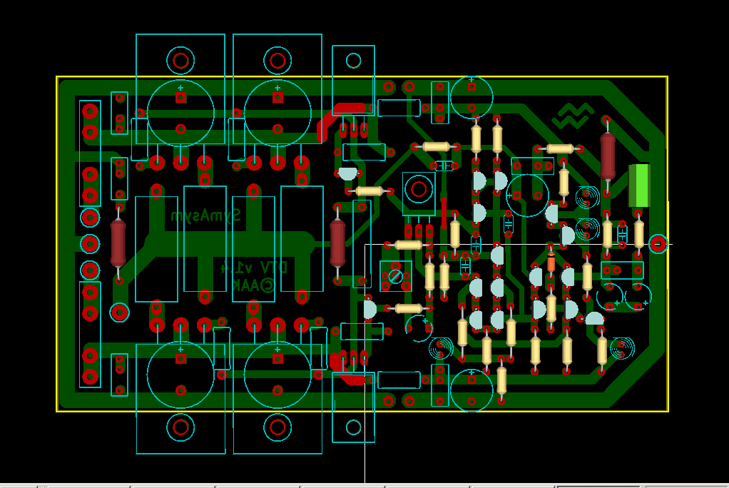

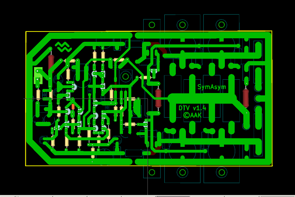

Another option PCB
Yes, i like to design PCB.
My PCB version of AAK's DTV rev_1.4 amp. May single layer PCB, friendly for DIYer.
Not Builded yet! may error, please double check if interest to used it.
PCB files on KICAD format.
- My new SymAsym PCB design Rev_1.3
