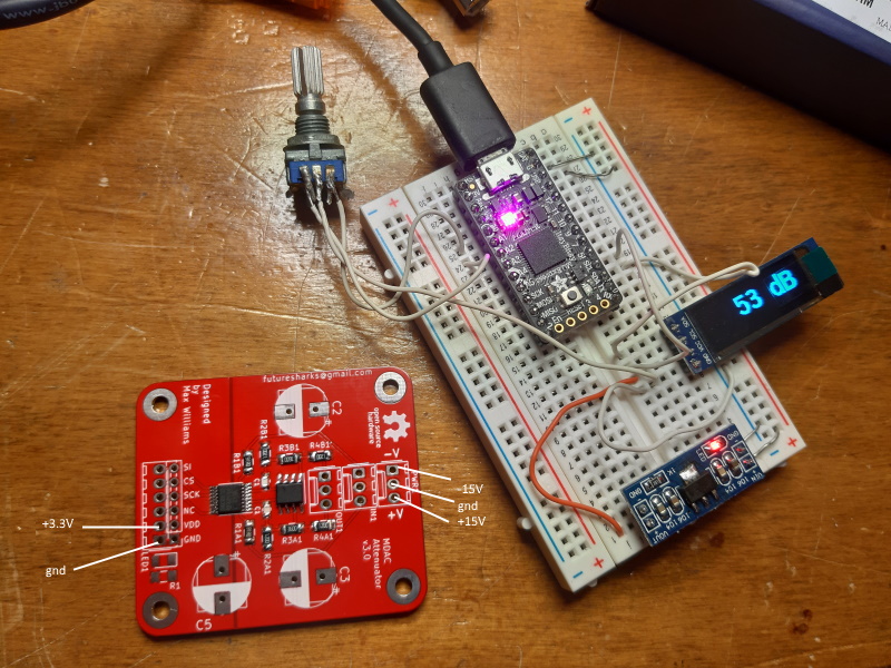

Is this correct ?
Is correct this power supply connection and values ?
see photo
The my Arduino M0 during the test have lost the bootloader so I have used a STM32 module to control the MDAC with SPI.
Good result also in the first measurements without the power supply by-pass caps
Vin 1.5Vrms
Vout 6Vrms at 0dB with 0.0047% thd
-10dB with 0.0073% thd
-20dB with 0.0055% thd
