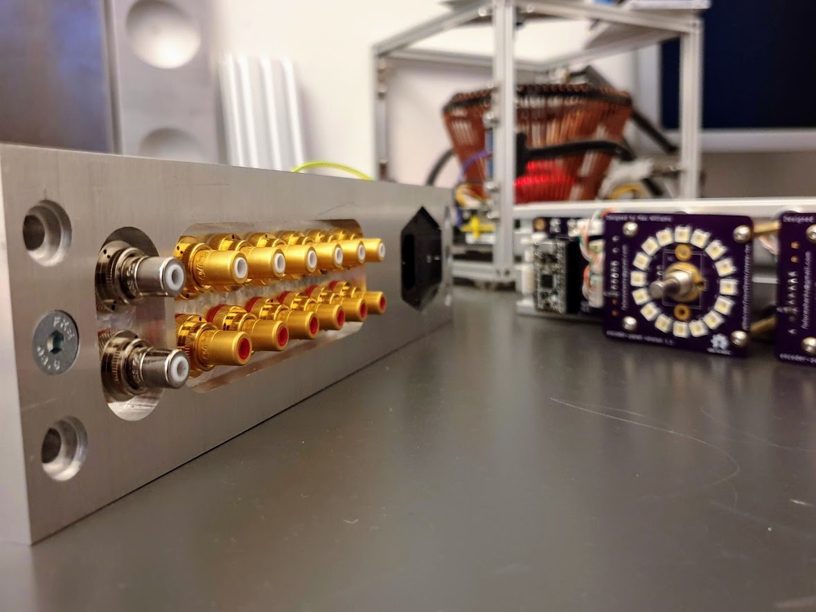

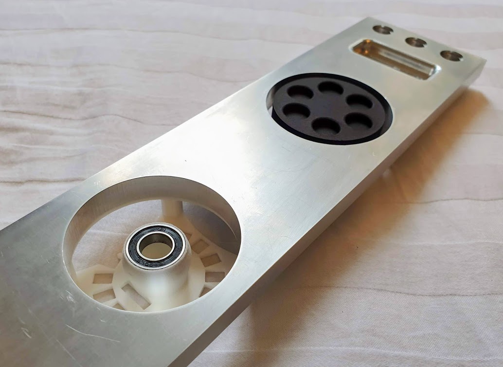

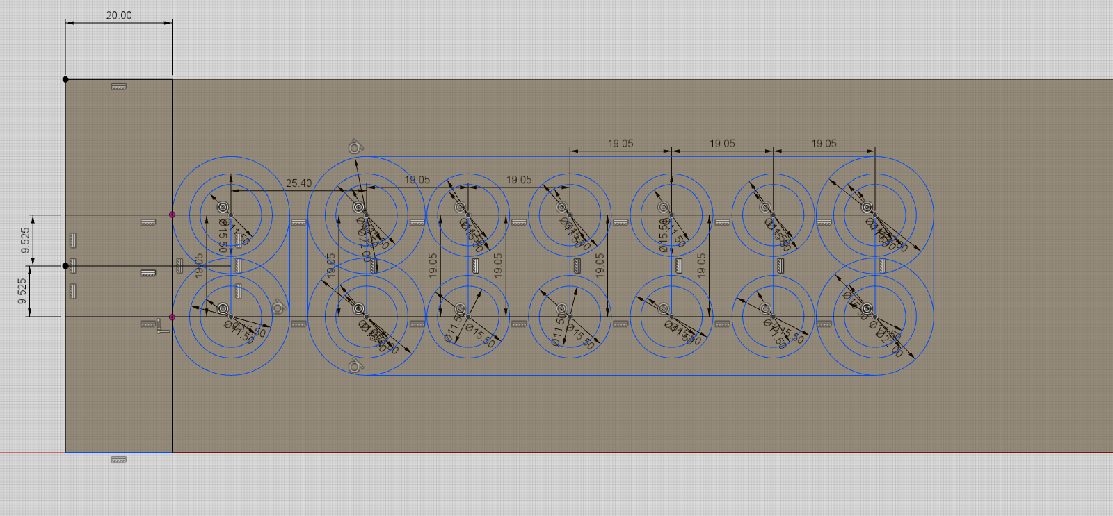

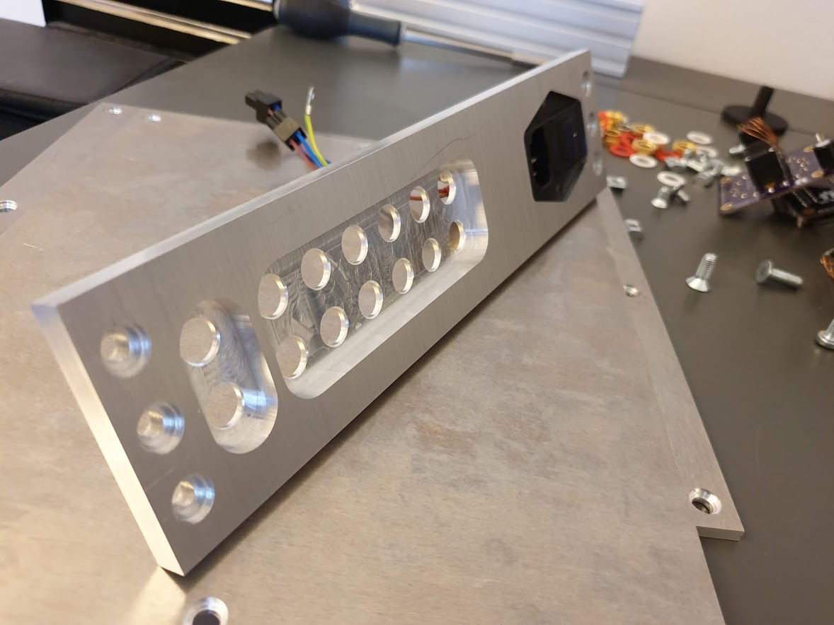

Finished machining the rear. No working on mounting it all together and the software.

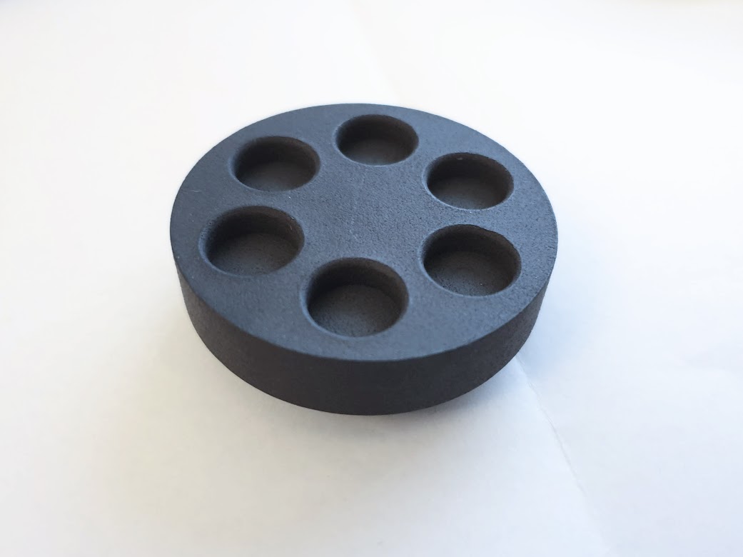

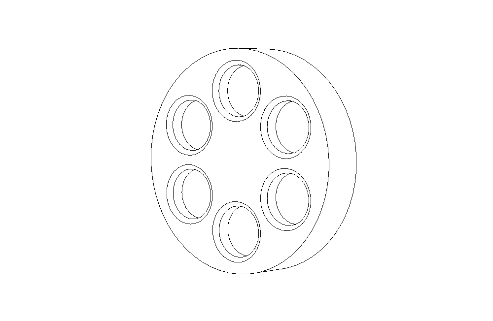

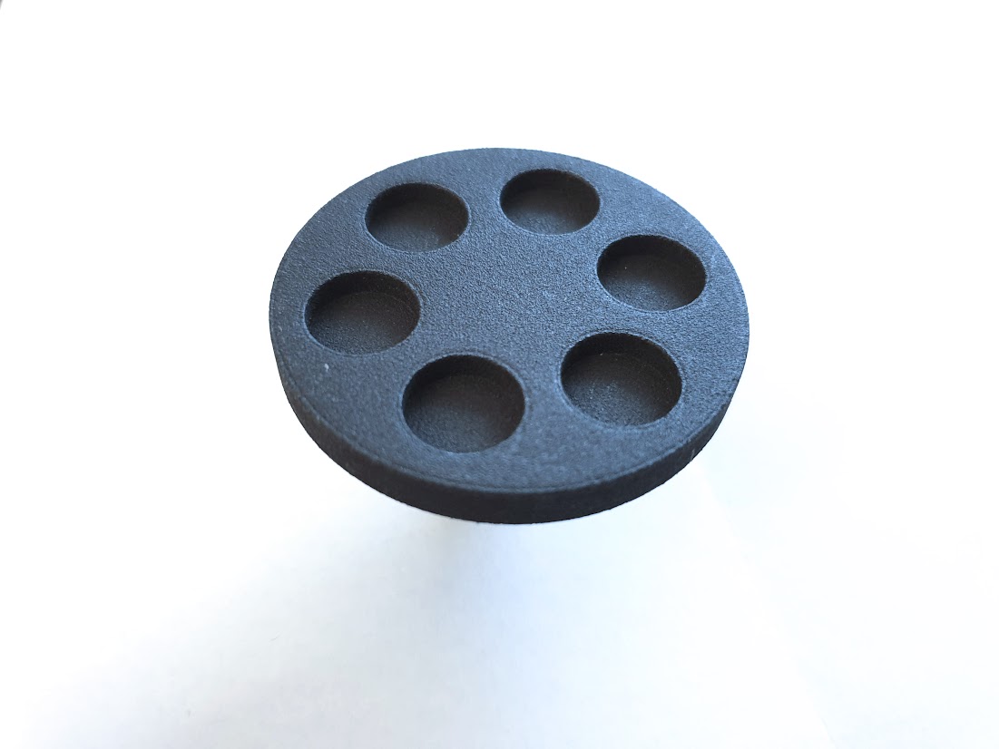

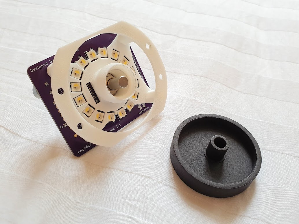

This was my prototype knob ordered from Shapeways in Black Natural Versatile Plastic. This cost about 12 EUR.
I love Shapeways, it's such a great service. There's definitely cheaper services but the finishing quality usually worse in my experience.
I had a problem where the 3d printed knob would not rotate perfectly straight when mounted onto the encoder. So I designed a bracket to hold the PCB, encoder, a 6800 bearing and the knob all together in one unit. The knob press fits into the bearing. Now it turns completely straight. Even when pressed with force.
The bracket was also printed by Shapeways.

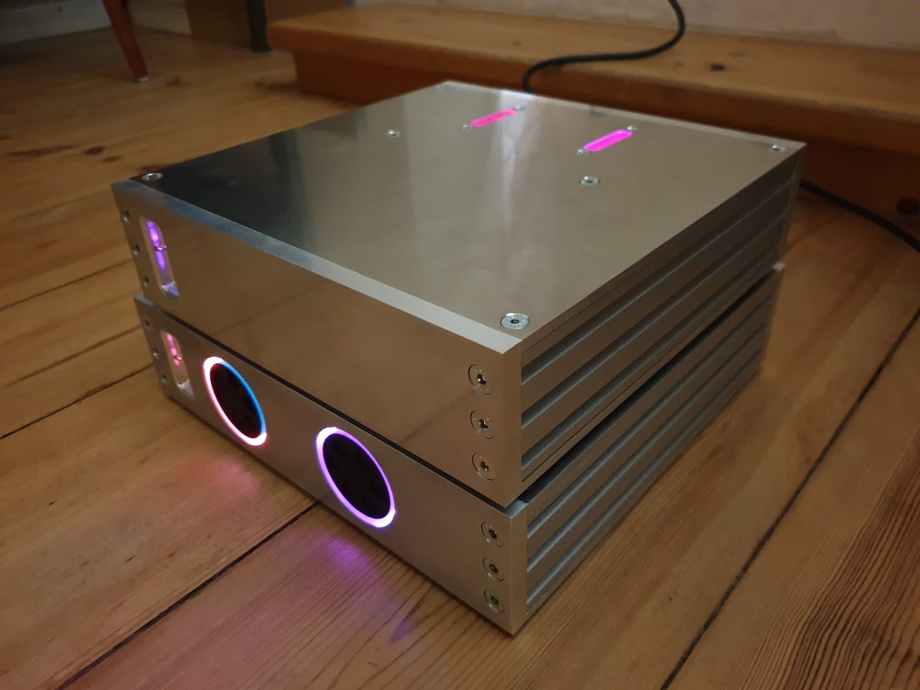

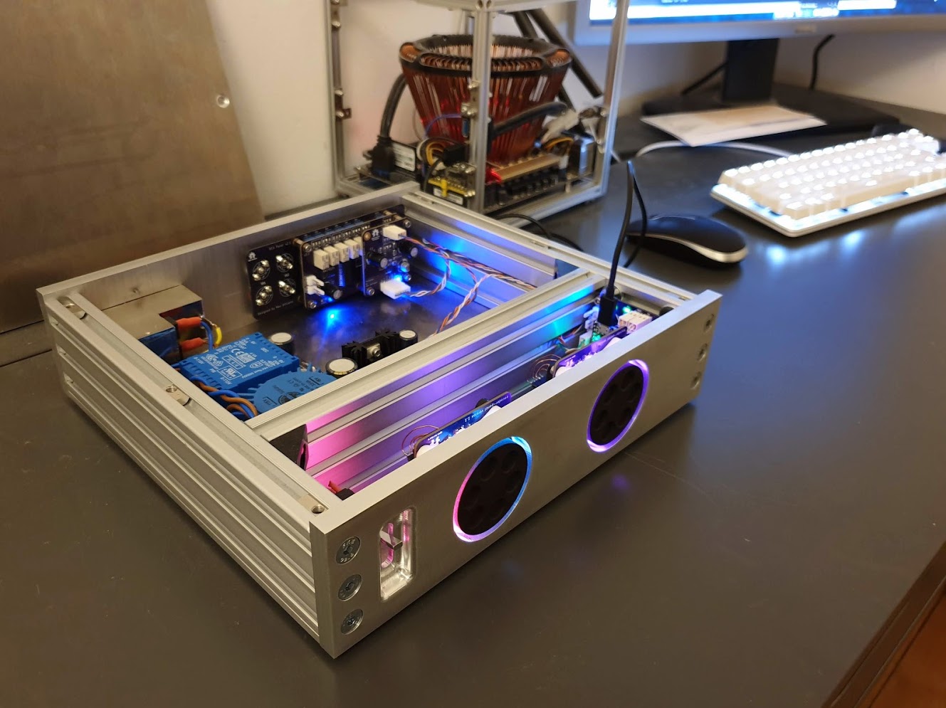

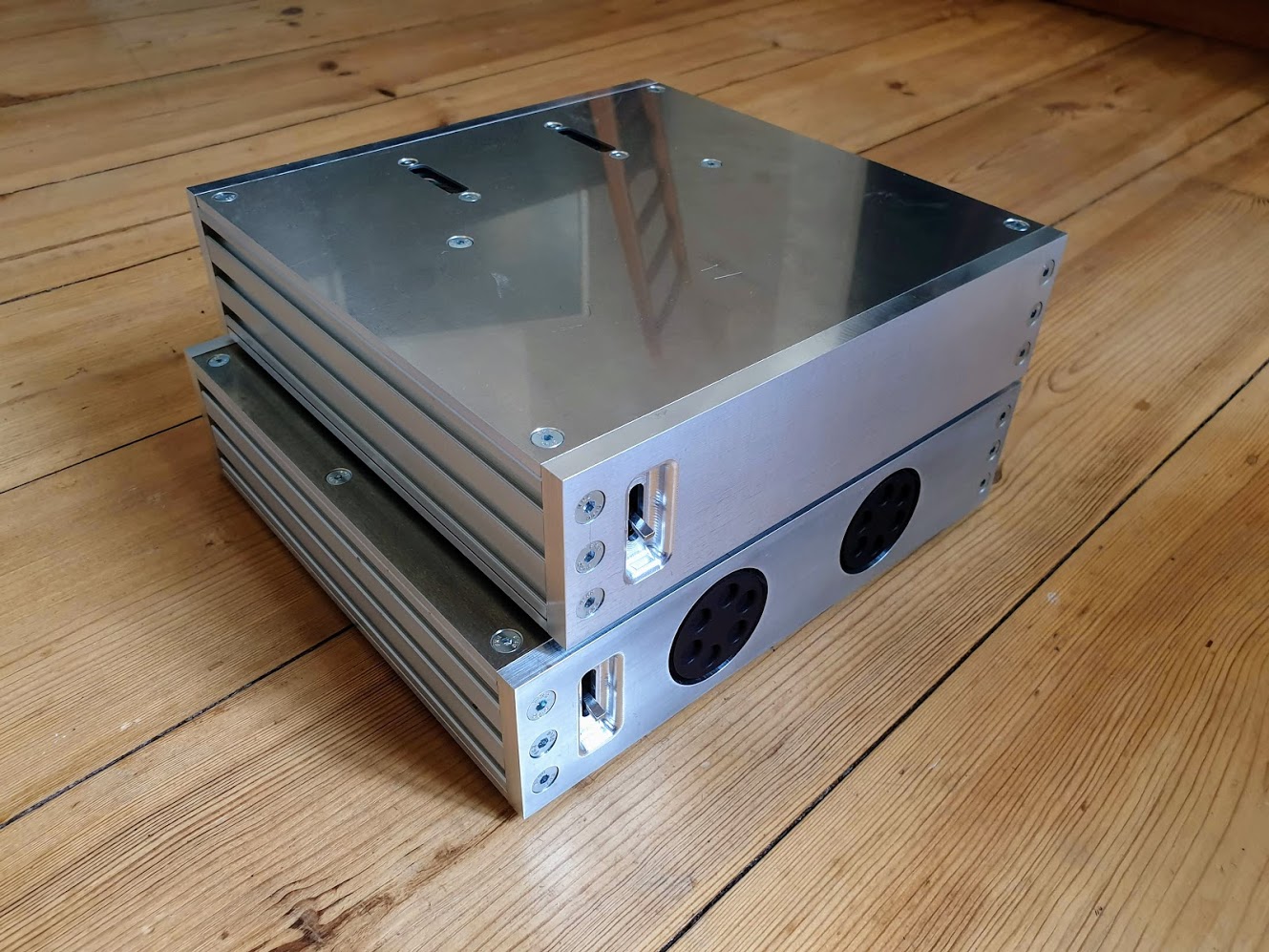

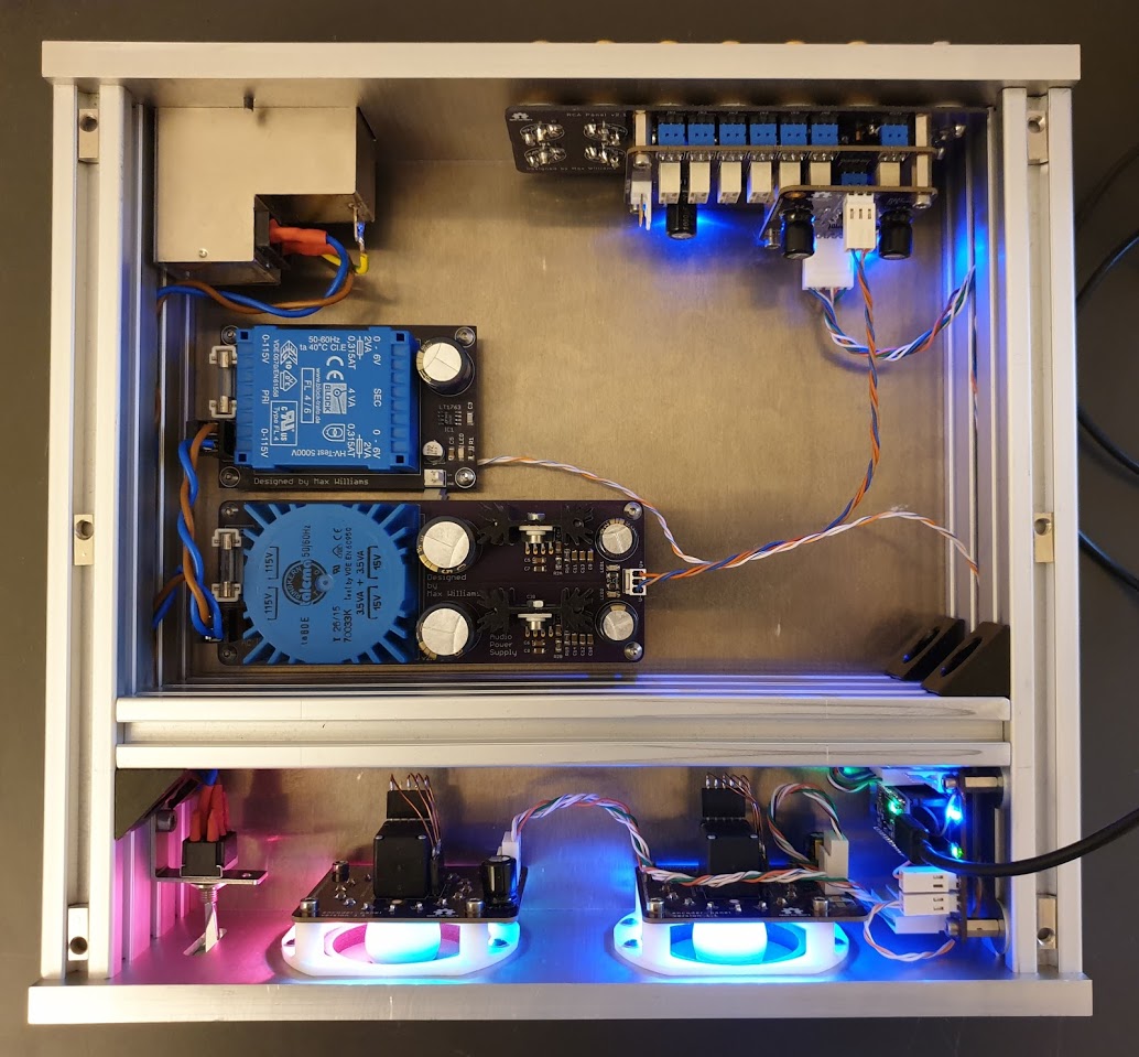

OK I think I'm done! It's been running great for over a week now. Really surprised at how silent it is. I was expecting to have some grounding issues or some other annoying fault but it seems to run perfect. Phew.
Quite a long project I guess. This thread was started 3 years ago but the design is based on my last preamp project and work done in this thread from 2013.
Here's a GIF of it working: Animated GIF - Find & Share on GIPHY
Python code, photos, CAD files, PCBs, schematics and more are all here: GitHub - FutureSharks/preamp-two: An digitally controlled hi fi preamplifier 🔈🎵
