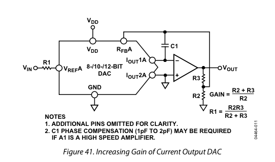

Gotta try it! But many questions arise. For instance:
Any gain possible. Using this small board or the bigger one pictured in the other thread post 42 (“version with gain in the I/V stage, 12dB”)?
Is this SE in/out? Is it possible to be balanced or would that need two boards? And SE in balanced out?
Headphones: I understand tapped after the attenuation, right?
Can take +/- 10V input. Can take or needs?
Thank you again!
Any of them. The 2 resistors set the gain. See page 18 of this datasheet or the attached pic.
My design is SE only, yes. Balanced would be 2 boards or redesign PCB with a quad DAC IC instead of a dual, e.g. DAC8814, and a quad opamp.
Not sure what you mean but it's the opamp that is driving the headphones.
I meant signal, not supply. The opamp needs +/- 15 or whatever (depends on the opamp, could be less). Basically the whole attenuator needs digital supply and analog supply, which means +5 and +/- 15 in my design.
Hope that helps! Happy to answer more questions if need be.

("Using this small board or the bigger one pictured in the other thread") Any of them. The 2 resistors set the gain. See page 18 of this datasheet or the attached pic.

What's the difference between the two boards?
The design is the same but in an older board I used an isolator IC for the digital 5V. It made no measurable difference so I removed it in a later design. I think I've made about 3-5 different PCBs but the design principal is always the same, just with slightly different components or layout.
Can the gain stage be replaced/bypassed by a previous I/V stage or similar from typical DAC boards?
You can make opamp have a gain of 1 by removing the resistors but you can't remove it because it does I/V after the R2R DAC IC. Basically the signal goes from V, converted it I and attenuated by the R2R DAC IC, then converted back to V by the opamp. But to be clear, there is no digital conversion, it's all analog. It just uses a special "DAC" IC that is made of precision R2R resistors.
I mean if the headphones output is taken before or after the attenuation.
After. The attenuation is done in I. Then signal is converted to V by the opamp, then there is the headphones.
I thought that the board was getting the value from an encoder throught Arduino SPI interface
This is correct. This SPI interface tell the DAC what setting to have. There's 65,000 settings.
But I was expecting the audio signal to be unprocessed (somewhat similar to the R2R relay attenuators)
It is "unprocessed". It's not converting the signal to digital, like with a sample rate etc. The signal is analog the whole time, it's just using a "DAC" IC as an V/I converter with attenuation.
There's more info in the application note from Analog Devices, you can just replace "AC Reference Signal" with "audio": https://www.analog.com/media/en/technical-documentation/application-notes/an-1488.pdf
