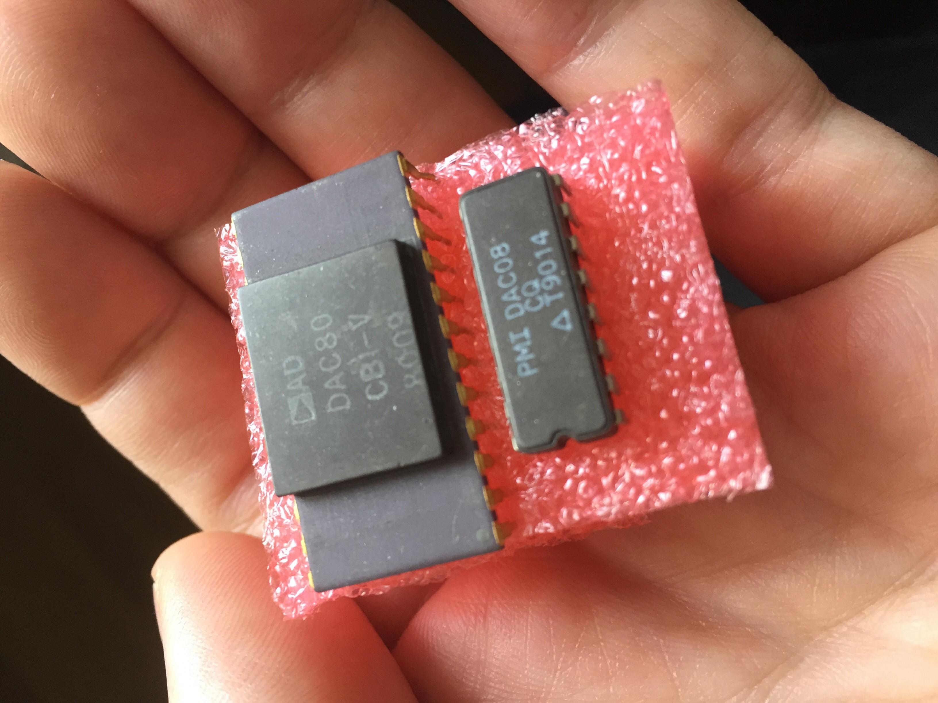

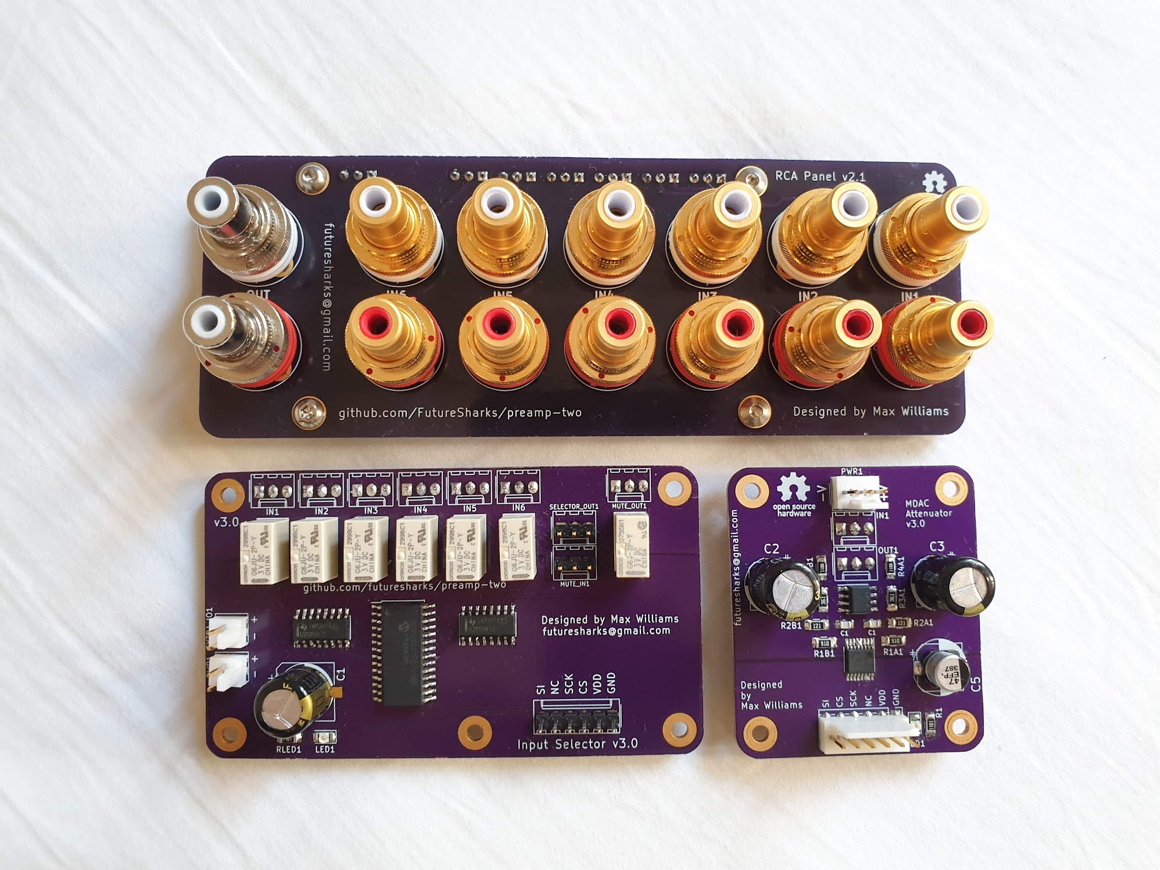

Awesome! I will study those boards and choose. Arduino shouldn't be the bottleneck here, I'm more worried about my (lack of) electronics knowledge (working on it). Look what I found in a box this morning:
I have to study the datasheets to see if I could use any of the two in your design but looks promising.
A final question (for now 😀). What's the main difference, if any, between the MDAC approach like yours and using a digital volume controller like WM8816, PGA2310 or MUSES72320

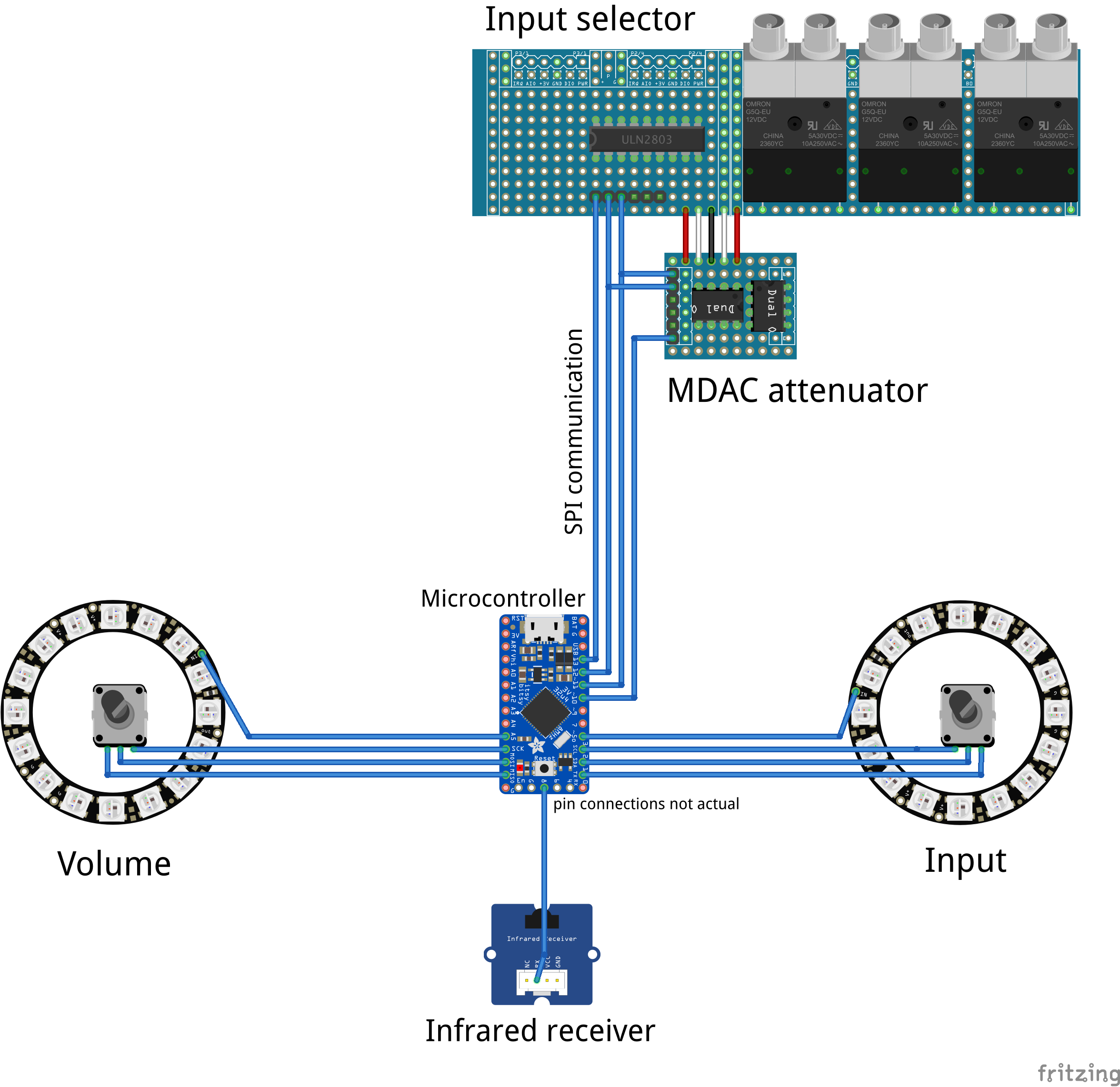

Small update

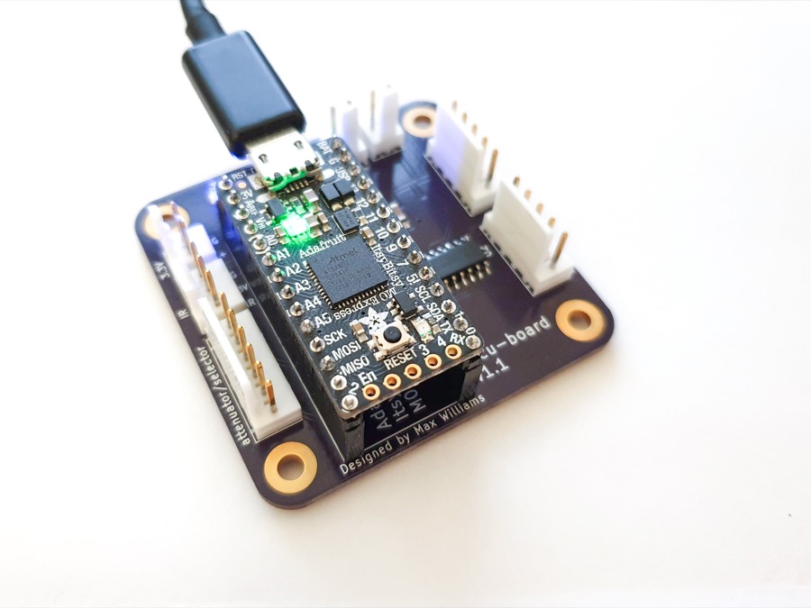

I switched from Arduino to Adafruit ItsyBitsy M0 Express. Once you used one of these newer micro controllers that runs MicroPython or CircuitPython you honestly don't want to go back to the crappy old Arduino way. It's so much better!
Anyway, problem is that they are all 3.3V so I redesigned my input selector and attenuator to be 3.3V compatible.

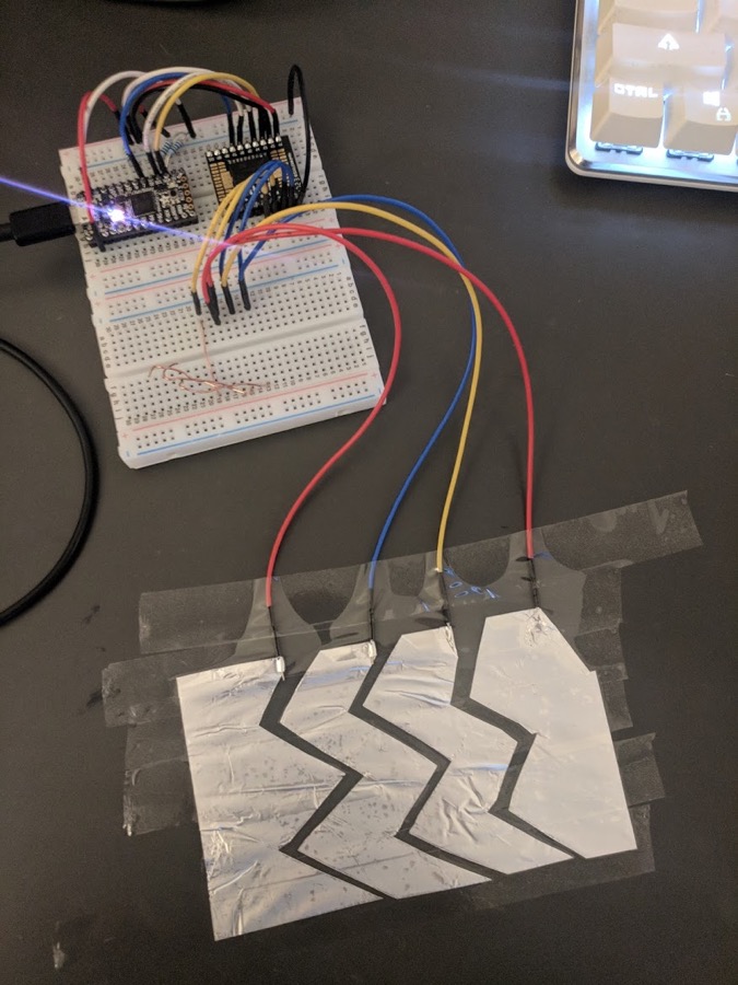

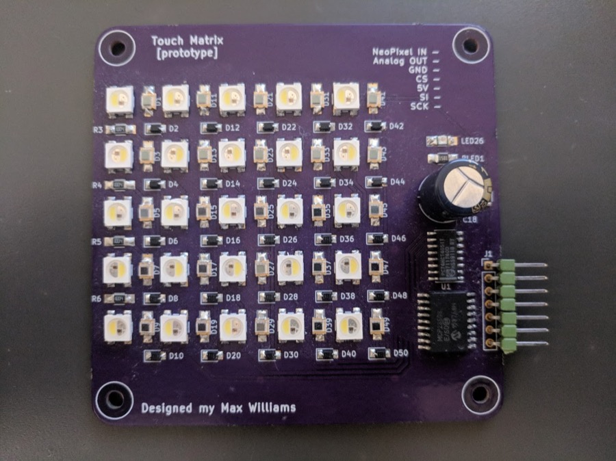

I was thinking more about control and tested out a bunch of different methods for control. An encoder or pot is an obvious option but I wanted to try some alternatives. I made some prototype touch interfaces based on some capacitive touch control ICs and a light based one.

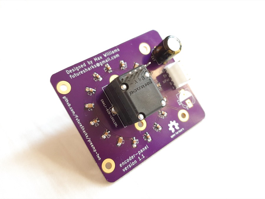

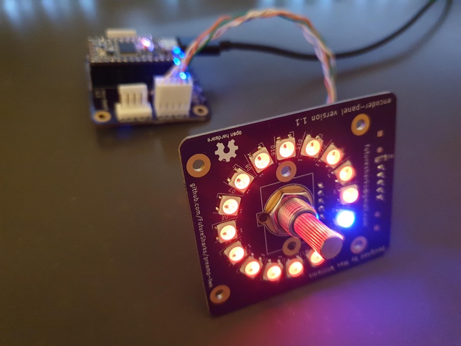

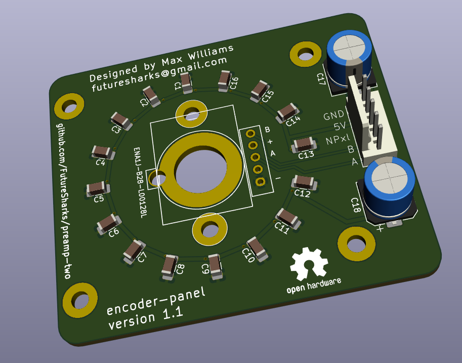

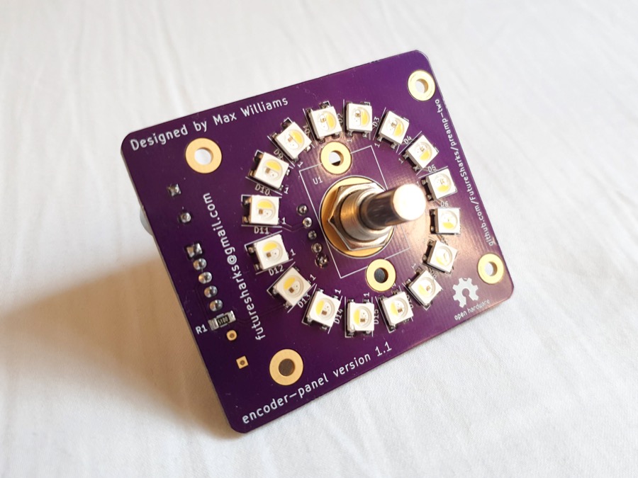

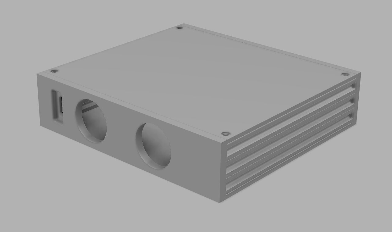

But in the end I couldn't make something that felt perfect so I went back to an encoder based input. I used a ring of 16 NeoPixels to for visual feedback.
