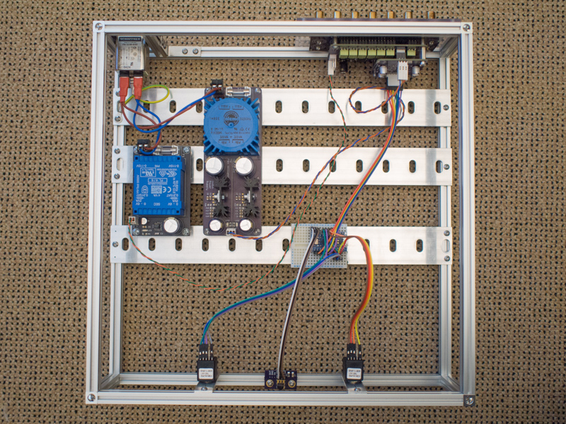

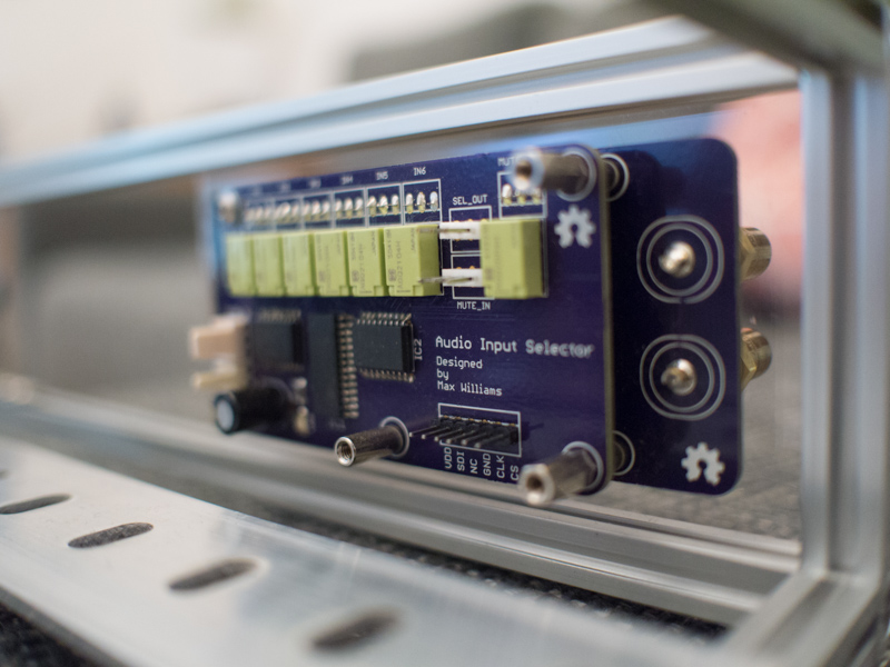

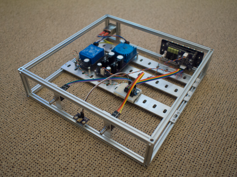

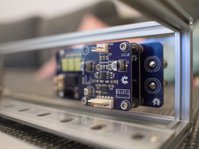

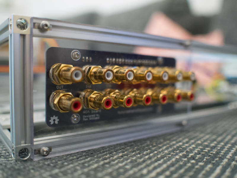

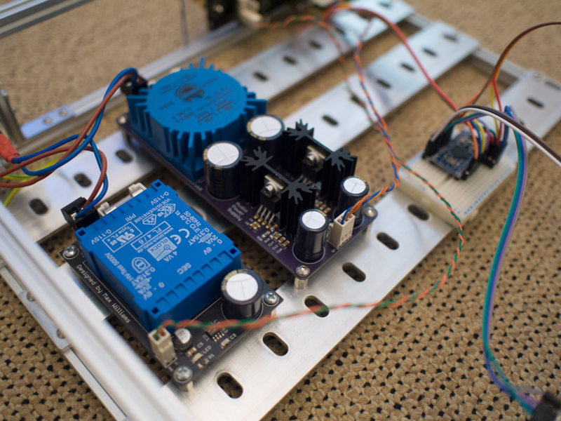

I've made a new design where the MDAC attenuator, input selector and RCA board all sandwich together into a nice compact unit:
My last preamp project had only 3 inputs which was a little annoying so I designed a new one with 6 inputs and mute:
I've written the initial Arduino code for two rotary encoders, one for volume and one for input selection, infrared and start up mute. The code is here:
https://github.com/FutureSharks/preamp-two
For now I'm using an Arduino Pro Micro 5V but I think I'll switch to something more modern like a NodeMCU or something that uses an ESP32.
PCB layout files are here:
https://github.com/FutureSharks/preamp-two/tree/master/PCBs
The power supplies I'm using are these two:
http://www.diyaudio.com/forums/power-supplies/252133-simple-lt1763-based-5v-psu.html
http://www.diyaudio.com/forums/powe...diy-friendly-dual-tps7a3301-power-supply.html

A couple questions:
1. Can anyone recommend a company for machining small quantity aluminium parts in Europe? I would like to get a front panel made from 20mm thick aluminium.
2. Has anyone used a bluetooth 4.0 / BLE remote with an Arduino?

Thanks. For display I don't know yet. I think LCDs look cheap so not so keen on that idea.
You can definitely use cheap encoders! I don't know what problem you had in the other thread but I've used many cheap encoders before without issues. Sometimes they need some hardware of software debouncing but it's definitely possible 🙂

Very interesting, thanks for posting and for putting this on Github. I'm especially interested in an ESP32-based version, and if a group buy for PCBs / kits ever happens. With my level of experience, making my own BOM for this would be a little above my head (I could do it, but it would require a lot of research on package sizes etc that I just don't know yet). I've never had a PCB printed. I have a decent amount of experience with ESP8266, Arduino, rPi, RFM69HW, etc and software development in general (my day job). I might try to take this on after the holidays, since I have some LXMinis and 6 channels of amplification to build first.
Me too but I think we need to wait a bit longer before the ESP32 gets more popular with DIY. Support, code and libraries still need to catch up a bit I think. There is already a NodeMCU-32S module released, you can get it on Aliexpress:
https://www.aliexpress.com/item//32758824128.html
I'll add an example BoM soon.
