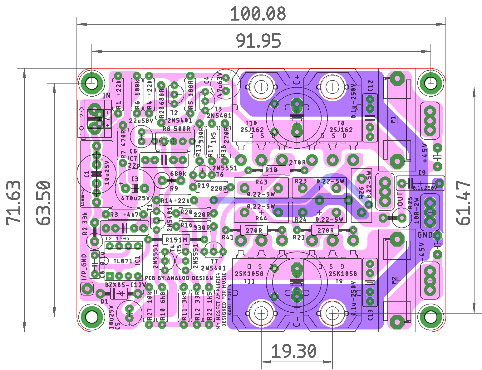

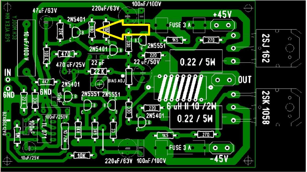

To Mooly and interested it was #719
where prasi shared the schematic and layout with paralleled R9-680k to 22p.

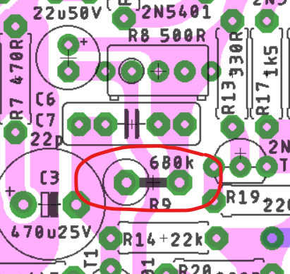

Mooly that is additional/optional added FB Resistor.
Don't remind correctly who has done it.
Yes, I vaguely remember now. It could have been AKSA that mentioned it.
Yep, that's me.......
It is controversial. Unconventional, increases THD.

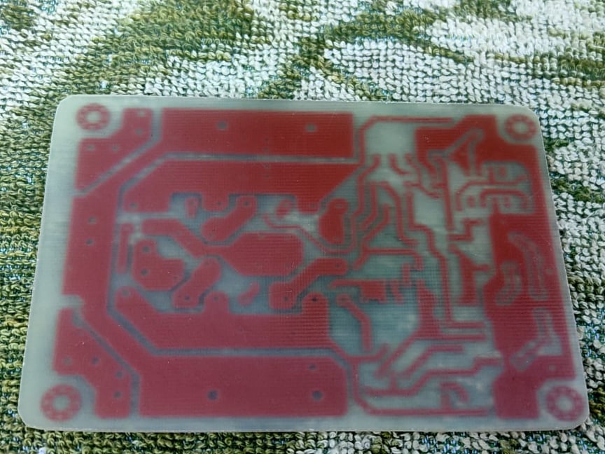

Thank you Mooly i trying to make your amp but i cant afford company pcb so i will make
pcb by hand and try
warm regards
Andrew
pcb by hand and try
warm regards
Andrew
Hello Mooly
greetings rough pcb for testing its prasi design
warm regards
Andrew
Andrew,
I havent looked at the layout in detail, but I suggest to keep the original feedback take off point as per my design. There is a specific reason for that to reduce THD.
Make an extra drill in the layout and use a wire to connect.
regards
Prasi
P.S., if you look at my design, its single sided only but with repeat traces on top. and feedback takeoff can be a wire. just 2c.

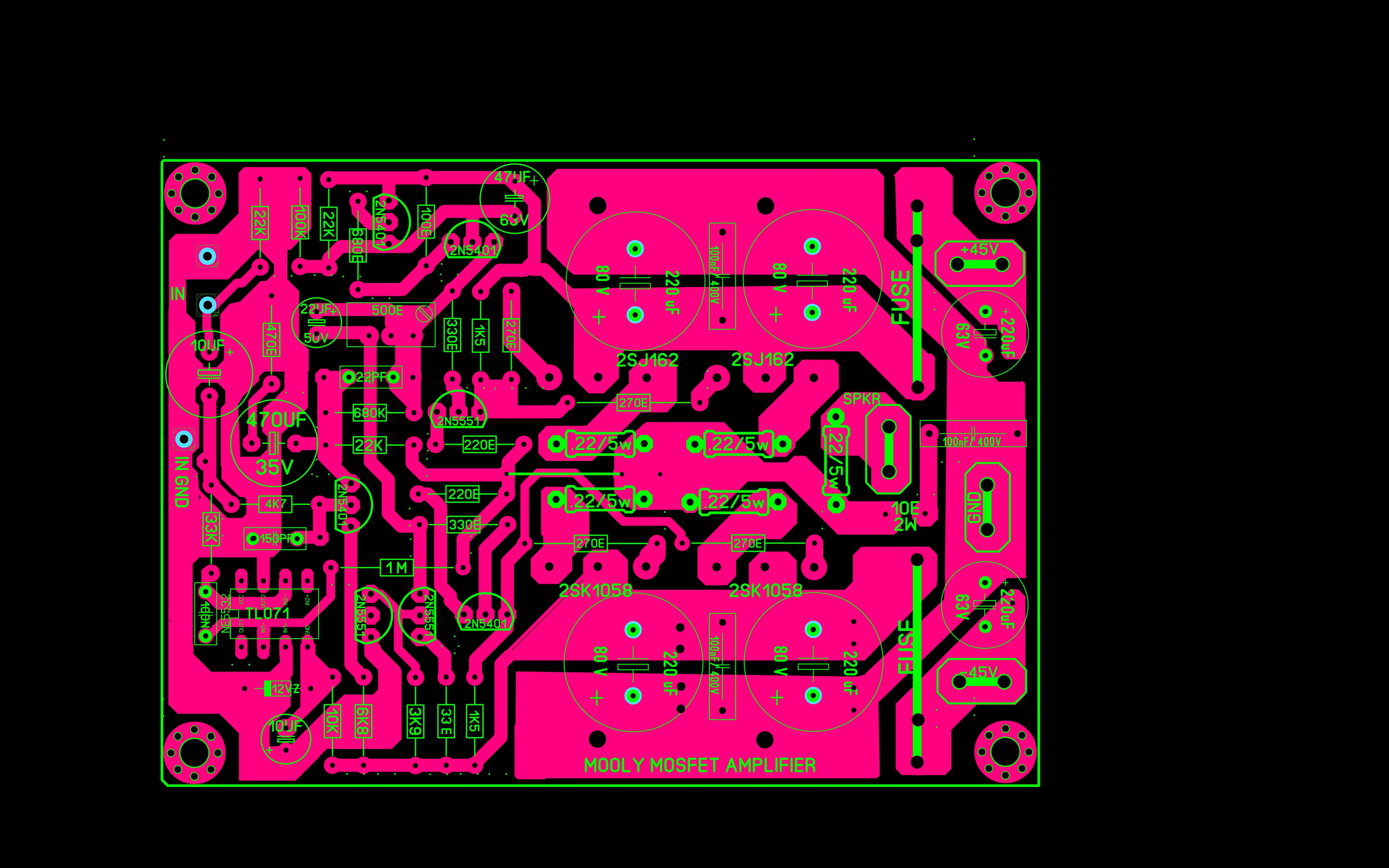

FriedMule,
make your homework before asking. post #1 gives the details. i have it posted here.
My MOSFET amplifier designed for music.
you can easily import gerbers into sprint layout and make adjustments as per your components.
Yes sorry for that, but I have to admit I did not remember that post. I did read most of the 1000 posts but did not remember that you had been so kind to share your files. 🙂
Edit: it looks like it's the gerber files, or am I missing something?
I was looking for the project files🙂
