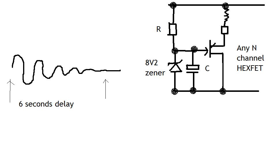

But it will be split supply, so twice of that? What is the effect of omitting the delay circuit?What is ESSENTIAL for a finished amp is the relay delay at power up as the servo takes a few seconds to settle. This can be a really simple design, little more than a power transistor with an RC network on the base to give the delay. As simple as that.
Ups, you mean the output will not be at ground level? Where will you put the mentioned delay network? Near power button (power supply)? Do you mean to delay the supply to the coil of on-off relay?

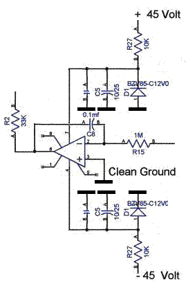

The opamp for any servo needs to have low (preferably "zero") input bias current to enable the integrator cap to be kept low in value (the 0.1uf... small, available in high quality types, inexpensive) and the resistor feeding it high (the 1m). The input currents of a bjt device are significant and would cause a large DC offset due to the bias current "developing" a volt drop across the 1 meg resistor.
FET devices have essentially zero DC bias current.
The TL071 holds the output offset to well under 1mv without any trimming or fuss, it's perfect for the job.
You could use a 741 or a 5534 or many other types and reduce the 1 meg to say 10k to minimise offset due to the input current, but then the cap would have to be scaled up accordingly... and a 10uf poly cap isn't cheap or small.
The servo causes the amp to produce a "damped" low frequency sinewave due to the action of the servo correcting the output and the time constants within the amp itself (feedback return cap etc) like this, so this is why the delay is required. To me any amp should be totally silent on power up. If you arrange a separate "rail" for the delay using a half wave rectifier and cap from one of the windings on the tranny and center tap then by choosing a "low" value for the reservoir cap the dalay circuit can be made to drop out quickly before the main rails to the amp collapse.
The relay is used to isolate the speakers. Choose R and C to give around 6 seconds delay.

Okay thanks I got the reasoning. Typical input bias for OP07 is 1.2nA at room temperature. I guess it is low enough, compensated by its low input offset voltage (at least 100x lower than TL071). Later I will check the voltage rating of my smallish Black Gate NX capacitor. The RC is to create a pole for LPF right? What is the max frequency so to isolate from audio frequency (AC), 10Hz? But there's no resistor in parallel with the cap hmmm 😕
I will check my other opamp then... OPA627... 0.9nA@25deg. TL071 is 0.009nA@25deg 🙁 Oh well, whatever, my expertise is not to calculate but to plug and play and to listen 😀

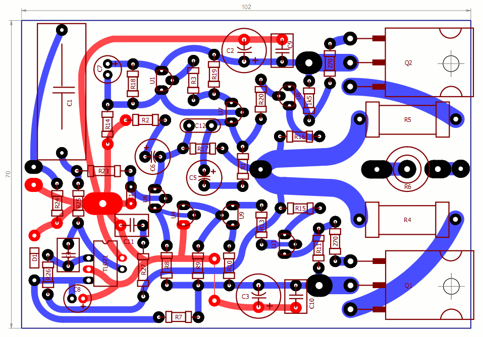

Sure. Planning for a permanent build I have wasted much time for preparing the housing 😀 It's hard for me just to pick transistors before measuring them 😀 Also I'm not yet decided whether I will prepare for paralleled mosfets or not (I think not).Just get it built Jay 😉
Do you think going double transformers (dual mono) would be any better?
On each supply rail (on-board) I will put Black Gate F 680uF + Elna Cerafine 220uF, but I'm not sure whether I will also put a Solen MKP (From experience I like the Solen MKP in the supply rail).
For main capacitance, I have plenty of bad quality audio caps. Good quality ones only in pair (2 pieces for each type/brand). That's why I prefer a single supply so I can use only two caps. I have two Nippon Chemi-con CE 8200/85. It is not audio grade but I like it. I think too big of "capacitance" will degrade the sound. Too bad many people like the better ripple smoothing effect and the bass performance of big caps 😛

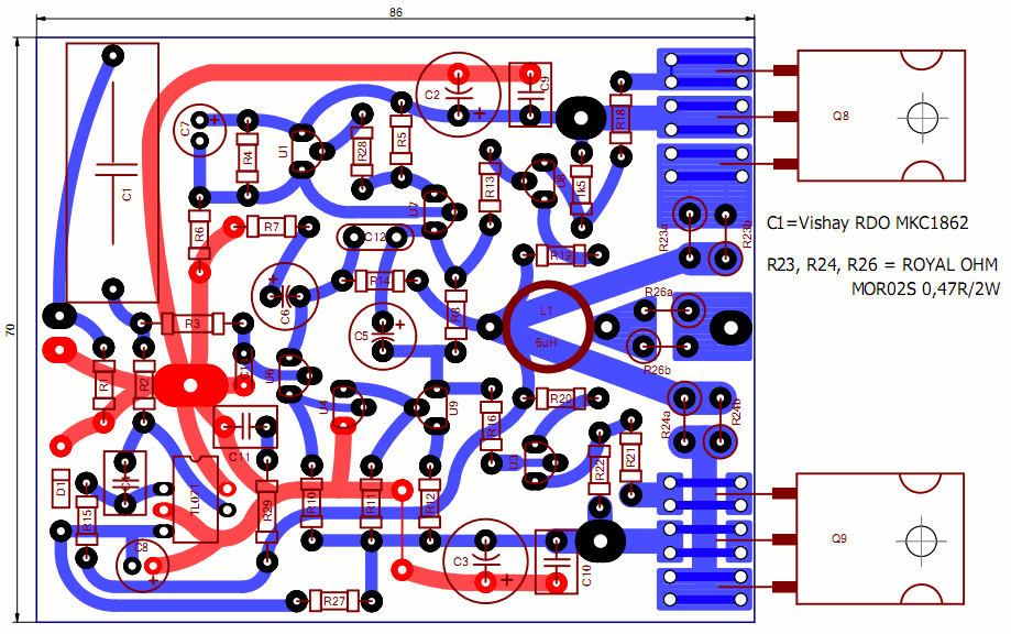

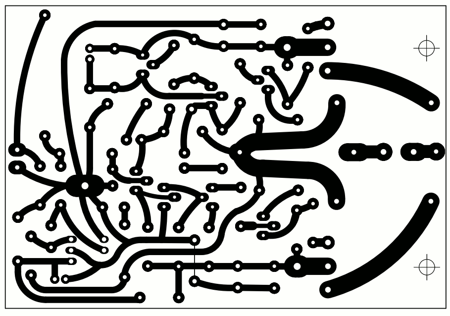

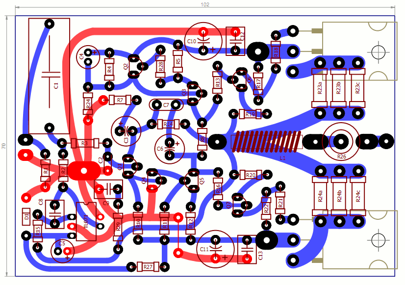

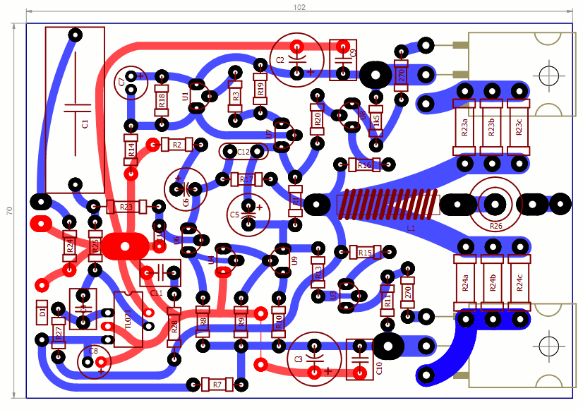

Are you designing your own PCB ? If so make sure you keep the decoupling cap ground returns out of the main signal ground.
True dual mono construction theoretically is better, the two channels are 100% electrically isolated. Downsides are housing the two trannys, doubling up PSU components, and if the two are in one case then weight, transformer interaction/layout etc.
I would use a single and get the wiring correct.

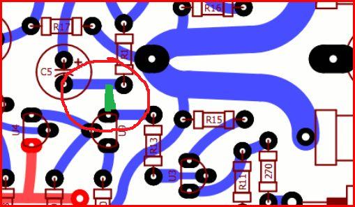

This is a error?
- My MOSFET amplifier designed for music
