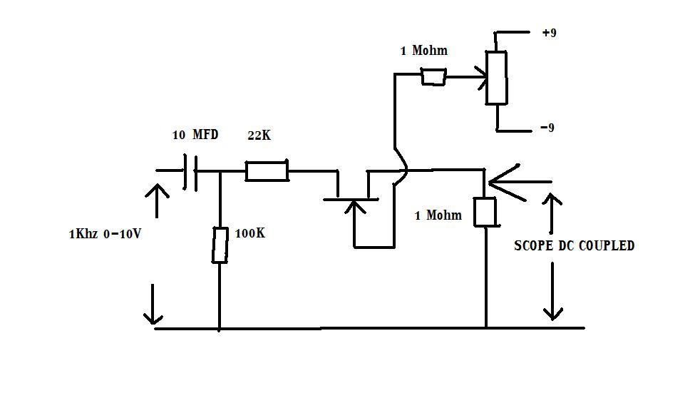

Try this-- it will give you a feel for what happens. If you apply say 4 volts peak to peak and take the gate to 0 volts it will conduct. There will be NO dc offset across the output-just the signal. Now take the gate higher and at around 0.3 volts a DC shift will appear as the gate channel begins to conduct. You need the gates close to this value to minimize their on resistance. That 0.2 volts makes quite a difference. Change the 22 K and 1 meg for say 100 ohm ( I am guessing these values but this is what I did ) so the resistance of the FET affects the output. The voltage now across the 100 ohm output will rise significantly as the gate goes from zero to 0.3 volts. Put the original values back and now swing the gate negative. To "block" 4 volts you need -4 on he gate, to block 6 volts you need -6 and so on.
In the inverting configuration I use there is no signal ( only a few millivolt ) across the FET, so this isn't such a problem anyway but do try it, it makes it easier to understand what happens.
Again going off memory I think the resistance of the FET was around 70 to 80 ohms at zero volts gate, and fell to below 30 ohms at 0.2 volts.
Another gem of information 🙂 Have you ever wondered how to identify the source and drain. You will find it dosn't matter which way round you put the FET's. And that's official 🙂 -- I asked Bob Pease at National Semiconductor, as it was something that always puzzled me. Thanks again Bob.

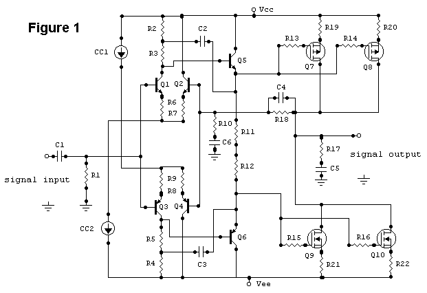

It is too brave to use class AB follower without negative feedback by voltage. Good luck!
Speaking of resistances, it is convenient to think about MOSFET as a charge controlled resistor.
I used HEXFET followers in class A amps and drivers. No additional feedback was used to linearize them, when it was used it linearized other things like class C stage working in parallel.
The best results were obtained when it was loaded on a counter-modulated CCS and drain powered from one more voltage follower. In such case it sees more constant conditions over all working region, both Vds and current are most stable, so distortions caused by variations of transconductances and capacitances are minimal.

I know what you mean, Wavebourn
Counter-modulated CCS
I guess this is what you have used in some of your published original an unique output stages.
There is nothing wrong with HEXFET outputs!
Otherwise Nelson Pass & Bob Cordell, two of our most experienced audio amplifier designers
were totally wrong, to the bone 😀
Keep your good ideas coming: Mooly and Wavebourn
I am all ears 😉

The 2SK152 has various Idss ranges that will lead to different lower Rdson. Did you make any kind of matching for both channels of same input ?
Today, I had a look at different vendors here to source this part. Unobtainium.
Source selection is not something I'm looking for, 100% of my listening is CD. Couldn't a BF245C do the job instead of your low Rdson part ? It's Vgs range is more suitable to be driven by a chip, even if I can't reach full isolation. Any drawback ?
I have a lot of BF245Cs in my drawer and guess what I can read on the Philips datasheet from 1996 :
Features -> Interchangeability of drain and source connections.

Hello Francis,
Yes- the second Op-Amp was just to preserve phase. Whether it makes any audible difference I don't know. Perhaps ommiting it and swapping the speaker leads would be better, but that never "feels right" somehow -- bit silly really.
If you have a signal generator why not rig up the FET's as I showed and try them, there must be many J-FET's that are suitable. I didn't match them at all as they are simply used either fully on or fully off. Any small difference in on resistance, say 35 ohms intead of 25 is totally swamped by the series input resistance. The first OpAmp operates as a mixer of course and to get the performance from the FET switching you have to use the virtual earth configuration, don't be tempted to use the non inverting configuration instead. As a bonus for some reason the inverting mode always seems audibly better to me. Maybe because there is no common mode error voltage.

O.K. The FET's as I use them give as near total isolation as is possible. With the volume of the amp on full and audio applied to all (3 in my case Aux, Mini Disc and tuner) unselected inputs there is no audible breakthrough at all. Even with 10 volts squarewave shoved up one of the inputs there is zero breakthrough even with ears right up to tweeter. None - nothing - - zilch 😉
Try those FET's you have.

Mooly said:Hi, Well after having seen all the amazing projects and designs you guys have come up with I thought I would share my design on these pages. First and foremost this was designed for music reproduction in a domestic setting and without wanting to "hijack" another current thread, YES amplifiers do sound different, that is why I spent so much time in the development of this one. This amp is without doubt "musical" in all the best sense of that term, it's ability to recreate a believable soundstage is absolutely compelling. If anyone is interested in what it looks like and further details there are some piccys in the "Post your solid state pics here" forum. (About post 283) The thinking behind this project draws on the work of the late John Linsley Hood whose designs and thinking I much admired.
Regards Karl

Hi Lineup,
The only change has been removing the 150pf cap on the input transistor. Nothing else. Totally 100% stable. Musically, out of this world. Oh and that 0.22 ohm series output resistor, which has always been present, just me, I kept missing it of the circuit
- My MOSFET amplifier designed for music
