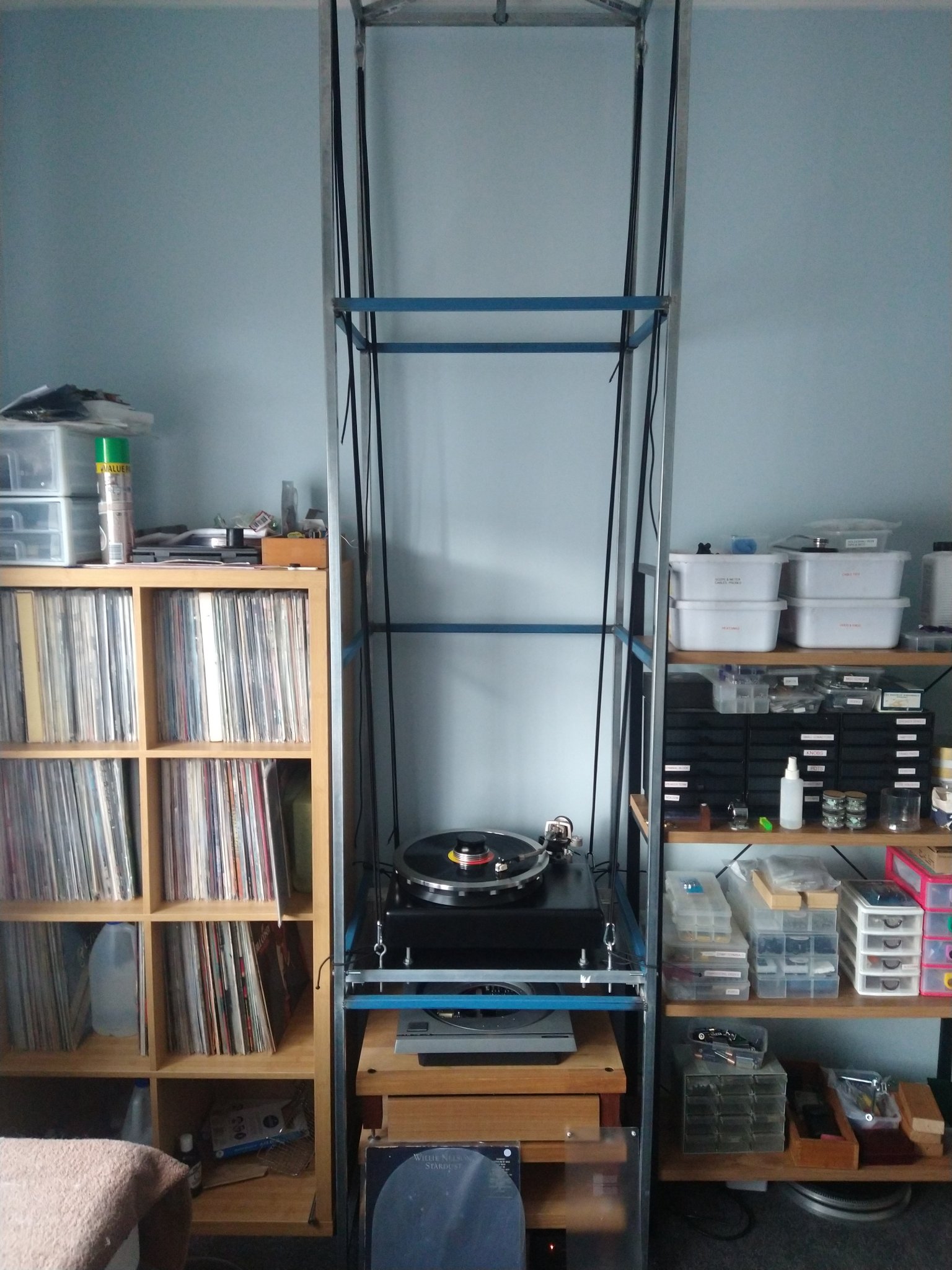

Wandering a bit OT, the hanging idea brings up something I've always found interesting. Say you hang a turntable by bungee cords or springs of some sort. You can find the resonant frequency without knowing the mass or the spring rate. All you need to know is how far the spring stretched (deflected) when you attached the turntable. Pulled from my spreadsheet, with "inches" subbed for the cell containing the deflection in inches:
frequency=(1/(2*PI()))*SQRT(9.81/(inches*0.0254))
So, if the spring(s) deflected 3", the resonant frequency will be 1.8 Hz. It works in compression too.
Like this. This isolation station worked extremely well, as good as my current Minus K, the BUT is I could not keep the TT level. Creep in the bungee chords of only 1mm would significantly effect level. Vertical isolation was better than 1Hz.

There is a way.Like this. This isolation station worked extremely well, as good as my current Minus K, the BUT is I could not keep the TT level. Creep in the bungee chords of only 1mm would significantly effect level. Vertical isolation was better than 1Hz.
Angle the bungee cords so it foms a sort of inverted pyramid and connect them to the sprung mass at a height significantly above the centre of gravity, such that a line extending from each bungee cord passes through the centre of gravity of the sprung mass. I can't sketch it right now, you'll have to visualise it. In plan view, the upper connection points form a larger square than the lower connection points. The sprung mass frame will have to extend upwards, to provide the connection points.
Any force applied at the CoG results in pure translation, but the system is much more pitch/yaw stable and less sensitive to changing bungee characteristics. I would angle the bungee cords at about 30 to 45 degrees from the vertical. They can be shorter and stiffer for the same degree of isolation.
Mike
Looks like you play around with racecars?Wandering a bit OT, the hanging idea brings up something I've always found interesting. Say you hang a turntable by bungee cords or springs of some sort. You can find the resonant frequency without knowing the mass or the spring rate. All you need to know is how far the spring stretched (deflected) when you attached the turntable. Pulled from my spreadsheet, with "inches" subbed for the cell containing the deflection in inches:
@mikey_audiogeek The frame was as wide as possible to fit where is was placed. The bungee cords were angled by about 5deg which was the max the frame would allow. This frame has since been replaced with a Minus K.
