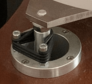

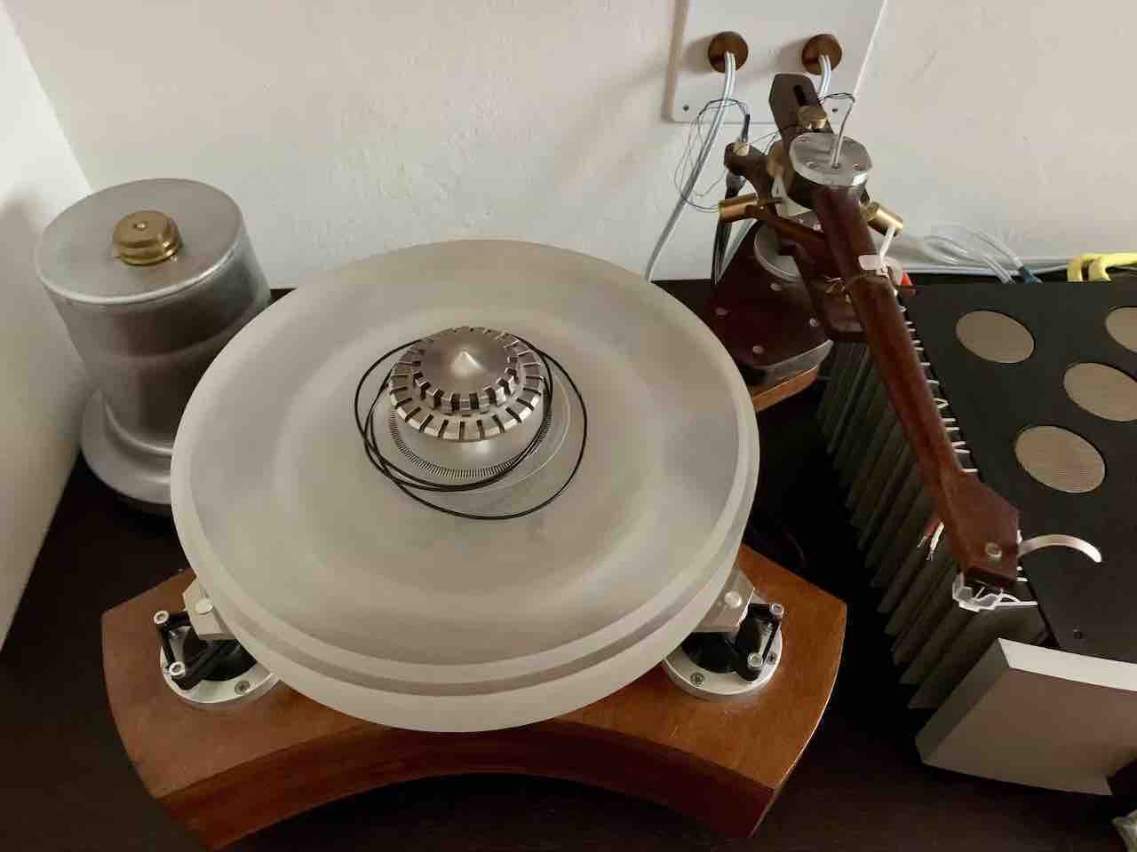

@ Rickmcinnis: Same problem with the magnetic levitation. Magnets strong enough to hold that up would certainly have an effect on the cartridge.
Sorry to disagree on this comment. My Mag levitation hold up the 5 Kg platter, plus 0.5 Kg puck plus the TA that is about 1 KG and leaning out a bit plus the structure of the floating plus the solid bronze and stainless bearing very well and using MC cart Denon DL 103 I never never had any problems or negative effect on the cart. It depend on how you make it. Above on 16 years of using it, therefore I am sure is not a case but a fact based on reality that mag levitation did not effect at all the Denon DL 103. Th eTA inner wires do not have even th Stroud wire, just the 4 cart wires..........
The small problem with mag levitation to engineer is to have a solution to keep the two repelling mags entered as they off set themself and stronger is the weight to be folded up stronger is the off set center power to control. But there are simple solution to it it the holding weight is not very high such as 30 or 40 Kg.
Rgds
Adelmo
Sorry to disagree on this comment. My Mag levitation hold up the 5 Kg platter, plus 0.5 Kg puck plus the TA that is about 1 KG and leaning out a bit plus the structure of the floating plus the solid bronze and stainless bearing very well and using MC cart Denon DL 103 I never never had any problems or negative effect on the cart. It depend on how you make it. Above on 16 years of using it, therefore I am sure is not a case but a fact based on reality that mag levitation did not effect at all the Denon DL 103. The TA inner wires do not have even the ground wire, just the 4 cart wires..........

This is a detail of one out of 3 mag unit that hold up my TT floating type one. As you can see there is an aluminum case, inside goes a pivot that have one of the upper magnet. The bottom magnet is fixed to the base unit of the aluminum case. As mentioned since two rejecting mags also off center themselves, I used a kind of O R to keep centred the mags. The lateral off set power of the mags increase according to the mags rejecting power , I.E according to the weight they need to hold up.
However in building a TT there are many way to achieve things...
My goal was to have a good isolation system simple and reliable.
But perhaps other TT might have different goals, such as isolate but also control some kind of frequency, therefore In my opinion something using springs may achieve better this result. I would not consider things engineered for the use of different weight and frequency for a TT as I have read above, but I am not a designer therefore it is just a simple opinion.
My mag system have some short coming, but overall I am happy to have used it and made it. Is not too soft therefore can hold up may Kg ( not soft like the old Thorens for example... ) and isolate well. Having the motor pod separated from the plinth I do not need too much to control vibration, also my bearing even though is a traditional one has a very very low rumble/noise level.....
However there are soooooo many ways to skin the cat, mine was just a sharing information, nothing more nothing less.
Rgds
Adelmo

TT sound reproduction is a pretty complex issue as it involve too many variable items in the line and the TT is only a part of the the analogue system so not easy to judge I think. I did not own many TT, just a tweaked Thorens TD 160 and before it a cheaper Pioneer that did not made any comparison reference. I sold the Thorens years a go as I think mine is better, but honestly speaking the tweaked Thorens was not too bad as well, but not better then mine. Mine has a better bearing as the Thorens old bearings have a too loosen allowance, the speed control in mine is better, platter wise also I think is better as I like acrylic platter with puck. TA is different issue as now I use a clone of the supatrac 12 inch. I have used a Rega RB 250, a jello SA 750 L 12 inch and some self made clone such as a 12 inch Ref 1 from Schroeder, a Unipivot 12 inch as in the picture. Does it worth to build it? Not so sure as the final cost is not ...lets say too low in my execution. Platter costed alone 400 Euros, bearing was made by my ex company for free under my design, but some material cost was involved. Motor higher cost is the case as I used a old brushless 5 inch floppy drive as motor and a PC feeder to supply the DC 12 volts. I use 3 belts now. Some cost for the lathed parts.
In my opinion make your own TT may worth only if the goal is to have a really top TT so the cost worth the result as a top TT made one has a too high cost. In case the goal is to make a cheap one I think is better to buy a made one.
Plinth is a 2 birtch types, 5 layers glued, I have inserted leads inside 3 layers in a particular position. All the metal parts are decoupled.Floating plate has a sound treatment in the lower part.
Comparing to my friend Denon DP 3000, DD type of TT and using the same cart Denon DL 103, same Pre Phono and as TA the Jelco SA 750 L, mine sound better, it is more detailed and have better controlled bass and the back ground much more silent.
Rgds
Adelmo

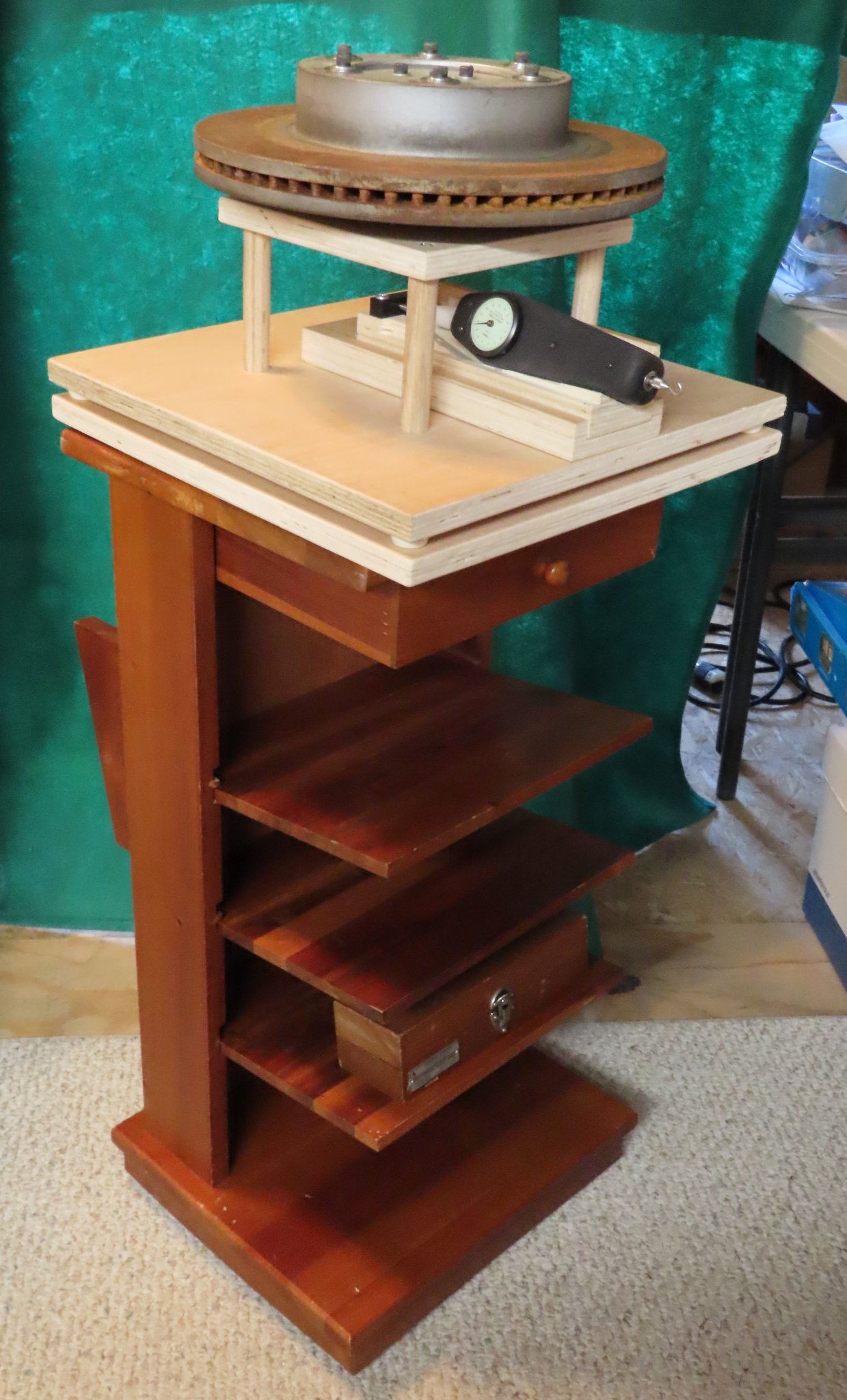

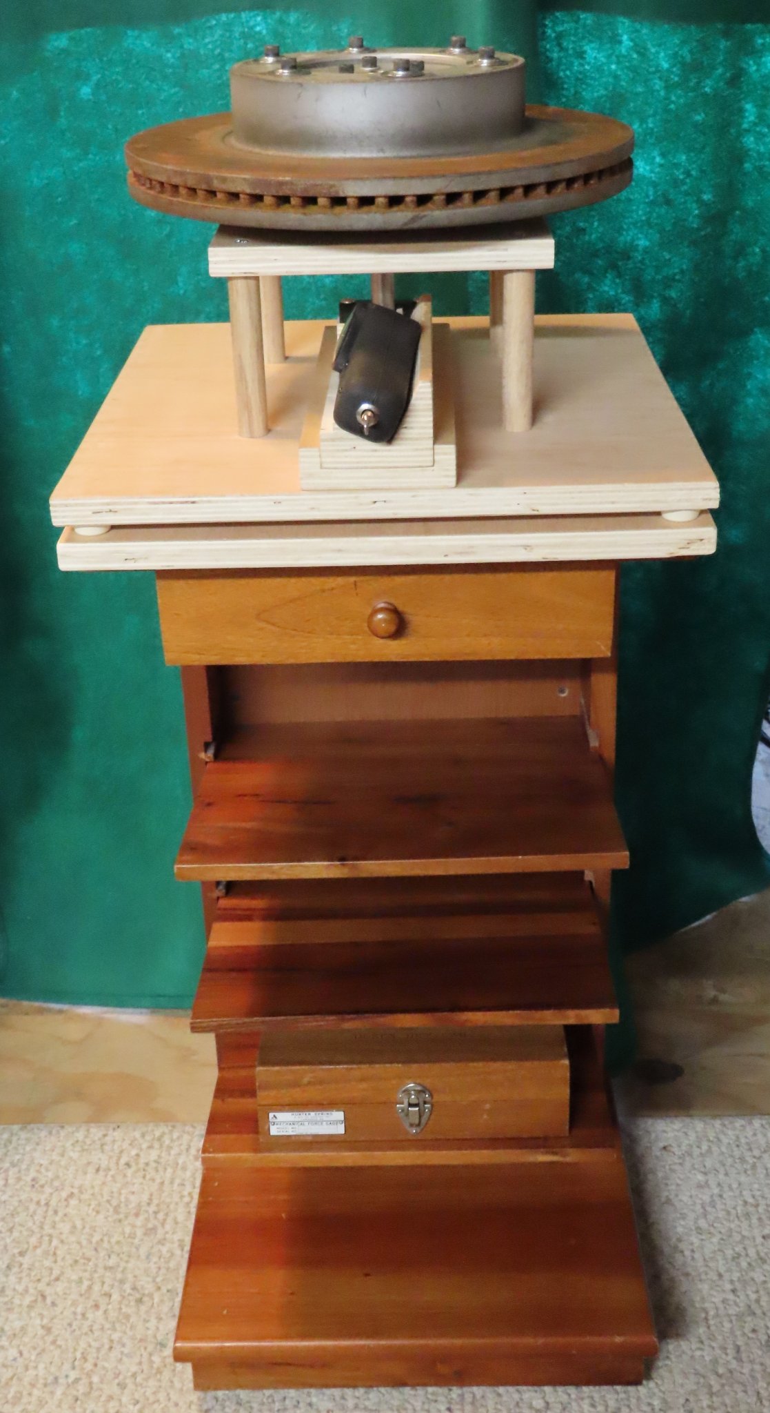

Hi Everyone,
I have some not particularly exciting news concerning my turntable project.
The testing of my bearing principle so far has been inconclusive. My test set-up was located on top of a coffee table which made it very inconvenient for testing. I now have the whole apparatus sitting on top of another piece of furniture that allows me to sit down in front of it. The other problem is that, I don't have a motor driving it. I'll work on that in the next few days.
In the meantime I got side-tracked with my bill of materials. I had to change the dimensions of various turntable components to allow for the availability of the various materials. I got that done and my materials arrived last Friday from McMaster.
Sometime this week my friend is going to write a CNC program to machine the six pockets for the bird shot into each half of the Delrin platter.
I purchased a nice camera so that I will be able to provide good pictures throughout the project.
The attached pictures show the new turntable test set-up and the materials I purchased from McMaster. I guess I'm committed now.
My new camera also takes videos enabling me to post some solid models right off my computer screen.
