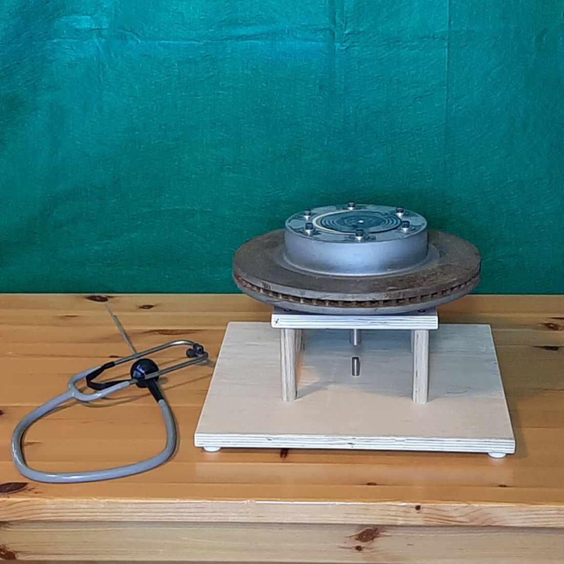

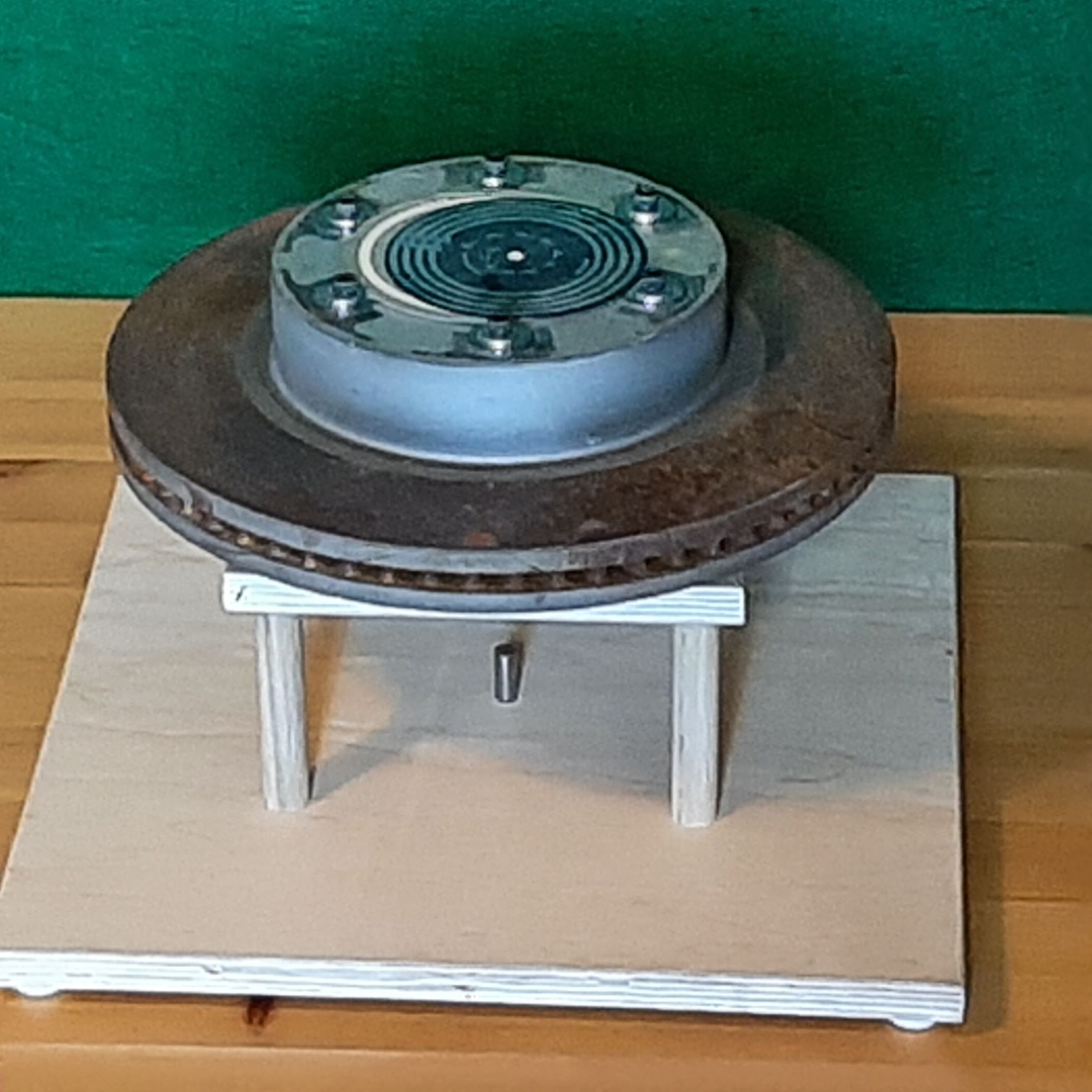

Hi everyone,
Here are some photographs of the turntable mock-up, using a disk brake rotor.
As I said, I am not going to play LPs on it. Its purpose is to test my main bearing concept which has not been built yet.
Tomorrow, I'll post some more CAD drawings showing my proposed turntable design.
There will be an overall view of the turntable and an exploded view of all the parts.

Hi, The problem you may have is assuming the the brake assembly is machined to close enough tolerances to make it suitable for a T/T platter. Have you slung a DTI on the top & perimeter to see what the run out is. I worked as a design eng in the motors industry for over 30 years & can assure you the tolerances are not that tight.

Once again, the disk brake rotor mock-up is not going to be used to play records!
I am using it to test my bearing design.
Somehow I should have made that more clear in my first post.
Sincerely,
Ralf

As far as the use of plywood is concerned, I am only using that in my bearing test mock-up.

Looks like a great project,
I have made a few Sp10 platters from POMC (Acetal). I used flat sheet between 20 to 50mm as 300mm round bar was very expensive at about $1000AU /meter.
Ralf, Yes I understand that you are going to test your bearing design. But any radial run out of the mock platter will effect the results you get from you bearing design.
Both bearing & platter have to be machined to the highest tolerance spec to do many meaningful testing, been there done that. If fact the heavier the platter the more the radial runout will effect the bearing.
