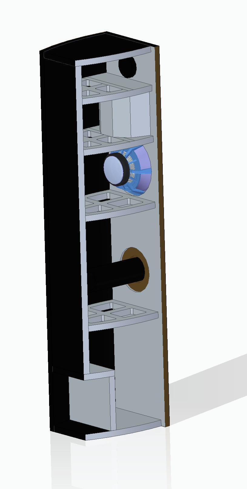

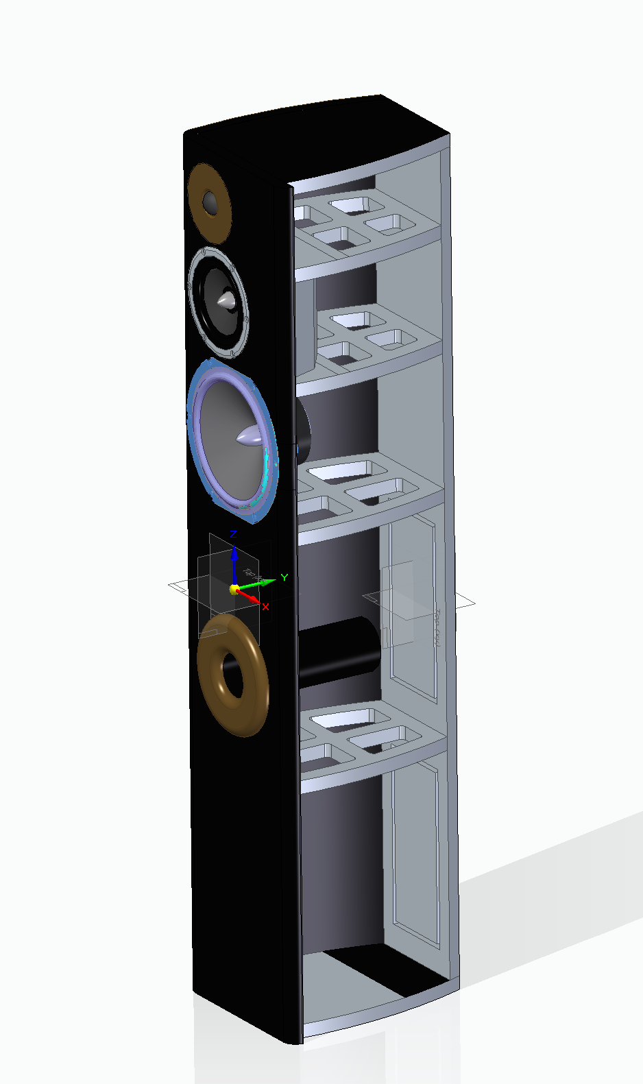

Step 1 - I worked out an initial cabinet design. WinISD showed a 1.75-2.0 ft^3 enclosure tuned to ~30Hz or so looked pretty good for the 8s and I found a thread on here involving them that also was right around the 1.75 ft^3 range with similar tuning.
After playing around with the design a bit I decided that I wanted a front facing port to allow me to incorporate a hardwood trim ring for the port. I also decided that I wanted to have curved sides with matching hardwood veneer. All non-wood surfaces will be gloss black.

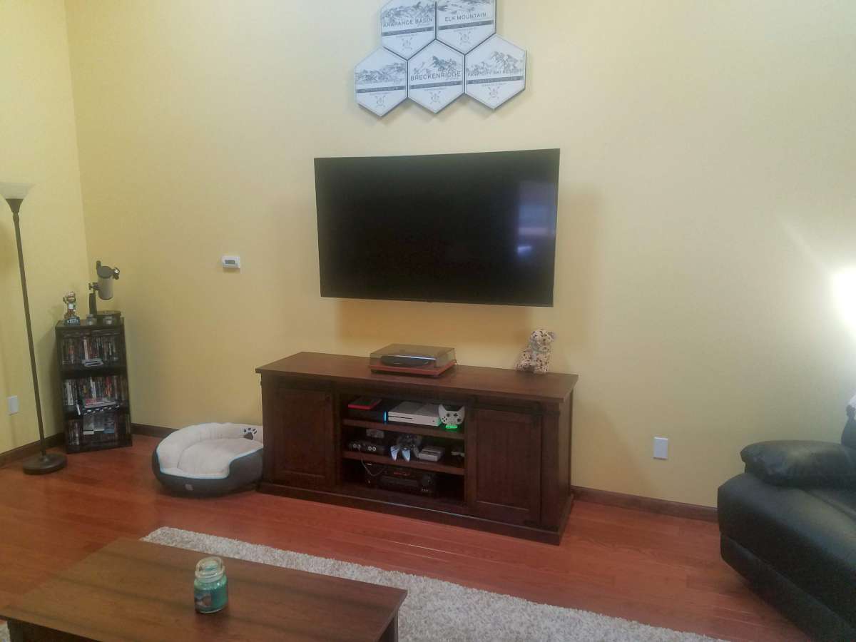

The room that they'll go into:

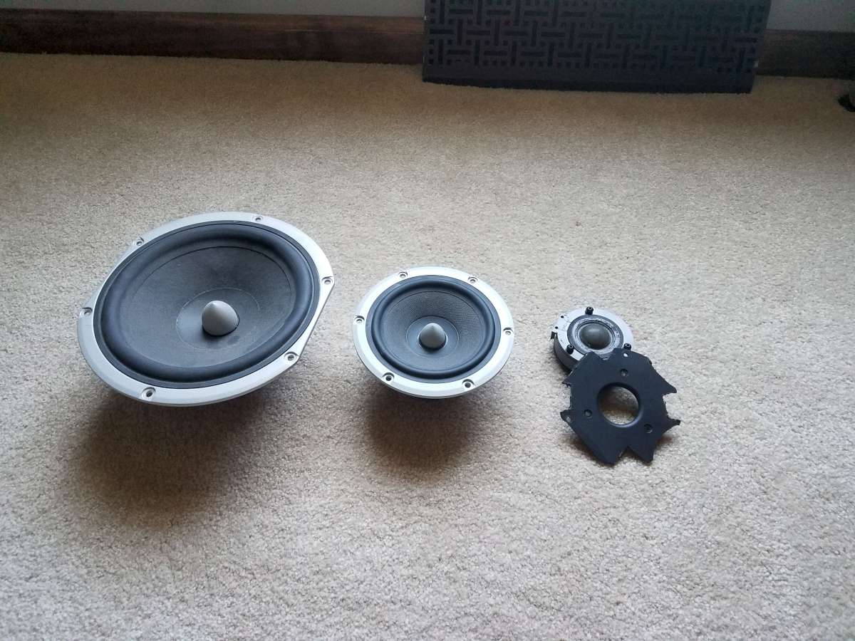

The drivers that I plan to use. Note - the automotive install that the Dayton Tweeters were used in required me to hack up the mounting flange for clearance. If I used these I plan to fab new faceplates out of matching hardwood.

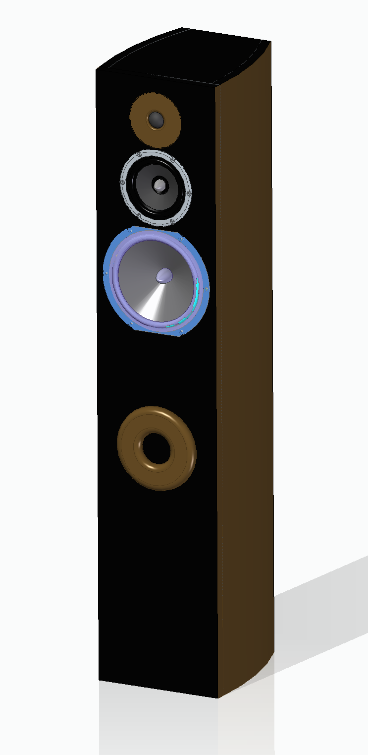

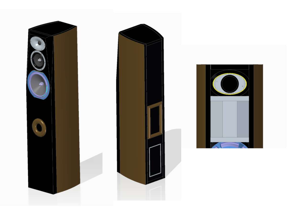

And a few CAD renderings of the initial cabinet design. 47.5" tall, 10" wide front baffle, approx. 11" deep. Brown surfaces will be solid wood (port ring, tweeter faceplate) or veneer (left and right sides). The height and depth were constrained to these values to allow me to use one roll of 24" x 96" veneer to finish them. Each brace has a different spacing (relative to the others) which should help to avoid having multiple faces resonating at the same frequency. The cavity in the bottom rear is for the crossover circuitry and will allow me to easily tweak the crossover design as needed.
(not sure why the images are distorted in the preview, they look fine if you click on them)
857751d1593804766-overdue-3-tower-build-front-iso-png
857752d1593804766-overdue-3-tower-build-inside-iso-png

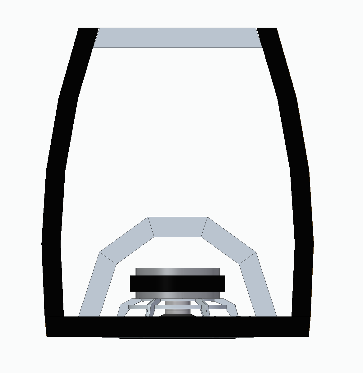

One thing I've learned from my readings on here (and elsewhere) is that non-parallel walls are good when making an enclosure for mids. I ended up settling on the enclosure geometry below for the midrange. Each of the five mitered walls is the same width and angle which should help fabrication. I'll be adjusting the internal volume as needed as I get deeper into the design process.
857753d1593804766-overdue-3-tower-build-mid-enclosurepng-png

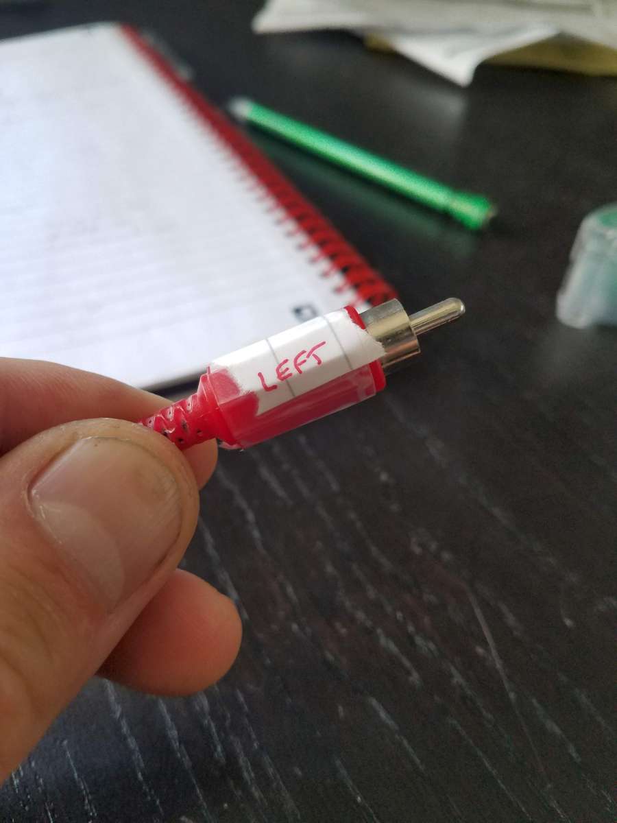

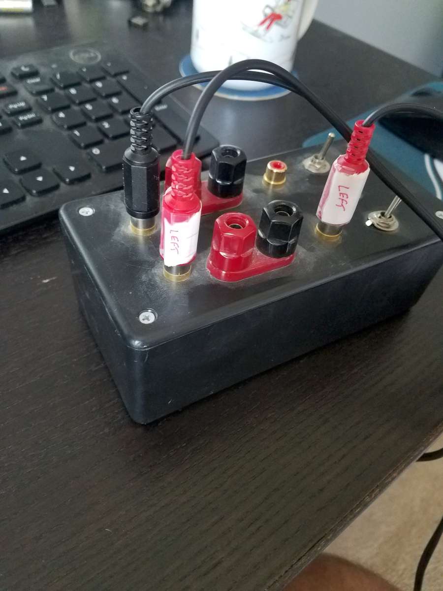

I started by dusting off the Wallin Jig and my old cables, and doing a DMM check on everything to make sure that age hadn't compromised the equipment. Wallin Jig checked out OK, but I was surprised to find that the 3.5mm stereo ->RCA cables I had used red covers on the LEFT channel RCA plug😱 Maybe assuming Red=Right was half of my issues in the past:guilty:
Labelled so I don't forget:

Setup for calibration:
859422d1594332910-overdue-3-tower-build-20200704_083430-1200-jpg
After getting what seemed to be a good calibration on the souncard & jig, I whipped up some stands to mount the drivers for free-air impedance measurements:

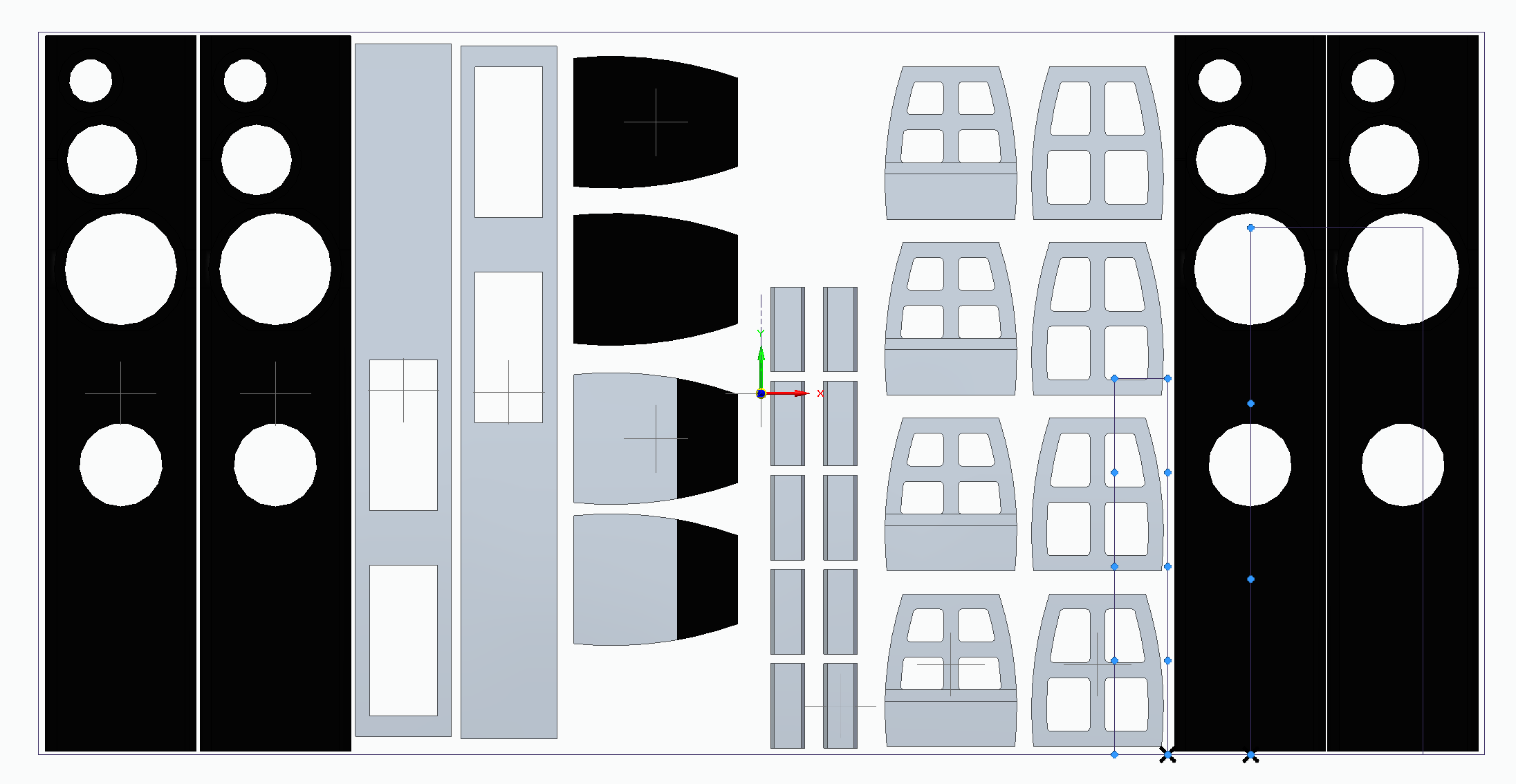

95% Final enclosure design (note - I pushed the mid/tweeter off to the edges based on some Baffle Diffraction Simulations...not sure if I'll keep them there or not yet).
859424d1594333524-overdue-3-tower-build-07-access-panels-png
A quick flat layout shows that I'll be able to fit all of the 3/4" parts on a single 4x8 sheet! The duplicate baffles represent the double-thickness front baffle that I haven't actually detailed out yet.
Next step is to finalize some of the joints, finalize some decisions on speaker placement and baffle edge dressing (roundovers vs chamfers), then start building some cabinets 🙂

Looks like I have plenty of room to make this recess geometry work with a flat faceplate or a waveguide. I'm looking forward to hearing his thoughts.
This geometry has been used successfully in horn designs as the rear enclosure, it has advantages. However rather than eliminating parallel surfaces, this makes the distance from the driver to the enclosure walls and back, identical in all directions. You will want to stuff your box appropriately if the midrange is to reach that high in frequency.
Those are some sharp looking cabinets! The elliptical waveguide is a nice compromise in keeping the profile more attractive as well as reducing the C2C distance between the mid and the tweeter. Of course you don't get the same vertical region of constant directivity as you would with a round waveguide but that's usually seen as being less important. The facets around the tweeter are a nice touch in making the cabinet seem narrower. Another benefit of a waveguide though is that it significantly reduces the effect of diffraction from the edges of the cabinet. You wont see the same bumps and wiggles in the tweeters response as you would if the tweeter was just mounted flush to the baffle. Of course the waveguide adds in it's own bump but that's something you want. As a result you could leave off the facets, for easier cabinet construction, and not see too much of a difference vs if they were there. Of course it wouldn't look as nice. 😀
Thanks for catching this and pointing it out. Seems obvious now in hindsight. It seems as though I've eliminated wall-to-wall standing waves, but have moved the the driver-to-wall standing wave frequencies all to the same value. Hmm, I'll have to chew on this a bit

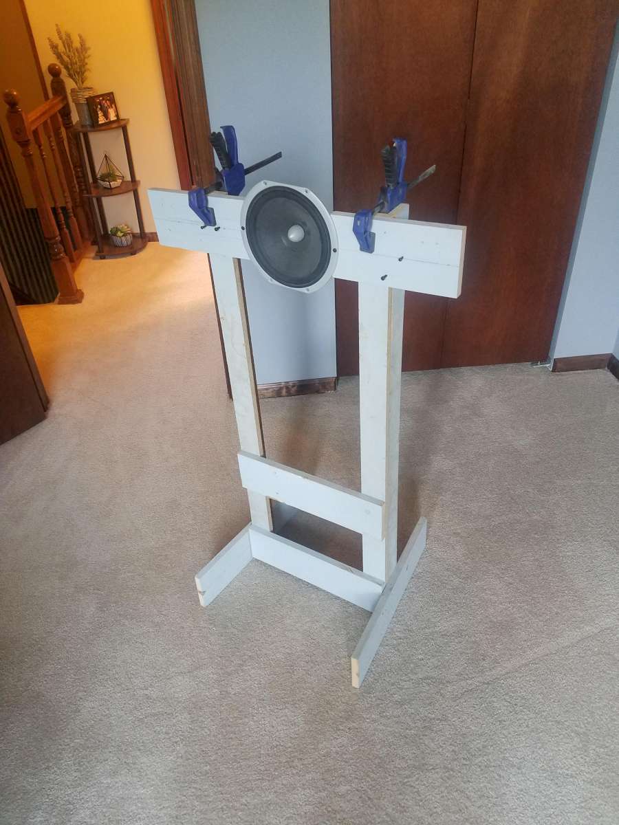

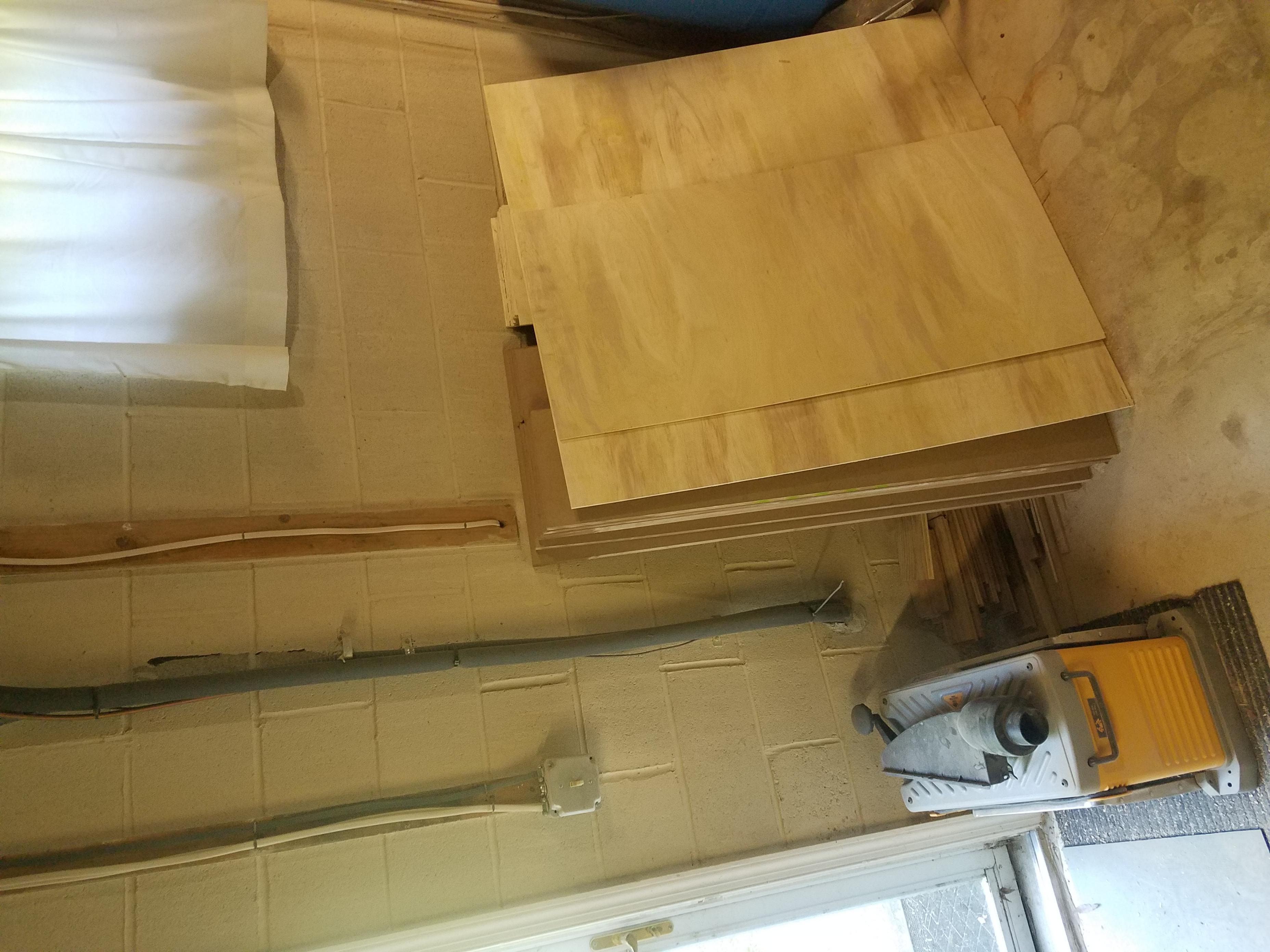

Picked up a 4x8' sheet of 3/4 MDF and 2x sheets of 1/4 sanded plywood earlier this week and this morning I broke it down into slightly oversized pieces that will be more manageable to put through the tablesaw for final dimensioning.
Err...sorry about the rotated photo. If i was on my PC I'd figure out how to fix it

Your speaker your decision. I won't get butt hurt if you don't agree.
Since only the woofer is truncated...
It is my OPINION (totally worthless) that if you rotated the woofer 90* the truncated frame would appear to be like that to make the baffle narrower. And therefore blend better with the other drivers.
Troystg - interesting you mention that, as I had considered it myself but every photo of a truncated frame driver was mounted as I have it (perhaps I didn't look hard enough.
Mounted as I have it, center to center distance is reduced. Rotating it would allow a narrower baffle and potentially better baffle diffraction characteristics.
I think I'll explore the pros/cons a bit more before I cut the recesses and facets
