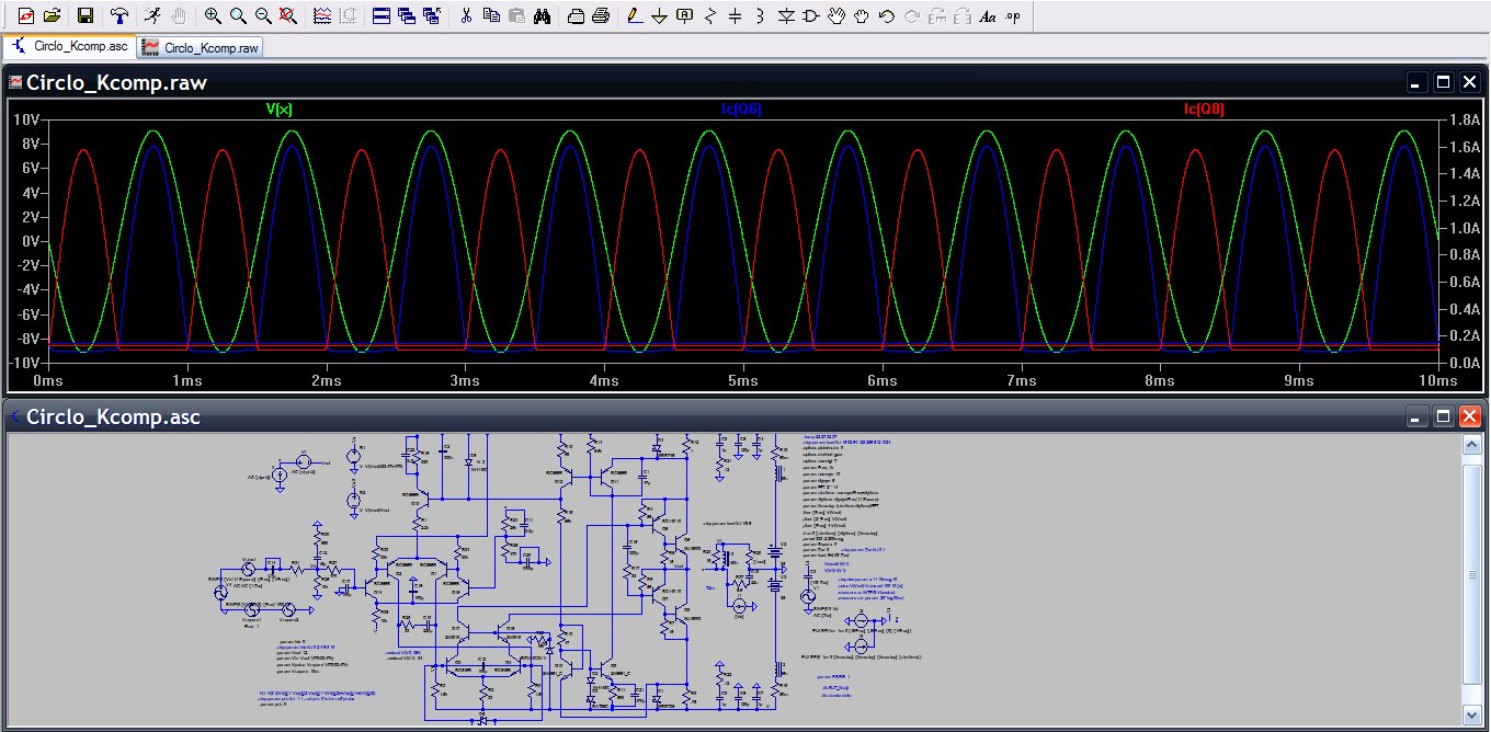

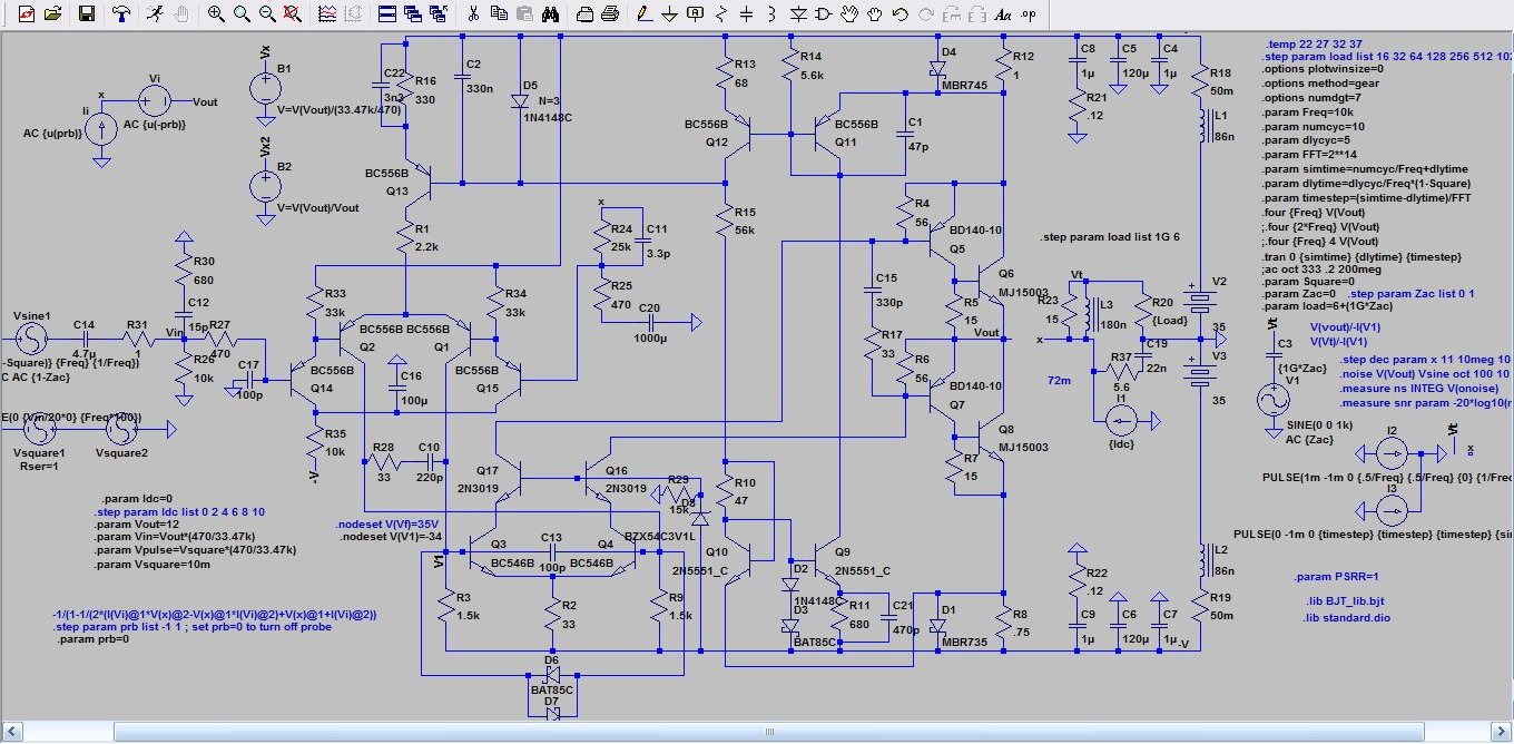

When you apply non-default minor parameters to a component, you should show it explicitly when you share a graphic-only attachment on the forum, Otherwise, it is completely impossible to guess (and even then, you have to look into the component in question, that's not obvious)I got these values worked out from adding a resistor series to C2 to represent a lossy imperfect cap. The sim freaked out with instability as usual, whenever that resistor is present.
Previously indicated at post 1039, there was indeed a temporary torture test, and after achieving the higher quality of hardened centerpoint values, all parts were re-checked and shown at default prior to posting.
As shown, it does not contain any non-default minor parameters. But it will resist them.
OK, it should be fine then.Previously indicated at post 1039, there was indeed a temporary torture test, and after achieving the higher quality of hardened centerpoint values, all parts were re-checked and shown at default prior to posting.
I do not get similar results, but I use the original Circlophone parts, that's maybe what causes the divergence.
The only thing that remains to do is to validate the circuit with a physical prototype, and check the improvements do indeed materialize.

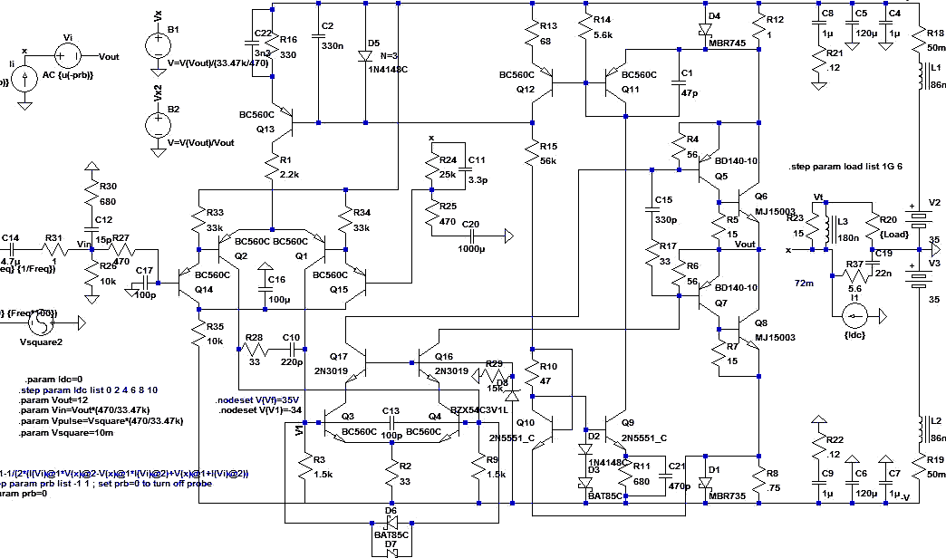

Refer to this schematic for your 20 watts (actually 27 watts):
http://www.diyaudio.com/forums/atta...es-beginner-friendly-circlophone-original.gif
If this looks overly complex, try an LM1875 for good practice.

Well, to me it looks like none of it is an overdo (let's check that again) and all of it is better than the usual strong miller comp or similar heavy-handedness. What looks familiar is that most good hi-fi amplifiers usually have a dozen small and transparent corrections instead of a big fell swoop. Although it is important that all of the corrections are small/transparent to audio, it seems even more important that all would be different so that they can't add up to any peak in the sonic signature. What do you think?The compensations being applied here are becoming, shall I say, multiplicitous... Though if that ends up with a better result, I think it's pretty cool.
Well in this case, the servo was out of balance. One side would be stable but the other would not. So one side had to be either sped up or slowed down.
That was my impression, that one half presented a different Bode than the other?
I kinda deviated towards a circlopony in complimentary symmetry, as-if that were
some kinda magic bullet to make both Bode the same. Now even with perfect open
phase, both differential halfs are equally unstable in .tran . I got rid of my input pair
Miller by neutralization, and there probably lies the greater part of my folly.
Neutralizaton on the top side only works when the tail isn't messing with the class
Aness of it all from the bottom side...

The output cannot swing very low with that cascode in the way.
Have you considered the existing negative rail for cascode base?
You would have to provide an extra negative rail for circlophony.
But it needn't be anything elaborate since the common mode is
strongly controlled by quadrature anyway, a 5v wart might do.

VAS, which VAS? As-if it were nailed down to one location.
The one that pulls up against constant current for half the cycle
Or the entirely other one that pulls down against constant current
in the opposing half cycle?
If the common mode loop is disabled, you have no less than five
transistors that could be VAS Q 5,6,7,8,16...

I havn't seen a schematic of this thread with BC560, at least not lately.
Also havn't seen where I can pinpoint a solitary VAS. Cascode voltage
could mean anything outside the context of a specific schematic and
reference designator that you have neglected to reference.
It certainly makes no sense in the default context of the most recently
posted schematic #1049. Please post your current schematic or link to
past required to make sense of your statement.

I don't know what it means without seeing the difference between two options. Could you post a schematic, so I could see?The output cannot swing very low with that cascode in the way. Have you considered the existing negative rail for cascode base? You would have to provide an extra negative rail for circlophony. But it needn't be anything elaborate since the common mode is
That is doable. See attachment.I havn't seen a schematic of this thread with BC560, at least not lately.
That was a fluke. Hopefully someone would use BC550 when it comes time for the NPN. Point taken--BC560 vas did look a bit odd. So, anyway. . .I love the way you use BC560 as both an NPN and PNP.
How is your demonstration schematic coming along to explain that extra negative rail to fix the cascode? I just can't quite imagine it from the words, but a schematic or even a sketch would be great.kenpeter said:The output cannot swing very low with that cascode in the way. Have you considered the existing negative rail for cascode base? You would have to provide an extra negative rail for circlophony. But it needn't be anything elaborate since the common mode is strongly controlled by quadrature anyway, a 5v wart might do.
Actually, using PNP for Q3 and Q4 is an interesting idea. This would reverse frontend and servo phase, making it an involving change.
I tested the idea. It seems to work, but with a THD figure approximately doubled, which is consistent with the degeneration of 4 junction resistances in the VAS, compared to two in the regular Circlophone.Actually, using PNP for Q3 and Q4 is an interesting idea. This would reverse frontend and servo phase, making it an involving change.
