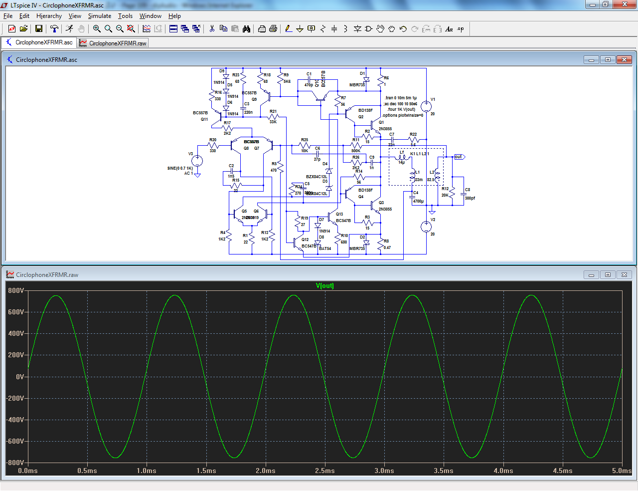

Some transistor models are not included, so I couldn't run the simulation,
The models I used are all included in the file Cordell.lib that is included in the zip archive. I have included the used models in the file and changed to standard models if available.
but anyway the likely cause of the problems is the lack of a DC blocking capacitor in the output, and/or a low/absent winding resistance for the transformer.
I wasn't able to track the actual series resistance used by the simulation: I saw it equaled Rip, which then equaled Ris, but then I lost the track.
Rprimary = 0.15R, Rsec=4252R
Even if there is a finite series resistance, it is probably not a good idea to drive the transformer directly: normally, this type of transformer is ungapped and has a high permeability, and the winding resistance is low.
All this means that even a negligible output offset voltage will be sufficient to saturate the core.
The transformer is a C-core with double bobbins. At the two gaps I inserted a small piece of plastic, so probably 2x0.2mm gap is there (I must verify if the gap is included in my transformer-model)
It will also cause a high dissipation in one of the OP transistors, because the amplifier will try to impose this OS voltage to a low resistance.
Ok, good to know.
Try inserting a large cap in the output, this should fix the problem.
Just tried it with output caps from 1µ to 200 µ and the dissipation is restored to the level of a load resistor. Unfortunately the output is also reduced.
BTW, making R23 ~=0 will probably cause problems. Even if they don't appear in the sim, the reality will be less forgiving.
This was left over from a test to see if it made any difference. In sim with higher values or R23 I'm getting a lot of oscillations.
Thanks for the advice, I'll try to further understand what is going on inside the loops (I'am not an electronics guy, just trying to understand and finding a suitable amp for an ESL, other than buying an Ncore).
OK, let's say you want to keep the offset current into the primary under 10% of the quiescent current, thus Ios<15mA, which I already find uncomfortably large.
This requires an offset voltage smaller than 2.2mV.
It is doable, by using good quality hand-picked input transistors.
Some builders have achieved under 1mV offset with this method.
But anyway, that is not something I would recommend: without any protection, a powerful subsonic signal that is slightly asymetrical could lead to the saturation of the core, with disastrous consequences.
2 x 0.2mm looks pretty large, it will seriously reduce the magnetizing inductance, and this could become problematic at very low frequencies.
Anti-saturation spacers are more like 0.05mm.
The value needs to be very much larger than that: it should be 4700µF or something like that.
If you don't like the idea of a big E-lytic in the signal path, there are alternative ways to arrange the feedback path.
The transformer too could benefit from inclusion in the FB.
I recommend you use the standard Circlophone as a starting point: it is stable, both in sim and in reality.
You can then make incremental changes from that base to see the effect of your mods.
This is probably the safest approach, since the sim is not very good at predicting subtle, marginal modes of oscillation between the different loops.

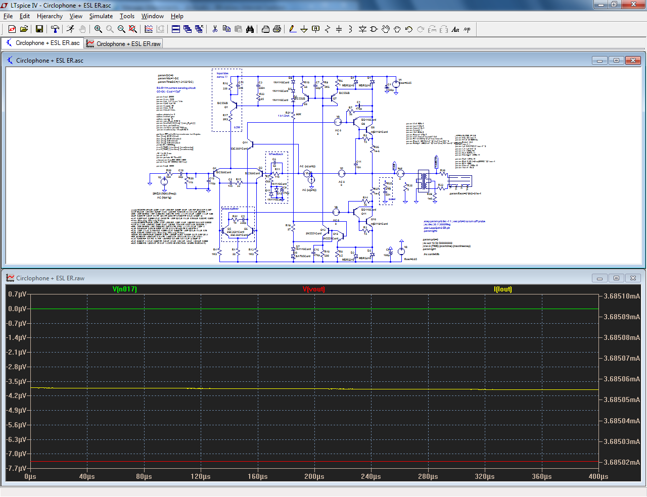

Including the input capacitor to balance the input LTP results in an offset of 7µV (that's in sim, obviously).
The offset current falls to 3.68mA, but this means this is incorrect:
These values yield a primary resistance of ~2mΩ

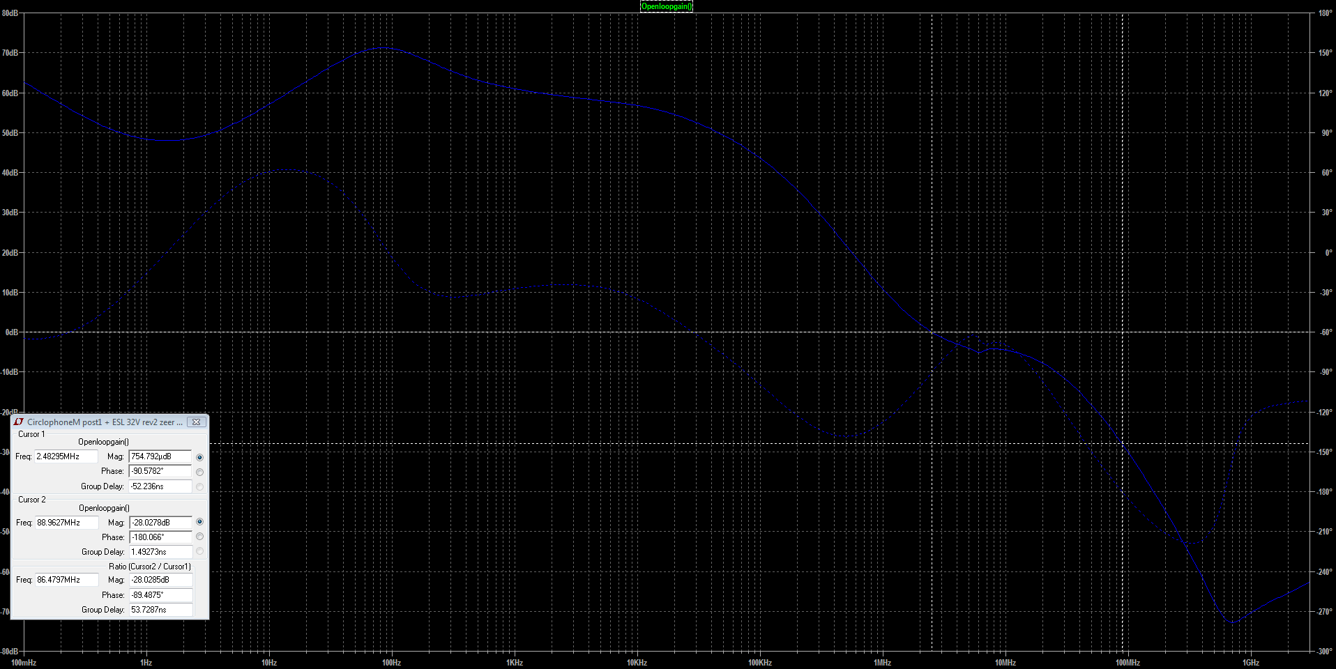

I did restart from the schematic of page1 and made some gradual modifications, based on following ideas :
1. at 20Khz, the input is limited. When the supply is increased this limitation was removed. This also seems to reduce distortion (I went to +/- 54V).
2. The increased rail voltage exceeds the voltage-range for the input transistors Q3/Q4 so I swapped the BC560b (Vce=45V), to BC556B (Vce=65V). This might be less low-noise, but I don't know if it matters here.
3. Q13 is changed to a 2SC3601 to exceed Vce > 2xVsupply)
4. Q8/Q10 are replaced with MJE21194, with higher power rating.
4. Based on on off the last schematics of (Keantoken I believe), I played with some capacitors parallel to emitter resistors of Q1/Q2/Q13. These capacitors do not seem to have a influence on the bias-servo, but reduce some oscillations at high frequencies (20 tot 100 Khz).
5. With these modifications and the insertions of a primary side resistor of 0.66 Ohm, I'm getting very good results (THD 2-20 of 0.004% from 160Hz to 20KHz on HV side of transformer, so transformer distortion include), phase margin of > 90° and gain margin of 28dB.
I'm still having some doubts, because a test of square wave stimulation gives me always very strange results. (the output is always either positive or negative, but never symmetrical. The same problem I have with the original circlophone with a load resistor, so it is probably something I do wrong.
Sorry for the long rant, but I’m eager to learn more about this "simple" amplifier (simple as in parts, I still do not understand all the different loops and interactions).
If this gets to far of topic, let me know,
Edwin

The square source is a great big failure on Linear's part regarding LTSpice. The simulator solves the operating point according to what is the initial value, so you end up starting the simulation with the input cap charged wrong. There is no complete way to work around this.
It looks good, but be prepared for some tweaking in the real circuit: the dynamic aspects are not covered very reliably by the sim, and some adaptations may be necessary.
