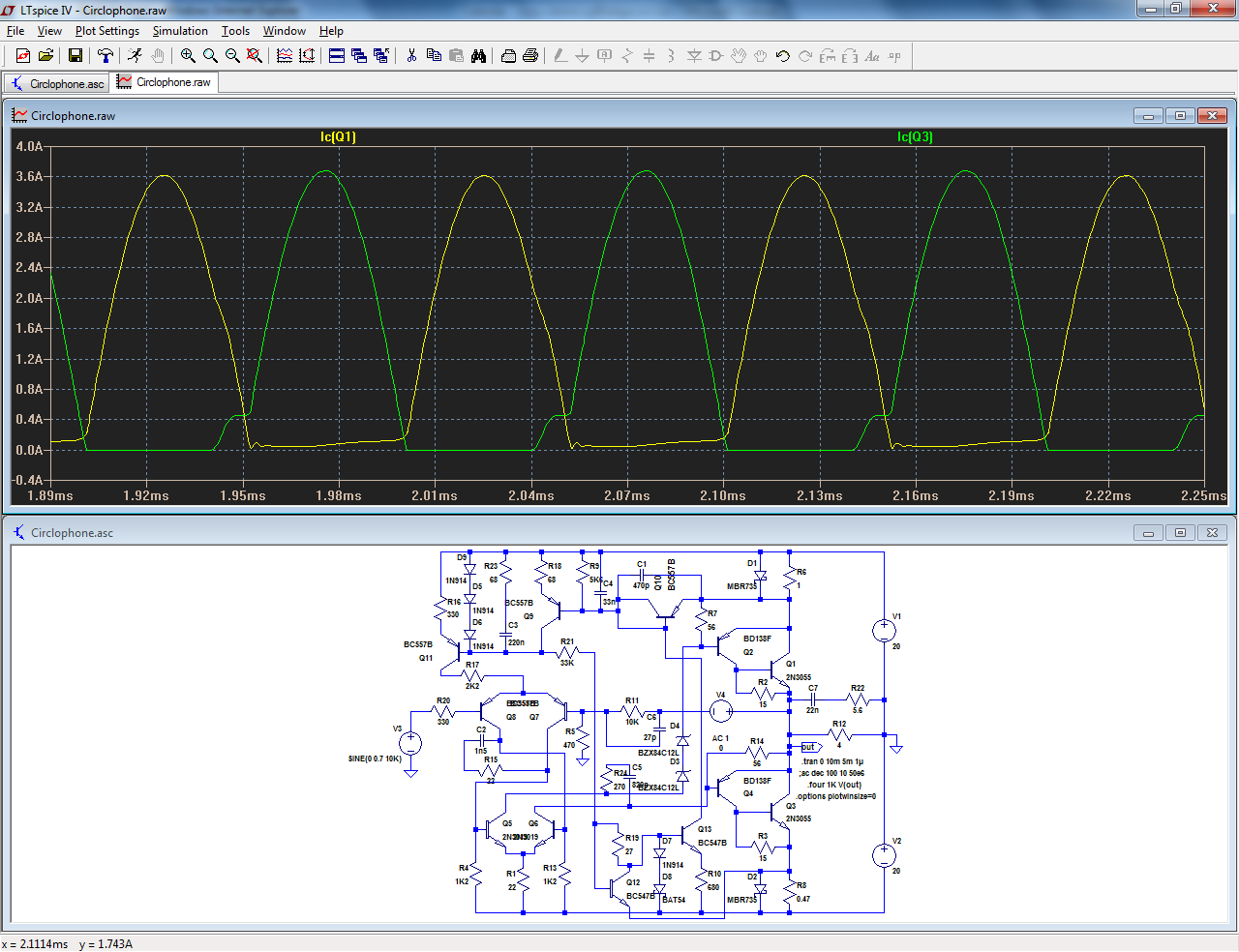

the Ccb participates to the overall compensation, and if it disappears something else will have to make for it.
This is not necessarily true. Ccb is miller compensation. The VAS compensation is shunt compensation. One probably works better than the other, and has less performance cost. Furthermore, the application of Miller compensation to the VAS when not cascoded is lopsided, creating an imbalance which causes Q3 to output more current, with Q4's gain lowered by the miller.
Dan has the most recent sims, maybe he can do a quick demo.
More specifically, 8x lower distortion, than without a cascode.
OK, I made a quick test: without any cascode, distortion is 0.0045% (+/-20V supply, 32Vpp out on a 4Ω load).
With a theoretically ideal cascode, it becomes 0.0035%
With Daniel's cascode, it is 0.0044%
With Ken's cascode, it is 0.0040%
Ken's version is marginally superior, but more importantly it doesn't harm anything and plays the role of the zener.
In my simulations the improvement was at most 2x less THD. Maybe Dan's figures are from his high-bias simulations... The effect depends a lot on VAS component, implementation and so on. I noticed in Dan's schematic the VAS was cascoded at 16V - which could explain his better THD specs, but this really limits the negative swing. VAS devices which aren't overpowered don't benefit much from high cascode voltages (hint hint). May I suggest what is potentially the most reasonable, well-performing and hazardless option, attached.
Maybe NXP has models for the BC337-40, I haven't checked. The BC550C might work better but with less Ic margins.

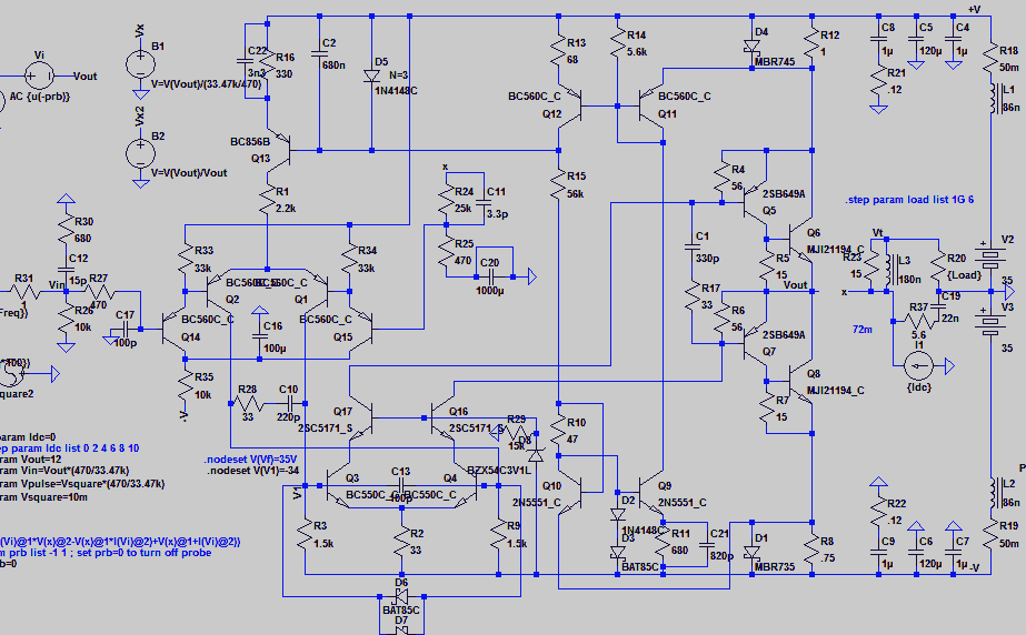

does it really matter? can you actually hear the difference?
To be honest, I don't think so.
But when you have two completely equivalent options from a cost perspective, I think it is better to choose the superior one, even if the difference is marginal.
And anyway, by accumulating numbers of marginal improvements, you end up with better designs.
I like to make it a practice to go for a superior design even in the face of diminishing returns when cost is not prohibitive. After all, how do we get better at what we do when we aren't striving for improvement? There has to be some testing ground for creativity and experimentation. It may not sound better but a gain in skill is always a good thing, and helps us in the other endeavours where it actually matters.

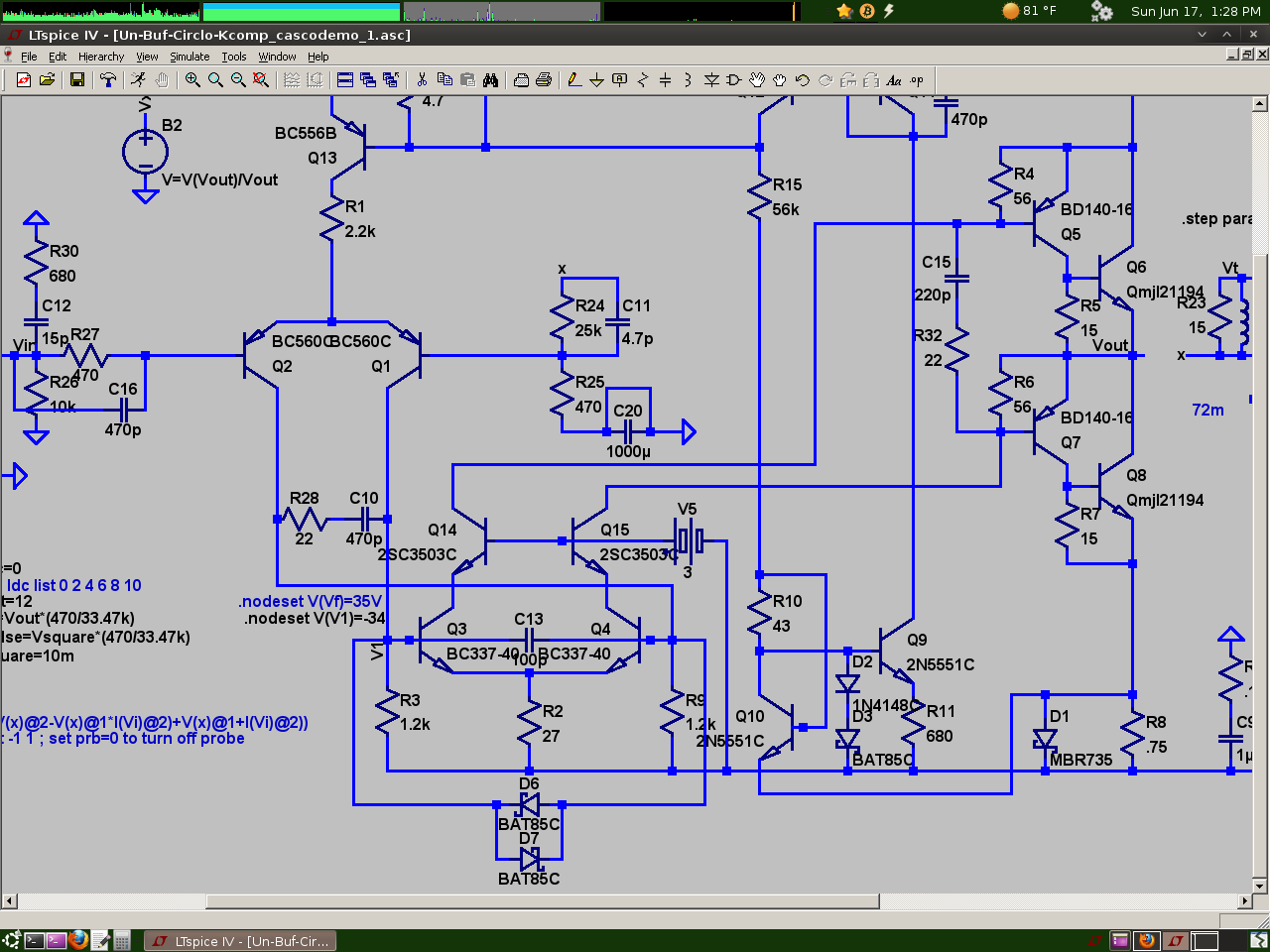

Your involvement with this topic brings some interesting ideas for topology. That's what I like about benefits of innovative spirit.
Also, dunno if you know this, in LTSpice, Tools->write bitmap to clipboard and then paste into MSPaint will give you an instant schematic with no need for cropping window borders. Too bad it doesn't work in Linux.
Tools -> Write to a .wmf file works under Linux for exporting schematics. An average image viewer application can open and export to other formats if desired.

CFP's drawbacks seem can't be deflated without heavy compensation?
Not true, but you can say it this way: CFP's drawbacks can't be deflated without specific compensation.
And this means that either you have a scope handy or else you make an exact copy of Elvee's schematic at exact same voltages with exact same parts. Unfortunately, substituting makes the compensation invalid, and the CFP version isn't as tolerant. SO, if the published modestly low power version isn't what you need, then you're up that proverbial creek without a scope.
The CFP version needs additional individualized schematics (possibly numerous) representative of each change, such as voltage and vas parts will need little adjustments for success. . . which would be a different schematic every time, but that is the way to do a CFP build without a scope, if someone already used a scope to verify that exact same build at the exact same voltage and with the exact same parts, thereby identical copies work.
In a nutshell, the CFP build requires tighter tolerances.
Is this for buffered variations from Daniel? If not, could you elaborate that why your latest pick hasn't any buffer please?
The buffer is Kean's, as you can tell by the BC560C army doing an excellent job at small signal. Its removal from the schematic was my fault--I removed it because the buffer is too helpful to the simulator. The buffer helps tolerances (opposite of the CFP), and I did not want the buffer's help while determining component values. Instead, I wanted to work with the values and then re-add the buffer again, at the last moment, in order to maximize its effectiveness. The 2 transistors, 1 cap and 3 resistors should be easy to add at any time.

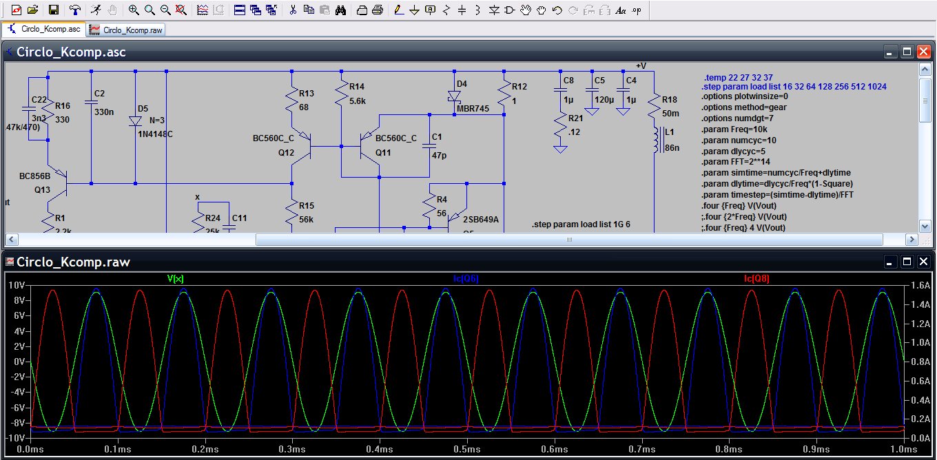

Kean worked hard to straighten me out and then we worked for most of the night on this new simulation. I didn't manage to contribute much other than some device selection. The drivers could be BD140, KSA1220 or 2SA1930 with practically the same results, and many different parts are usable for vas. See attachment.
Here again, fiddling with the quadrature loop has nasty side effects: since C2 is larger and has no series resistor, the loop becomes unstable and requires phase advance capacitors C21 and C22 to be stable again, and the gain of the loop at high frequencies is ~0 which means the effectiveness of the correction decreases quickly with frequency to the extent that the non-switching action lost from several KHz.
Did you try it? C22 has the same effect as a resistor in series with C2. C21 helps with stability and makes switching smoother for the lower output. In my simulations the version with 220n for C2 and a 68R series resistor was unstable and the lower output had strange overshoot. This version seems better behaved, even to several KHz.
Combination approach works
Thank you sir.
Error: The simulator had (again) assumed an absolutely perfect cap at C2.
I returned C1.
There was no need to remove it since it is helpful for tolerance if it isn't too big. After re-deploying C1 (100p or smaller for reduced glitching), then some of the new compensation was oversize. C2 went to 330n (range 220n to 470n). Not shown, C21 went to 470p.
I got these values worked out from adding a resistor series to C2 to represent a lossy imperfect cap. The sim freaked out with instability as usual, whenever that resistor is present. Then I added capacitance at C1 until even a lossy red polyester dip cap could work at C2 (and I hope we use a better cap instead). And lastly, I removed the destabilizing resistor from C2.
Success!!
Practical cap losses were swamped and surely no need to add any. With the sim set at 1k, 10k, and 20k, it is the same each time--no switching. Distortion raised to 0.0014% but stability should be like you wanted (see attachment)? If that won't do it, try C1 at 100p which is almost big enough to be bad but rather 100p there is the make break point. 47p is less distortion.
