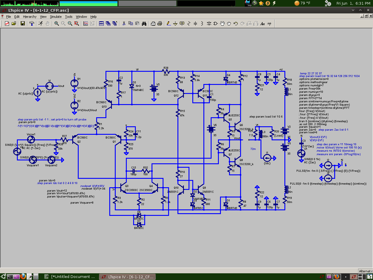

The compensation amounts to a dominant pole scheme, but unlike the classical Miller of a "normal" amplifier, it doesn't have a negative impact on the slew rate, which is good.
It does have one serious drawback though: the corner frequency is pushed much lower in frequency, and as a result the loop gain*bandwidth product is only ~130KHz.
This means that the distortion is much higher.
Now we just have to find a scheme combining the best of both worlds...

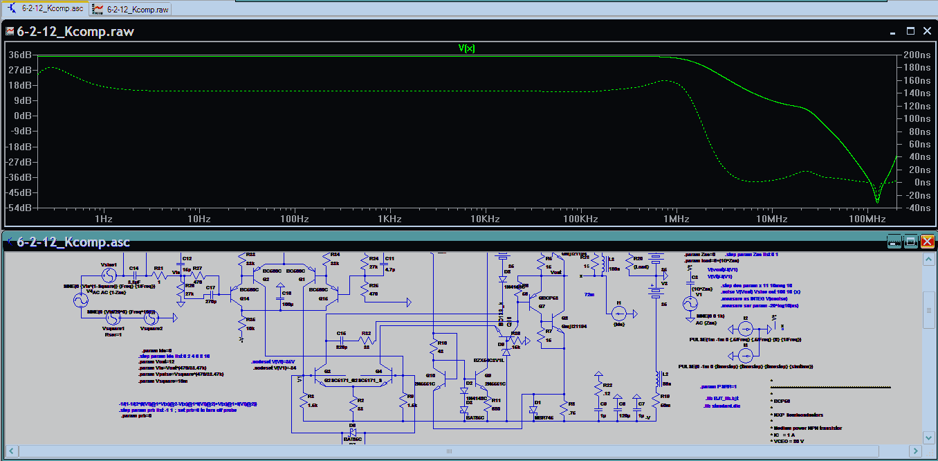

I don't know why you say the GBWP is so low. In simulation it is 2.56MHz, and distortion at 1KHz is below .001% at 12V into 6R.
Remember I lowered R31 and R33, causing the input stage RC comp to become about 15 times bigger, but this is just an impedance thing, the loading hasn't changed. This scheme makes the amp as fast as it will go without significant overshoot.
All my sims so far suggest CFP is only useful below 10KHz and it hurts BW and makes distortion a little worse at HF. So I'm going without it for the time being.

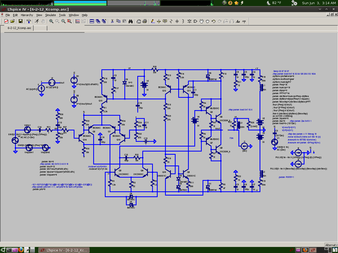

There are several ways to make this amp stable without significant overshoot, but this one has worked the best so far. My current simulation has a GBWP of 7.3MHz and a slew rate of 110V/uS. 1KHz distortion hasn't changed, but it is a whole lot faster. This causes stipulations.
At this point the input would become a GDO and would need to be shorted to ground with several hundred pF, and even that may not be enough. An input buffer would trivialize this, but that adds a transistor to the circuit and may complicate DC offset. The Jfet buffered schematic I've seen would probably work well for this. Ground plane may also help.
THD at 1KHz is still about .0034% at 12V into 6R. BUT, at 20KHz it has been brought down from .02% to .006%.
There is a problem with the speed. When slewing the VAS tends to go into class B, and this causes a jump in output current bias while switching, up to several amps. Thus I've fitted the Schottkeys across the VAS. This limits the slew rate to 60V/uS, except it's the diodes that are saturating, not the VAS or the output stage. Small signal behavior is the same.

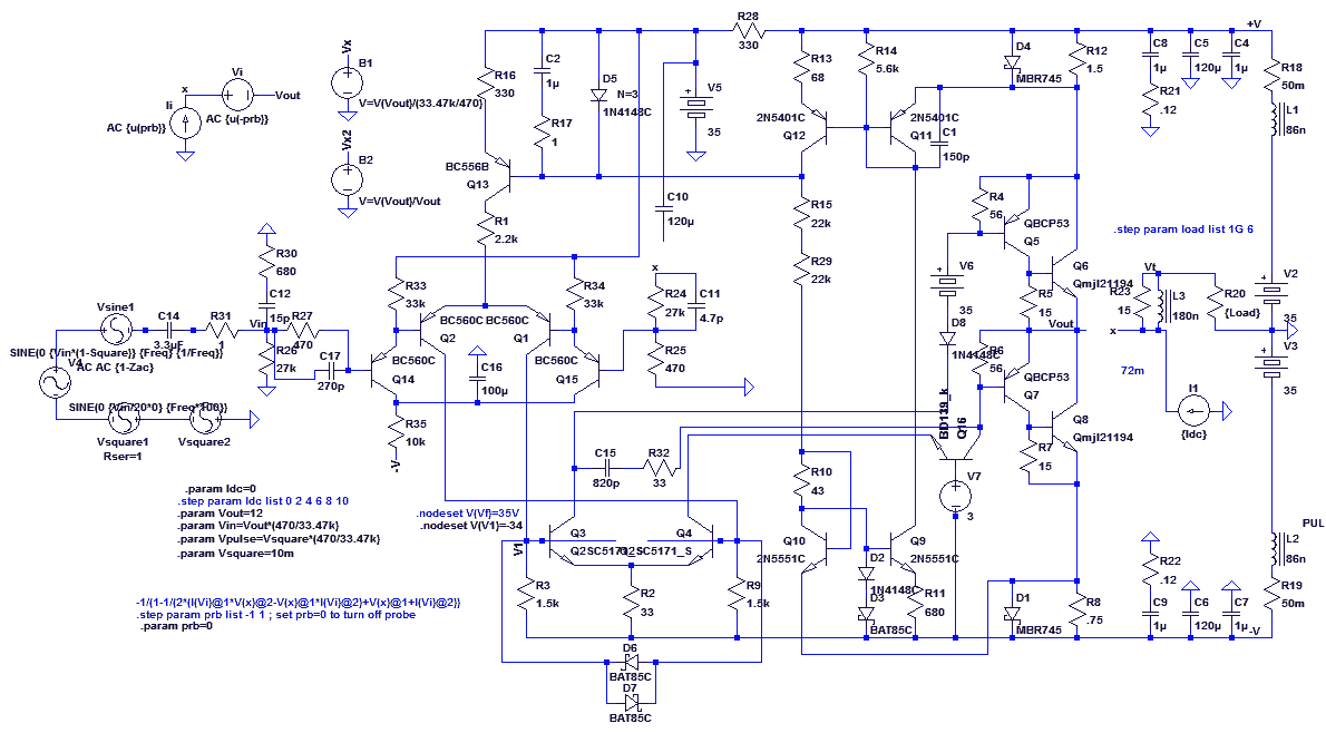

OK, I had missed the resistors change, now I am a little under 1MHz, but that's probably down to the different types of transistors you used.Remember I lowered R31 and R33, causing the input stage RC comp to become about 15 times bigger, but this is just an impedance thing, the loading hasn't changed.
A problem with low value resistors is the bias current, which is only moderately improved compared to a non-CFP stage.
In my simulations distortion increases by 20 times if you have a 25k source impedance, which will occur if you use a 50k volume pot.
CFP helps with this, but I think an input buffer may be better for this specific problem. We could buffer the entire LTP with the same number of transistors. With this schematic distortion only increases by 2.5% when 25k input impedance is used.
It should 25 kOhm maximum for a 100 kOhm pot with a preceding voltage source, 50 kOhm from cursor to ground in parallel with 50 kOhm from cursor to source.
With modern audio components, one should never use more than 10 kohm for volume control pots.

I have a 100k stepped attenuator I'm using, my amp has an input impedance of 150k (buffered, so source impedance is hardly an issue). Before this, changing from a 10k pot to a 50k pot made a big improvement. I suspect it is soundcard issues since I'm using an on-board card (stac9227). Lately I've decrease the soundcard volume and increased my amp volume, this too seems to help.
The peculiarity of the input impedance has been signaled from the beginning:In my simulations distortion increases by 20 times if you have a 25k source impedance, which will occur if you use a 50k volume pot.
Here are some additional characteristics and information:
The input resistance is ~10K, but the source impedance is preferably kept below 1K, because of the base current modulation caused by the bias servo.
It is an annoyance, but a relatively minor one in a semiconductor environment, where impedances are best kept low: a 4.7K pot brings practically no degradation
On an other subject, I was aware that a "decompensated" version could be made stable in sim, but in practice I was never able to reach stability without the additional components.
However, my tests were made with closed loop gains ranging from 10 to ~20.
It might be stable at higher gains, I didn't test it.

Instead of increasing gain, the same thing could probly be done with degeneration.
The input buffer is important if you want to make your amp very fast. Else it will oscillate depending on the source. I've done this with my own amp.
. . .However, my tests were made with closed loop gains ranging from 10 to ~20. It might be stable at higher gains, I didn't test it.
With a modern source and with gain at potential, if 30+30vdc rails the feedback resistor should be 20k in real life. Therefore, what, proportionately should the feedback resistor be if 37+37vdc rails?Instead of increasing gain, the same thing could probly be done with degeneration.
Unless that was a trick question, 30/20k~37/25k.
I kind of prefer to have highish gain, in the practical sense. Having an available boost can helpful.
The problem is not the input impedance but the bias current and degeneration will not help in this case.Instead of increasing gain, the same thing could probly be done with degeneration.
The bias current is dependent on the tail current, which is itself under the control of the servo.
I totally understand the input impedance and LTP base current issue. I was meaning for making the amp stable with smaller compensation values, without increasing gain so much. Degeneration is an alternative to this.
I found that using too much phase lead (say 47pF) compensation made the VAS compensation values skyrocket. It was better to use no phase lead or use the NFB network in my first schematic. I used a very small value in my later schematics (1.2pF) but this is not very practical.
