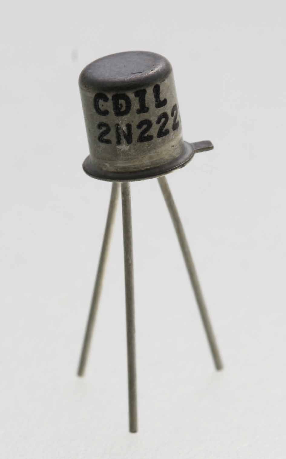

That's for people who don't do any phase inverting in the dark.Why this picture of an opto transistor of all the things ??![]()
Hi Prof,
Its a google thing, don't know why an image of an opto transistor has appeared...😀
Let me correct it, we might be getting the wrong impression here..😉

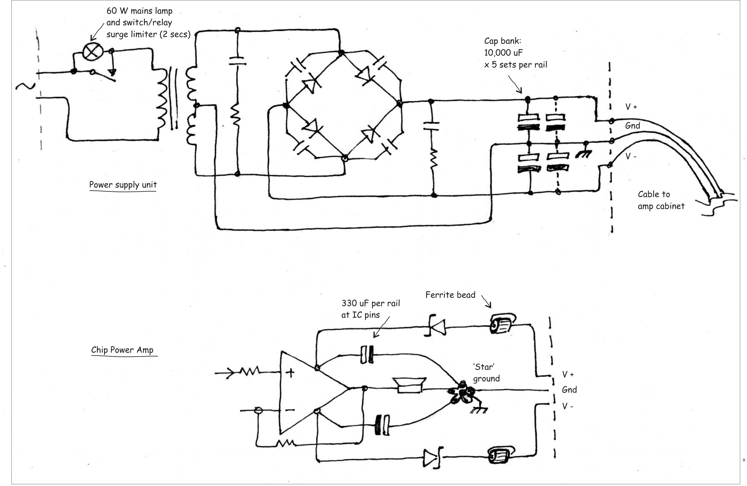

Allow me to present the following-- for what it is worth.
The last few days were spent in serious listening, some re-think -- and then some mods. We had always thought that it was better to use our gear to listen to music, and not use the music as the reason and the tool to listen to our equipment... 😉
My apologies for sticking to the Chip amp; but it was familiar territory to our ears and I wanted to come to some definite (!) conclusions so that I could adopt a similar approach to the Circlophone project. With Elvee's eagle eyes over our shoulders, we were as impartial and objective as we could!
Please note the changes. The switch-on surge limiter has been moved to the transformer primary side. It is nothing more sophisticated than a 60W mains lamp and a switch. (which will soon be replaced by a power resistor and relay, with a 2-3 second delay.) The capbank now is 'pure' electrolytic, and nothing else. The (axial) caps are arrayed upside down, and connected by strips of solder-coated pcb material, one each for V+, V- and ground -- true power 'rails'. 😀
Moving to the amp, there is a single 330 uF mounted on each supply pin. The 'isolation' Schottkys have been moved here, and the power input has a couple of small ferrite beads, which made a subtle but audible difference, all of us felt.
All I/we wish to say is, the whole exercise has been worth it!

Prof, normally you'd want to tune a power supply to a specific amp after you've built the amp. For example, it would be best to tune the power supply after you built a Circlophone.
Your original/earlier schematic was better, since it featured caps within the amplifier enclosure for speaker return bypass. The soundfield can be bigger when the return force from one channel doesn't invade the other channel, of a stereo amplifier.
Smoothing and storage are two different jobs--You wouldn't pump AC into a battery that's hooked directly to an audio amp. Likewise, we don't want to omit the smoothing section that should come before the cap bank. On your earlier schematic, you can use approximately 3,300uF caps directly upon the rectifier, next the inrush resistors, next the cap bank. . . aha! A nice clean CRC! 😀 When so much cleaner charge, your cap bank can be less excessive and therefore less expensive and still run much cleaner than before. It is important to do something technically good before tuning by ear.

@Dan: I would be happy with a "good" PSU that could do its job with any amp, of course, within limits. 'Tuning' is a good word, provided it is applied to fine-honing the basic traits of the PSU, rather than making it uniquely partner a particular amp. The requirements of the chip amp and Circlophone are not much different, and the power requirement could be as per spec. But here we are trying to decide on a 'topology' that is as near to the ideal as can be vis-a-vis its effect upon audible performance.
You seem to have ignored my mention of the serious listening exerise. The simple conventional, the complex earlier design, and then some were compared one-on-one. Then only we (three people, two much younger and with better hearing... 😉 ) arrived at the present simpler circuit. Please note that the smaller parallel caps were axed as they provided absolutely no audible improvements. (Believe me, it was not easy to decide to do that...) Do note that the small electrolytics on the IC pins were more than adequate, the isolation Schottkys (two each per channel) providing the 'dual mono' channel isolation of speaker returns. Moving the surge limiter to the primary side and switching it totally out of circuit after a few seconds improved things a lot, especially on sustained high-level, transient-rich signals. The capbank reservoir altered the character of the amp's delivery totally. If you are queasy about the speaker return, you may try a higher value cap on the IC pins/amp board.
Smoothing and storage might be two different things, but I dont think things work in that simple manner in the PSU circuit. And speaking of C-R-C filters, I would any day go for an L-C, all things considered. We have a lot of theory and "accepted" practices like bypassing a large cap with a smaller one and then a stilll smaller one etc. People have done a lot of analyses of CRC and LC filters and regulators, snubbers...what not. But doing the best job you know as per theory is one thing, and discovering that a simpler solution is better (audibly) is another. I would choose to go with something like this for my Circlotron (difficulties with some parts sourcing is holding it up)-- unless somebody convinced me I was committing "hara kiri" with such a design.
The above PSU mods were the result of careful 'elimination' -- and the "best man" won, I must say.
Now it is left to pundits like Elvee or others to guide us with some sensible theory -- and practice.

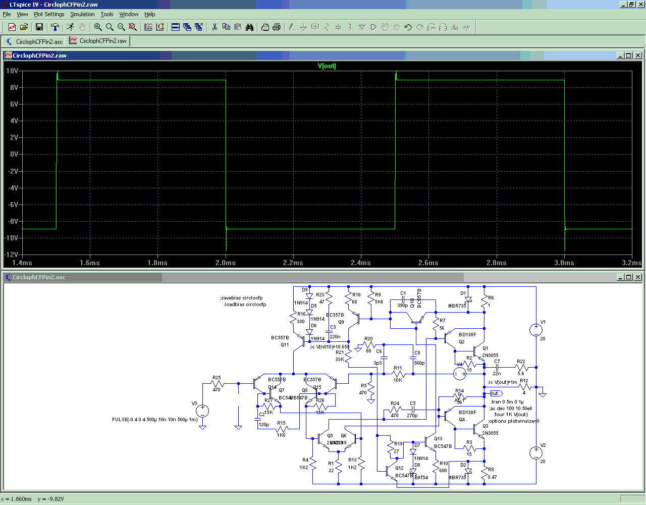

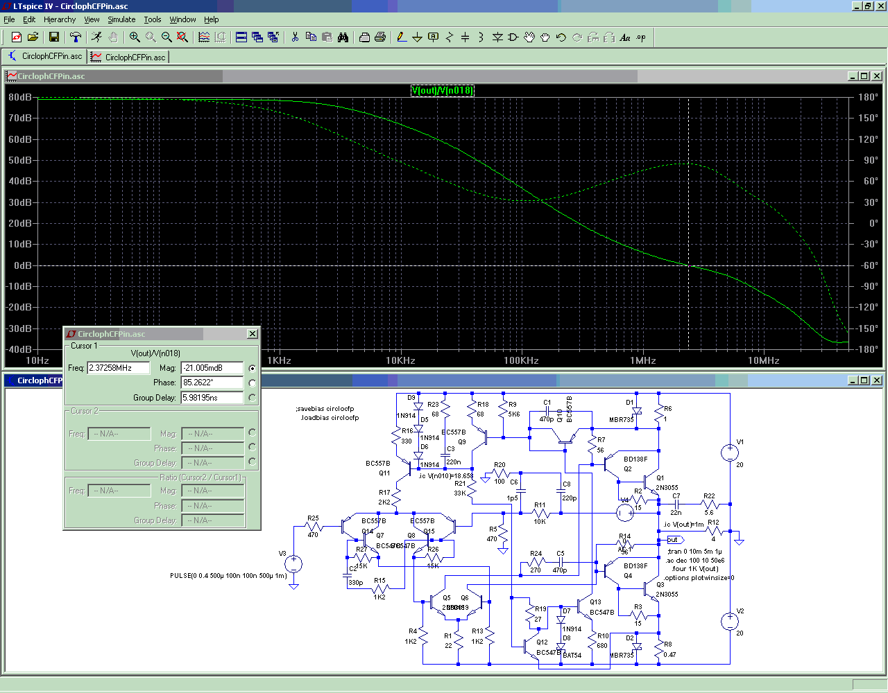

I have not been very present these times, I have been busy investigating an issue raised by Piersma, and building a 12V adapter for the Circlophone.

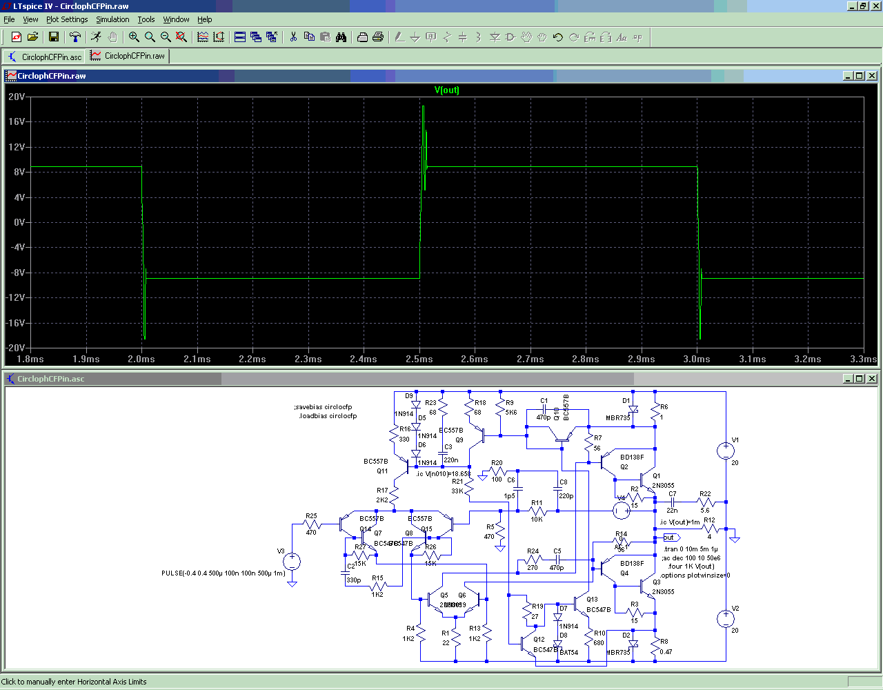

Piersma and others have noticed that the CFP version has strong overshoot when subjected to a squarewave signal.
I have to remind everyone that, to date, the only "official" version of the Circlophone is still the original.
I have studied some variations, including the CFP, but I didn't optimize them the way the original was, or subject them to detailed and in-depth tests.
The behavior of the CFP is therefore not particularly surprising: I just made sure it was stable, and could reproduce music, but that's about it, and additional experimentation was advisable.
The first pic shows the problem simmed.

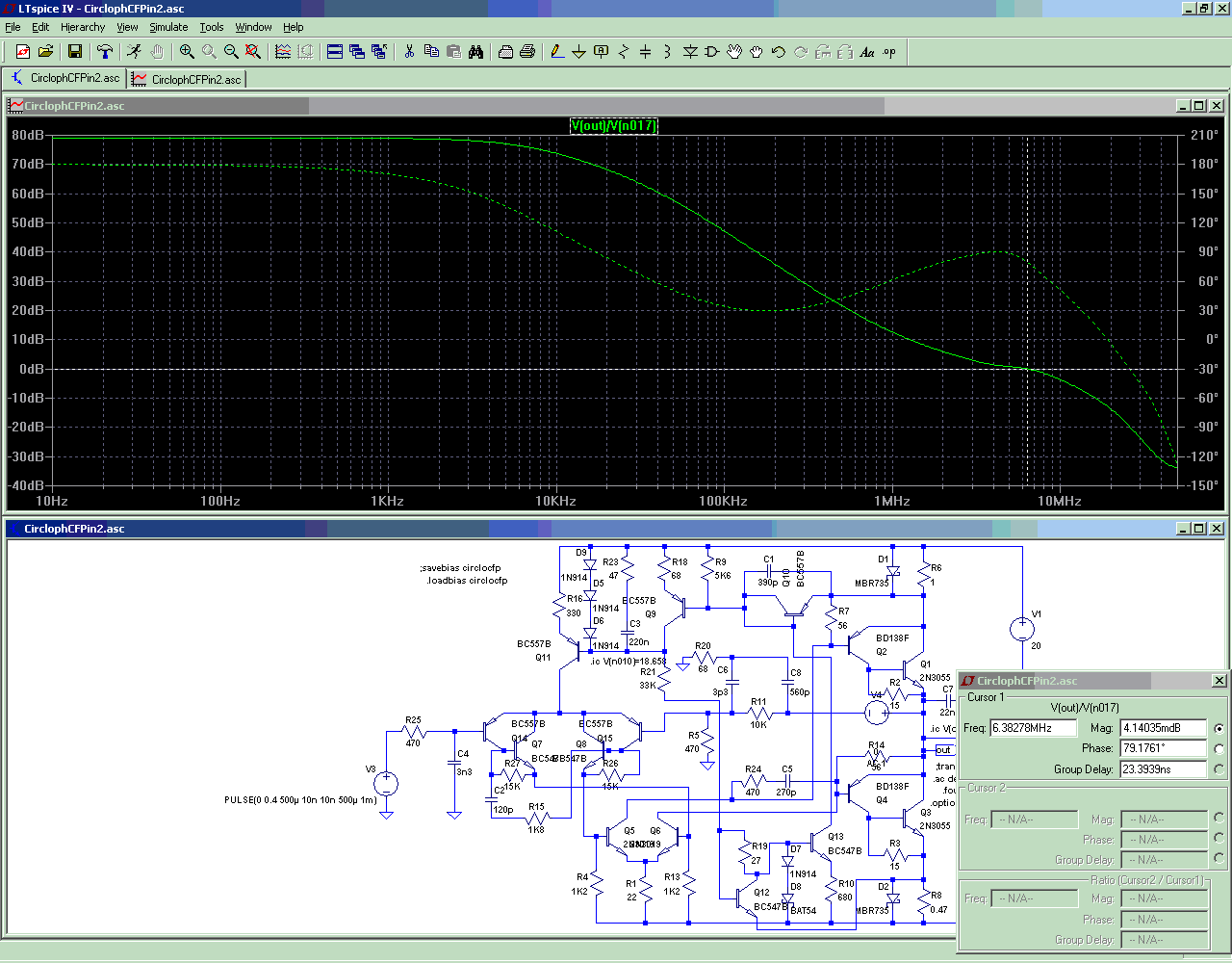

The second pic is the stability plot: it shows that the problem has nothing to do with the "linear" stability, which is excellent: in fact, the fast edges trigger instabilities between the two loops.

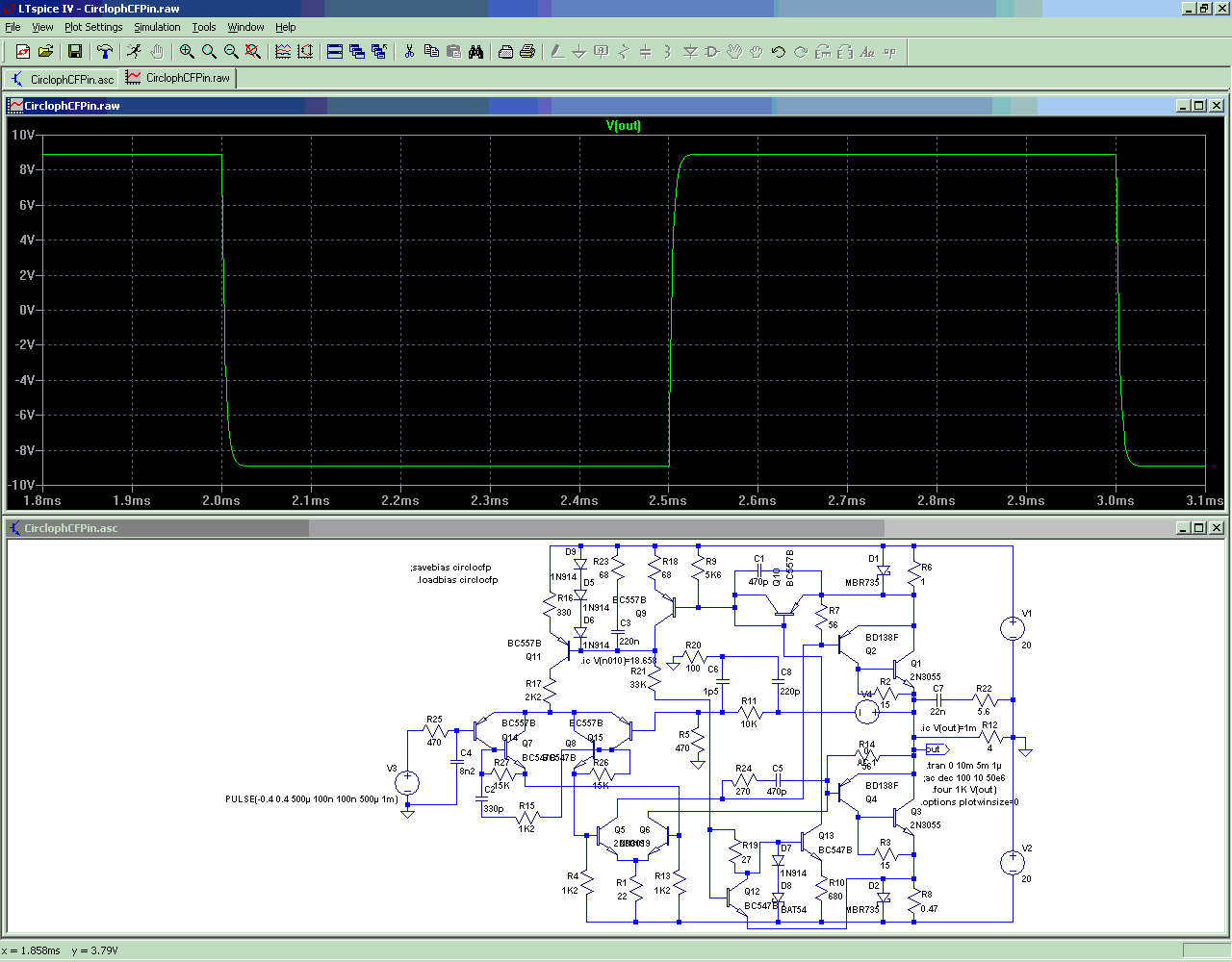

When a lowpass filter is placed at the input, the problem disappears (next pic).
That could be a possible fix, but it is possible to achieve better results with some fine-tuning of the compensations.
Only a moderate filtering is then necessary to remove any hint of "nervousness".
These modifications have practically no impact on the stability.

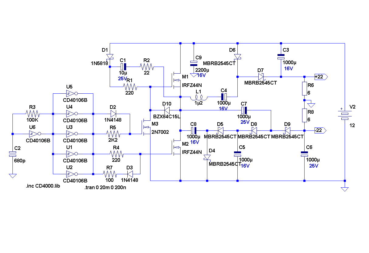

The final picture is the schematic of a simple charge-pump power adapter for those wanting to enjoy their Circlophone in their car.
I will post more details in the power supply section of the forum.
Here is the link to the power adapter:
http://www.diyaudio.com/forums/power-supplies/212945-boostor-ideal-companion-circlophone-move.html

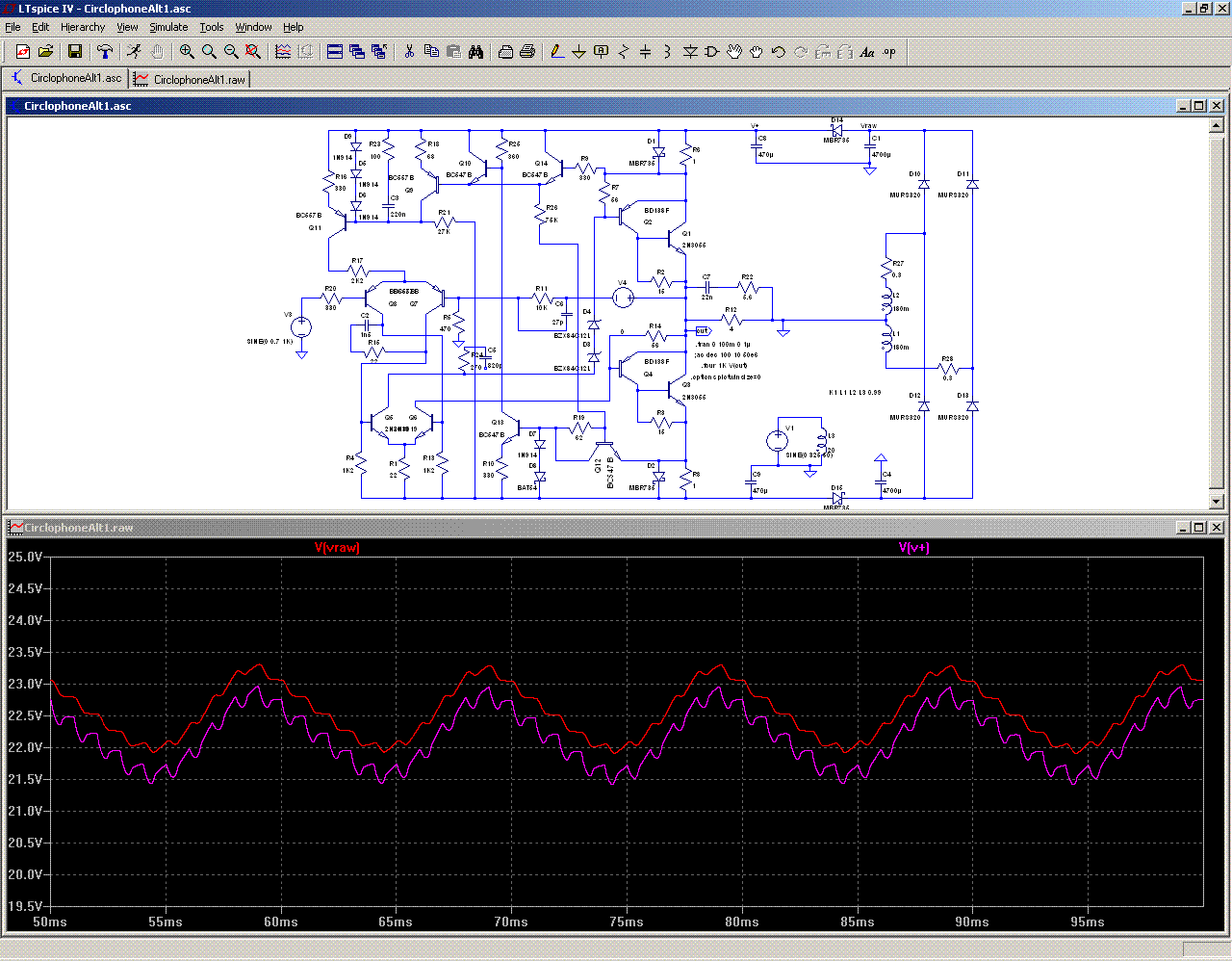

I have investigated the effect of schottky diodes in the power rails.
Apart from the DC drop, the effect seems quite minor, see picture.
It somewhat raises the impedance of the supplies, leading to an increased modulation by the audio signal, but the effect is too small to have a negative impact on the performances of the Circlophone.
What could be the benefits?
As I said earlier, in multi-channel systems it could marginally increase the channel separation.
Other than that, it could also act as a signal-driven, dynamic low pass filter: at low currents, the diode's dynamic resistance is higher, lowering the cut off frequency.
It could contribute to reduce the no-signal hum for amplifiers having a poor PSRR, without wasting the power of an equivalent purely passive RC filter.
With the Circlophone, the effect will be much less apparent, because of the relatively high quiescent current
