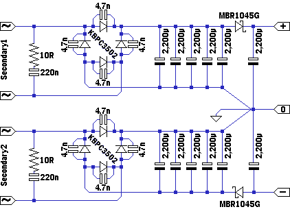

Power schematic? needs checked
Sorry for the late response. Electronic drawing takes a long, long time, and I was so distracted by it that I mistakenly exchanged my tea for hummingbird food, and have quite the sugar buzz. Anyway. . .
So what part of this (attachment) needs changed?
I see no need for two separate rectifier bridgesSo what part of this (attachment) needs changed?

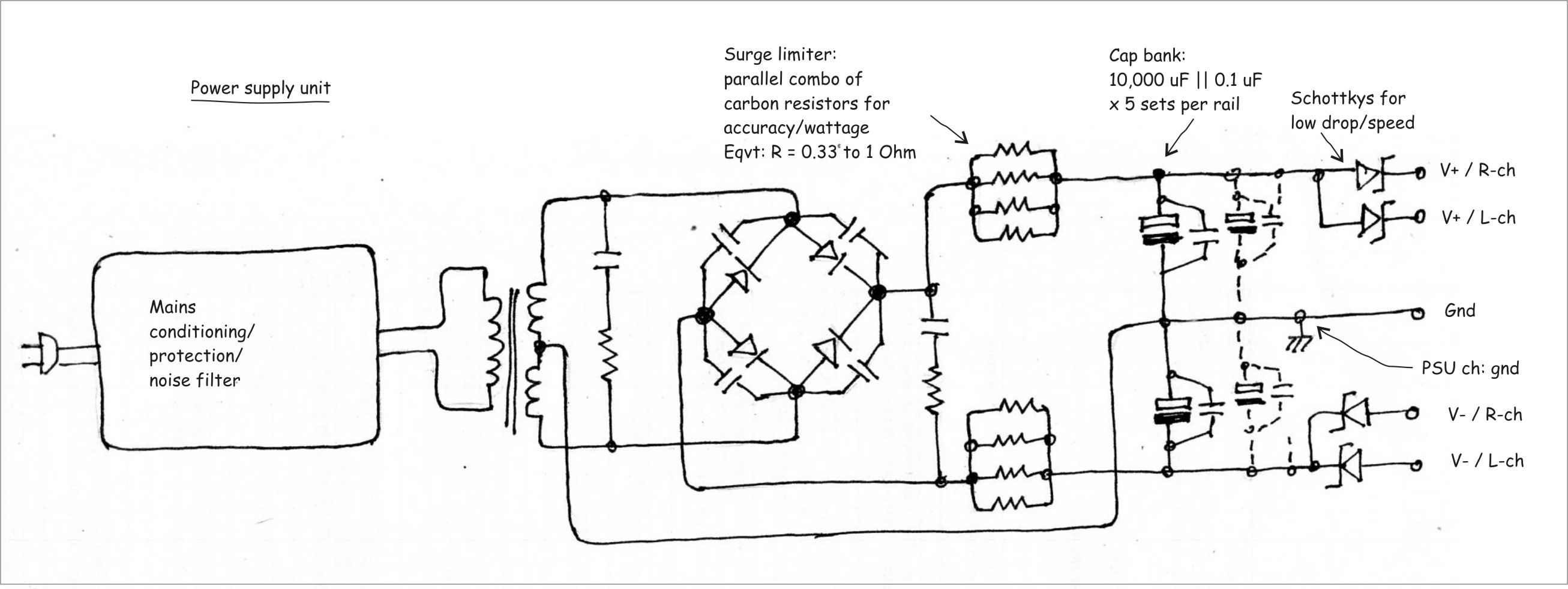

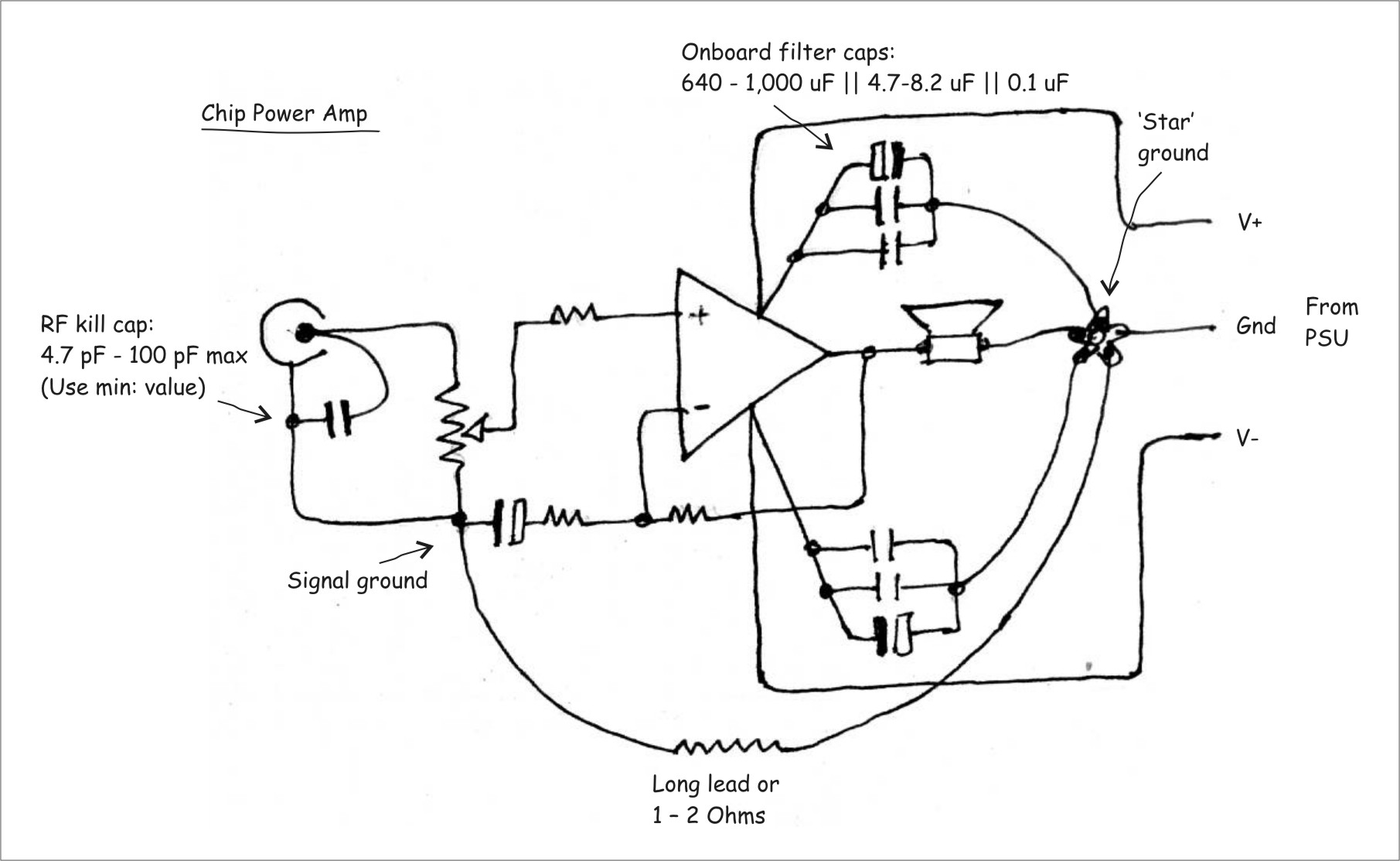

As for my take on the Circlophone PSU, I would like to do something similar, making the onboard cap perhaps 330 uF || 6.8 uF || 0.1 uF.
The input signal ground PCB trace would be cut and wired separately to the 'star' ground. In my experience with other amps, that lowers the ripple/noise threshold very much.

Circlophone is capable of a lot more power than a chip amp.
The problem with 50,000uF AND a more powerful amplifier--that is much like operating a high current device from only one little solar panel while also charging a huge marine battery. The increased workload of that much capacitance might not be as helpful as intended, because you can get "noised" instead of charged. The current dumper resistors are a further disadvantage since they can cheapen any transformer; and their presence means either not enough transformer or too much capacitance or both.
Since a charging cap is an open door to noise while it charges, I suggest a bit more concentration on keeping the caps full at the highest possible speed instead of charging as much capacitance as possible. These practicalities need a better balance.
Howabout dualie Fairchild Stealth charging lesser capacitance far out faster, staying fully charged even during playback and without using current dumper resistors at all?

@Dan:
While sharing your anxieties, let me say that here we need a PSU design Guru (I am NOT one!) to lead us forward with certainties. However, let me share some of my experiences. (Somebody please correct me if I in the process dole out incorrect information...)
I had safely (and with practical improvement in performance) employed 5 x 6,800 uF per rail with a 100 W RMS discrete amp long back, using the same transformer (E-I core; not toroid) that was suggested by the designer for use with about 5,000 uF. Practically the peak STEADY-STATE currents will be more or less the same for caps in the range from say, 5,000 to 50,000 uF. But the picture is a lot different in the initial few milliseconds, and with a truly heavy-duty transformer and thick wiring, the first inrush current peak can be destructive indeed. What I did then was to use a surge limiter of about an Ohm plus, which would be shorted out by relay contacts after a delay of a couple of seconds. With the cap bank, the reduction in ripple and the overall "reserve" of power for actual musical transients was easily verifiable by casual listening. The trick here I think is to use rectifier diodes that are rated for much higher peak currents than normal; no need to go in for any fast switchers. I have heard of the Fairchild Stealth devices, but have had no experience with them.
I agree that the charging peaks have a very short duration with large cap banks, and are theoretically a good noise source. But with enough snubbering and some care, there wont be any audible or measurable artefacts. Surely in the interests of keeping ripple low and limiting the inrush current, a better solution I think would be an inductive input filter, the surge resistor being replaced by a suitable inductor before the cap bank. In a separate PSU box as here, I think we should have space for a couple of inductors, and I guess it ought to be a far better solution, viewed from all angles. Please also bear in mind that smaller caps have higher ripple ratings and lower ESRs, and so it is better to have a bank of lower value caps in parallel. Often, this will be a cheaper solution too.
Overall I guess the cap bank should prove to be an excellent performance enhancing trick with the Circlophone too, if your aim is to listen to real world music (sorry, I am NOT speaking of loud metal/hard rock fans!) and not measurements with a signal generator. That has been my experience with a series of amps of varying output powers ranging to a maximum of 120 W RMS, and as my cap bank (which peaked at 64,000 uF/per rail at one time!) was in a separate pluggable cabinet, it was easy to make comparisons.
Let us in the meantime pause for the guidance of more knowledgeable designers.
