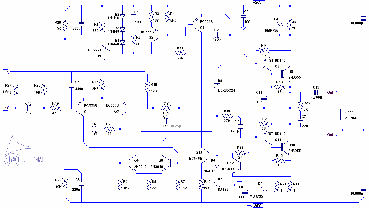

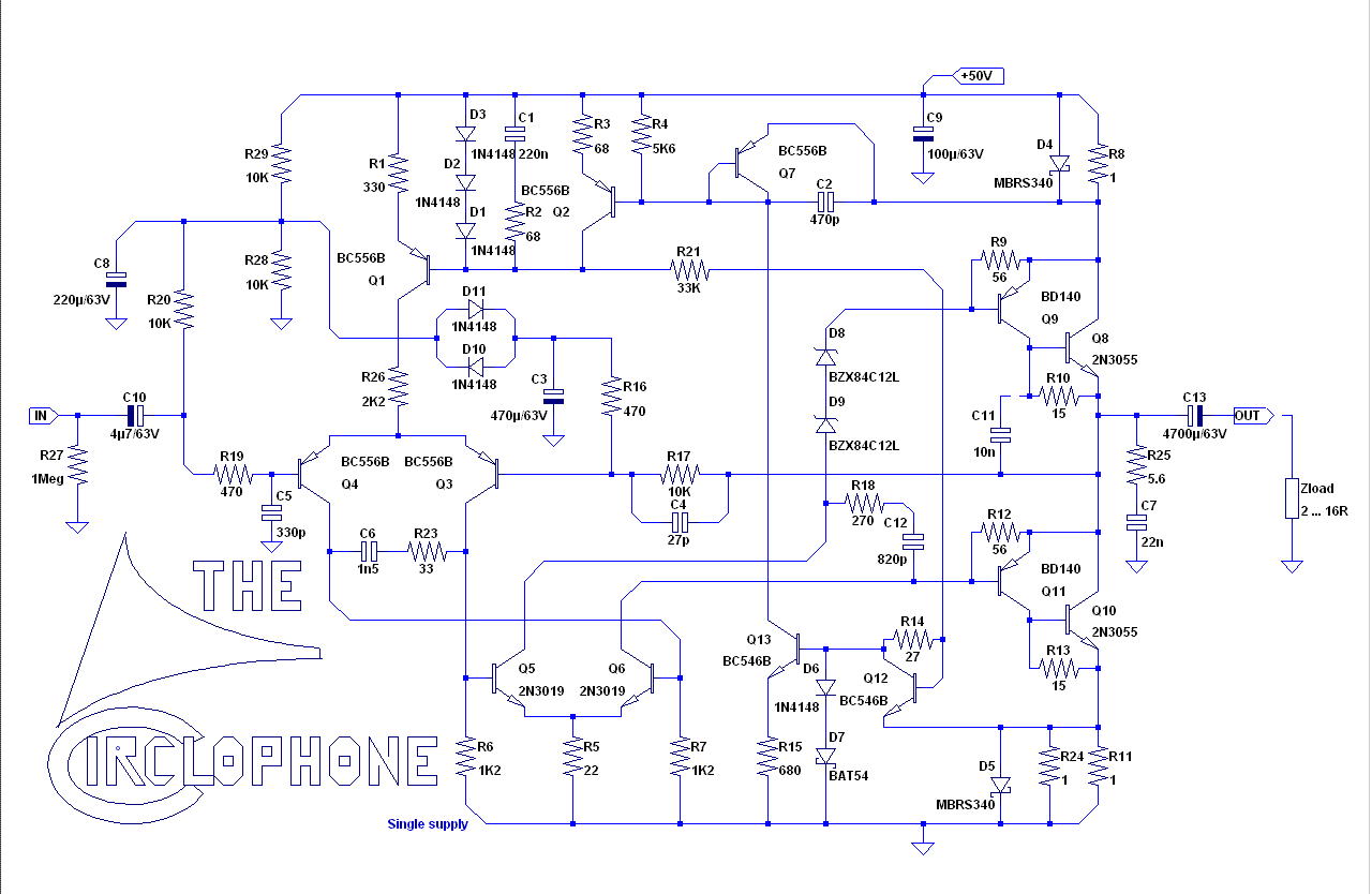

Elvee, I have a simpler question: How do we adapt the inputs of Circlophone for supporting single rail operation?
Here is a way to do it.
I fact, I have already done it myself, because I wanted to upgrade an old amplifier with Circlophone boards.

I wanted to try for auto-center at the output because a speaker doesn't need any sort of DC reference, and I have two single transformers not quite match for either voltage or current, yet wired as a single center tap and thus a trimmer doesn't have any right setting; and I have both a grounded amp and a grounded source with the grounds not quite match either.
So, does this (attached) scheme work with that scenario?
(the purpose of the attached schematic is to ask a question)

I see a number of problems there:
-Input and output are referenced to two different capacitive dividers; in an ideal world, it might work, but in practice, any mismatch between the capacitors will introduce ripple, and Elytics are not famed for accuracy.
-The input reference is created by 10K resistors dividers, and there is no blocking cap in series with R16, which means the DC gain will be high, and will amplify any offset disproportionately. Even with an AC coupled output this might cause troubles.
I think a better solution is to jettison completely the (pseudo) center tap, and act as if it was a true single supply. The scheme given in #901 then becomes applicable and suffers from none of these problems

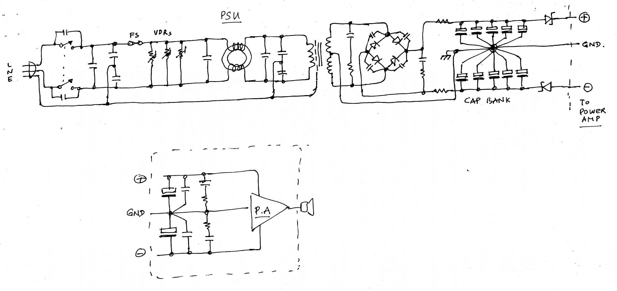

I couldn't agree more with Elvee's reminder about the KISS formula, and experience tells us it often is the best approach.
Still let me share with you the approach of one of my junior friends vis-a-vis a 'belt and braces' power supply for his 'Gainclone' (LM3886) amp, out of which he wanted to squeeze the best possible performance. Though many agree that the chip amp performs well with just a couple of thousand microfarads of filtering, this PSU with its large capacitor bank audibly improved the low end and the transient performance, while at the same time it "took away" something from the amp. But when the cap bank was isolated with a couple of diodes, the performance had both the goodness of the 'light filter' as well as the 'ease' provided by the heavy cap bank. I dont know what to make of it.
Perhaps Elvee would be kind enough to examine the question in detail and give us his recommendations.
Though that shouldn't bar us from experimenting with all sorts of combinations, looking for an audible improvement... ;)
It is a good, state of the art supply. I am not too sure about the effect of the diodes though. They could provide some isolation between multiple channels sharing the same supply, but other than that, I don't know.

My apologies for the late response--two reasons for that; one, I am travelling, and two, as the PSU was the baby of one of our group, I had to check with him as regards some details.
@Dan:
I had a bit of difficulty understanding your terminology on ' retarding the speaker return force'. My mind goes back to those days when the +/- supply advocates were horrified by the output caps of single supply amps, which they wanted to abolish at all costs in the interests of fidelity. How easily they all forgot that the PSU caps were in-line of the a.f. currents. So, I guess you have here in mind the role of the filter caps to offer a ready path for the a.f. signal currents. As Elvee pointed out a few posts back, electrolytics are notorious for the accuracy of their values and so it is best to err on the high side when considering the l.f. limit.
I am sorry I just drew out a simplified version of the PSU that has apparently created a bit of confusion. The chip amp board (where you have a small pcb; many designs follow the point-to-point wiring method!) has 'normally' about 1,000 to 2,000 uF onboard, which is more than adequate. Many DIYers have reported that the amp 'sounds' best with that. Some finicky guys, like my young friend, have a 1,500 uF in parallel with a 100uF and another 0.1 uF. However, unless you have a beefy, regulated PSU, this meagre amount of capacitance is not adequate when the amp is driven by music, with the supply rails doing their own tap-dance. But we had observed that the addition of a really 'heavy' filter bank audibly detracted from the amp's 'sound'.
My humble suggestion then was to maintain the 1,500uF plus 'onboard' caps unchanged, and then beef up the PSU power reserves with a heavy cap bank. With the isolating diodes in circuit, the amp works normally with the a.f. signal currents routing themselves through the onboard caps. When the rails sag on account of drive, the virtually 'infinite reservoir' is connected, thus improving the transient and l.f. performance. This is the only practical explanation I could think of.
My friend has one heavy PSU with two sets of isolating diodes for the left and right channel amps; they are Schottkys salvaged from old SMPS.
The parts are largely non-critical, he tells me. The diodes are ordinary heavy-duty 10 Amp diodes bolted to aluminium angle off-cuts that are mounted on a strip of pcb material. He does not favour fast diodes, which he tried and says do not give any added advantages. The 'snubbers' are standard values, like about 5 kpF across the diodes and 0.22uF+6 to 10 Ohms. The noise filter is scrounged from an old SMPS. As for the MOVs, many knowledgeable designers advocate a parallel array of lower powered devices than one of higher rating. As for the transformer, many of us still go for an E-I core CRGO transformer -- if you have the space to mount it. The trick is to have the laminations put in a vat of wax BEFORE assembly, and then assemble meticulously--meaning, not like the "commercial method" of stacking half a dozen stampings together, but doing it individually. Use strong clamps for final assembly and then give it another boil in the wax vat, and pretty much nothing can touch that transformer. It is the quintessence of the "strong, silent type". And when you put in your cap bank, unlike a toroid, this doesnt pump in a lot of switch-on current, so that your current limiter need hardly be say, 0.5 or 0.33 Ohm after the transformer.
@forr:
Please do not take the rough drawing so literally. The mains 'earth' is fully isolated. The ground marking just indicates that the cap bank is 'earthed' to the PSU chassis in the interests of shielding. With isolating feet on the PSU, the amp doesnt care for that earthing. The amp is 'earthed' in the standard manner, with the 'star earth' connecting the filter caps and the speaker returns. The input signal earth needs to be a bit 'higher' than the star earth, and my friend has achieved that with a long piece of enamelled copper wire ( formed into a close wound inductance over another bit of thicker enamelled wire bit) connecting the input signal earth to the star earth. This also takes care of any 'rogue' RF signals too, he says from experience. You could also put in a resistor of a couple of Ohms or more here to lower the silence threshold of the amp. Earthing, as they say, is more an art! I hope this has cleared the air as regards the details.
Personally I am in favour of trying such a PSU with a diode-isolated cap bank with the Circlophone -- if only to verify whether it can provide the kind of improvement it has given with the chip amp.
