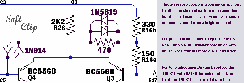

I might have exaggerated a fraction though, so perhaps the builder's thread is 99% camel-free.
There is one exception.
See the attachment.
That soft clip circuit didn't quite work as intended, but rather it makes noise quite similar to a triode (as shown, although it may be set differently). The effect has a use for MP4, AAC types such as Digital TV, Itunes, HD radio or for any source that has duller treble that needs some help (those would blare if cranked up were it not for the funny little soft clip accessory). If someday you need some fake clarity, remember this little thing--especially good with TV and HD radio, and surely lower distortion than a baxandall. It is actually a treble harmonic enhancer not much of a soft clipper. Thanks for the opportunity to fix the documentation for it.
