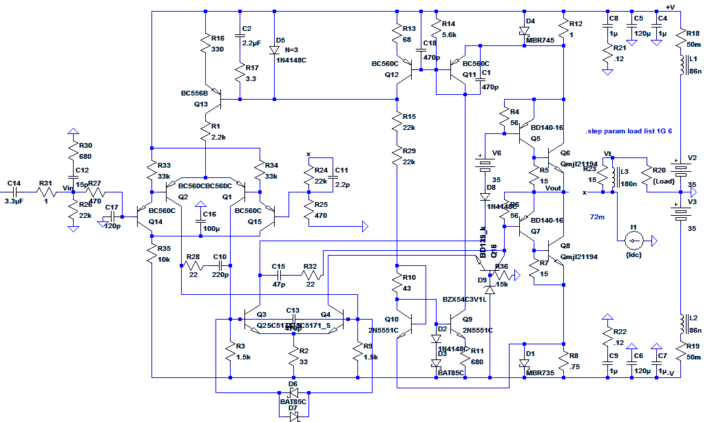

The drivers in post 998 are Philips BD140, but many drivers could be used for those results, since it isn't touchy about drivers.
However, it is very touchy about VAS components, and thus if 2SC5171 is exchanged for a substitute then the function would be less pleasant than expected. The problem is the capacitor parallel with the feedback resistor. Not only is tuning that in harmony with the vas compensation giving the excellent performance but it is also an Achilles heel. Some other and more tolerant way needs to be found or else there would be a schematic per each different vas device and per each different voltage. For example a variety of 5 transformers and 5 transistors requires 25 different schematics. . . because the vas compensation has tight tolerances and will neither successfully nor automatically adapt to differences. Ideas?

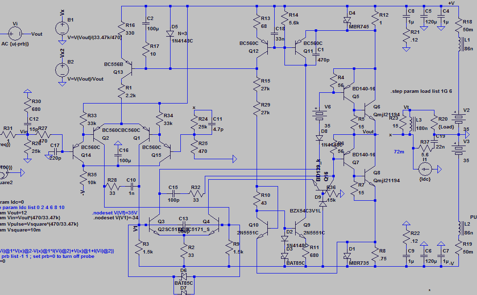

I see you have recently added Q16 to make both
halves of the cycle more similar. When did this
new part first appear, and why was it not worthy
of previous mention? It cuts severely into your
negative swing's headroom, so its not pure gravy.
Why bother at all with V6 + D8? If Q16 exists,
these should be mated with the same.
D8 is to keep the simulator from determining an operating point where V6 is pushing current the wrong way through the driver. It is just for the simulator.
I like your idea to cascode Q4 with the top of D8 as a reference.
AFAIK the VAS is in class A, except when overdriven or when being severely messed with by the servo loop. Furthermore, the servo loop itself ensures that the VAS, just like the output stage, has that non-switching characteristic. Furthermore, the VAS is certainly balanced, or currents of the outputs wouldn't be balanced or controlled so well, which they are.
In simulation a single 500pF cap across the bases of the VAS works well to iron out differences, ensuring a baseline of slowness. This modification should make me and Dan's variant more tolerant of different VAS devices.

The servo is pretty slow. At frequencies that matter for compensation, the VAS is operating pretty much without any common-mode augmentation.
The 500p cap actually does not slow it down that much. Remember that low values of miller capacitance matter because they are multiplied by the voltage gain of the stage. This does not happen to emitter capacitance.

I'm pretty sure the VAS will still saturate before the LTP does. Remember that Elvee's versions have a lot more across the VAS bases, 1.5nF as I remember. Albeit with some series resistance, but the critical difference is that in that version the LTP would have saturated before the VAS. So I don't think this version would have any problems that Elvee's didn't have, in fact it may be better.

I found that the static and low frequency aspects of the Circlophone are very accurately modelled by the sim.
For the dynamic aspects, it is a different story and there are discrepancies.
Some are positive, like the slew rates, power bandwidth and transient cleanliness as shown in the oscillograms better than the sim, some negative, essentially stability, worse than the sim.
The stability in a Bode sim is a necessary condition for the physical stability, but it is not sufficient by itself.
My hypothesis is that the two loops interact, creating a sort of "modal oscillation".
This cannot be caught by a simple Bode analysis, where you look essentially at the result of one stimulus on one loop at a time.
The transient analysis should be more accurate in this respect, and it sometimes is: making a simulation with very small time steps, like 1ns can help uncover some issues. But some discrepancies remain.
Maybe the models, maybe the physical layout, or some other unknown effect.
When oscillations occur, they are generally rather high in frequency, several MHz, and low in amplitude, less than 1Vpp thus pretty harmless and non-destructive.
So, it is perfectly feasible and safe to experiment and test various compensation schemes, practically without risk (not on a real speaker though).
Amongst other things, I found the lead resistor in series with compensation capacitors was practically unavoidable.
But maybe I was stuck on the wrong track and missed something. That kind of thing can happen when you are involved too deeply for too long in something, which is why I welcome the look of outsiders.
I made a quick test on two Circlophone builds I had handy: one is a completely unaltered version, with TIP3055 as OP, the other is based on BD249C.
I simply shorted R23:
On the plain vanilla C, it resulted in downright oscillations on the positive half cycles, on the BD249 one, nothing was visible.
This means that with somewhat better output devices, the margin is wider, but it doesn't mean it is sufficient for practical use.
At the time, I made my homework and made stress tests under many marginal conditions, with many semi's, etc, and came to the conclusion that the values published were near optimum. Or at least a local optimum. If a completely different compensation strategy was adopted, things might be different, but if the original scheme is retained, series resistors are probably necessary.
I know that it doesn't quite square with sim results, but in the end it is the physical circuit that has to be made to work, not the sim.

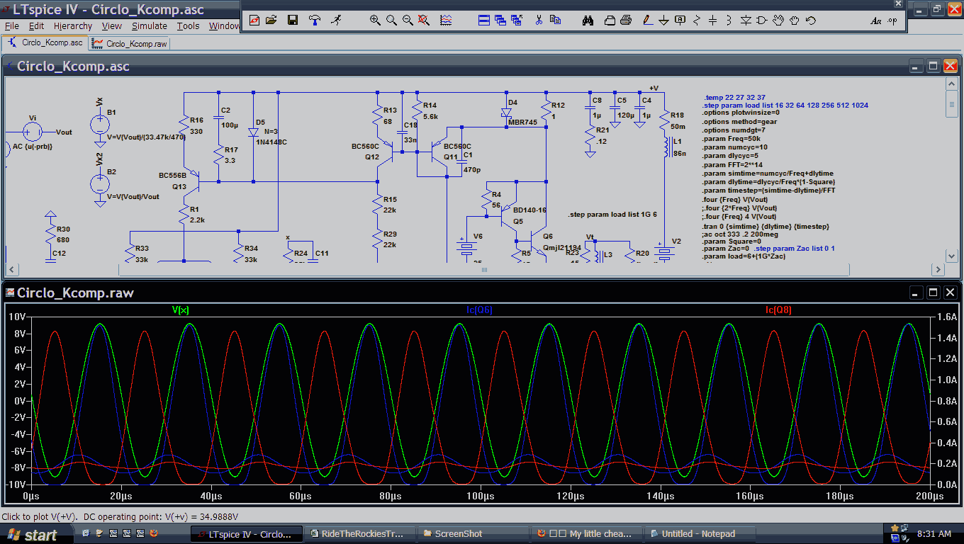

Okay. Howabout this?
3MHz Phase Linear
Different compensation
Restore sensor RC
Restore LTP comp
Remove sticking
0.002106% THD

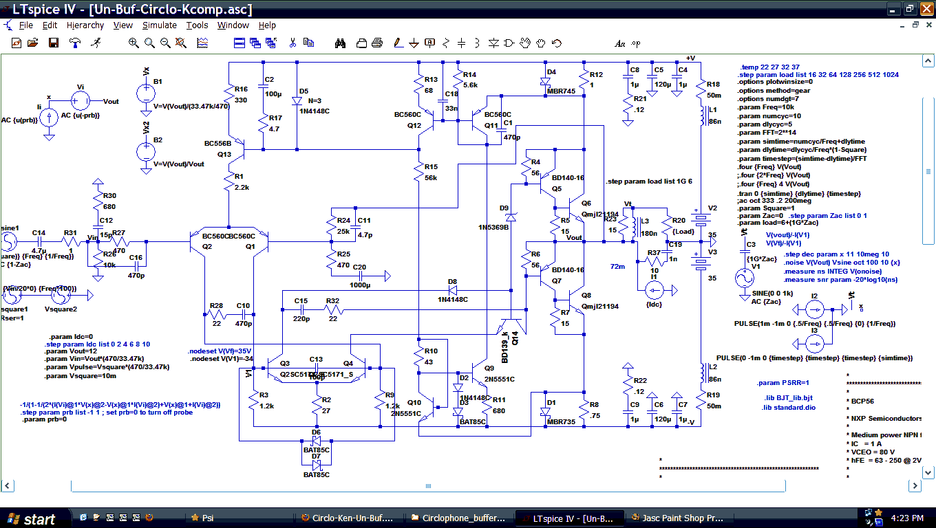

Un Buffered?
Apparently, that buffer really is an upgrade. For comparison, here it is without the buffer. This time it is at 2.5MHz and 0.002215% THD. Not shown is the harmonic effects of the output device currents being fairly jagged on this version as the sensor is not nearly as well behaved on this un-buffered version. There's not actually any sticking, but it is just not quite as level. Even so, it looked worthy of checking out the differences between the two versions (with and without the buffer). The compensation differences are especially interesting. It seems that either you have a buffer or you have double the compensation efforts (see attachment).

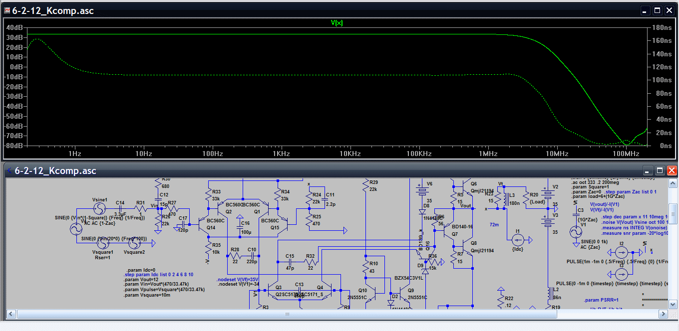

0.000033%THD buffered Circlophone?
0.000033%THD@1kHz
0.000077%THD@10kHz
0.000712%THD@50kHz (shown)

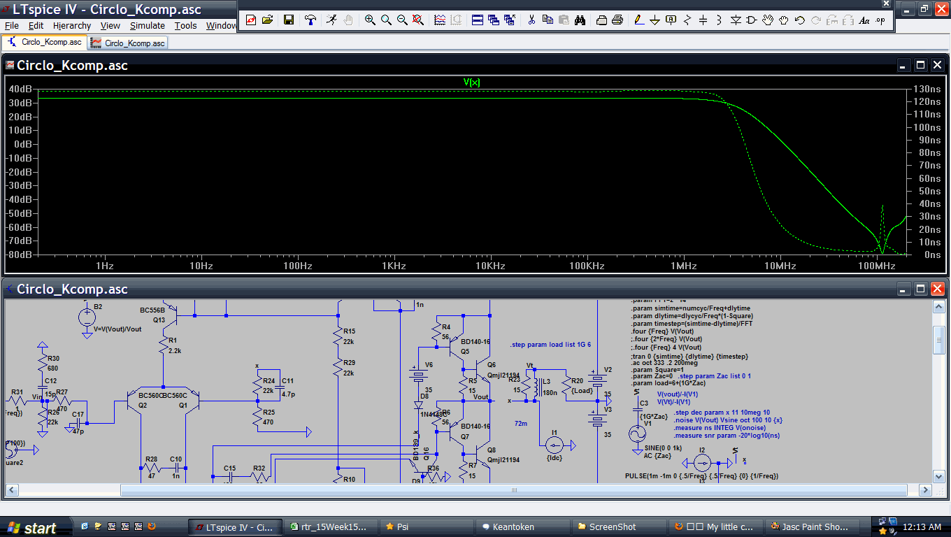

Top speed on that one is 1.5MHz if you want strictly phase linear. It was simulated with the load engaged for more realistic results (for example if I took off the buffer, then the passive component values will look very much like post 1). The fantastic THD figures are because of unusual manipulation of the sensor values (see attachment), Q16 which cuts THD in half anyway, and the 2x better tolerances (easier to comp) seen when using the buffer. I was attempting higher efficiency, but this looks unusual and I do not know how to interpret the results. Help?

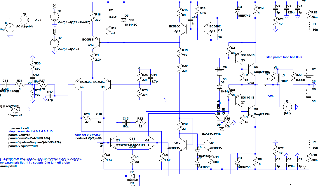

Ah, practicality issues.
1
I read only one of the THD graps. The other says 0.0022%.
2
And R17 could go to 10 ohms or even a bit more if necessary for practical concerns of having that resistor large enough to assure that C2+R17 doesn't act like a bad cap but instead really does perform as an RC for consistent behavior. The entire goal of the latest exercise has been to break free of too small R17 values, and finally we did.
Bias at 700mA will get you low distortion, and this amp seems to like class A. However notice the bias point changes between loaded and non-loaded. For some reason loading pumps up the bias. This may have to do with your changes to the servo.
Also, dunno if you know this, in LTSpice, Tools->write bitmap to clipboard and then paste into MSPaint will give you an instant schematic with no need for cropping window borders. Too bad it doesn't work in Linux.
The simulator regards this circuit as 0.0013%THD. Although I show it without the buffer, adding the buffer is probably vital if one wants to support a much wider range of components. Without further ado, see the altered cascode.
I don't know what Q14 brings/improve, but it is unusable outside simulations: it will cause premature clipping of the output.
Cascoding Ken's way (on the other leg) does bring benefits, but here I only see additional problems.
D9 has to be somewhere around 66V to prevent premature clipping. So it's a bit weird, and too much rail sag could cause VAS saturation. We could fix this and use fewer components by just cascoding Both halves of the VAS. For some reason that option never seemed attractive I take it, but now it looks like the best way. It would also allow us to use smaller VAS devices with better Vcesat characteristics; I'll bet we could get away with the BC550C or the BC327-40 there.
