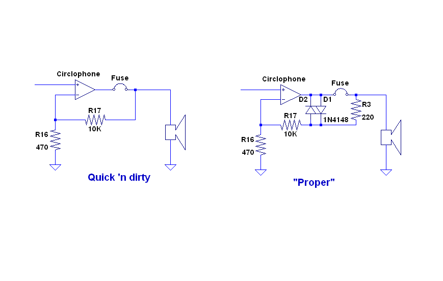

Can you value that optimum fuse (and series resistor?) rating for 30-35-40V @8ohms and @4ohms please?
Thanks again.
R3 is there to keep the feedback loop from going crazy and the output stage from failing in case the fuse blows for other reasons than output stage failure, for example because of accidental output short, or if a speaker with too low impedance is used.
Its value must be significantly higher than the speaker impedance because it is in effect parallel with the speaker at all times (and thus dissipates power), but significantly lower than Rf so that there isn't a huge change in the feedback loop when the fuse blows. 220 ohms to 1k is fine.
. . .Perfect symmetry doesn't extend to failure modes, except when you have a lot of luck. That's why I think Daniel is playing with the devil trying to extract 180W out of two miserable transistors.
Unfortunately the "watts" measure has obscured a few details. The speaker and output devices have matching SOA, and with the limiter aligned to ~145w (speaker X-Max) and the amp has a real transmitter heat sink. The voltage will go down from 43 to 41.5 per rail after RF filtering. With harsh use it can sag 2v. That's 39.5v rails. In such conditions the Schottky removes at least the .5. We have 39v rails. And, there is a limiter attack, as well as a thermostatic fan.
Do I need to lower the voltage further?
Here is a document which states that how improving bass response while using a fuse at feedback loop. Do you agree? .
No, it will not work: if the fuse opens, R3 will become ~connected to the ground by the speaker's low impedance, thereby opening the feedback loop, just what the scheme is supposed to avoid.
Note that the Circlophone will tolerate it: it will operate as a big power comparator.
These are not the healthiest working conditions, as the output stage will be pushed into deep and hard saturation, causing cross-conduction spikes, but it is tolerable, and the Circlophone will survive.
If you opt for this quick and dirty method, you can completely dispense with R3: see first figure.
This has the advantage of needing no modification, you can just change the way R17 is connected.
The next figure shows the proper implementation, with diodes closing the loop when the fuse opens.
In order not to introduce non-linearities, the peak I*R drop in the fuse may not exceed 0.6V. If this is not the case, 4 diodes have to be used.

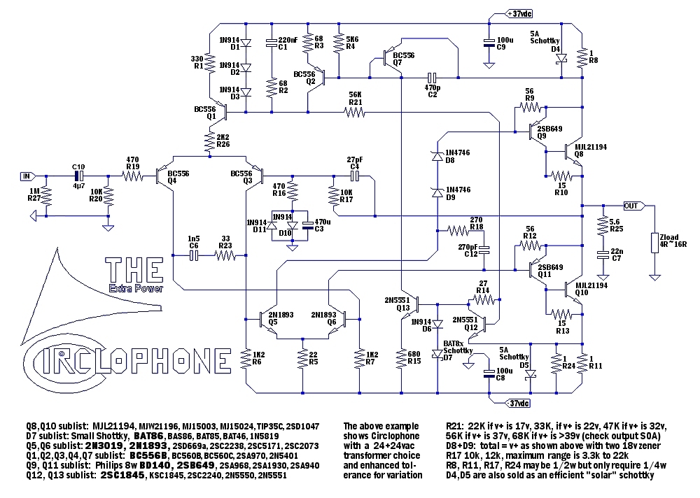

Right. Thank you for putting up with all that. Here, I believe, is the de-rated result, pictured in the schematic attached below.
Please consider this post as a sort of question.
Scenario1: The annotations list a 24+24vac transformer; however, unregulated supplies may wander considerably and daily and may exceed 40v rails temporarily and repeatedly, despite measured actual average at 37vdc rails. Hopefully the derating is now correct to withstand expected power fluctuations?
Scenario2: For documentation purposes, sublist preferential components are in bold, with less suited alternatives in small print, although all items have been scanned for availability. The sublists might need double-checked to remove/replace anything unworkable and/or add anything missing.
The parts selection and schematic should remain valid for many years, except for D7 candidates durable enough to withstand power surge conditions. So far, NXP has BAT86, BAS86 in current production and ESD protected, Vishay has tiny BAT85 but I couldn't confirm sturdy, ST has BAT4x of which BAT46 might outlast a surge, and OnSemi promotes using their 1N5419, which is odd but ESD protected. That's all I could find for D7 withstanding power surges and ESD. I'm curious if the original model had a germanium diode. At maximum (worst case estimated condition) how much voltage and current is seen at D7?
Scenario3: Higher useful power via elegance? Unfortunately, I didn't add your 4n25 based limiter to the schematic (as an accessory part, underneath the annotations), because I didn't know the correct value for the zeners. We discussed adding series variable resistor and 2v? 3v? LED series to 4n25's inbuilt LED, but with that and the 37vdc rails (actual average), I became lost. The schematic below is what I'm using on first build, so I'd love to know the limiter values for soft clip?
Believe it or not, there was much effort involved. Hopefully, this provides some compact documentation. What needs improved?
D7 is not subjected to any surge, power or otherwise: it simply becomes weakly forward biased when it is clipping.
Even the most fragile HP 5082 xxx would survive any "surge" in those conditions.
C5 is not optional, unless you want to hear crackling noises each time you switch an appliance in your house.
