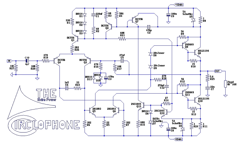

Here's the parts list progress so far:
Q5/Q6 2N1893, 2SD669, 2SC2238, 2SC5171, MJE340?
Q8/Q10 MJL21194, MJW21196
Q9/Q11 2SB649, 2SA968, 2SA1930, MJE350
Q12/Q13 2SC1845, KSC1854F
And here is the "extra power Circlophone" schematic progress so far:

Does it need a voltage spec added?
No, the max. they will ever see is 1V or so.
As for the BIG Schottky D4, D5, I'm glad that we didn't have to specify 80SQ045NG or STPS5L60 or an even larger "Solar Power" model for very low voltage drop. Performance like the Motorola in your photograph is rare. I have simply marked the schematic as "5A Schottky" but I need to know if 5a is insufficient. Does it need a voltage spec added? Moderately, since we're close enough for most speakers but not all?
For normal load impedances (down to 2 ohm), a generic schottky of 5A rating is sufficient.
Here again, the reverse voltage is negligible.
For very low output impedances, 1 ohm and below, a bigger type would become necessary.
I would leave the MJE340 out of the list: it works, but it is not optimal, and when combined with other suboptimal components, it could begin to cause troubles.

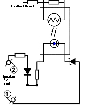

So, instead of blowing the speaker jack fuse. . .
To work my extremely simple "gain nipper" circuit's hand made optoisolators, I need to know the permissible range of gain for Circlophone.
The gain nipper can also be worked by Rod Elliot's clip detector Power Amp Clipping Indicator See how it uselessly lights up an LED? That could light up an optoisolator instead. 🙂
I think it is doable without that circuit when the speaker load is known, since clipping output is obviously more powerful than normal output.
Probably an optoisolator can be powered directly from a voltage divider at amplifier output, really similar to a headphone jack hookup. Just divide a predetermined safety limit down to led switch on voltage for powering up the gain nipper's LED with enough current for up to 40% of LED tolerance at most. Its about $1 per gain nipper. Again, really no noise when it isn't on. 🙂 The optoisolator is bypassed by an ordinary resistor and simply changes that resistor value mildly, decreasing output power during emergency conditions.
For example R17=8.2k series to 2.7k//optoisolator.
Thank you! I would also like to leave sub optimal parts off the list.
So that line was changed to look like this:
Q5/Q6 2N3019 for rails < 40v, else 2N1893
With 2N3019 and 2N1893, there is sufficient availability to remove the less optimal alternates. Thanks again!

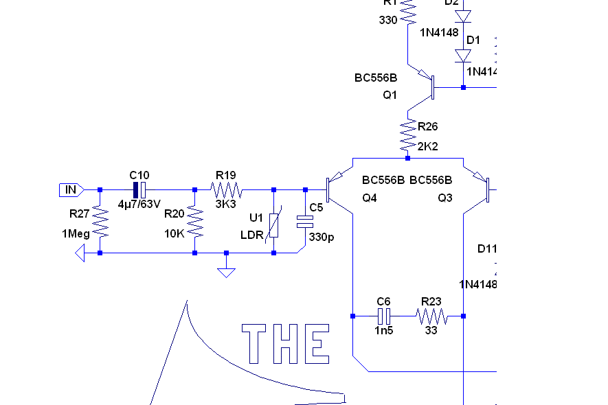

I don't know exactly how to go about it.
Make a variable input divider, like in this example.
For an inverted control polarity, swap R19 and the LDR (and shunt it with a suitable resistor)

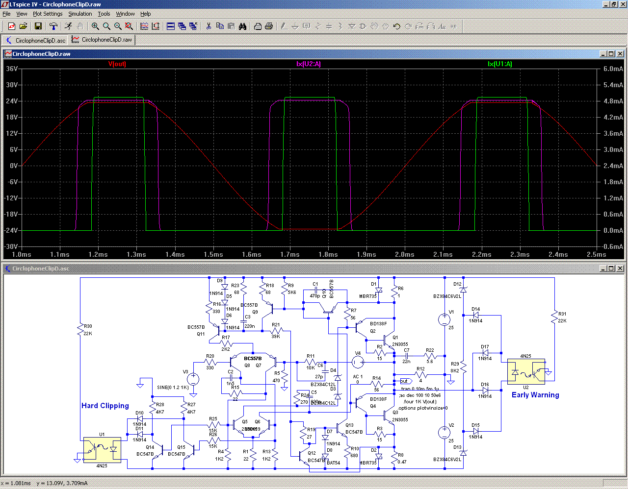

Here are two possibilities of clipping detection.
The hard clipping detection (left) is specific to the Circlophone, the warning (right) is "agnostic" and could be used with any amplifier.
It has the advantage of taking into account the actual rail voltages.
In this case, the warning flag is raised when the output is closer than ~4V of either supply rail, but this can be easily adapted by changing the zeners voltage

Your version of the early clip warning is so much more elegantly streamlined than I've ever seen before.
I have some notes. . .
The optocoupler's inbuilt LED (very low current tolerance) would appreciate a series resistor, possibly fantastic as a variable resistor dial. It is also nice to add an ordinary LED series to the optocoupler's inbuilt LED, flashing correspondingly to the LED inside of the optocoupler, thus facilitating easy adjustments and a taller knee voltage to help prevent nuisance activation. A small value zener could be added series to the LED, if necessary for tolerances. With the clipnipper, I had only intended to make mildly proactive vu meter, but you changed the whole prospect into a soft clip amp. WOW!!! THANKS!!!
An optocoupler doesn't have a particularly low current tolerance: the 4N25 in example tolerates 60mA of continuous current and 3A surge. Probably more than a general purpose LED.
Anyway, the optocoupler's presence only serves to illustrate the output of the detector, and it could be replaced by any current sensitive device (or an LDR-based opto)
That is certainly an option, and a visible LED certainly does offer a plus, even if it is hidden from the final user, but adjustment is not required: the left part detects when the amp runs out of steam, and the right part reacts somewhat before, but also at a well pre-defined threshold.
That will only change the current in the LED when the circuit is active, not the threshold.
Here, for the example I have chosen a 5mA current, but other values are possible.

. . . and a few questions.
I'm not great with math, and so need to ask: What feedback resistor value results in a gain of 8 for Circlophone?
470*(8-1)=3K3
MBR745 7.5a 45v diode datasheet says same vdrop graph as MBR735 7.5a 35v diode. Is the voltage a concern?
Not at all, you could use a 2V one, if you could find it...

I'm about to alter @powerflux pcb with minor changes. One of altered pcb may not use the schottkys on each rail due to space requirements. If it is not a compromise with sound quality, power efficiency is not a deal for me. So, can we omit 1R and 0R5 respectively in this situation?
The schottky's are (sort of) optional, but the resistors aren't: they sense the current for the bias servo, and if you omit them, your amp will be destroyed in milliseconds.
You can leave them, and just omit the schottky's: that won't lead to an instant disaster.
However, this might not be as attractive as it looks: on a 4Ω load, the output voltage will be amputated of ~25% (due to the 1Ω, but when it clips on one side, there is no point going further on the other).
This will divide the output power by 1.25²: more than 1.5.
If this is not bad enough, the power not dissipated in the load will be by the resistor: this could easily reach 20W or more, depending on the amplifier's power.
A 20W resistor is not exactly a space-saving option...

------Elvee, what's this about C11 not required for the outputs I'm using? I take it this has been tested? If so, I may remove them. Although, I may not. Why mess with something that is already good.
Schottky reverse voltage is irrelevant here.
We are only using them in forward bias.
R16 and R19 = 1K2?
I don't think you want to mess with 10Ks.

You want a 3K3 input impedance?
No sir, that's not the intent. I just needed the documentation of both high and low points of reference, because I wish to avoid exceeding that range. My limiter and Elvee's elegantly streamlined soft clip do both momentarily change amplifier settings, but that occurs only for a brief instant and only when needed. In trade, I was able to choose a more orthodox transformer voltage.
Although such technology has existed in the past, the new presentations are much different because they are extremely doable and because they both have a "tump the zener" function to make sure that they stay "off" until they are needed to block clipping or maintain SOA. It is the "doable" aspect, together with the low cost, that makes clipping an outdated notion of the past. A simple thermal resistor, just 1 more part, could add a further elegance and function to the protection, yet still maintain the low cost, simplicity, and high performance. I appreciate that these easy systems are readily adjustable. Their effect on audio is momentary, rare, and good, since it is better than either exploded output devices or clipping.
The unorthodox possibility is a somewhat more like a 25w soft clip Circlophone outperforming a "standard" 60w amplifier.
C11 is necessary when very fast output transistors are used. In your case, it is not necessary, but it does little harm.
If you remove it, the transient response will be infinitesimally cleaner, but otherwise the effect is barely noticeable.
R16 and R19 = 1K2?
In general, I prefer to leave the impedances seen by the LTP more or less constant, so that minor poles are not disturbed, but in this case, 1K2 would work without problem.
No, that's the value of the feedback resistor for a gain of 8.
With your supply, transistors, and on a 4 ohm load, you run no risk of exploding your OP devices.
If you try to abuse it, you will probably damage your speaker, but not the amplifier.
I recommend you first try to build the naked Circlophone, and you add your bells and whistles later (and incrementally), when you're satisfied everything works fine.
Otherwise, there is a risk all ends in a big mess for unclear reasons.
Here is the way it is implemented by Peavey (they call it DDT):
Patent US4318053 - Amplifier system with automatic distortion control - Google Patents
The patent has long expired, you can copy as you wish, even for commercial purpose
It works very well, without thump or anything.
You just have to graft my clipping detector on it, as it is simpler and more elegant, but the gain control can be left as it is.
