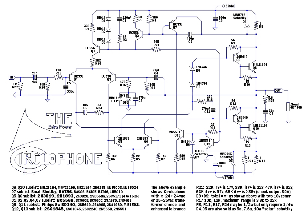

And, earlier your schematic/board shows option of R21 at 47k, meaning about 32v rails for total span of 64v. Perhaps Q12, Q13 needs to be one of these: 2SC1845, 2SC2240, 2N5550, 2N5551, transistors that can take voltage in excess of 65v. Guaranteed that an unregulated power supply is eventually going to pop BC546B at Q12, Q13.
Merely peculiar to my own notions, I'd like D7 as BAT86, and D8,D9 both at 1 watt capacity, and D4,D5 at least to 5a if not more and with voltage specs that appear to handle a rail even if such overdo may be unnecessary. One thing about modern diodes is that they tend to "glitch" randomly and so some fierce derating helps.

Well, I had the documentation attempt, a bit off the mark. Here's a new copy with the sublist annotations fixed to represent capacitance at Q5,Q6, and the C5 is shown. I do have a question: What type of soft switch diode might be suitable to use at D10,D11?
D10 and 11 are normally inactive. Their role is simply to keep the voltage across C3 within reasonable limits in case something goes wrong with the supplies powering sequence or similar event that could cause a latch-up.
Practically, every silicon diode in the catalogue is suitable.
The simplest option is to go for the 1N4148, but you could as well use 1N4007 or BAT81, or zeners, varactors, PINs, you name it......
