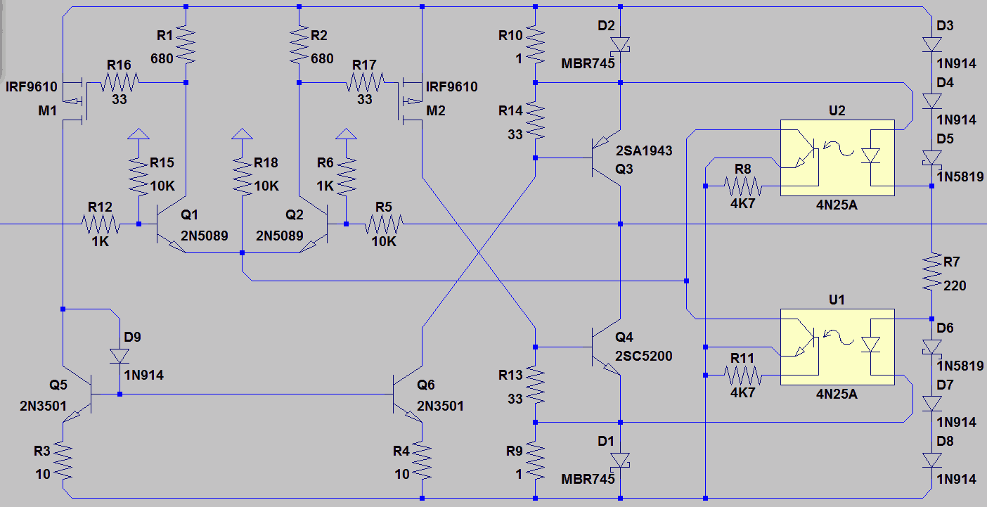

I wonder MOSFET for Q5 & Q6? Would maintain input pair at more constant current?
Even with quadrature trying to disturb this, the collector resistor drops would drive
fixed gate threshold voltages, and no base current leak. Currents can't drift far from
this mark. R6 R7 obviously must scale up as VBE becomes a slightly larger VGS.
Wacky drain capacitance is my only concern. I don't know how to guarantee any
simulation behave realistic in that regard. IRF510 (100V,0R5) IRF610 (200V,1R5)?
either claims about 16pF, if only that cap would stay put and not squirm... You
got 820pF sandbagging from anode to anode, it seems reasonable in that light.
Is R5 in the second tail actually helpful? Considering its position within both
closed loops, the closed loop balance and non-shutoff here is already forced...
I was never all that clear about how one calculates loop stability to begin with?
And as we throw another loop at 90degrees effect into the blender, I get really
confused what effect the compensation is having upon each... If push and pull
are each doing nothing at some current minimum for slightly less than half a
cycle, differential compensation is clearly also active in the common mode loop.
I'm not saying that's a bad thing, it might be a good thing? Only it's an I don't
have a clue how to grasp for the math of it...
Not quite sim ready yet, just another half-baked noodling...
Not sure I got the fuzzy thresholds of the logic function quite right?
Pull the LTP up to try and shut it into class B. Then if either output
would actually threaten to go B and shut off, I pull down on the LTP
until the threshold of true shutoff is never quite met?
Moto 4N25A spec sheet suggests 1V15 to 1V5 might be threshold for
the LED? Seems a little too temperature dependent for the purpose...

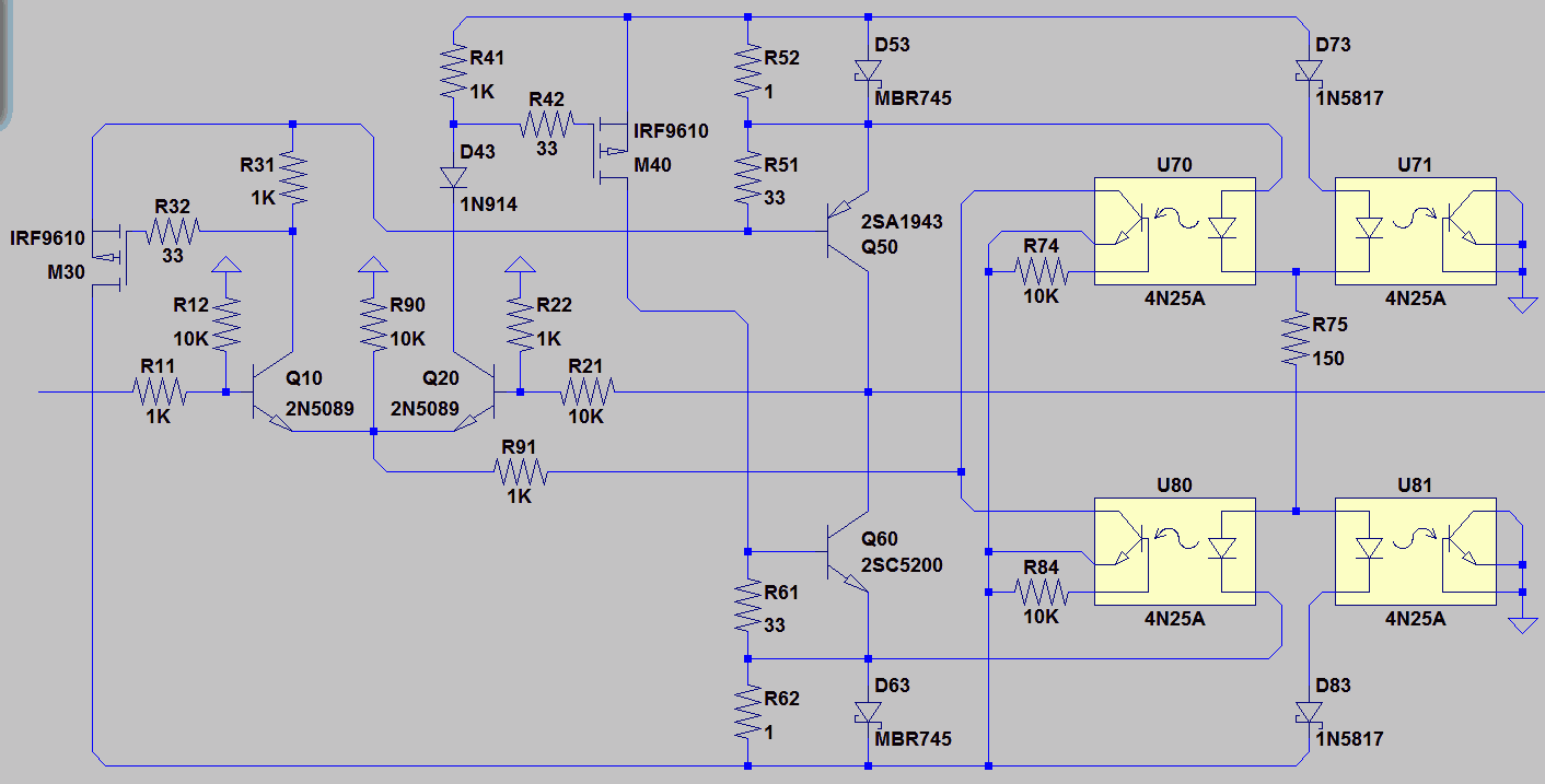

Right now I'm attempting a baseline example to see what a normal Circlophone could do. ♫♪ The Inexpensive Circlophone© ♫♪ It is very much like post 1 with some of the expense subtracted and a slightly different voltage, aimed at 4R to Tip35c, and seemingly keeping the parameters normal.
Unfortunately, I had managed to connect a possibly decent predrive to a erroneously haywired output section, somehow confusing a topside photo with a trackside photo, and that smells awfully. Visible damage looks inexpensive, with 1 Tip35c and 2 resistors nonfunctional.
However, the drivers need checked out somehow. The load that I was planning to drive with them is an ac voltmeter, hoping they can produce signal. For repair, I do have more ST Tip35c, but unfortunately, no more 2SB649 at the moment and I do not know if they survived my wiring error. I do have "Authentic Chinese" Fairchild BD140, which might not be that good, but of course might have to find out. . .

Muntz'd an entire current mirror, yet kept drain voltages ~ equal.
What more to be simplified and still obey laws of circlophonic logic?
I am still uncertain 4N25 optoisolator will conduct the required current.
The curves stop at 1mA, even though spec suggests it could go higher.
Maybe time to dig up the 9610 .model and see what LT thinks of it?
If the optos don't reduce complexity, really no point to them...

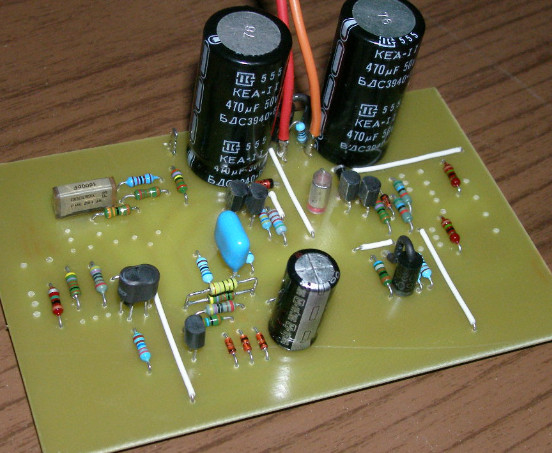

C8 and C9, decoupling caps
I missed that.
I am not sure it is a good idea: without a local decoupling, it won't be possible to achieve the transient cleanliness displayed in the oscillograms at the beginning of thread.
There is still plenty of room in the middle of your PCB, and it would certainly be possible to include at least a minimal on-board decoupling: nowadays, 10µ/63V caps are tiny, and they would make a big difference if there some length of wiring to the supply caps.
If you choose to include them, place the supply pads in close proximity, to avoid creating low impedance loops in the tracks.
I reiterate also about the respective placement of the output pad and the feedback take-up point: as they currently are, they will easily cause a doubling of the THD.
It is a possibility, but it would have to be a matched pair: MOS have a large dispersion in the threshold voltage, and this would force Q3 and Q4 to run at different currents.
This would increase the distortion.
It is a concern, th Miller cap there has a strong effect, and it "mixes" the modes
Without it, the amp oscillates, in sim and (much more) in reality
Compensation is rather messy. I have tried to keep both loops as independent as possible, and each is comfortably stable in its own right, but the mode mixing at higher frequencies creates unexpected effects.
I do not have a deterministic approach to cope with these effects.
Be very careful not to leave a damaged component in place before making you next attempt. This includes low-values resistors, zeners, etc.
Be aware that some components might appear OK when tested with a multimeter, but could still be non-functional.
I would be very suspicious about your other TIP35: if one has gone, the chances are the other is also damaged.
I do not recommend testing the circuit without OP devices, it could do more harm than good, use the light bulb tester instead.
