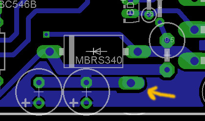

@powerflux:
15R and 56R on bottom are reversed on silkscreen. Also, you can push them a bit front side due to opening room for driver heatsinks. You can flip 1R and 0.5R in safe. There is enough room.
Bottom side decoupling capacitor's pads different. Upper ones seem good.
You can avoid first bypass cap each side (most left ones) and you can use their pin as supply pad. If you go with this, current will flow through these caps in optimal way. I have modified pdf in this manner. I will post some pics soon.

you are correct, my apologies. i've swapped those values on silkscreen and i've also moved the resistors to give the BD's more space for future revisions. you can now put one sheet of +/- 1.5mm aluminium across the board and mount both BD's to it. they're "in-line" i've got the feeling there will be more recommendations so i won't attach this subversion at the moment, only a screenshot.
just make shure to first mount BD's and "cooling-sheet" before surrounding components.
however, i don't understand what you mean by different pads. negative pin is octagon, positive is round.
you are correct, my apologies. Swapped values on silkscreen and i've also moved the resistors to give the BD's more space for future revisions.
i've got the feeling there will be more recommendations so i won't attach this subversion at the moment.
I expected each side pin as same. If there is a design rule, then it's not a big of deal. But my recommendation regarding using first caps as supply pad should be a good improvement.
EDIT: I depicted on last last revision. Also, wire jumper's pads too small for etch and drill.
