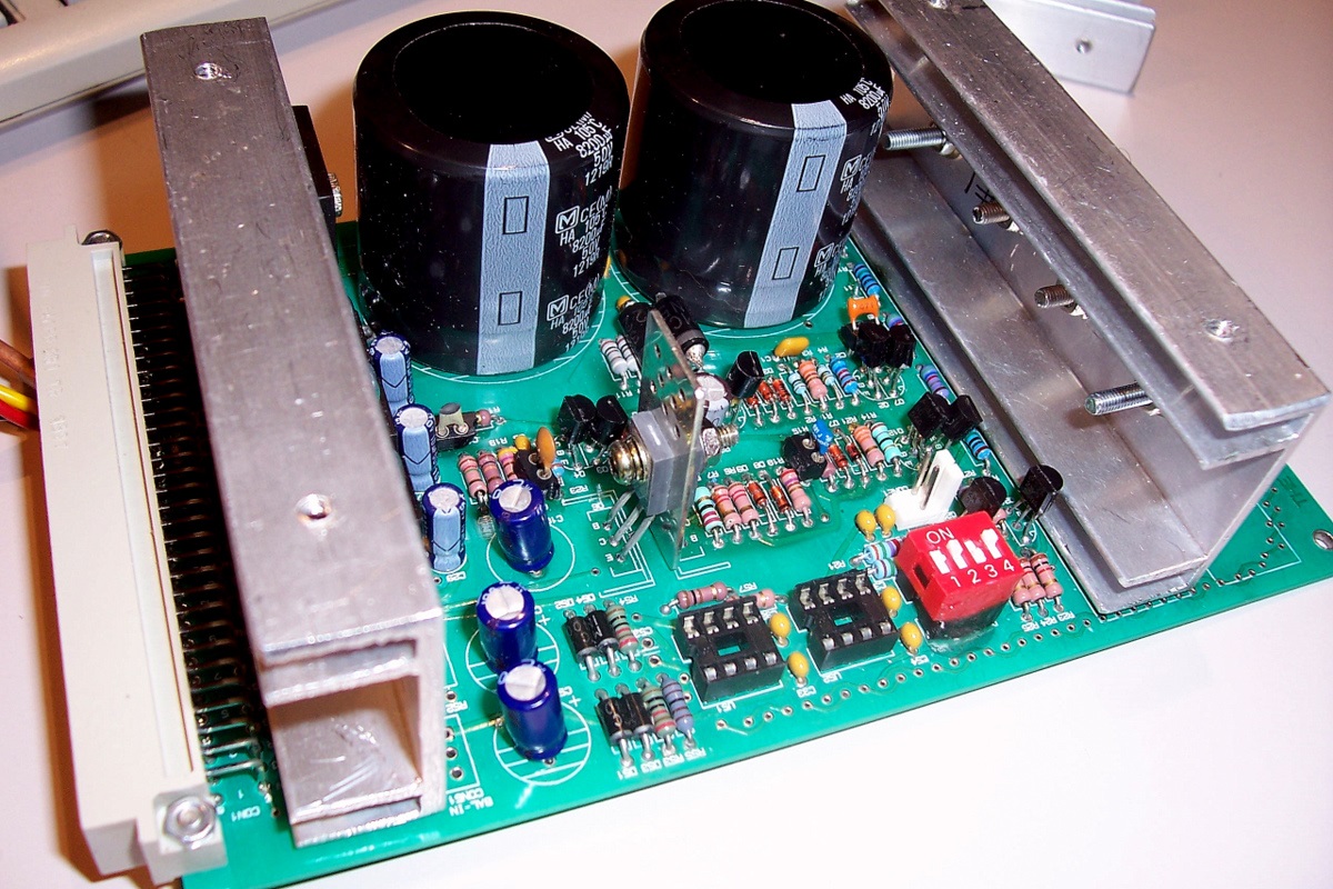

Some great news:
mickeymoose is about to release his PCB version for the Circlophone.
It is a complete one-channel module including the power supply, a balanced preamplifier, a fan, fan controller, auxiliary supplies, and a well thought out mechanical/heatsinking design.
Neat and compact, works like a charm.
Here is a preview of the beta version:

ELVEE:
Thanks for your patience in getting all of us this far with this amp!
Some additional info :
The board was designed to fit a DIN standard card-frame, size 100x160mm, the assembly is 1.8" wide
I will post schematics and layout info soon
All parts used are through-hole and standard, off-the shelf
If there is enough interest in a group-buy I see following parts included in the package:
2 pc boards (amp & back-plane), heatsinks (4 pcs.) and a programmed uP for the fan
E

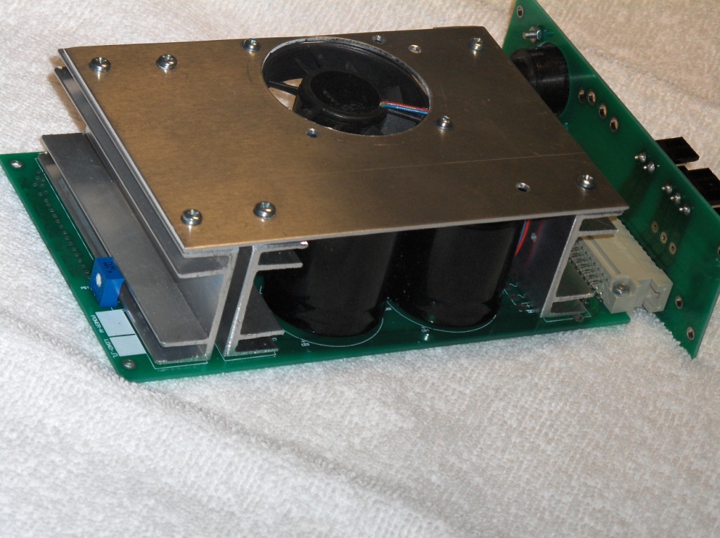

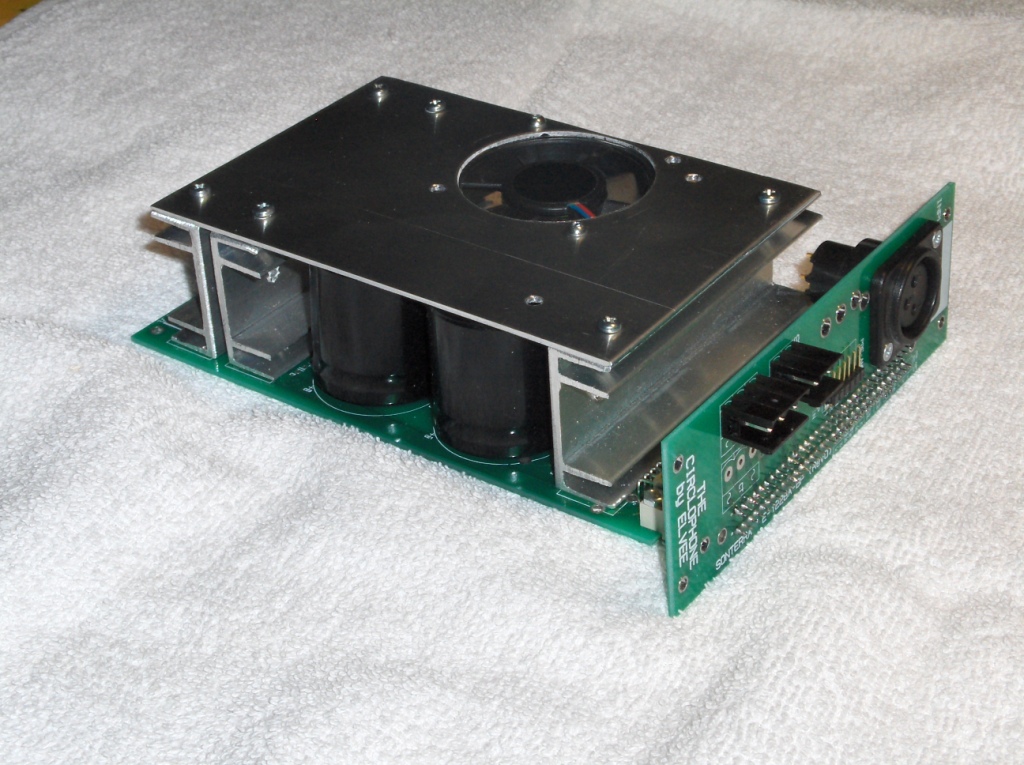

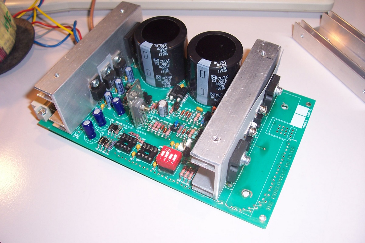

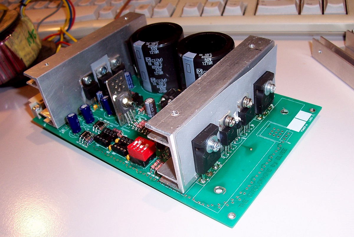

Thank YOU for your dedication!
Here are some more pics of the "innards" (always the prototype of the beta version):
The cost of the "kit" depends on what you expect. The easiest for me (and cheapest for you) is just the boards and pre-cut heatsink parts (drill your own holes), it is diy audio, after all. The code for the fan controller will be available (not yet written, any one willing to do that?)
Cheers, and lots of presents to all! E

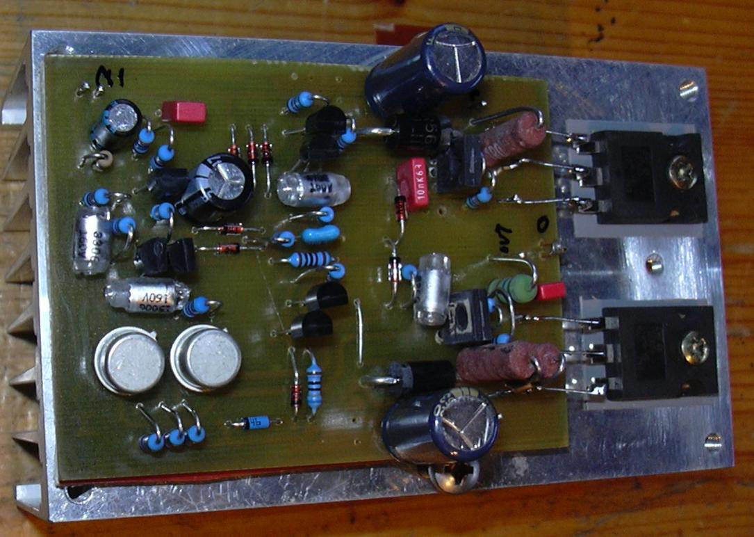

i made a circlophone based on powerfluxes pcb (see the attached picture). I did use the transistors originaly proposed in the schematic. Voltage ist +-25V.
Power draw (no signal) from Transformator is approx. 10W.
First impression (using cheap speakers): Good bass and mids. 🙂
The only problem i am experiencing: The driver Transistors and 2n3019 are getting too hot to touch. Did anybody else a build usind the tight packed powerflux pcb? Is there a clever way to use a heatsink on the to-39 package?
Thank you.

i've made a mistake: 15R and 56R on bottom BD are reversed on silkscreen. this has been noted before but here i've uploaded a corrected PDF-document.
Other improvements are more space for cooling for the BD's. if one doesn't use the jumper, or solders one on the bottom, one can use a flat standing piece of aluminum across the PCB for both BD's together. but do remember to use isolation (mica or silicone)
i call this V2.0, and the power transistors are TO-264
