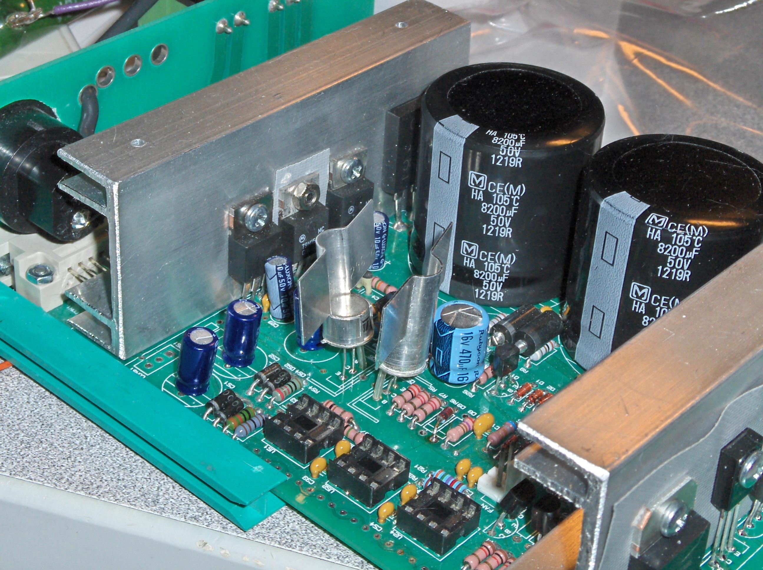

i made a circlophone based on powerfluxes pcb (see the attached picture). I did use the transistors originaly proposed in the schematic. Voltage ist +-25V.
Power draw (no signal) from Transformator is approx. 10W.

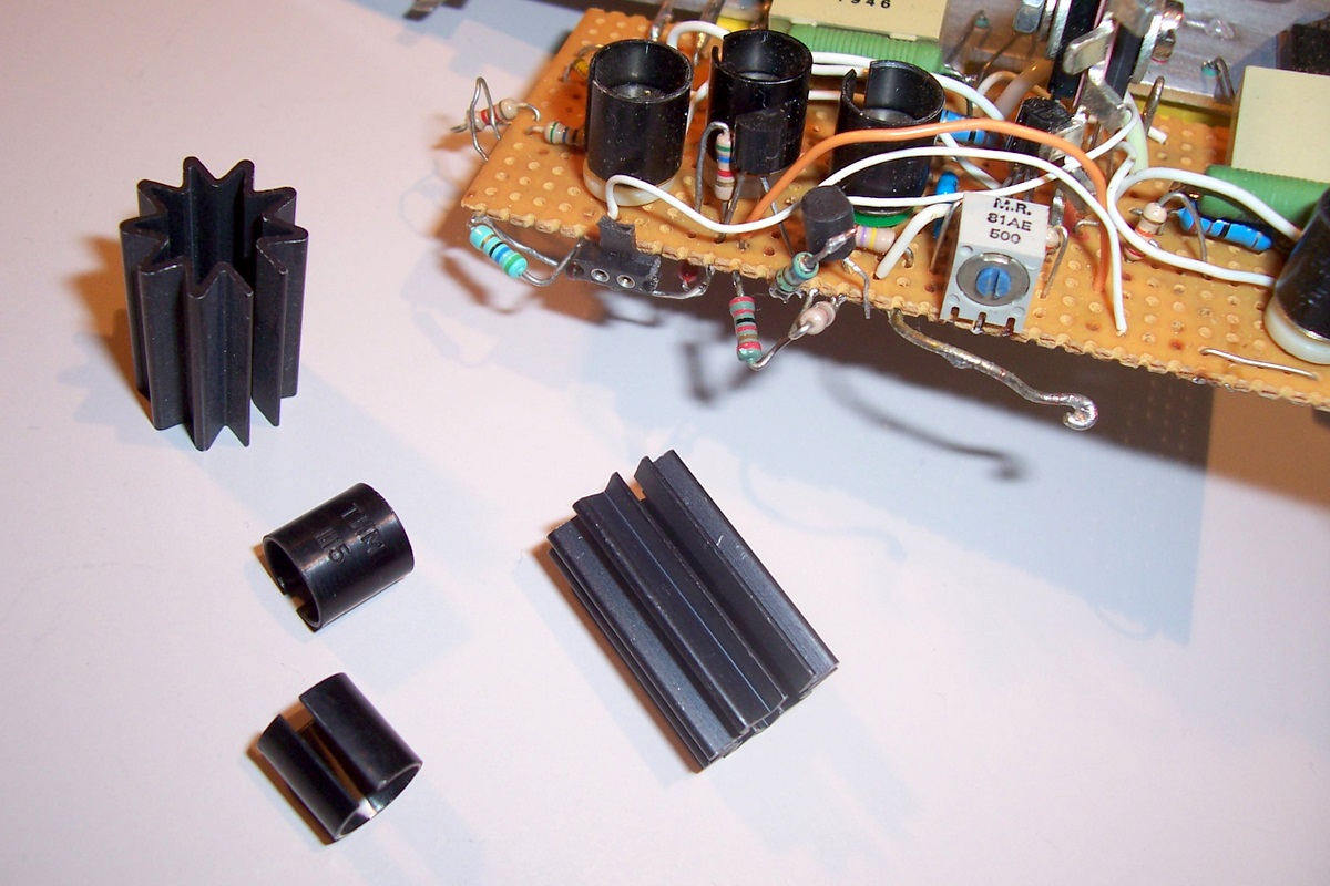

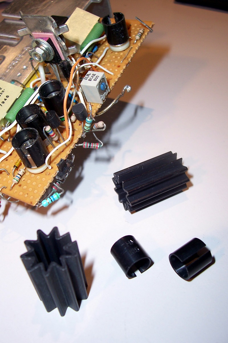

Here are two examples of cooling clips for TO5/TO39.
One is a very small, tube-like shape. It could be used in any situation, even where there is very little space.
It is marked "THM 1115" (probably Thermalloy).
The other is a corrugated, chimney-like, and is more obtrusive.
Between these two extreme, one can also find medium-sized grooved cylinders.
I have no example to display unfortunately.
This is the heatsink I used:
Edit: I replaced the MJE15031 (see Elvee' next post) with the 2N3019 in this setup. I am still looking for a suitable transistor in a TO220 or similar package. E
