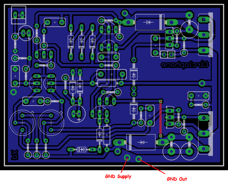

The input is in the right region regarding the ground.
To avoid passing high currents at unpredictable places of the ground plane, I suggest you set the position of the supply (power) ground and output ground pads.
Placing them in proximity will avoid uncontrolled dispersion elsewhere.
Note:
By pushing the diodes towards the center of the board, there would be room enough for decouplings.

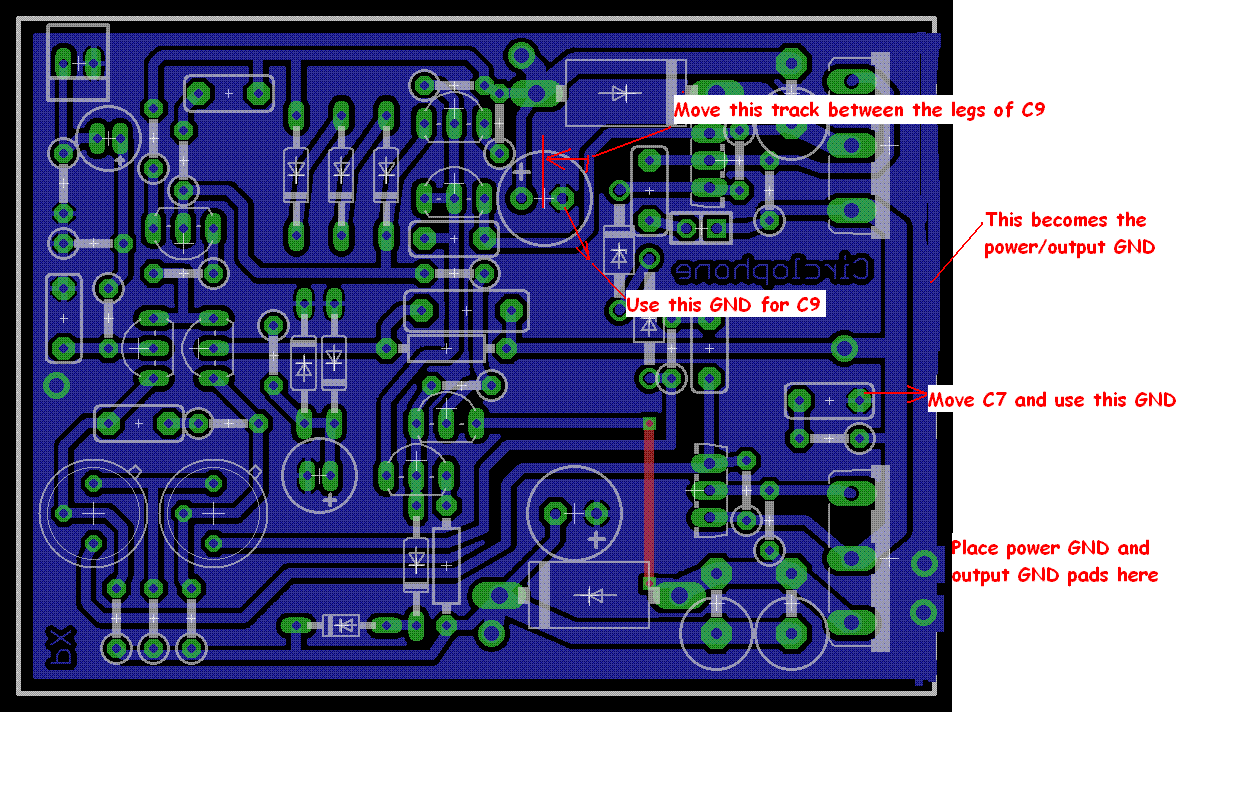

like this? i really dislike the way the drivers are routed. there is only space for the tiniest decoupling caps..
I am not too concerned about the drivers, but the way C9 returns to the ground is a problem: it loops back more or less randomly through the input section, and this is going to cause troubles.
The best solution would be to push the big schottky's D4 & 5 towards the center of the board and place the decouplings on the outside, near the edges.
Alternatively, as a second best, it is possible to choose a better return path for C9, without modifying the placement of components.
See pic.
It is also important to define a power and output ground clearly, where the Zobel also has to return: mainly to the right of the board.

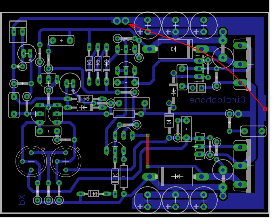

a quick one. forgot about this project since i'm buisy with an I/V converter.
let's call this 0.6.
- enlarged PCB a bit
- fitted caps
now i want to get rid of the whole groundplane on the left side and just route on specified path back. opinions?
EDIT: like this. 0.7
This time, I think it is about OK. I would just change the placement of the power and output ground pads to eliminate the effect of the class B current from the positive side, but otherwise it is good, and this applies to all versions.
The ones with the complete ground plane are more risky, less deterministic: they might very well outperform the plain boring single ground ones, but I cannot tell for sure.
Any version will perform acceptably.
Some refinements would still be possible to minimize induction effects from the outputs currents, but the improvements gained would be below the current level of performance of the amplifier, and a proper dressing/placement of the wiring would give similar results so I think we can leave it there.

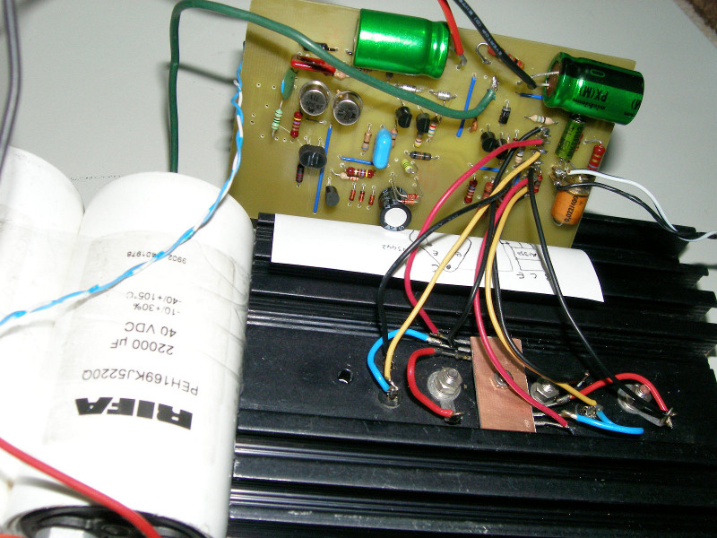

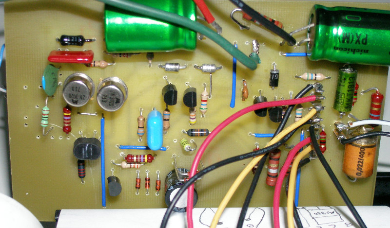

My dirty setup
At last I finished and listened one channel. I have modified wakibaki's pcb respecting 2sa/2sc small signal transistors. During populating parts, it was not easy to deal with narrow headers and bridges.. just needed some patient.
My setup:
2sa970 as PNP small signal
2sc2240 as NPN small signal
2sa1930 as Driver
2N3442 as output (test setup)
2N3020 as bias servo
180pF as C12 (servo compensation)
1200pF as C6 (main compensation)
31V per rail
Unbalanced signal
After sure that there is nothing wrong with dc-offset, bias current etc, I plugged speakers. On first listen, I realized that all efforts was absolutely worthy for this amazing amp! I'm listening one channel with two speakers parallel and I'm forgetting each time that I'm listening actually one channel.
First big impression is DEAD SILENCE even with my 100db speakers! I never expected this level of silence. There are radio station antennas near my house those interfere with my gear easily. Circlophone barely kicked it.
Second big impression is human voice. Just impressive!
Detailed, well bodied presentation without any haze as mentioned by oddyseybmx before. I gained my expectations so far and I hope to finish second channel in short time.
Thank you for all collaboration.
