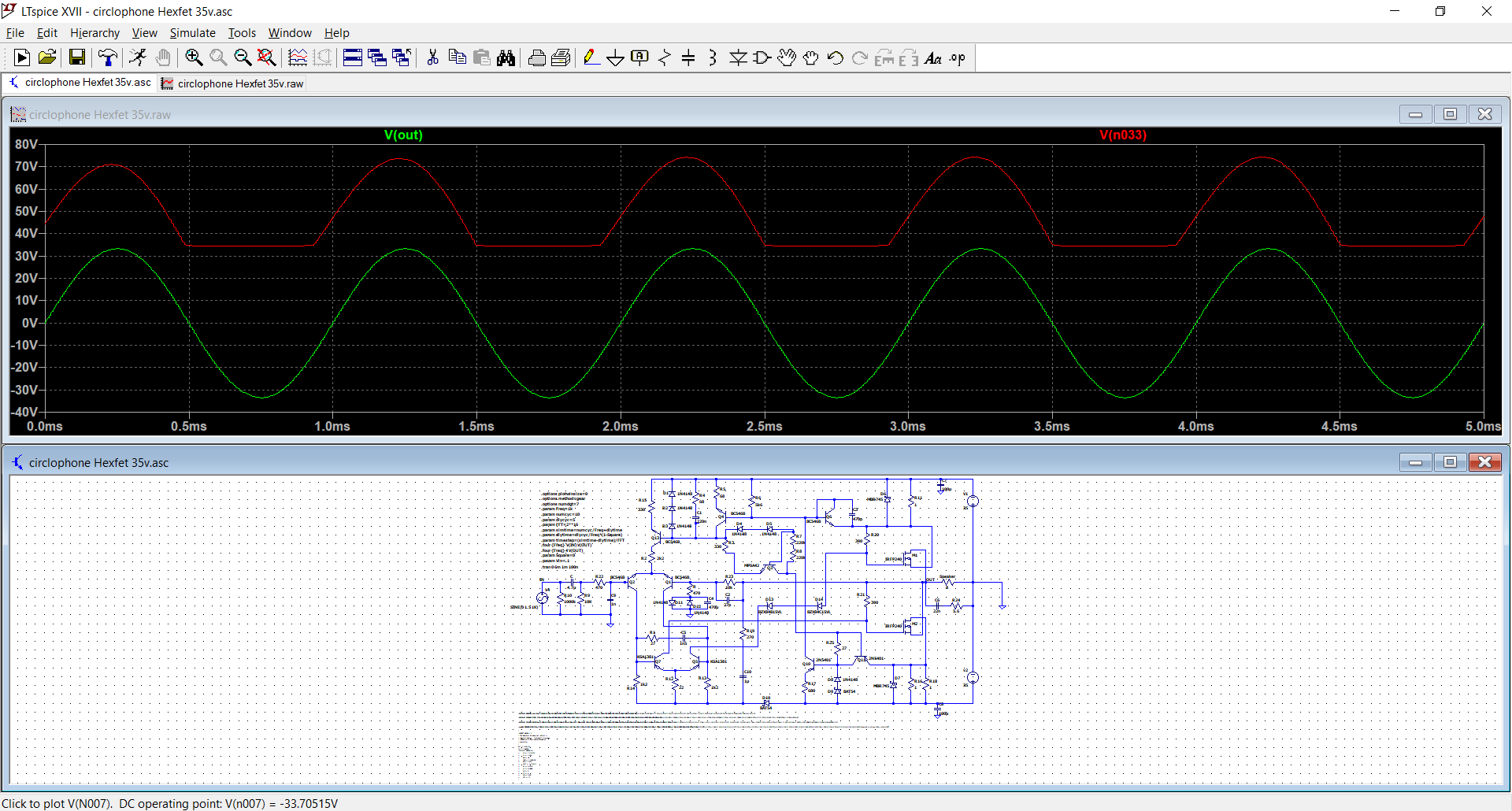

Mr Elvee, While increasing input frequency to 10Khz at input signal of simulation, the THD increases dramatically. What could be the reason or am I doing something wrong?.

I made the test, but I didn't see such an effect: your unmodified circuit at 1kHz gives 0.02% THD, increasing to 0.023% @10kHz.Mr Elvee, While increasing input frequency to 10Khz at input signal of simulation, the THD increases dramatically. What could be the reason or am I doing something wrong?.
With the bootstrap, the figure remained practically identical, and it didn't change when the amplitude was increased to ~70Vpp.
Remember that you have chosen to define the frequency at two different places (input source and parameters).
This means that when you change the frequency, you need to do it for both, otherwise inconsistencies will result.

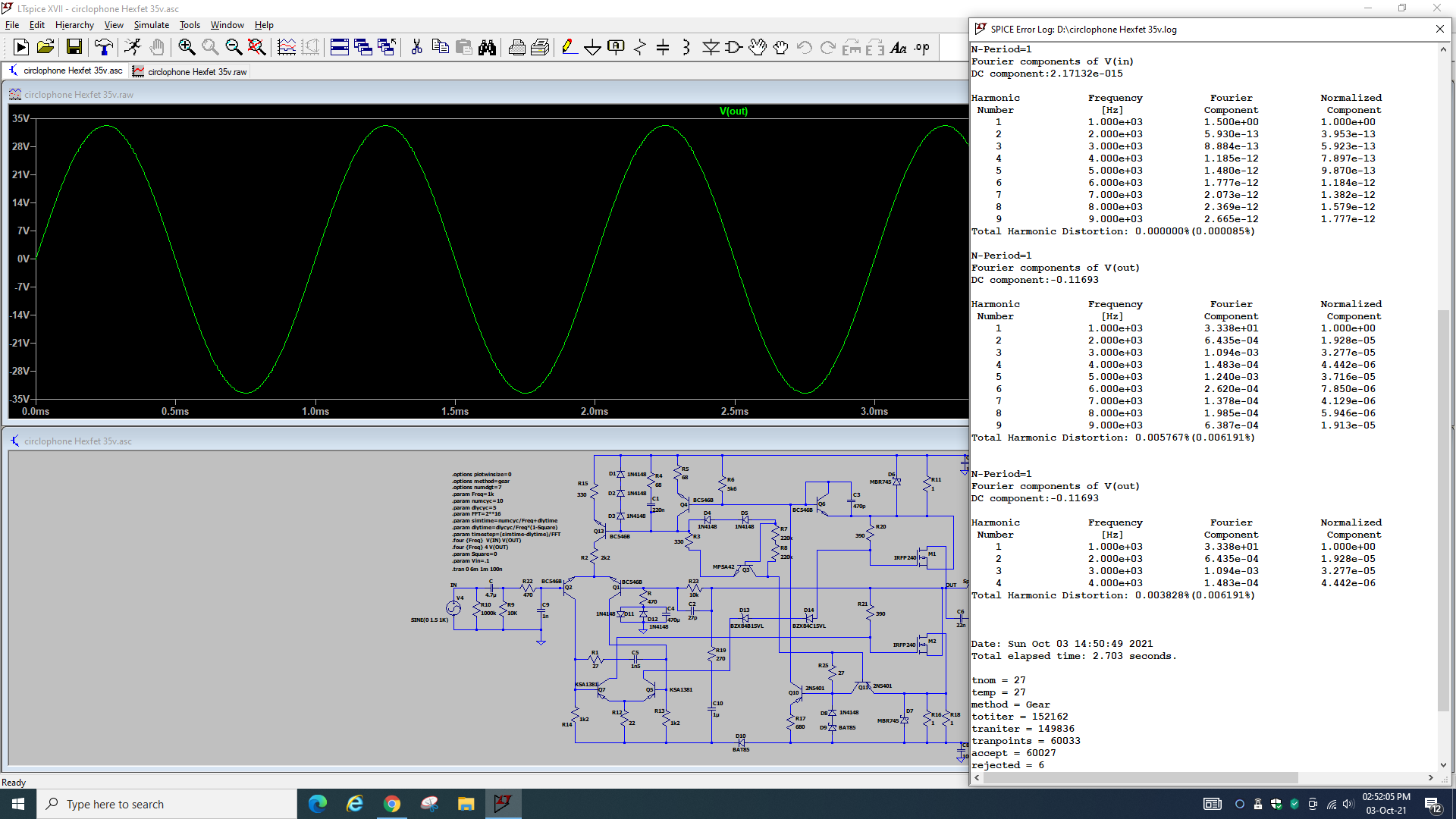

Mr Elvee,
Based on your recommendation of Bootstrapping circuit, I did following modification to the exixting build. This is what I achieved on the simulation at 1.5V input with 35-0-35 V DC rail. Snapshot is attached.
I am attaching simulation file with the request to please check whether I am getting such a low THD at 1KHz in actuals or I am doing some mistake.
LT Spice models of transistors used in the schematic is also attached.

The THD predicted by LTspice is what it is, it should be taken with a pinch of salt, but I see two issues: mainly the low value of C10.Mr Elvee,

To remain effective at VLF, the time-constant C10*R19 should be well larger than the period of the lowest frequency to process.
You currently have 270µs, but since most of the energy of an audio program is at low frequencies, you should aim at ~100ms.
The low value of R19 is also contentious, not only for time-constant issues: a low value generates a very high bootstrap voltage (more than 70V peak), as illustrated in this screenshot:
This will stress (probably unnecessarily) a number of components including the diode, and increase the dissipation.
It might have a favourable effect on the THD figure, but this has to be balanced against the possible drawbacks.
I suggest you use more reasonable values for the bootstrap passives, but feel free to experiment, in sim and reality

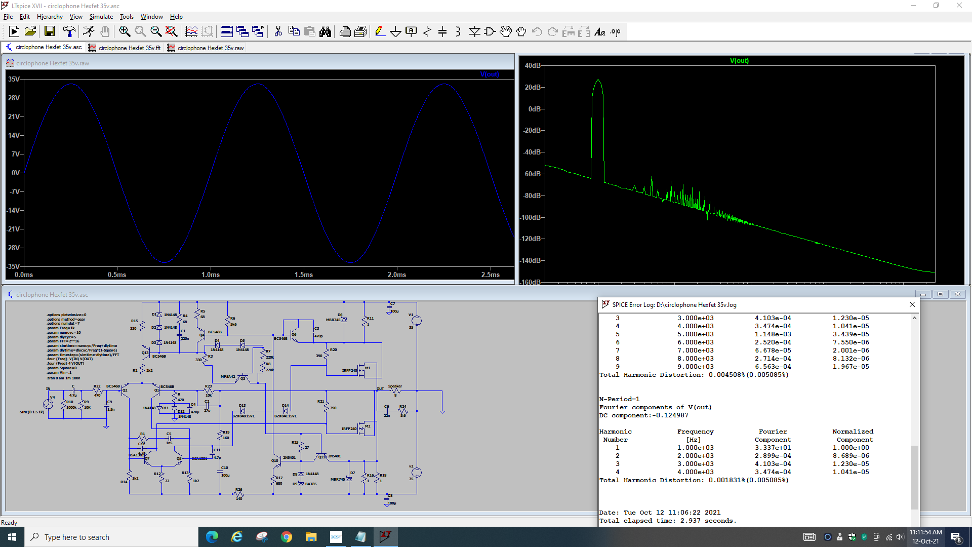

Mr Elvee,
I have incorporated the Bootstrap circuit in my build. I had to choose resistor version due to non availability of BAT with me. I donot have scope with me so I could not see the waveform in actual but I did get much lower distortion in simulation.
After so many iterations I could find the attached schematic most optimum. I donot know whether thereotically and practically it will be stable at full power since I could not test it at full power but there is no stability issue at quite high lstening levels.
The Vout FFT showed wierd harmonics with bootstrap circuit which were not there previously yet there is no change in sound quality. As a designer you can tweek it further w.r.t stability issues if you could spare some time on this schematic.

In fact, you do not really need to use a BATxx.
Any signal diode, typically 1N4148 or BAV20 will work in this role.
In theory, a schottky has ~zero recovery time, but at an audio time-scale, the 5ns or so of the 1N4148 is completely negligible.
I do not see any stability issue with your latest implementation, but the 100µF cap is a bit low, considering the resistor values.
220µ or 330µ would be preferable, but I recommend you upgrade to the diode version: it does not require a large cap, and is more efficient.
I wouldn't worry too much about the Fourier analysis results as long as you don't see an elephant in the room: sometimes reversing the order of two series components is sufficient to induce small changes, which of course have nothing to do with reality. These are just simulations quirks
