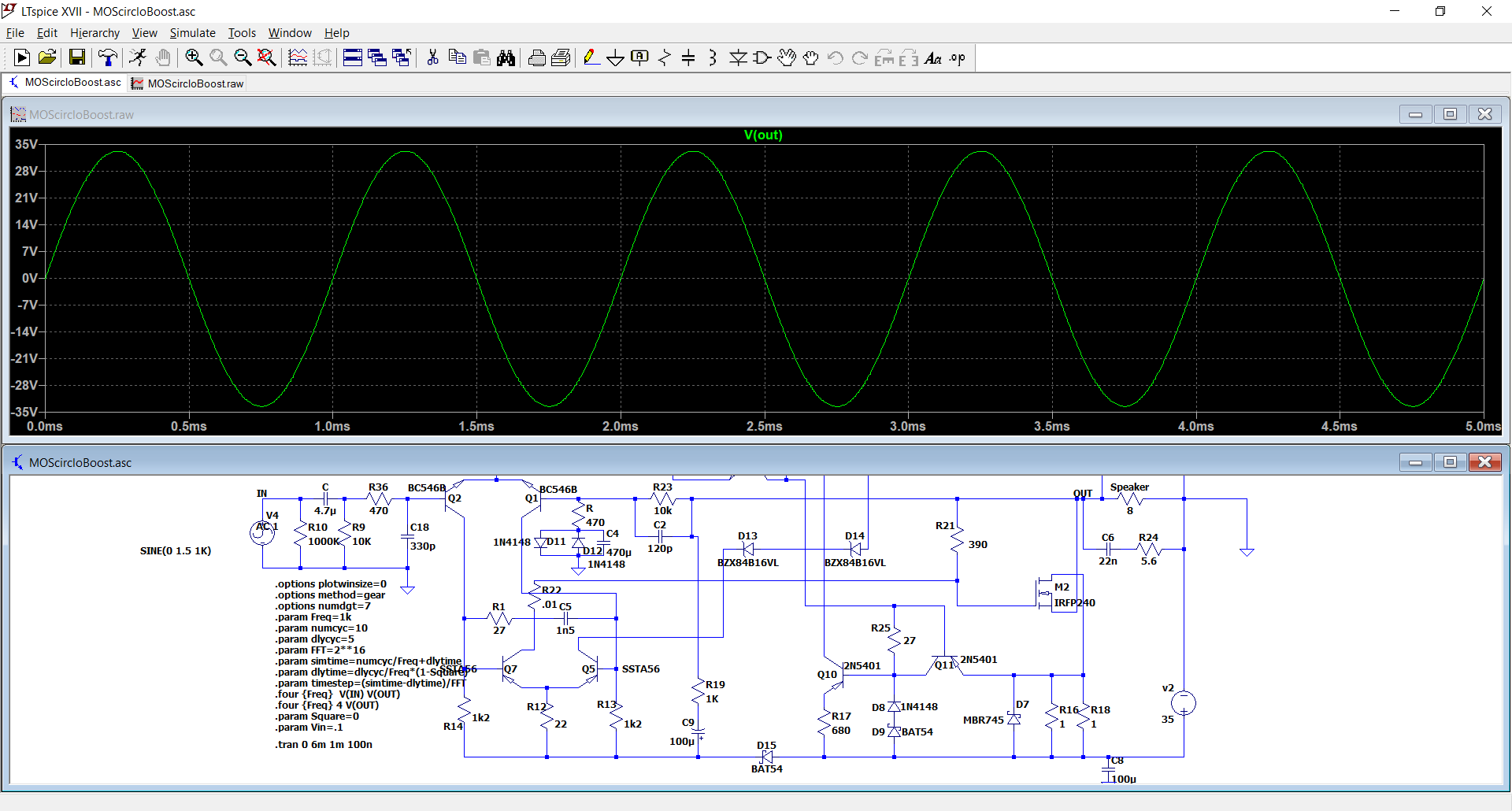

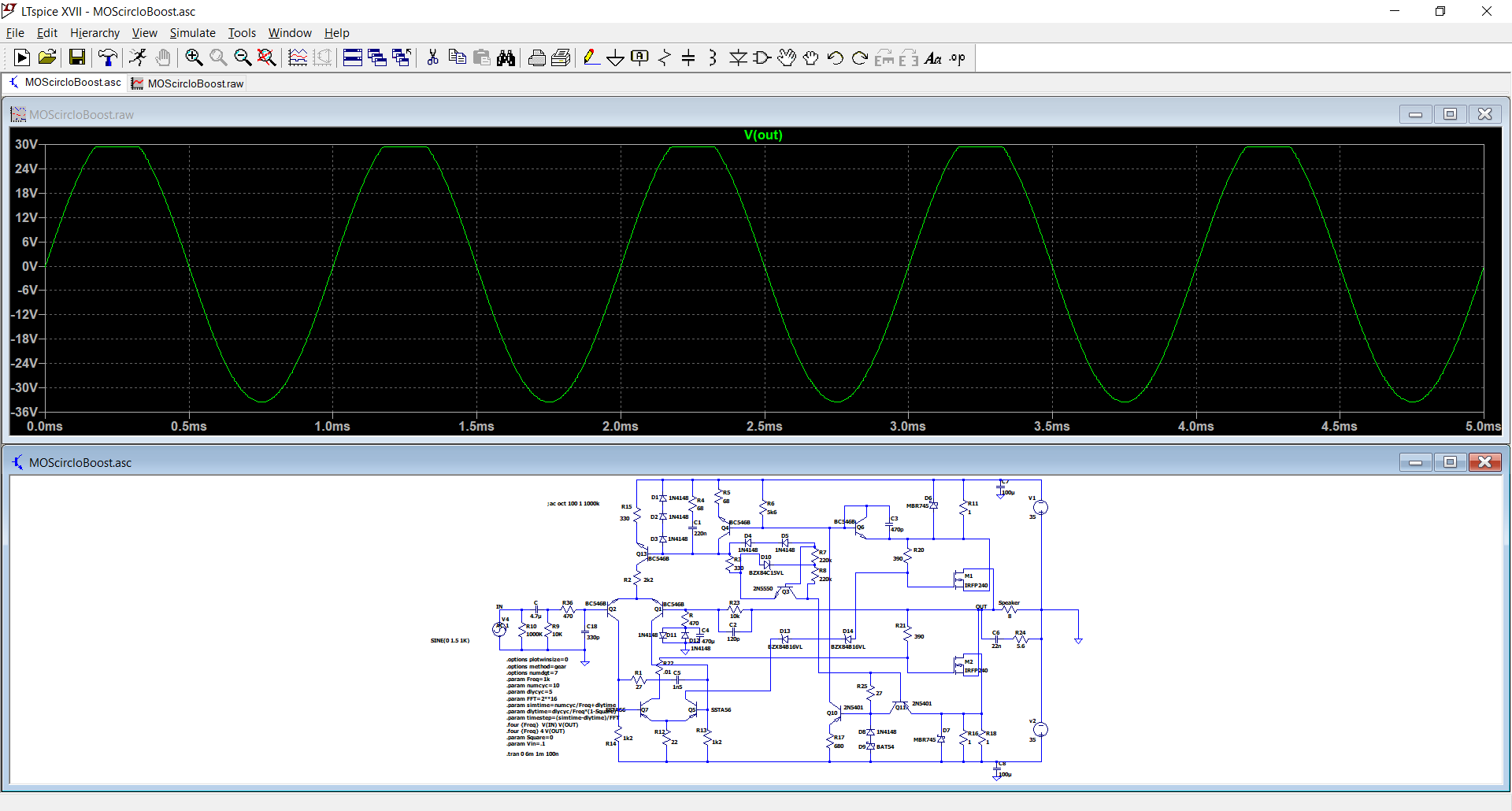

Mr Elvee, Is there any solution for symmetrical clipping in MOSFET C. Only positive half goes in to clipping by amount of GS voltage. Also series resistor of 470R at input increases slew rate of C. Thanks
There is in fact a solution: the whole driver assembly can be bootstrapped to allow the maximum voltage swing.
To illustrate this, here is your unmodified FET version when overdriven (there are minor transistor changes, but it's to accommodate for the native LTspice library):
attachment.php
Now, here is the same circuit, also overdriven, but with the bootstrap installed:
attachment.php
The mods should work in reality, and the power lost in the resistor should remain <1/2W.
Can you clarify your issue with the 470R?

Wish I know this earlier. I thought that it is a fundamental issue relating with nature of the FETs. Thanks for Elvee for quick solution and Katiyar for bringing up this. I didn't sim it yet but I hope this won't bring some other issues like degraded stability and THD.

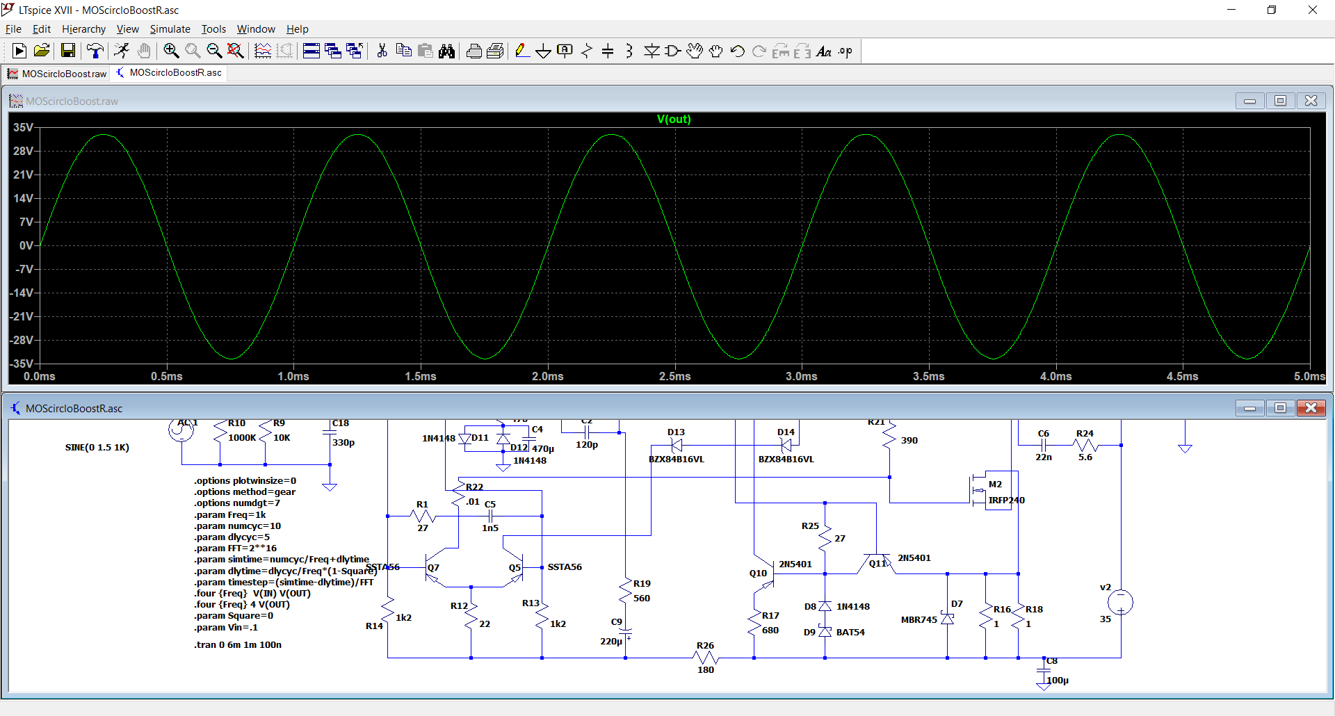

One might object to the discontinuities introduced by the diode; they are minimal, especially with a schottky, but they are present and although they should not cause troubles thanks to the symetrical nature of the structure among other factors, they could make purists uncomfortable.
It is possible to dispense with the diode, but it requires more power, because the bootstrap becomes completely linear, and wastes power for the whole of the cycle.
In addition, the increased impedance might cause stability issues (reducing the impedance would be possible, but at the cost of even more lost power).
Here is an example anyway, for what it's worth:

According to sim, THD drops from 0.005 to 0.001 with schottky and to 0.002 with resistor. Quite interesting.
Interesting and encouraging, indeed, but when it comes to very low THD levels in sim, they need to be confirmed in reality.
Sims are incredibly useful to highlight possible issues and their remedies, but once you have reached the performance floor, some kind of reality-check is required because many subtler higher-order effects aren't properly modelled, or some non-linearities happen to compensate one another in the sim, but not in reality.
The opposite can be true too, but it is a rarer occurrence: something like 20% against 80%.
If you have a working MOS-circlophone, testing the bootstrap should not be difficult or intrusive: you just need to add three components, and cut one or two tracks, depending on how the existing PCB was laid out
