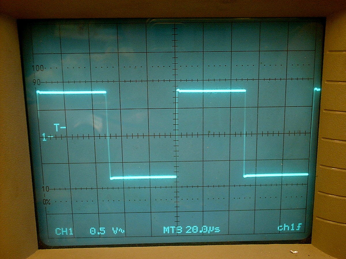

when output transistors are MJL21194 which value C12 should be used ? ( originally shown 820pf on page one )
I read somewhere in the post that with 2N3055, 180pF worked better.
I think I will follow the suggestion from post 1864 by Terri.
But do let me know if something has changed
Thank you in advance
You can try 180pF, but make sure that there are no signs of instability.
A good test is a ~10kHz squarewave with the output nominally loaded: the edges should be neat, without ringing or overshoot, something like this:
In this case, stay on the safe side: use 820pF. It is safe and proven with countless device types, and the published specs apply to this case.
Using a lower cap will improve the dynamic performances with suitable devices, but refrain from using one until you have the means to check its viability: you certainly do not want to fry your tweeters
