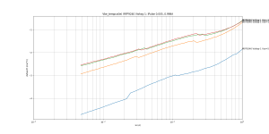

I didn't do a quick dirty test during matching. With or without heatsink, first value and then stabilized value etc. Somehow devices have retained their gap in each condition then I assumed that method is fine. As you noted, actual circuit will decide.
Interesting real-world feedback: it is generally assumed that MOSfets of the same process can be matched accurately based only on a single pair of parameters.
It would be instructive to see what the dynamic behaviour is (I assume you measured the quiescent current).
Peufeu should have the means to test it in his measurement setup.
When he is finished with his main targets, he could investigate that particular aspect

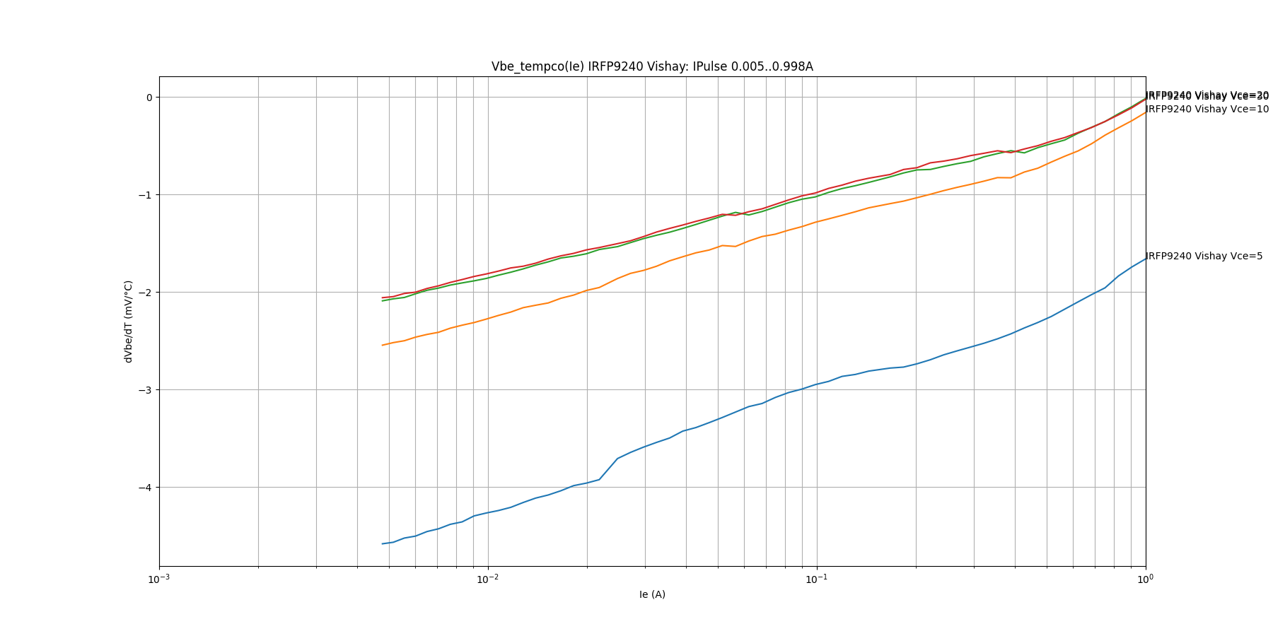

I only tested 2 samples of IRFP240/9240, so caveat...
They had different Vgs tempcos (it also depends on Vds and current)
So if they have a bit different tempcos, and you measure them at ambient, they will no longer be matched when hot in the amp!
But they had exactly the same gm versus Id:
But... I used pulsed measurements: Vgs and Id are applied, then Vgs is measured a couple microseconds later.
Without the pulsed technique, looks like it's another can of worms...

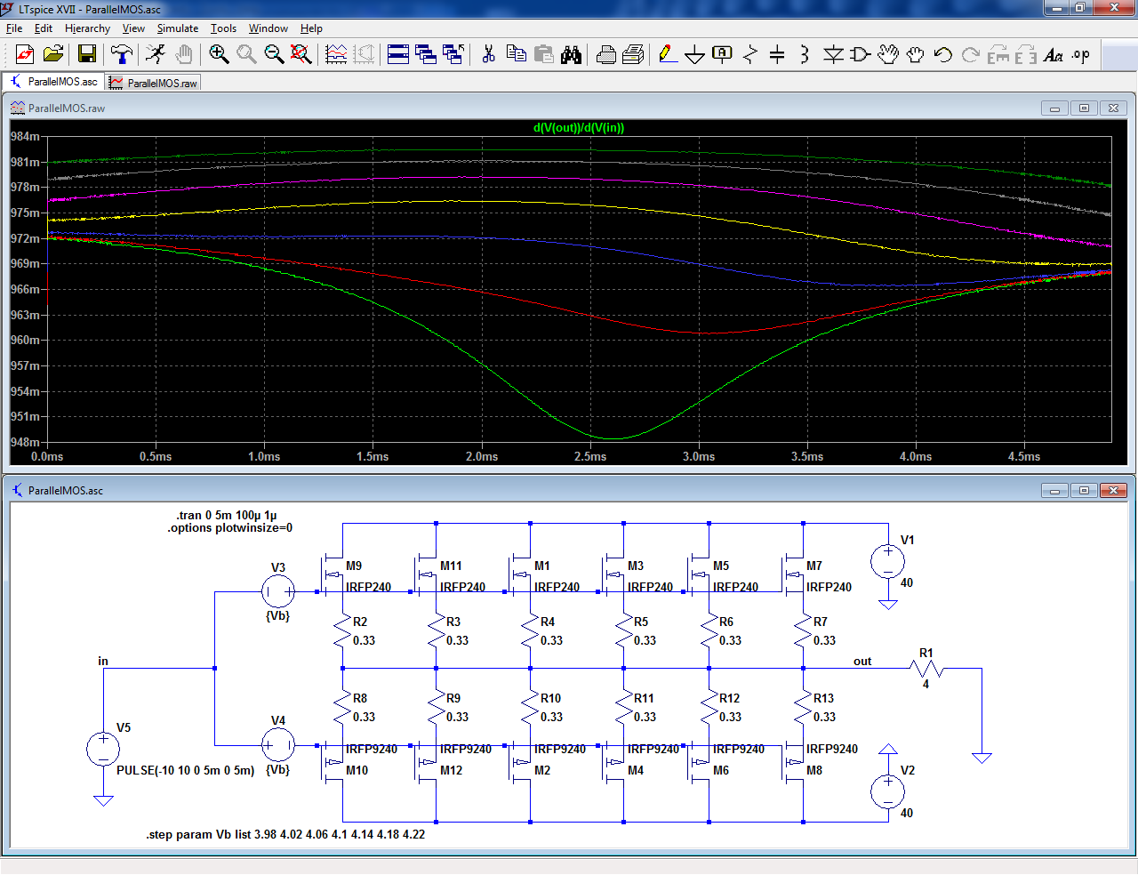

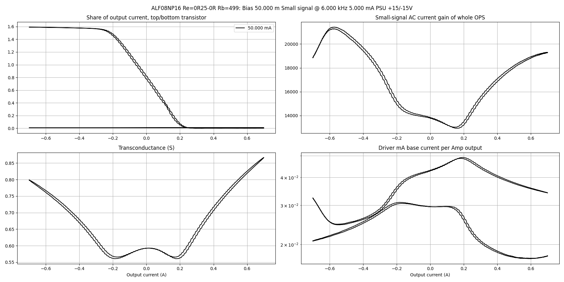

There is a problem with the sim: with the IRFP240/9240 models, crossover artifacts are practically absent.
There is some droop in the Xover region if the bias current is really too low, but when it is high enough, only a hint of gm-doubling is barely visible.
Difficult to improve on that.

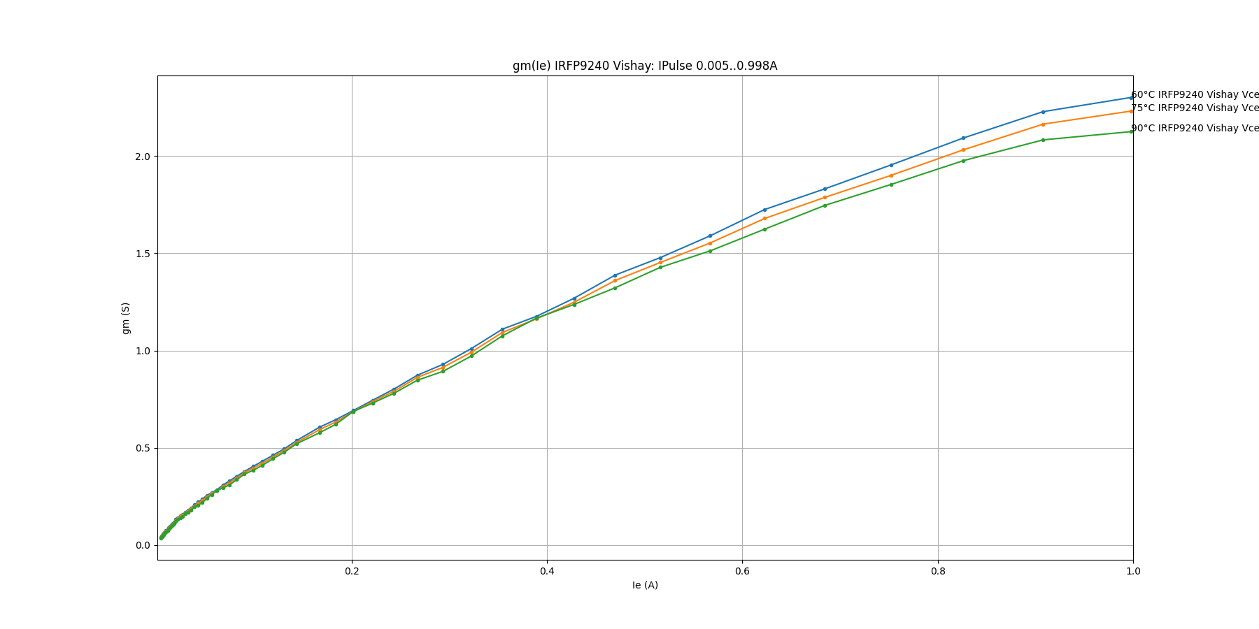

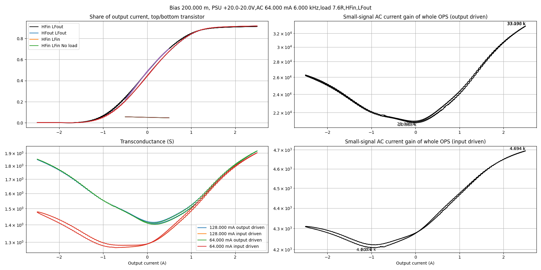

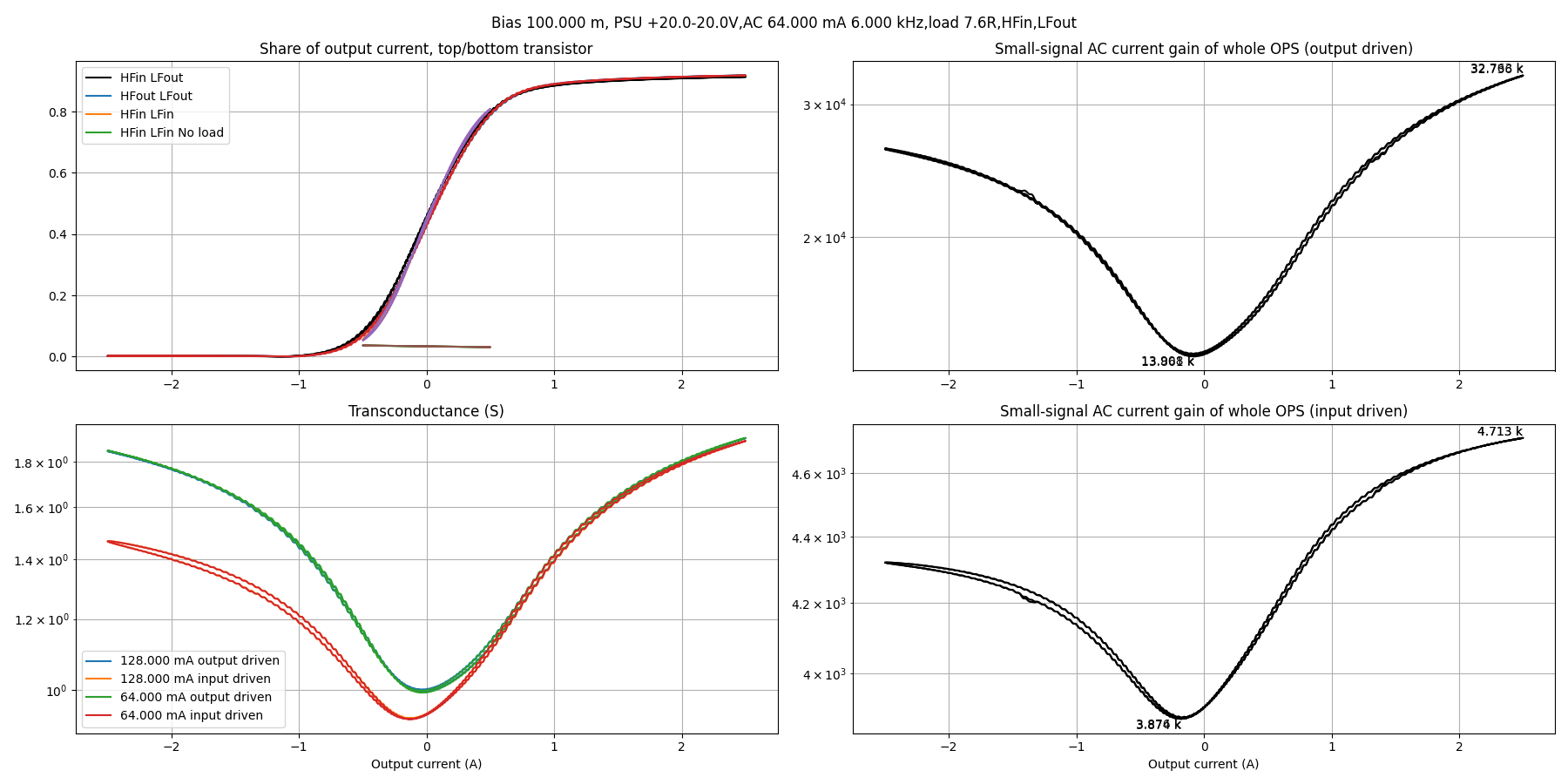

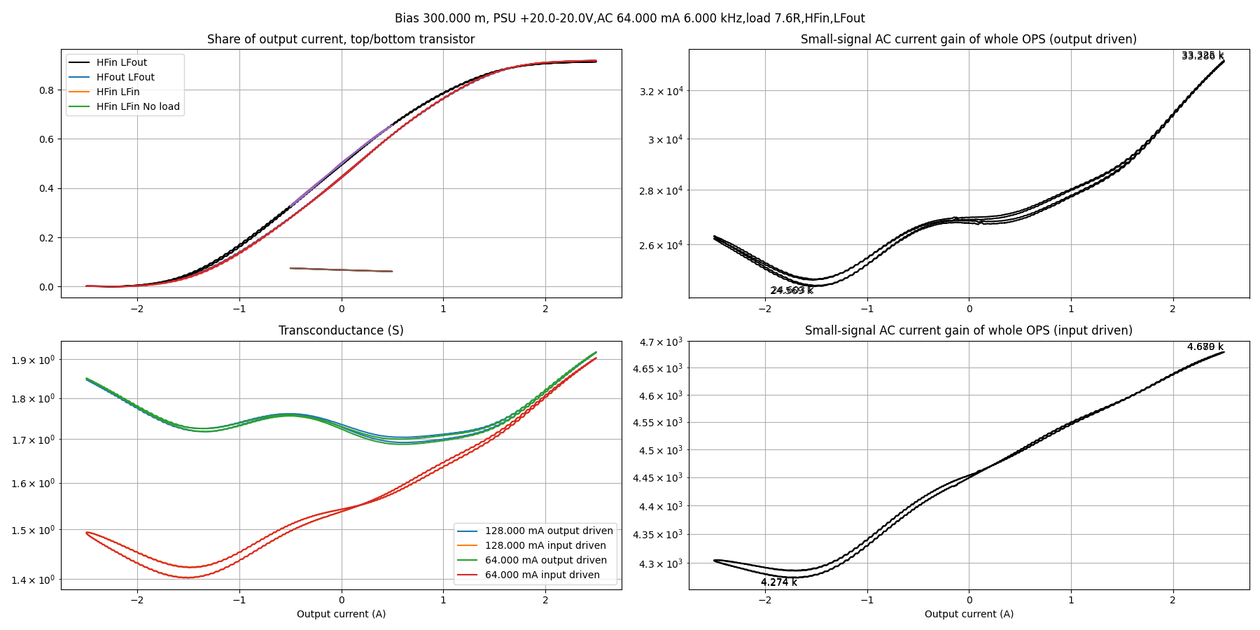

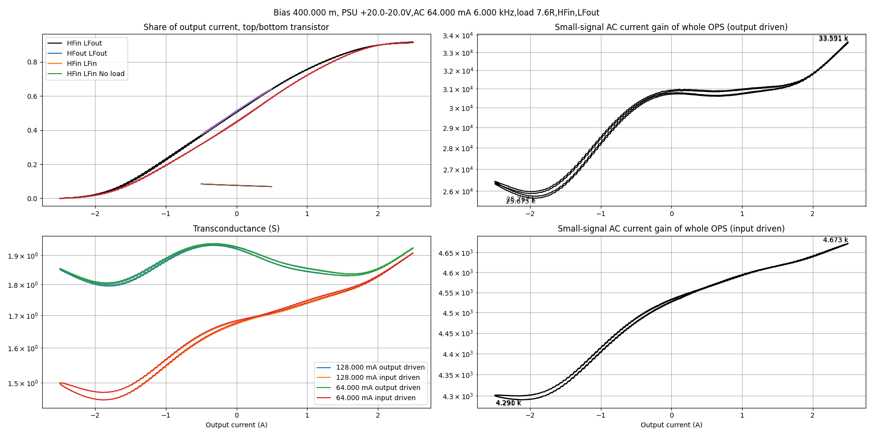

Your models agree with my measurements. These FETs produce a very nice crossover, but they need quite a bit of bias current to fill the gm hole in the middle. Plots below are one pair IRFP240/9240 with non-inductive 0R33 source resistors.
Can you post the same gm plot with your FQA models?
gm-Bias 400.000 m, PSU +20.0-20.0V,AC 64.000 mA 6.000 kHz,load 7.6R,HFin,LFout-IRFP9-240 v13 Re=.png204.6 KB · Views: 108
gm-Bias 300.000 m, PSU +20.0-20.0V,AC 64.000 mA 6.000 kHz,load 7.6R,HFin,LFout-IRFP9-240 v13 Re=.png195.3 KB · Views: 247
gm-Bias 200.000 m, PSU +20.0-20.0V,AC 64.000 mA 6.000 kHz,load 7.6R,HFin,LFout-IRFP9-240 v13 Re=.png193.6 KB · Views: 252
gm-Bias 100.000 m, PSU +20.0-20.0V,AC 64.000 mA 6.000 kHz,load 7.6R,HFin,LFout-IRFP9-240 v13 Re=.png175.4 KB · Views: 247

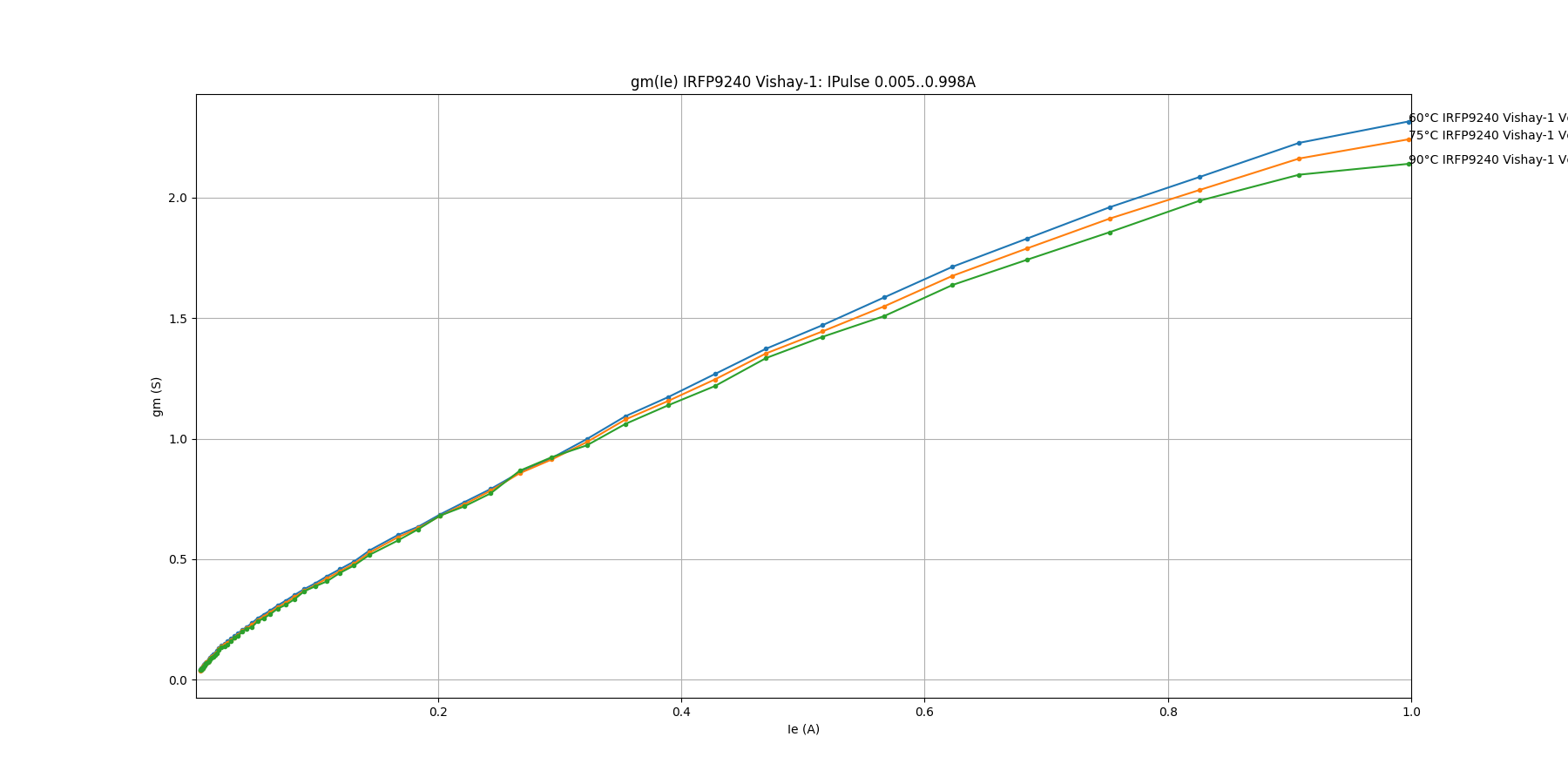

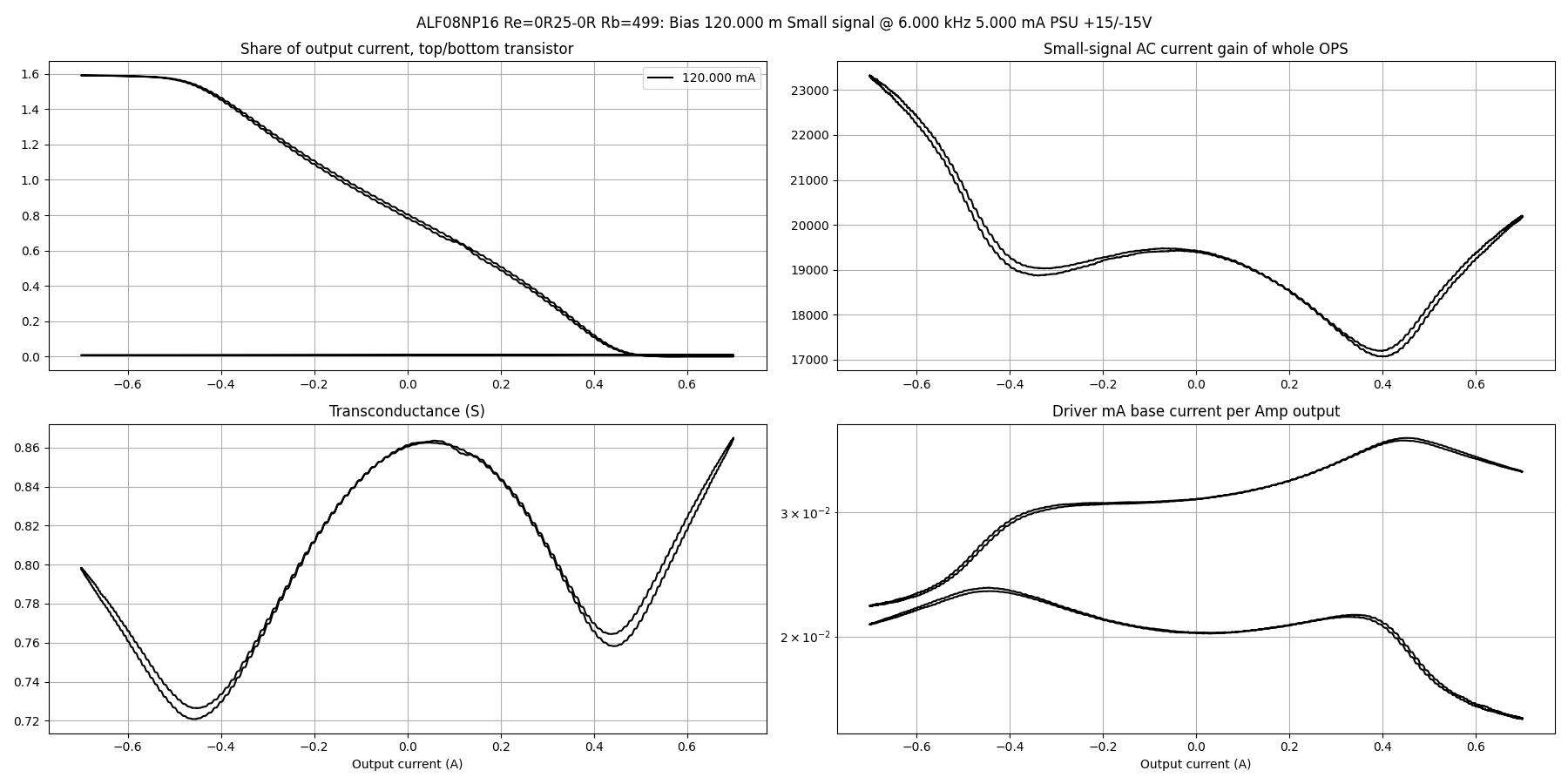

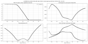

I measured FQP19N20/FQP12P20 a long time ago and they give a similar gm plot, very smooth.
But TO-247 versions FQA19N20/12P20 have been discontinued, leaving only TO-220s (FQP reference) which have high thermal resistance. And their tempco is much higher in the wrong direction than the IRFP's. Both factors combined mean the bias goes YOLO. Also, difficult to parallel, the hotter one will steal all the current. With the huge TO-247 package and very civilized tempco, IRFPs are super stable.
If your FET models give a gm curve that looks like that one below, a W shape with gm-doubling in the middle and two sharp corners at the bottom, then they're not modeling subthreshold correctly. Plot below is for ALFET lateral FETs.
The good news is that, unusually, reality and models converge remarkably well.
The bad news is that these Fets are not good candidate to test the staggered Vto hypothesis in a // configuration.

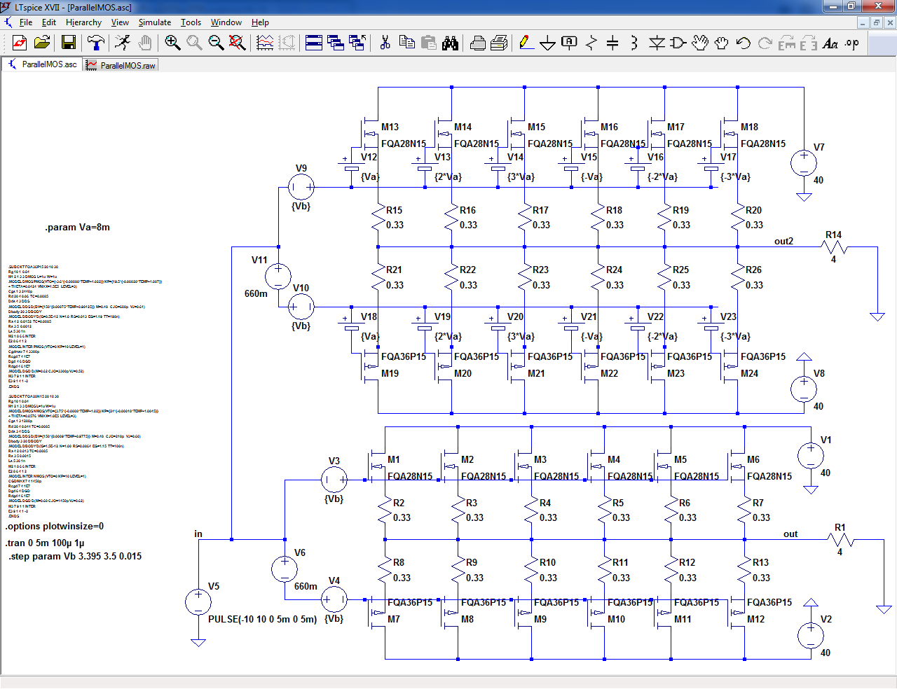

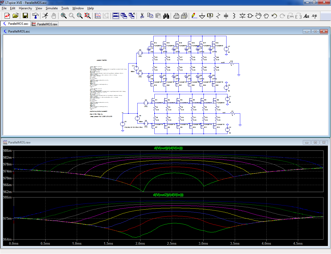

I have made the sim with the FQA's:
The top pane shows the situation with identical threshold voltages. This time, the transition is really ugly, maybe excessively so.
The bottom pane shows the same circuit with "random" threshold variations between -24mV and +24mV, by increments of 8mV.
The result remains ugly, but it is obviously smoother and more civilized.
You can play with the sim, by substituting other transistors, other current steps (parameter Vb), other threshold variations (parameter Va).
Currently, the quiescent current/transistor is stepped from 24mA to 135mA.
In a real, more realistic situation, having a slight dispersion of the threshold voltages can probably help reduce the crossover artifacts.

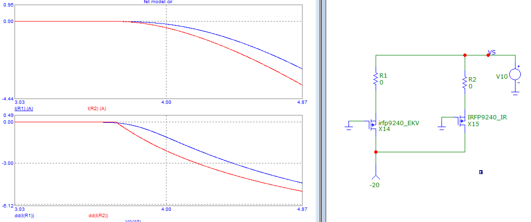

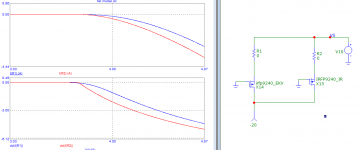

OK, that explains it. These FQA models are wrong, the real transistors don't behave like this at all.
Basically for a FET, the simple model is
Id = constant * (Vgs - Vt)^2 for Vgs >= Vt
Id = 0 for Vgs < Vt
And gm = d(Id)/d(Vgs), so
gm = 2*constant * (Vgs - Vt) for Vgs >= Vt
gm = 0 for Vgs < Vt
Below Vt, gm is zero, and above Vt, it is proportional to (Vgs-Vt). So there is a sharp corner in gm, and a discontinuity in the second derivative of gm at the point where the FET turns off.
In a real FET there is a subthreshold conduction zone where Id behaves more like an exponential, which gives a smooth transition if it occurs over a wide enough range of current. That's why IRFP9/240 and the FQA's give a smooth crossover. The laterals from ALFET don't have enough subthreshold, so they don't. And the models you got don't model it, so you get the wrong gm that looks like a "W". These models are only good for switching behavior, if you want to simulate a DC-DC converter it's fine.
Here's a comparison between EKV model and wrong model (gm on the bottom).
With LTSPICE you can use VDMOS model which fixes that, but you need the proper models that use it of course.

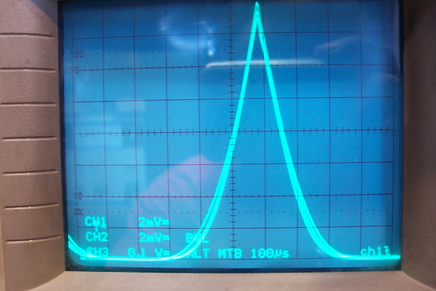

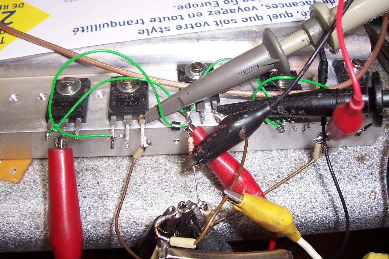

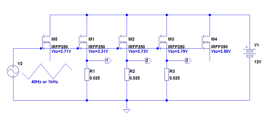

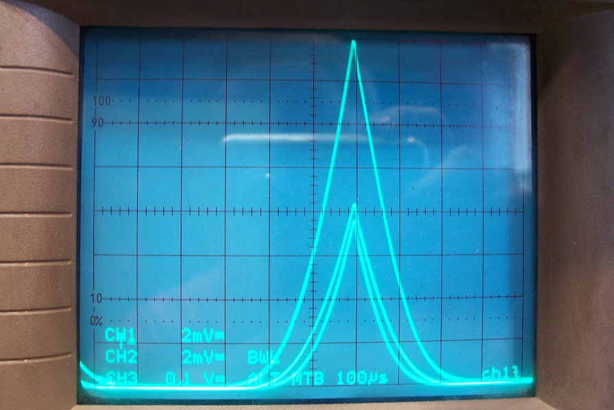

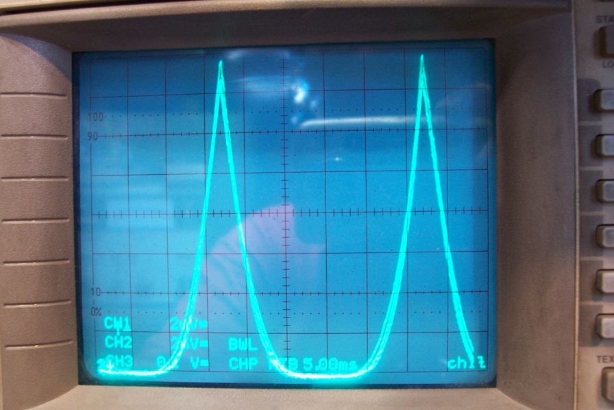

I made the parallel test.
I randomly picked 5 IRFP250 of various vintages.
I measured their Vto at 10mA and attached them to a common heatsink (non-isolated, but no thermal compound):
I paralleled them by triples, using a 25mΩ source resistors to monitor the currents.
The value is low enough to have a minimal effect on the current-sharing, meaning they are functionally paralleled.

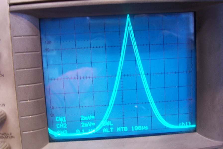

I injected an offseted triangle wave into the gates (to better visualize the transconductance linearity).
With 20mV/div (the third channel is simplified and has an external lab amp bringing it to the same level), the scale is 800mA/div, 6.4A full screen), this is the result for ~1kHz, for the three best matches (Vto=3.71V, 3.73V, 3.79V):
The maximum difference is 640mA, 10% thus negligible
The same with a 40Hz signal, to evaluate the effect of heating (the peak dissipation reaches 77W/device):
No difference (the small artifacts are caused by the digital mode of the scope)

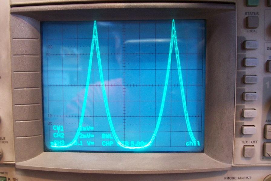

Next is two matched devices (3.71V & 3.73V) + 3.56V at 1kHz:
Somewhat paradoxically, the high-current sharing is better than for the previous case; some discrepancies are visible at a lower current.
Then at 40Hz:
No difference.
Finally, I tested the 3.31 + 3.56 + 3.73V combination at 1kHz:
This time, no miracle: with a discrepancy of >400mV in the Vto, the ratio becomes 1:2.
In summary: as long as devices are coarsely matched, the high current sharing remains perfectly OK.
Deliberately introducing small matching errors is of no consequence on the dissipation balance, and can probably improve the crossover region.
Note that the test was performed without additional balancing measures, like source resistors.
The IRFP250 are old devices, and do not have a too steep Id/Vgs curve, but more modern devices would be more demanding
Then at 40Hz:
No difference.
