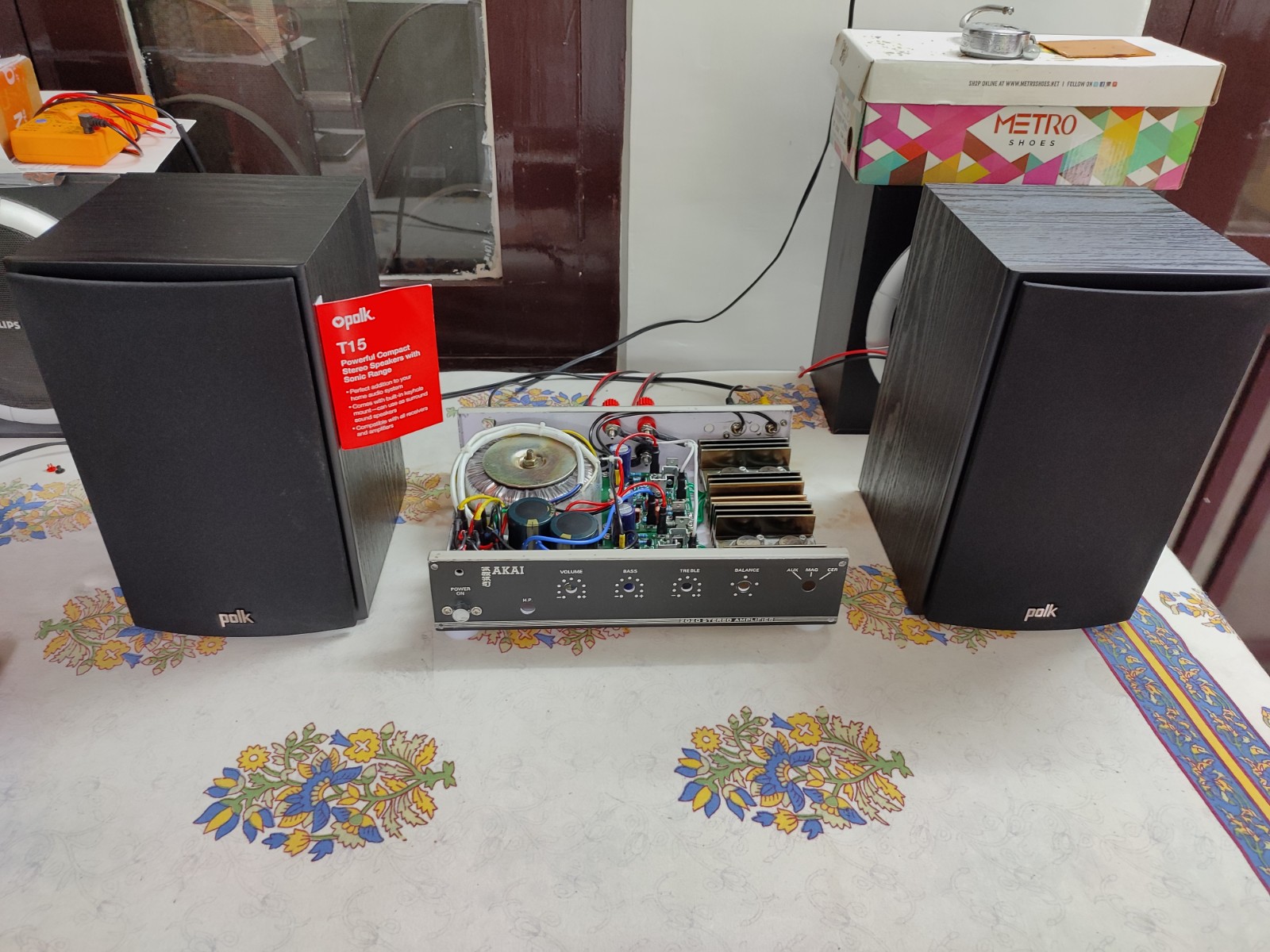

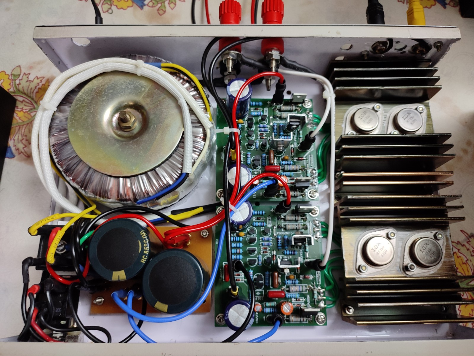

Finally assembled two MOSFET boards in a salvaged enclosure. The circuit and layout has now been tested fully and I finally connected Polk T15 speakers to feel the audio quality. It is simply excellent. The only constraint could be heat issue at higher power due to small enclosure size.
Following main components used in the build;
MOSFET - IRF350 (as I already had with me)
VAS - ON KSA1381 (Original from RS)
BC546B & MPSA 42 - ON (Original from RS)
2N5401 - KSA original
BAT54 - SMD placed under board (Original from RS)
MBR745 - Taiwan Semiconductors (Original from RS)
I have made some changes in CCS circuit after various iterations done on LT Spice and found that the present circuit maintains constant current over wide range of voltage from 18V to 65V DC. The variation in current is ~ 2ma during this range. CCS transistor is MPSA 42. The present layout accomodates CCS circuit. At current supply voltage MPSA 42 does not heat up but not sure at higher voltages.
I have not used Cascode transistor as I found it not very suitable for lower voltages so I revert back to 16+16V Zeners.
The measurements are as follows which are very near to simulation except for offset
Supply Voltage - 35-0-35V DC
Offset Voltage (-3.5V- 4V) & (-5V - 6V)
Quisent Current (154ma & 160ma).
HEXFET.asc file on which simulation has been done is also enclosed.
High resolution print of top and bottom layer of PCB is attached.
Congrats! Very nice compact build. Did you do any load test in order to observe the heat dissipation with those heatsinks at extent levels? Mounting them vertically could help a little but case dimensions doesn't seem to allow that. If you feel discomfort with the heat at prolonged sessions, you can attach a single 12V computer fan that runs at 5-6V.
Thanks for sharing PCB files.
EDIT: Don't you use any kind of thermal paste between mica insulators and mosfets/heatsink?
Also, I remember KSA1381 were mentioned as having Cob little bit to high for the circlophone...
I think it is very good choice for bias servo. Datasheet specifies it is as 3.1 pF / 150 MHz . Very similar specs with 2SA1370 which is my preference.
Thanks Mr minek123 and Mr terranigma for your advice. I know this build might not sustain full load test as per present setup not due to circuitry but due to limitation of heat sink and size of enclosure. But I had no choice. I have connected this build to my PC output giving me excellent response at room listening levels much much better performance than run of the mill market available amplifiers.
And more so the joy and satisfaction of DIY experience.
