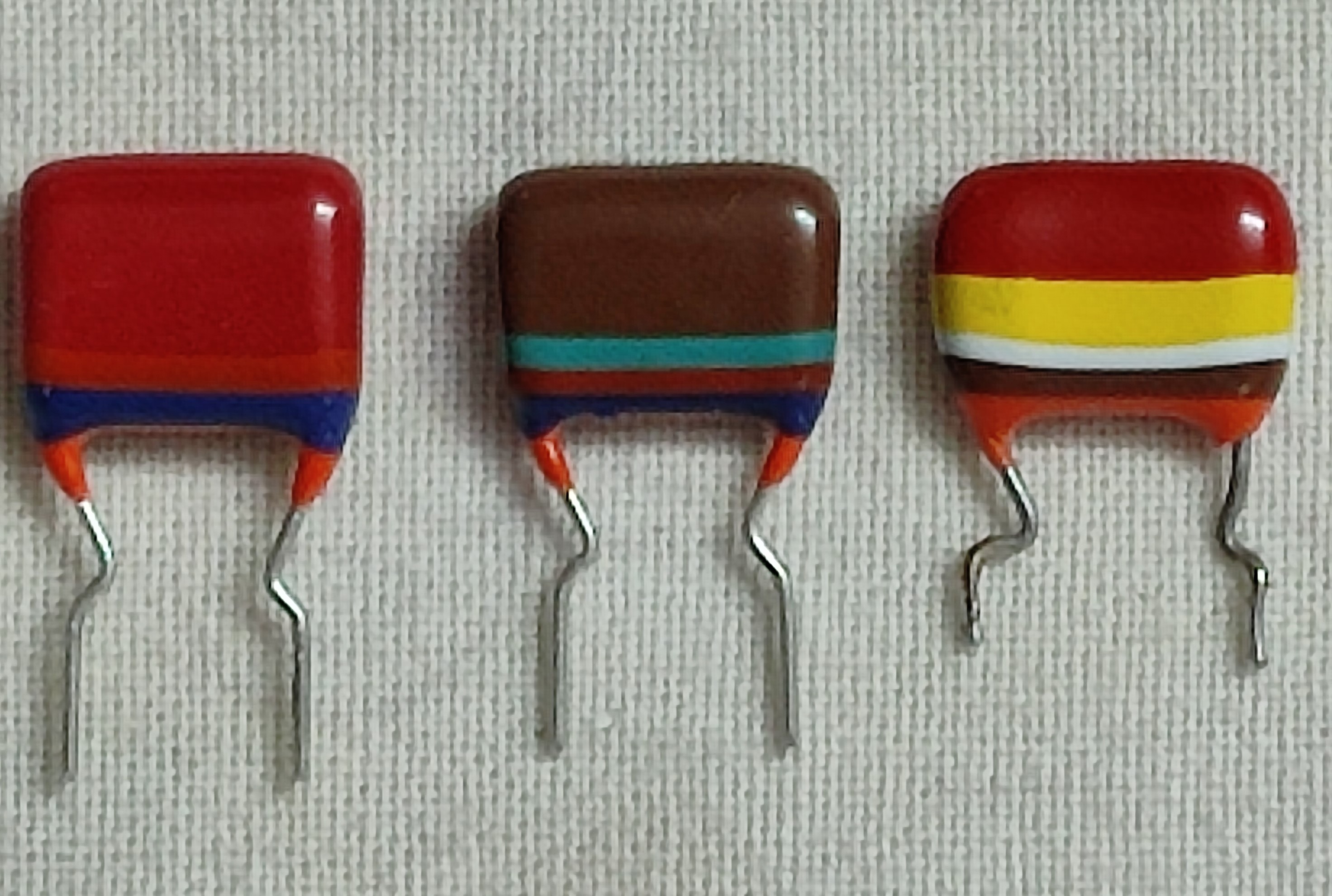

I have used Philips Polyster Capacitors (100-250V)
